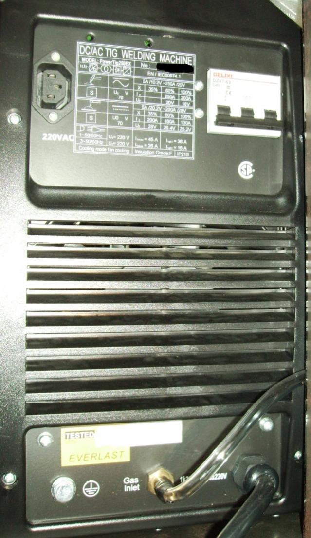

    I can't really speak for the other models but on my 250EX the 220V outlet for the water cooler hot all the time the welder is plugged in. Basically a computer extension cord that can be ordered from Wal-Mart for about eight bucks will plug into it. On my cooler the 220 volts goes through a computer power source that was converted into lab power supply. The pump and the fan run on 12 volts DC. Th pump is just a HF special.
    You can pair that 220V back down to 120V through a Jbox using one of the power wires and the ground. Unless you feel comfortable doing that kind of stuff, don't try this at home.
    As long as you are moving cool water through the torch is what counts.

    The connector on the back of my 250ex is hot all the time as well.
    This is the kind of cable you could use to plug into that connector.
    http://www.ebay.com/itm/200667002097
    Could someone post a pic of the back of a 250EX please.
    Parkour,
    That's an affirmative. That's the one you're looking for.

    Here's the back of my 250EX.
    The cord I linked to on eBay is identical the the one I got to connect my water cooler to the welder. I used the connector from a bad ATX supply as the power connector for the water cooler; thereby allowing me to use the power cord, unmodified.

    Thanks, there were no pics of the back at the Everlast store.
