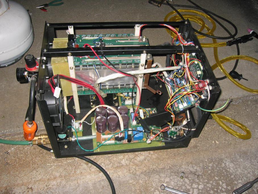

    Regarding making a Super200P last a long time, there is a design flaw with the diode circuit that you should be aware of. In my case, I didn't have any problems with it until only after I upgraded the torch to a CK TL-210 (200amps AC @ 100% duty cycle rated torch) and attempted to weld some godawful thick aluminum. Luckily, there is a fix for the diode problem, involving simply removing some diodes that cause some instability. If you wanted to make your machine as reliable as possible, you could do this preventatively (before any diode went out.) You will probably not experience any problems with it using the WP17 torch, though.
    http://www.everlastgenerators.com/fo...ghlight=melted
    So you just removed the 2 diodes tied in the circuits and all was well huh? I will keep that in mind. I like the idea of replacing with single higher rated diodes than running several in series. You have been a wealth of knowlege and help Jake, I really appreciate all your help. You are very articulate in your explanations and have been a great help, maybe Everlast should hire you as a tech rep! Coop
    To perform the Superp200P "diode-ectomy", there are four dual-diode packages in total that should be removed. Getting at two of them located near the center of the machine requires the removal of one of the large heat sink assemblies. The picture below shows a Super200P with the large heat sink assembly removed (to give you an idea of what state your machine will be in during the job):
    Also, during the job you should trim away any second layer of rubber insulation you may find between any of the remaining diodes and the heat sink. (In order to promote maximum heat transfer between a diode and a heat sink, there should only be one layer of the rubber insulation.)
    I wouldn't recommend doing any of this unless you have upgraded your TIG torch.
