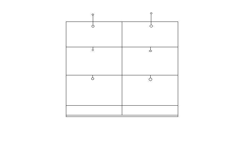

    Well, right off I'll tell you I haven't ever built a trailer...But my dad has built a few. The latest was a kayak trailer. He started with 2" 1/16" square tube. He got it square, tacked it, and checked square again. For this trailer he used an axle off a different trailer. It was built to hold six kayaks, but will hold 8. the kayaks weigh 41lbs apiece for a total weight of 328 (kayaks only).Click image for larger version.
