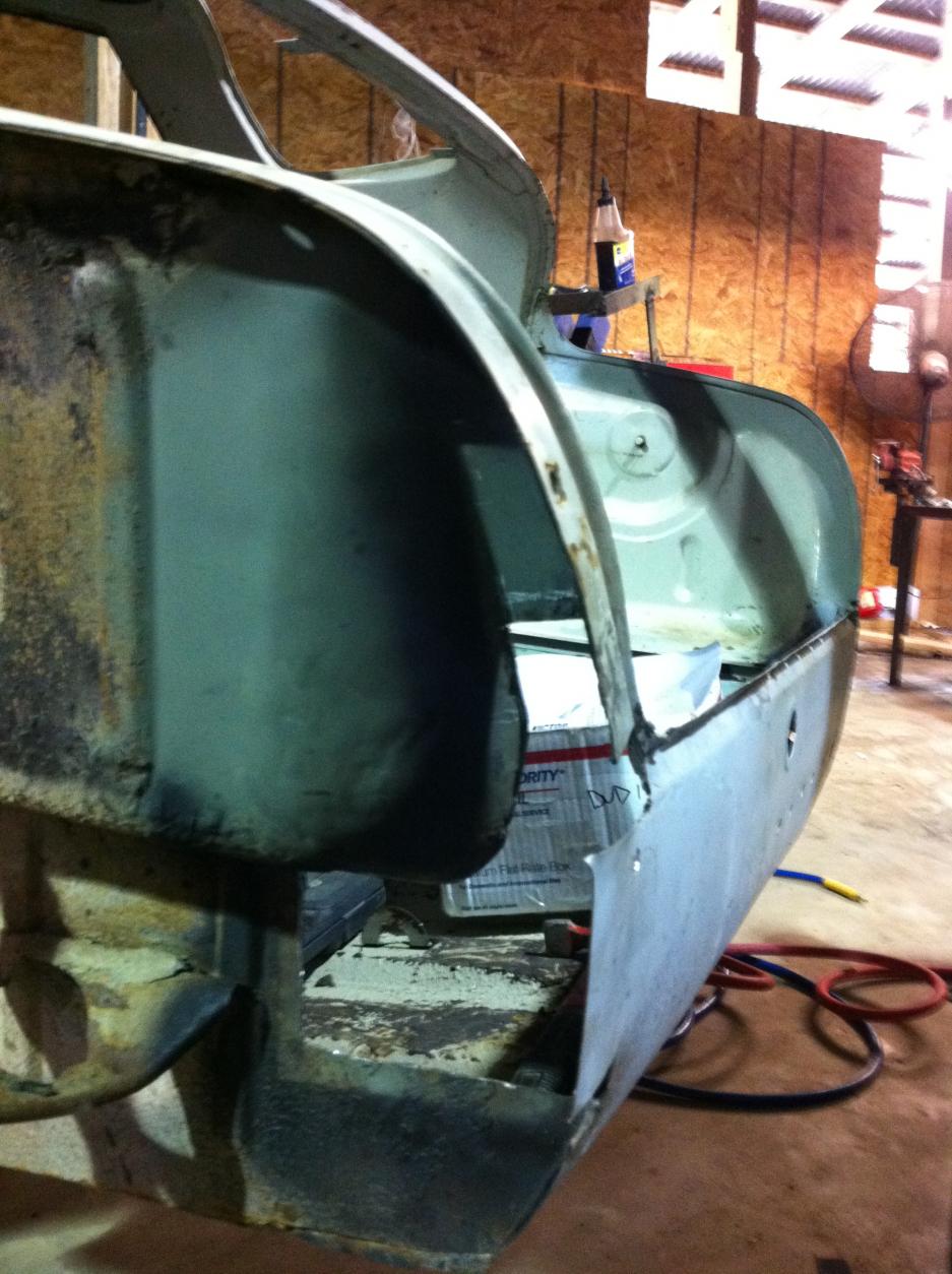

    This is a '61 bullnose that will be as close to perfect as I can make it when it's done. it's on long term hold because the boss is more interested in go-fast than look-good.

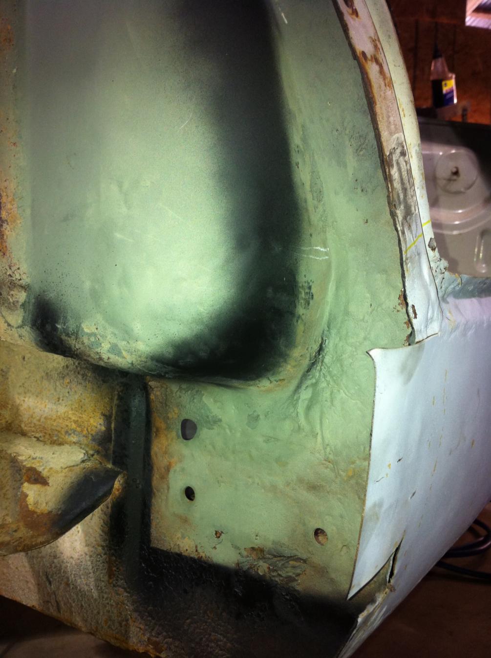

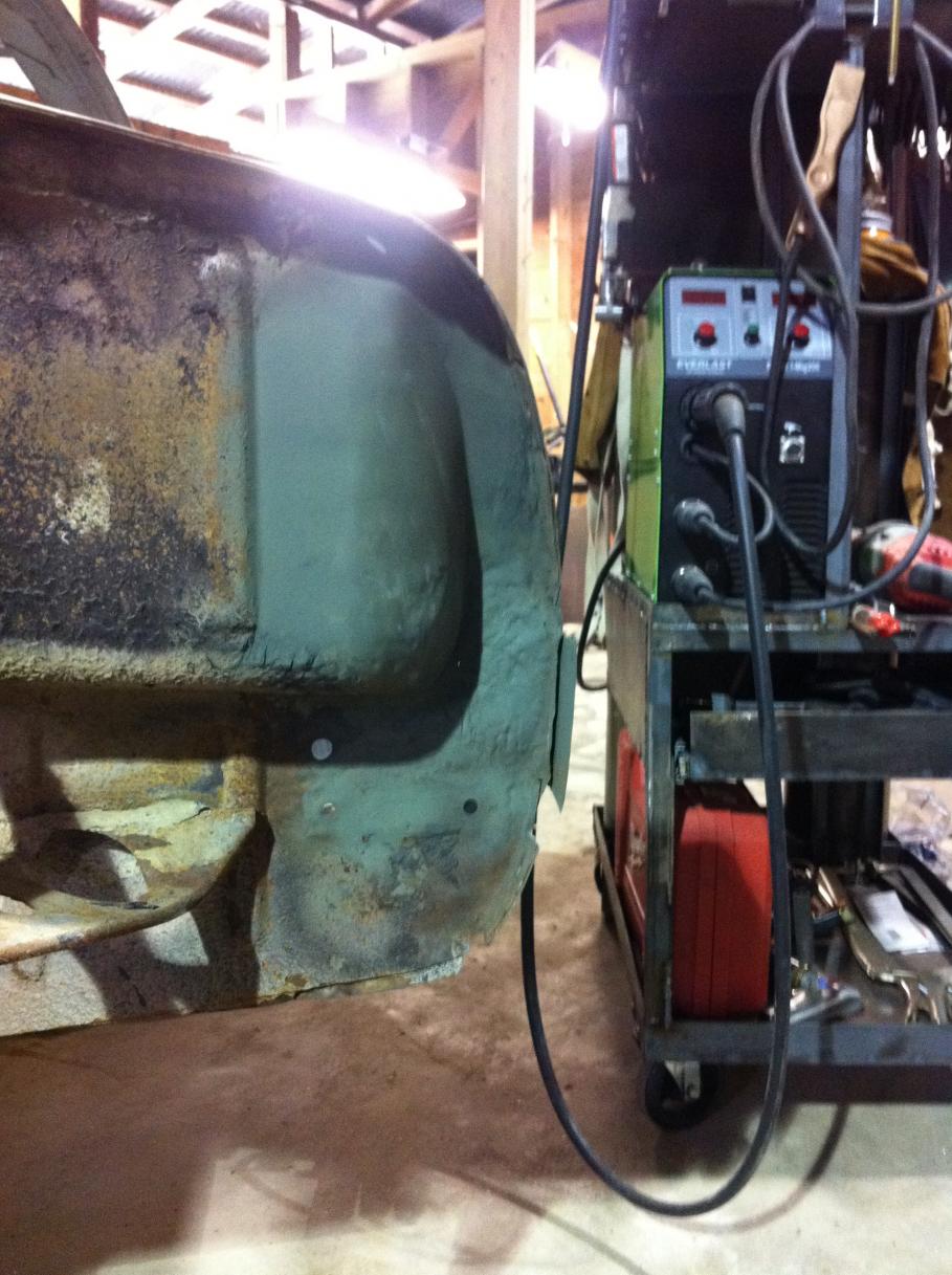

    this corner of the tail panel was hit and pushed and repaired, but this section of the inner quarter was pretty weak after being beaten back into place, so I replaced it.
ID:	3783Click image for larger version.

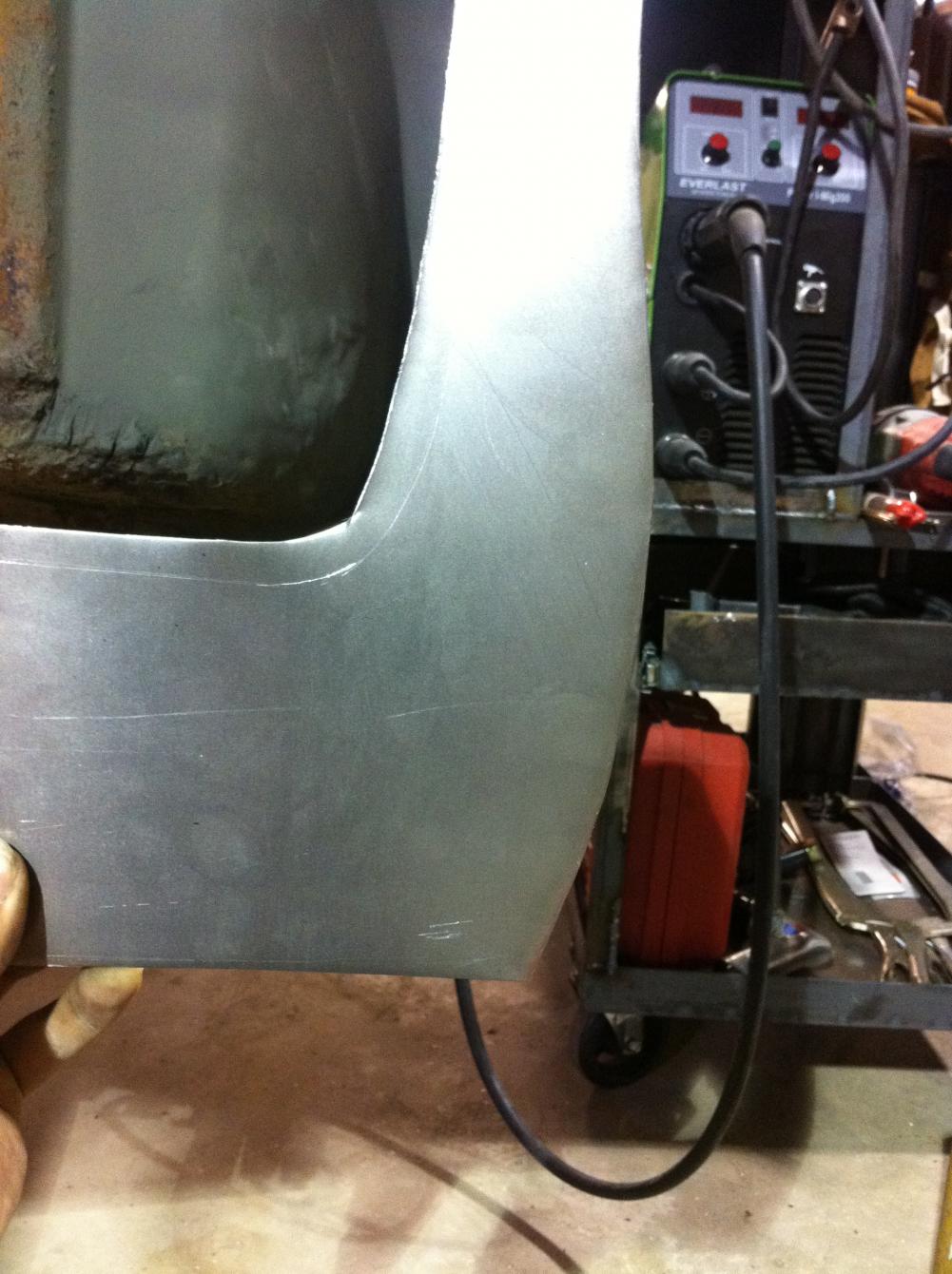

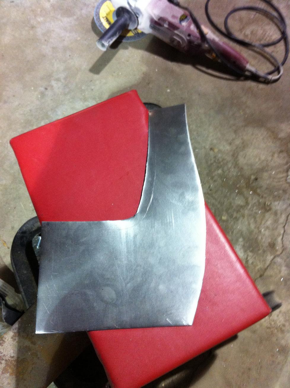

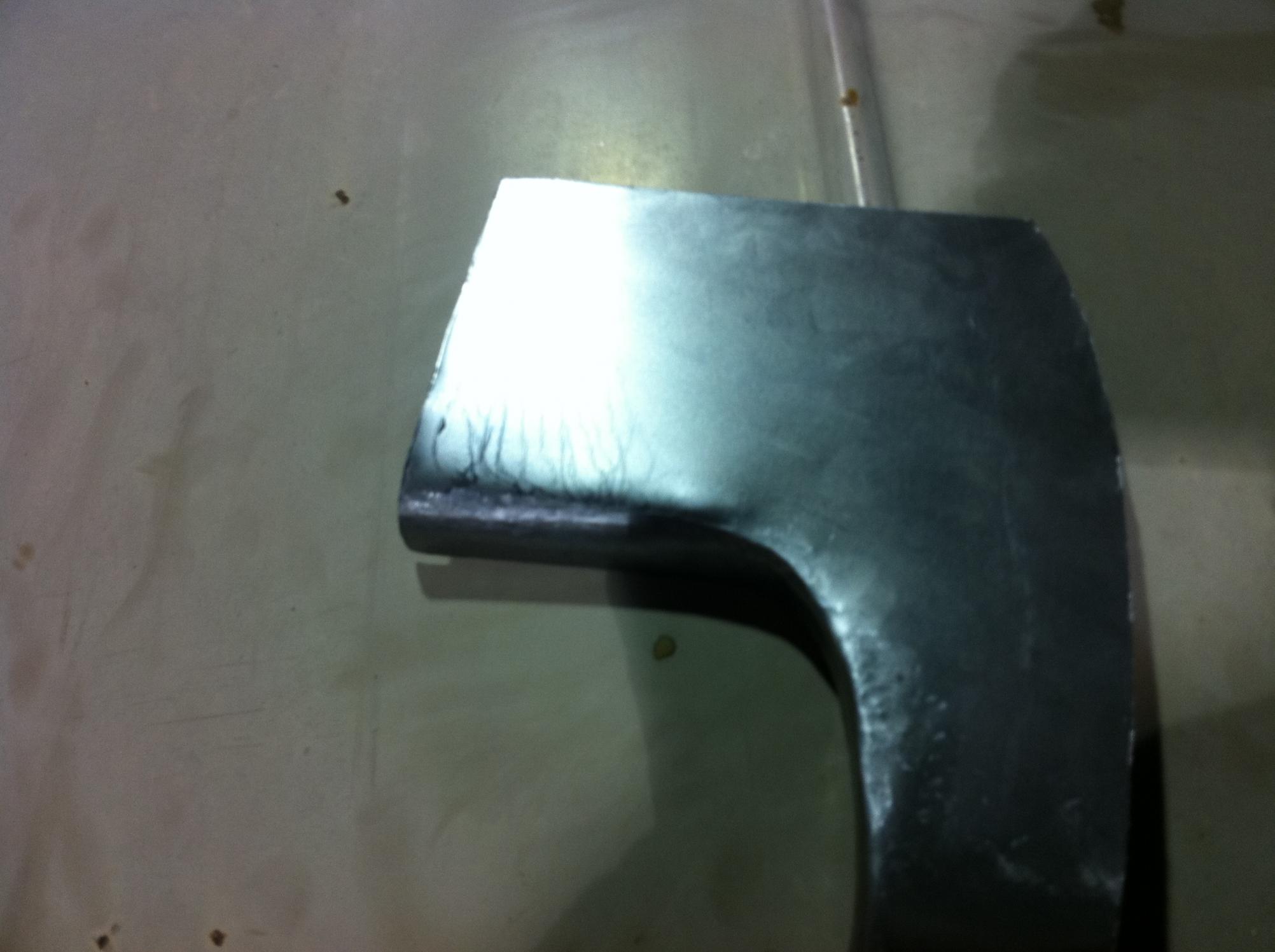

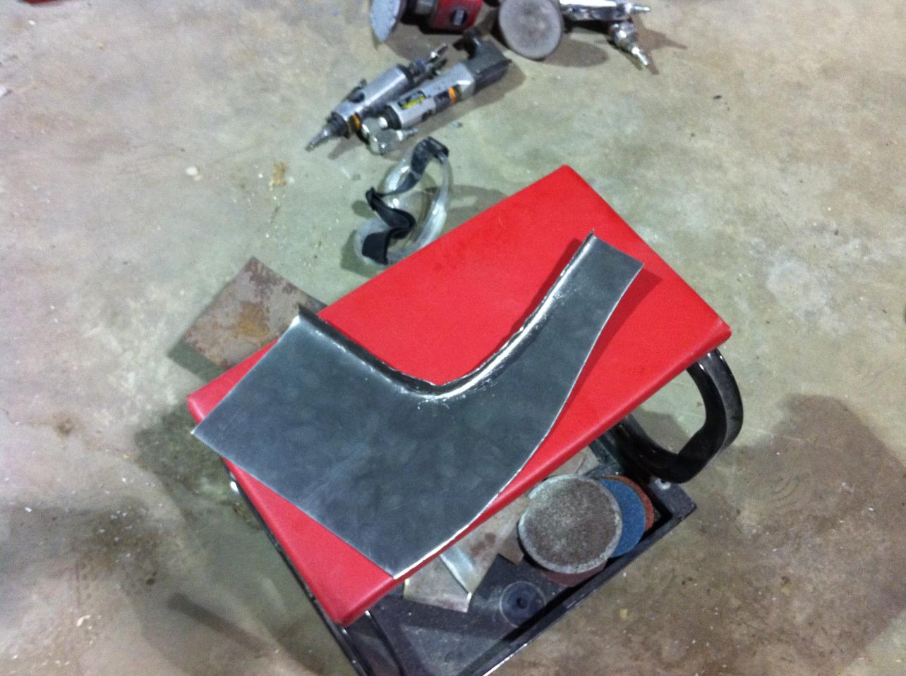

    the patch blank. you can see a faint scribe line where the flange needs to be folded over on the inside corner. I used a piece of copier paper to make a template. I usually use posterboard, but I didn't have any.

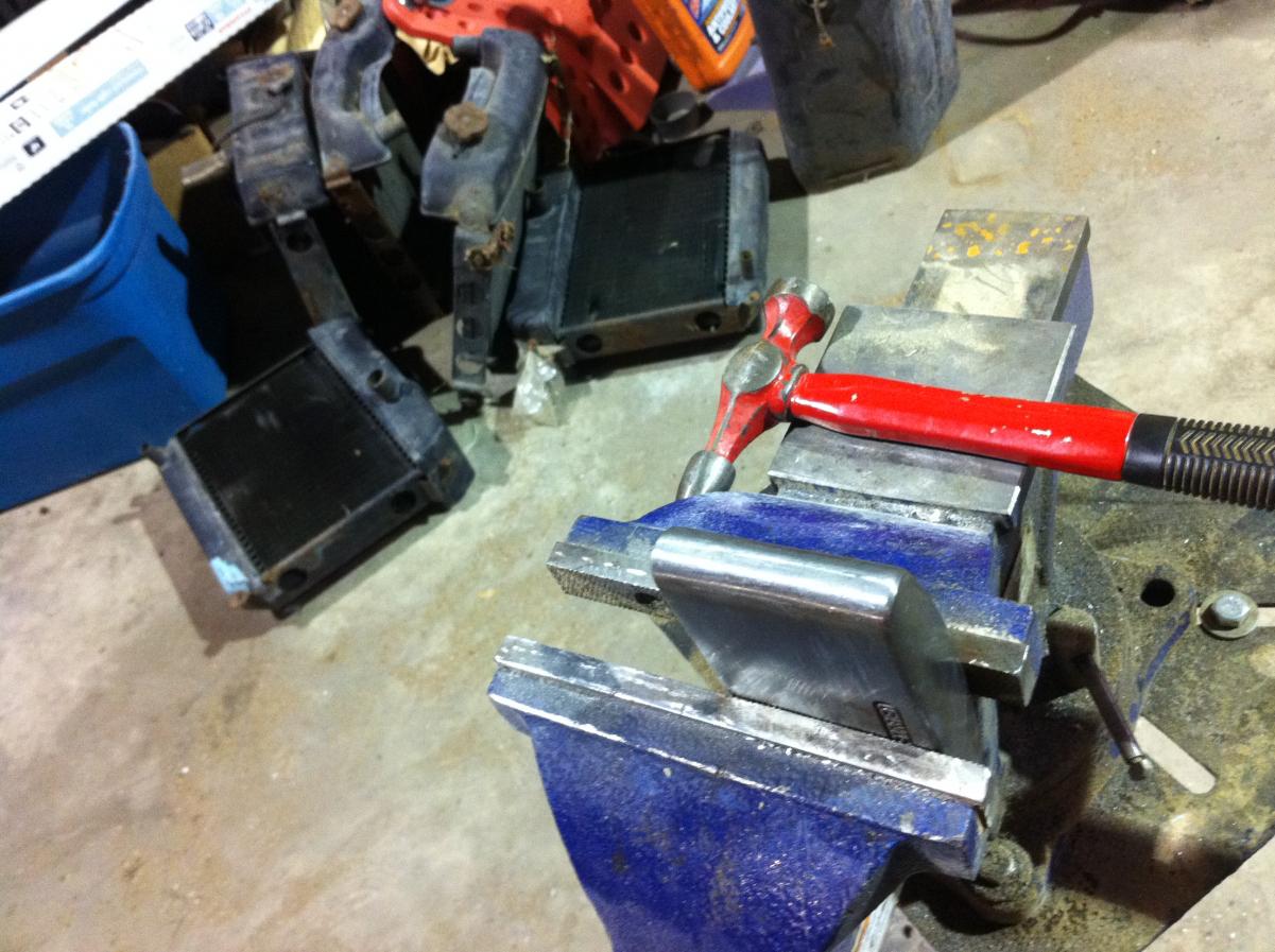

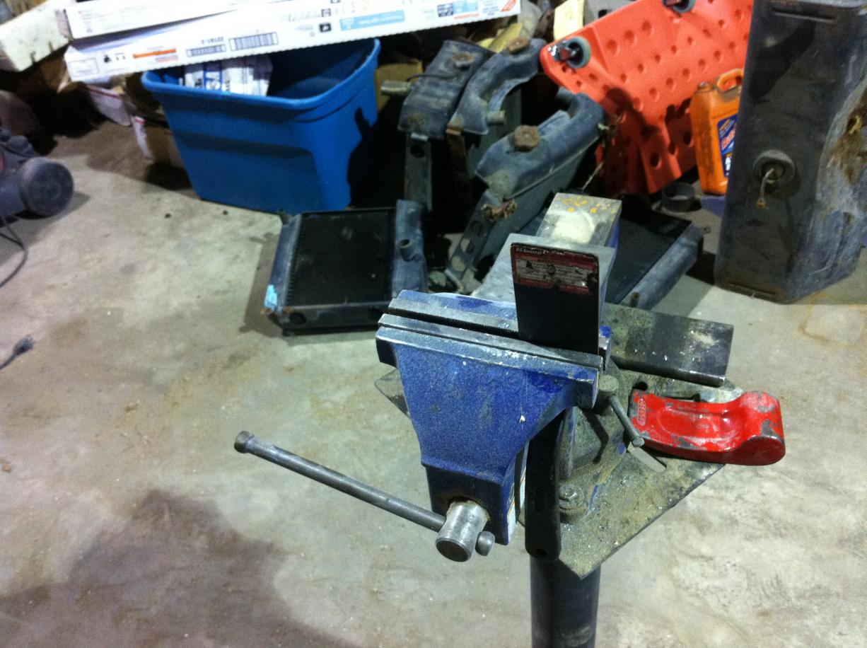

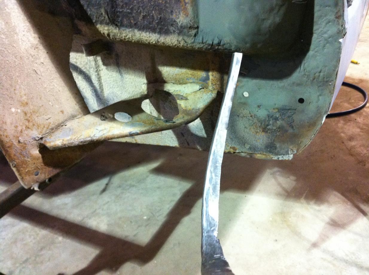

    this is a chunk of leaf spring i found by the side of the road walking home from highschool that I ground and polished one end of. it works great for folding edges over with, especially in combination with a dolly like the second photo
ID:	3786Click image for larger version.
    with the inside flange folded over:

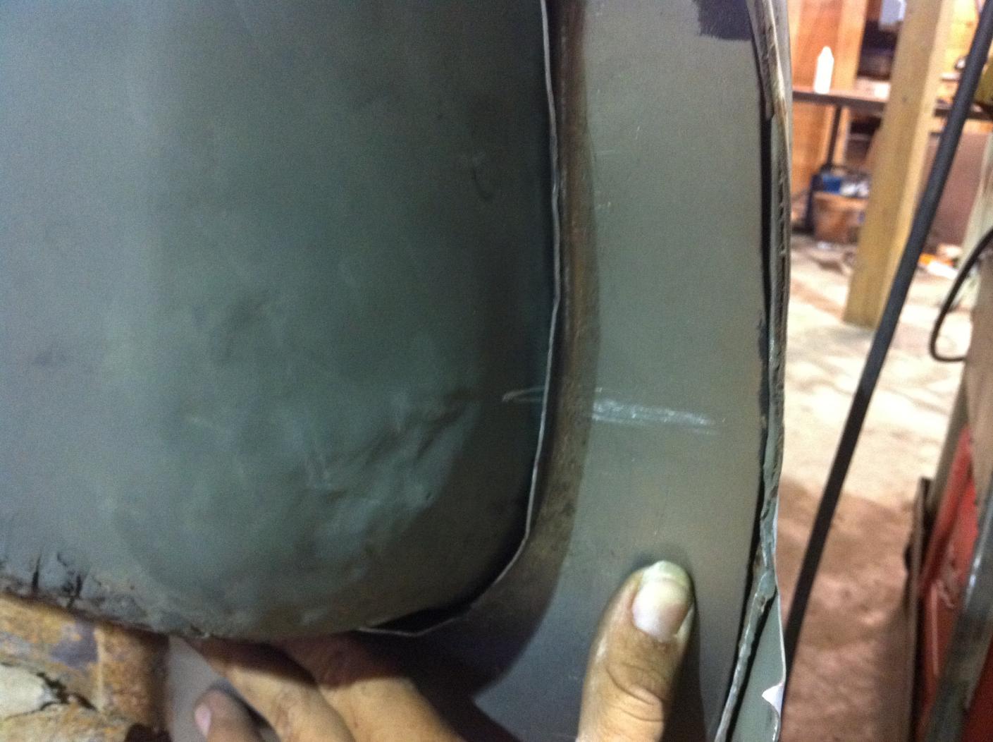

    the inner quarter leans out, so I had to make the patch do the same:

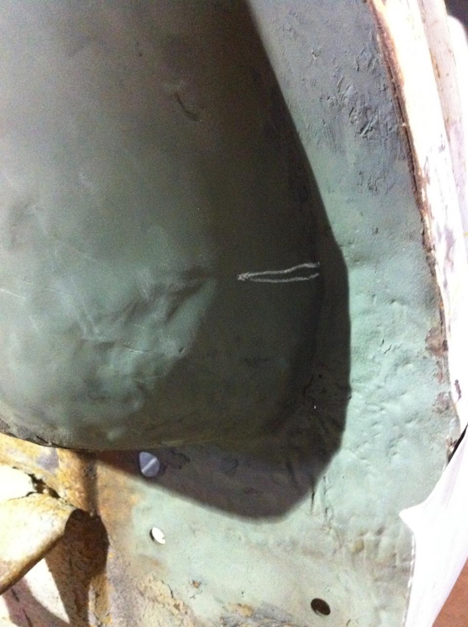

    the soapstone mark is where I was thinking of cutting the patch off, I think it ended up leaving it a bit higher.

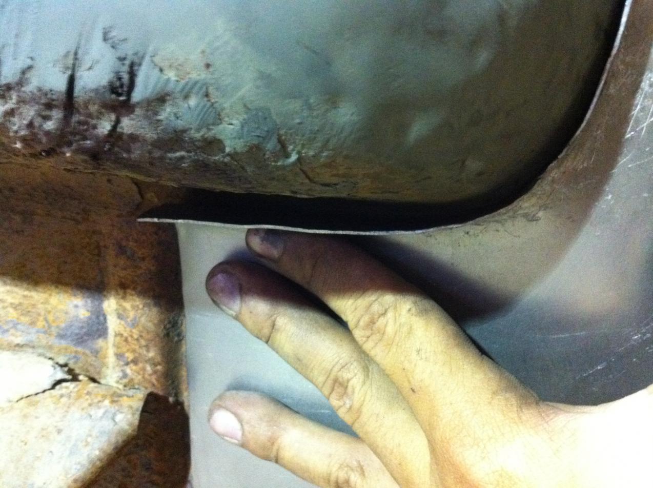

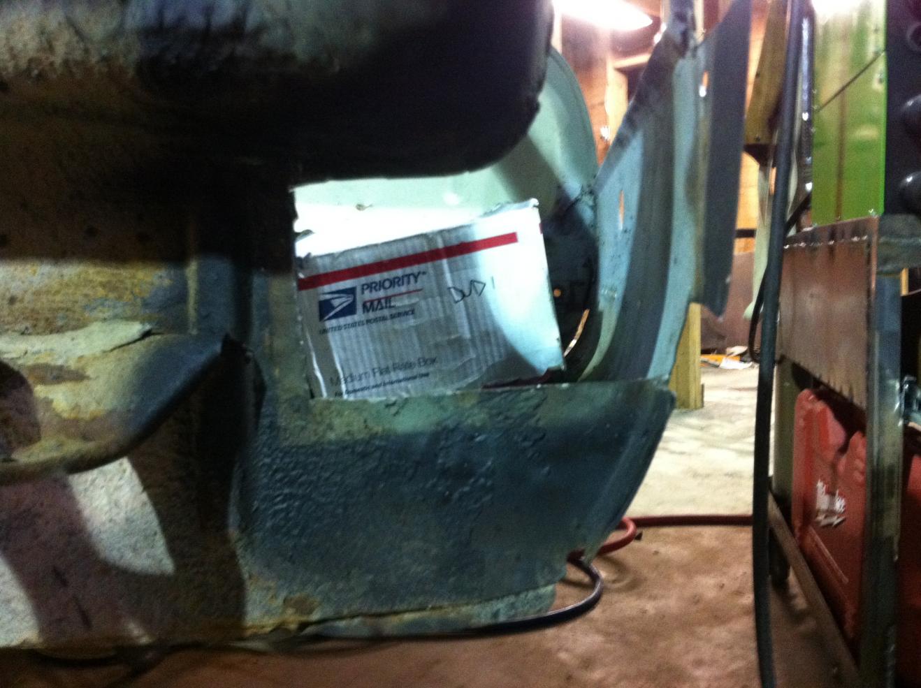

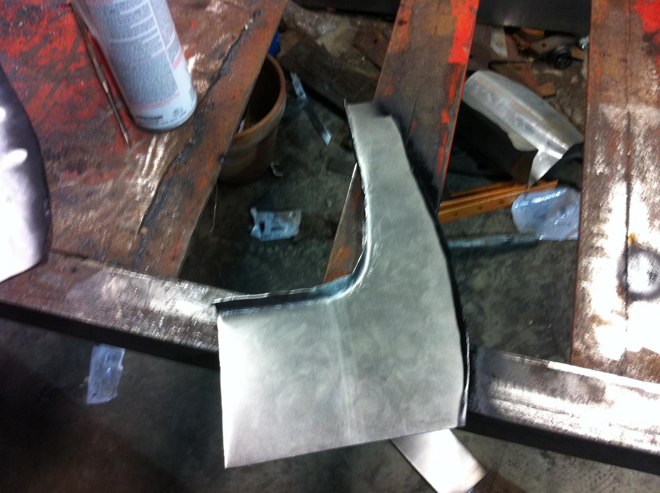

    you can see that the flange is bent over a bit too far at this point. it's always a challenge getting a flange like this to lay down right around a corner. the second one is the mostly fitted patch.
ID:	3793Click image for larger version.

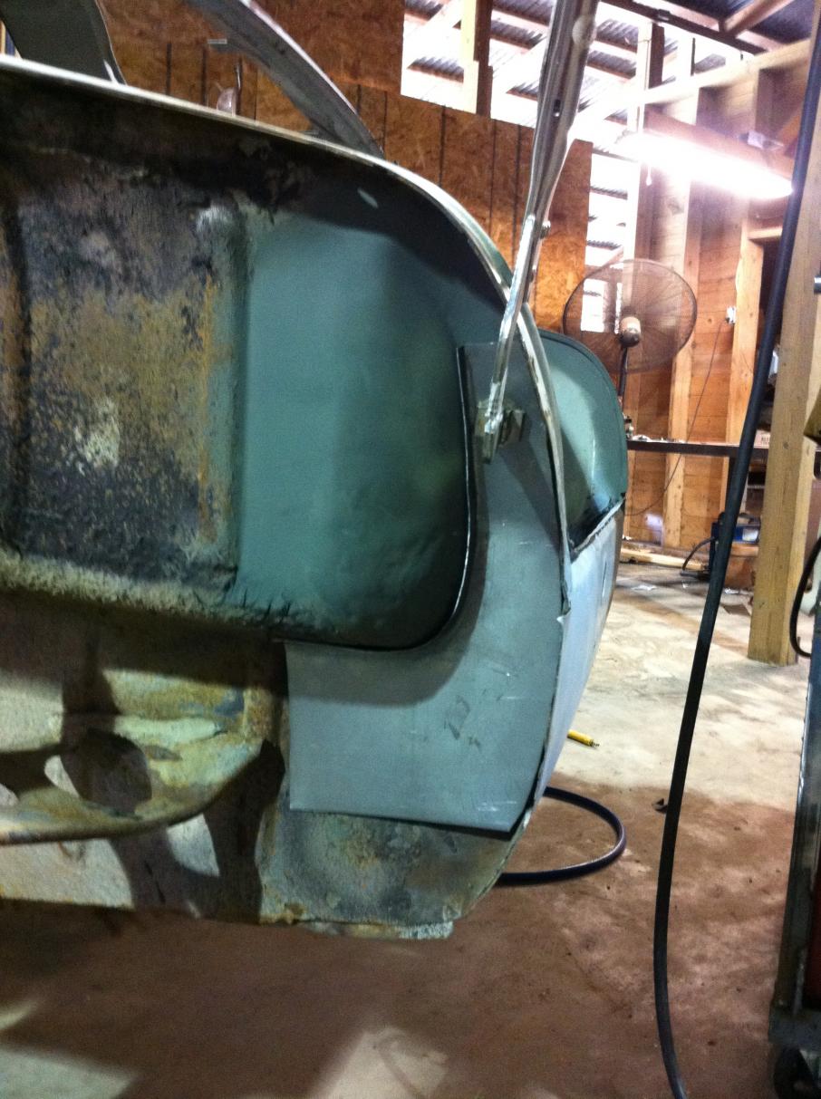

    the patch pinned up with a tong clamp:

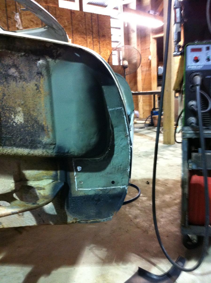

    I used black spray paint to give myself an outline while the panel was clamped up, then I chalked in where I was going to cut out.

    and then the hole:
