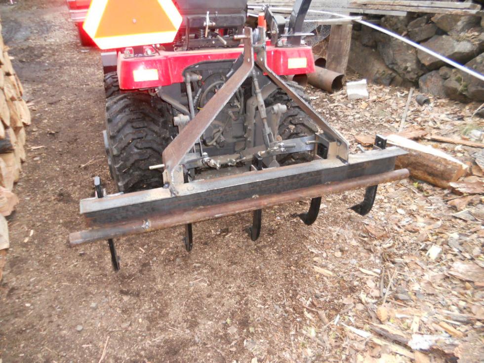

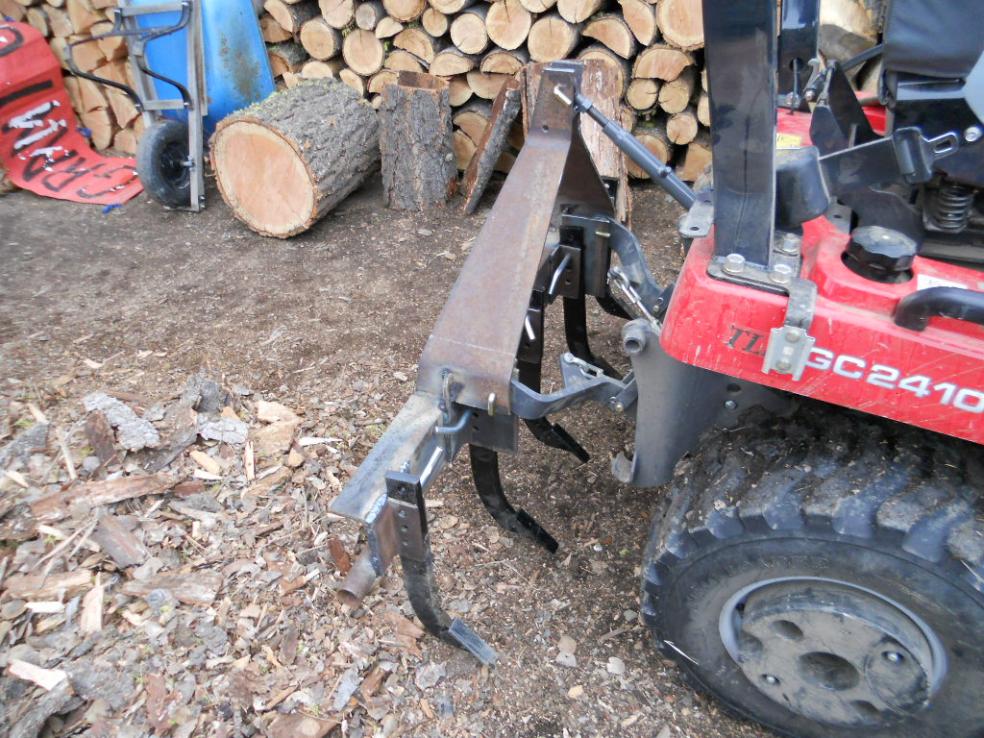

    Finally got it all welded up, I probably burned more rod on this one project than I have in the past 3 years. (I really need more helmet time don't I?) Still need to bore the 3PTH holes out to full size, chip slag, and clean off all the spatter (too bad I just couldn't wait for the shiny new DC welder ).

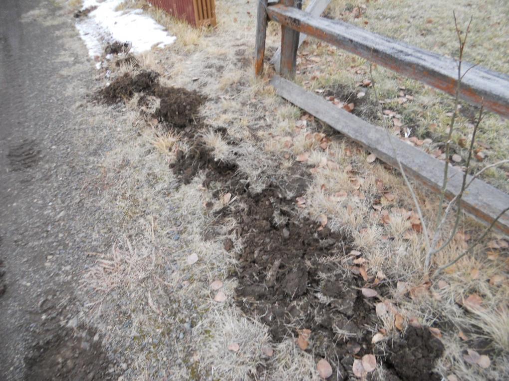

    This should make planting the wife's tulips a breeze!

    The scarifers are great for busting up soil, but instead of using a hinged box, I added hydraulic tip and tilt to the 3point. This allows you to roll the entire box forwards to get the scarifiers in contact or roll it back to a point where the scarifiers are out of contact and the 2 blades work like a block plane ( there are 2 blades, one mounted forwards and one mounted backwards ). It also allows tilting the box left or right for making crowns. Its really not that tough to add the tip and tilt, a couple rams and electric solenoids from surpluscenter.com, tap into the loaders hydraulics. Flip the electric switch and control the box with the loaders control lever. Its about the best impovement you can make to a tractor with a 3-point.
    Another great project with the scarifiers is a single tooth for a cable trencher using a sweep 90 degree elbow mounted behind the tooth to lay the cable in the trench. I can get about 14" depth with this setup and I dont think there is a faster or better way to trench moderate size wires or cables or even small piping. I've trenched up to 5/8 PEX but you could do a larger diameter with a larger sweep elbow.
    You get unbelievable ripping power from a single tooth, the down pressure loads the tires for traction and because there is an upward pull on the tooth, you can rip out almost anything that gets in your way. Here again, the hydraulic tip/tilt helps for fine tuning the attack angle and cable depth.
