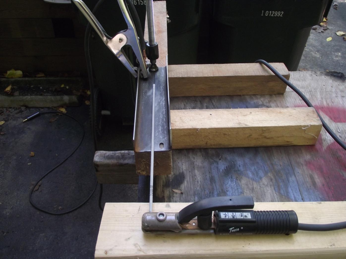

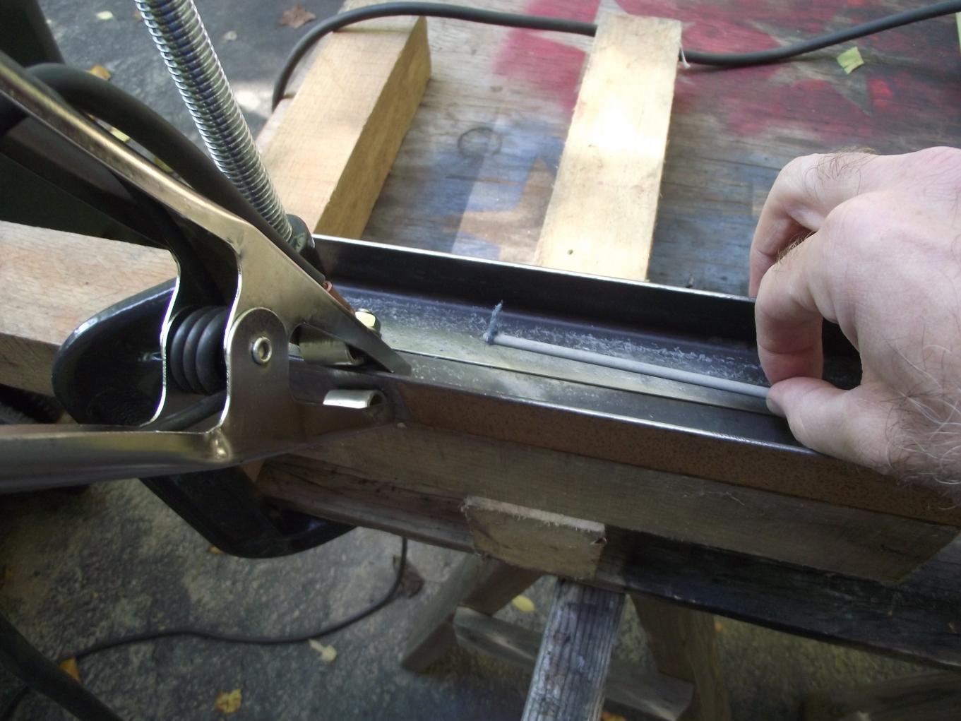

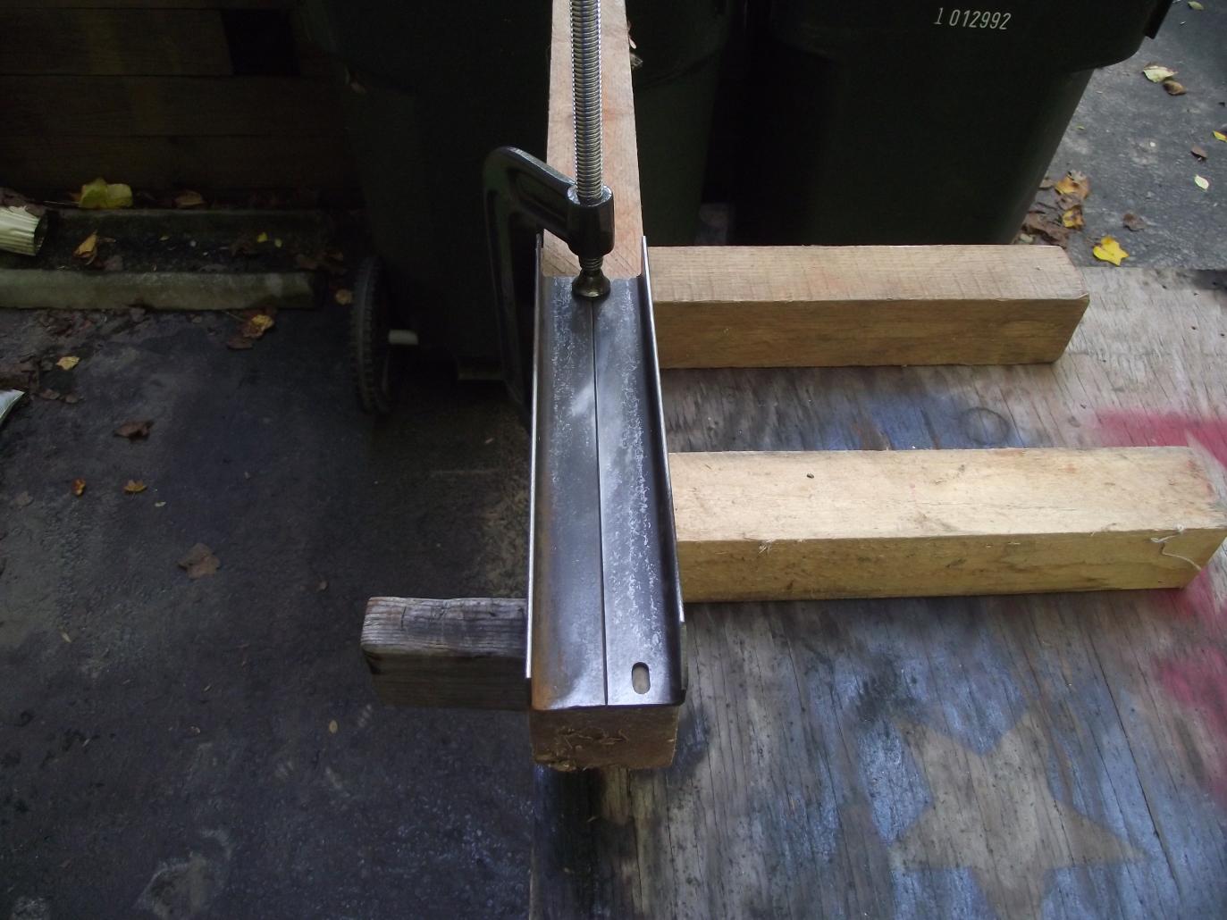

    In my attempt I decided on a 7018 rod (for its drag capabilities) on a horizontal butt weld of 3/32 mild steel. Photo 1 shows the butt weld. Photo 2 shows the setup: this is a dry run I set up while the 7018s baked. The Beth Steel paper doesn't divulge the mechanics of starting the weld, and I felt that turning on the welder and leaping from "off" to "full welding" would not be good for something somewhere. So I decided to forego the securing tape suggested by Beth Steel and drop the electrode onto the plate. The Beth Steel paper did mention they used steel wool to help initiate an arc- photo 3 shows my intended drop setup with a little wisp of steel wool on the end of the electrode.

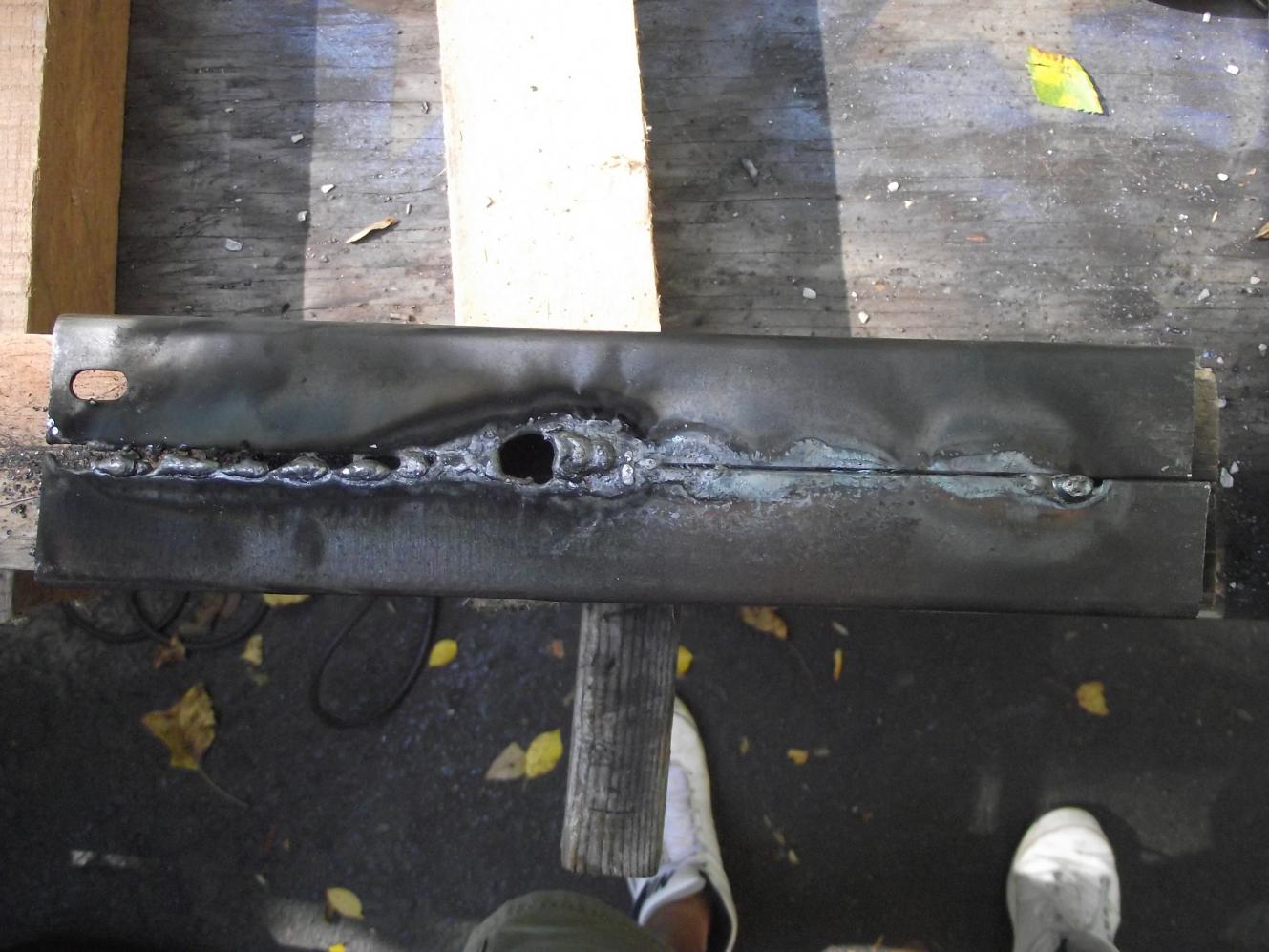

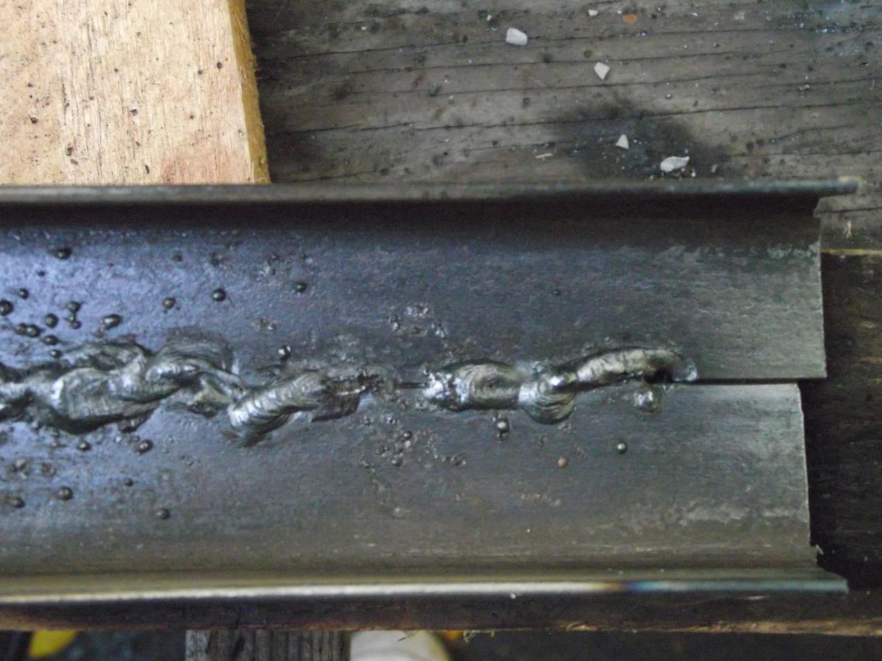

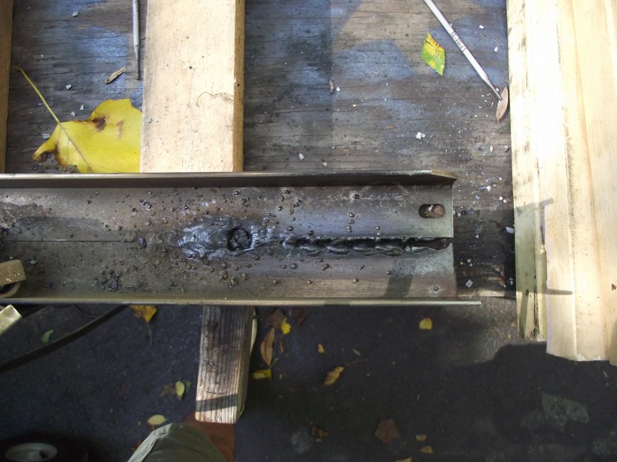

    NONE of those ideas worked. I started out at about 75 amps, got no results, and cranked the heat up to about 100 amps thinking it would help start the arc. The drop technique was useless, with or without steel wool. Finally I wound up picking up the striker, starting the arc as in normal welding, and then setting the striker down and holding it still. This actually worked! But the heat was too high and the weld completely burned through (photo 4)- I didn't realize it until the rod had burned to the end of the steel. I flipped the steel around so I could start from the other direction and turned amps down to about 75. This resulted in a tolerable weld, for maybe an inch or so. Photo 5 shows the results of two different successes. I tried to hold the striker still but it waved around- probably why Beth Steel used tape. Photo 6 shows the opposite side of the weld.
