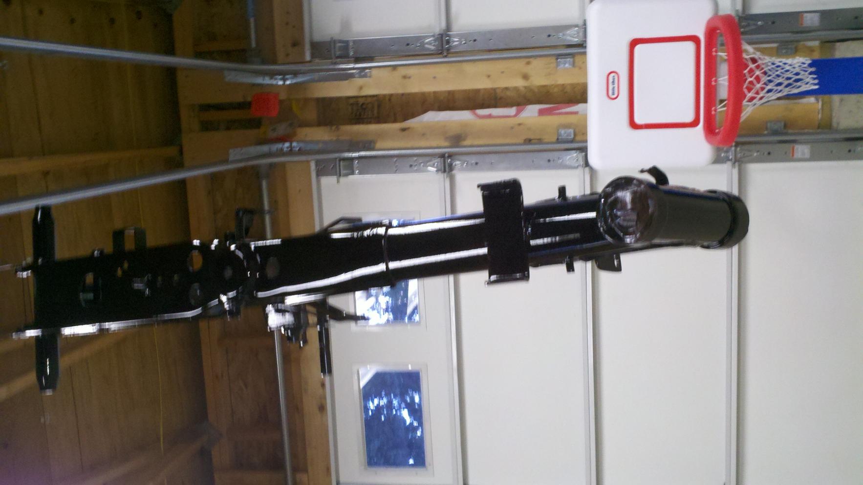

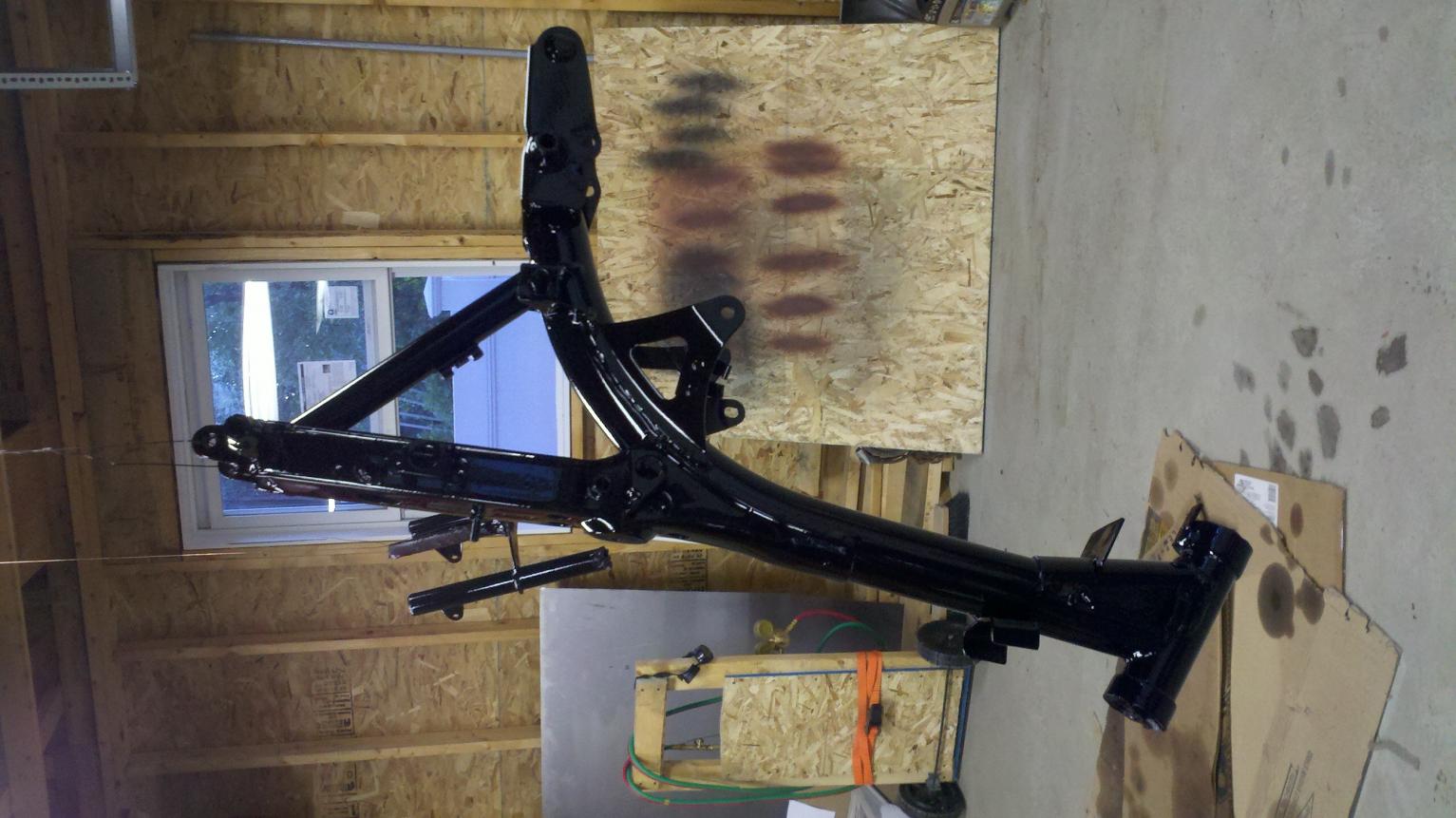

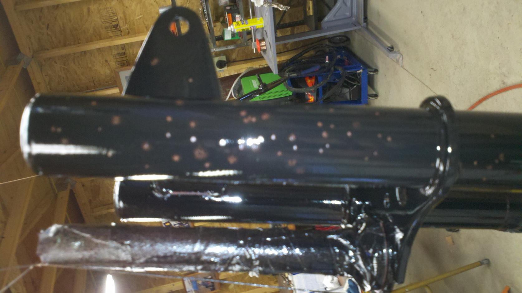

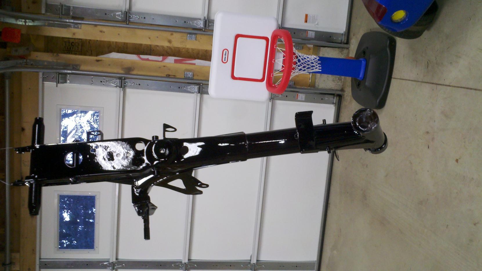

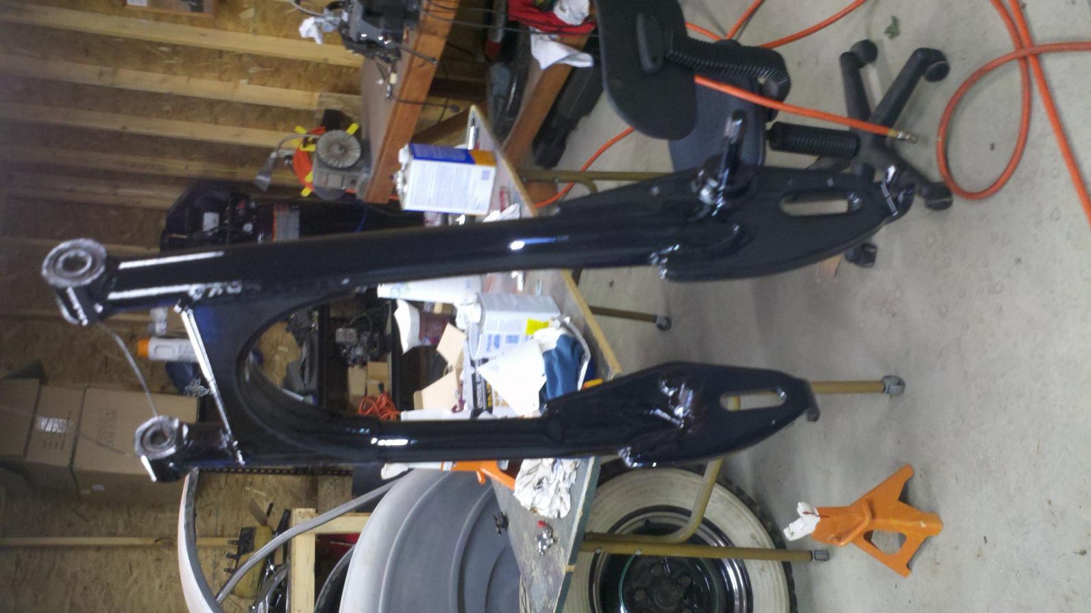

    after the "shakedown run" I pulled it back apart to do all the finish work. up to that point most everything had only been tack welded to check for fitment and use. after things worked it's time to do bearings, bushings, cleanup and paint!
    the paint was done "on the cheap" as well. I wanted experience spraying so I tried the "thin rustoleum and add hardener" route. I had issues with my prep work on the forks and swing arm (fish eye from oil) but it sprayed out pretty dang good. fish eyes were sanded out, reprepped and came out as good as the frame.
