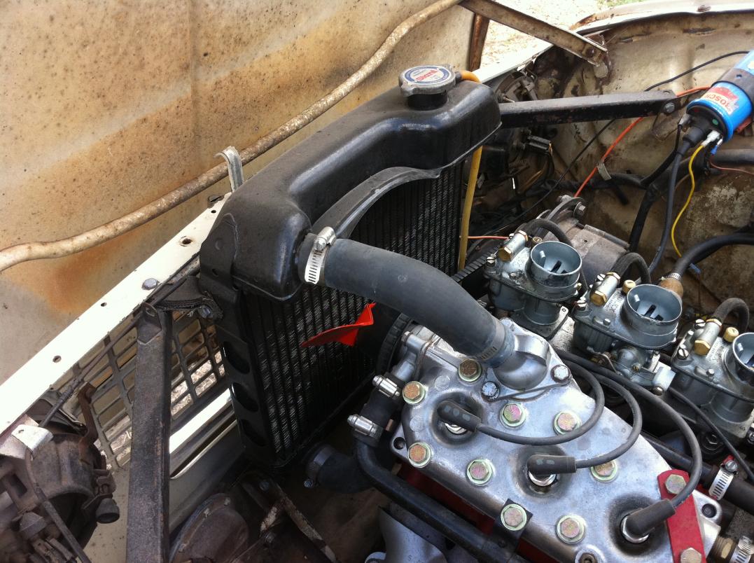

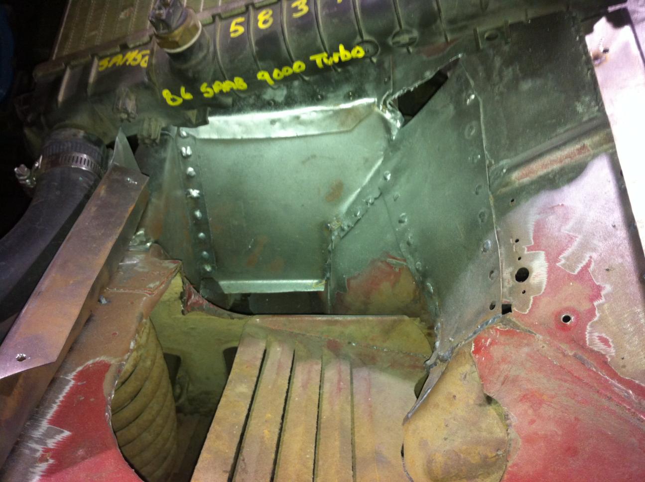

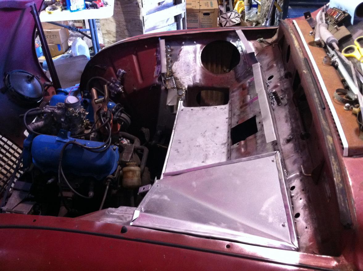

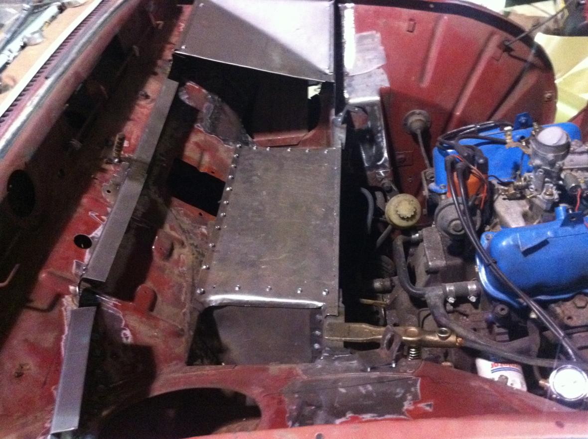

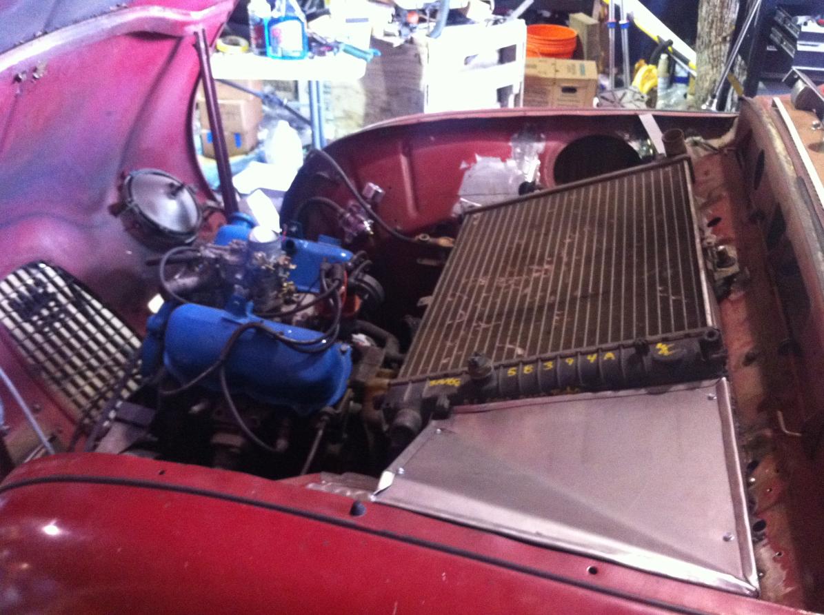

    one of the cars I'm currently working on is a '63 Saab 96. originally, these had the Saab 3 cylinder two-stroke with a tiny little radiator mounted above and behind the engine and a rear-facing shaft-mounted belt-driven fan. they were notorious for overheating, particularly with ethanol blended fuel (the mixture runs leaner the more alcy is in the fuel, and hence hotter).
    this car, though, as the V4 engine Saab used in the later 95/96s and sonnets. it's a few inches longer than the 2-stroke, so it's really jammed in the engine compartment. I didn't do the engine swap on this car; it was left half-done, which is how the boss bought it. he had a the local VW beetle shop get it running again, but it still had the stock radiator in it.
    the boss bought a used radiator from an '86 Saab 9000 on ebay a while ago, which I'm currently making bracketry and ducting to mount it in this 96.
    I've deleted the heater core and fan blower unit off the firewall so I have more room to work with. they're not really necessary here for 11 months out of the year.
    the 9000 radiator is 16.5"h x 27"w, so I had to lay the radiator down to about 25 degrees off horizontal to fit the top hose under the hood. because of the angle and it's position behind the engine, I'm ducting the exhaust side out the wheel wells so it doesn't dump back out and heat the radiator back up. there are two engine air outlets ontop of the inner fenders that I've taken out to allow more air to pass. the center section between the shock towers needs to be removable for access to the shift linkage and steering rack.
    I've made the tops of the duct boxes removable (well, one. I still have to make the other one). I'm going to have to run wires, lines, ect through the duct area as the duct plenum occupies pretty much the entire area behind the engine from fender edge to fender edge.
    eventually, this car will get a megasquirt 3 ECU, controlling port EFI and electronic coil-per-plug ignition. charly wants to stick a turbo on it, too. if that's the case, I'm going to have to re-do all this stuff, as the only place to stick the turbo is right behind the engine, which would heat-soak the radiator for sure.
    It's a fun project, though. I'm currently doing another radiator swap in one of the long-nose 2-strokes, as well as changing to an electric water pump. they have a typical front-mounted radiator, but they were still only 12x12, so not a whole lot of cooling going on there. the core on the new one is 21wx14h and will have a 14" electric fan on it. there's not going to be near as much fabrication on that one, else I'd do a project out of it, too. it's a higher priority, as it's a complete car, so the V4 car is sortof on hold at the moment. this car is also getting a new engine, mostly 'cause charly just got a hopped up one back, not because it really needs a new engine. it really just needs a new harmonic balancer.

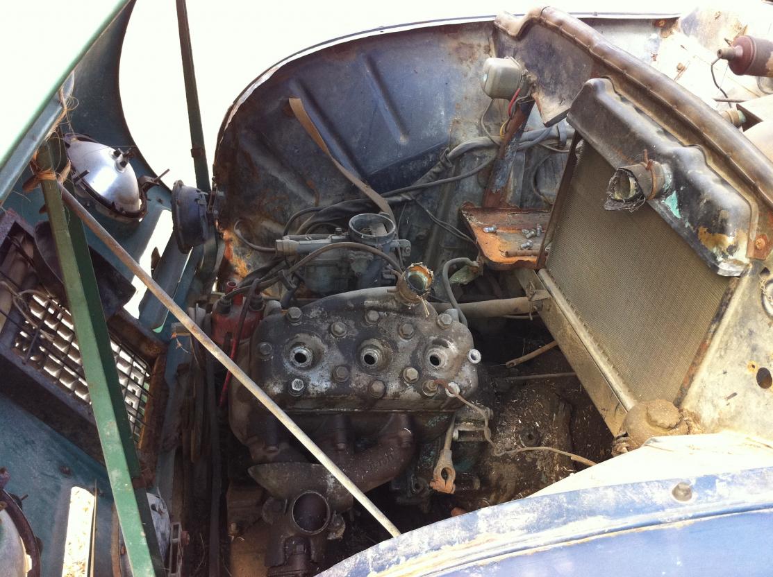

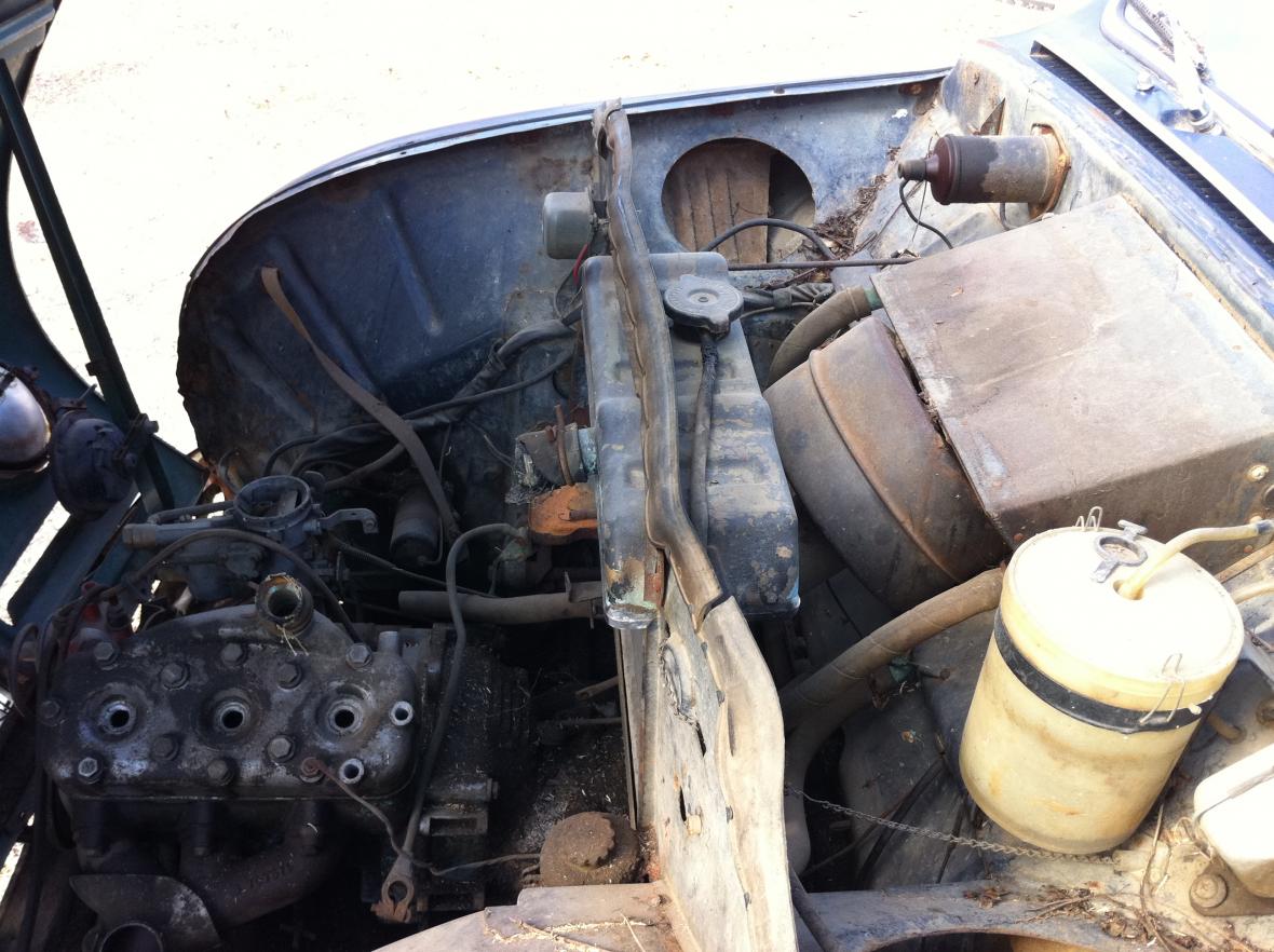

    This is the stock engine compartment (this is actually a different car, but the V4 looked the same before it was v4'd

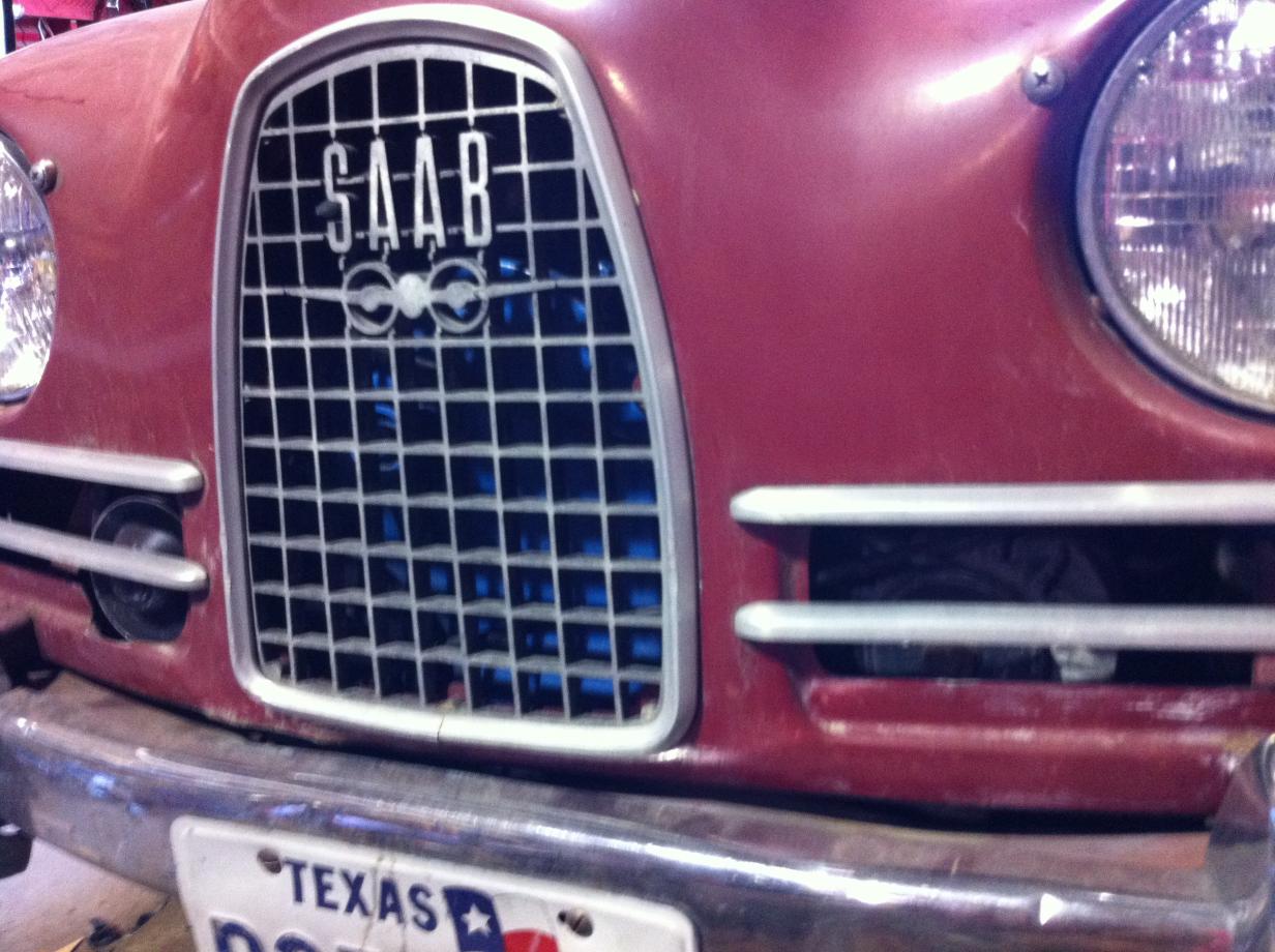

    these two are from another short-nose that the boss bought recently. body's in good shape, but there's a good deal of bondo in the bolt on panels and the mechanicals are mostly toast. we have plenty of good doors and fenders and a few rebuilt engines and trannies coming back soon, so no worries!

    left and right view w/o radiator. the silver everywhere in these shots is just silver pain, not bare metal. it was starting to flash and I was out of acid etch. the rebar 'stud' in the top center fits through a rubber grommet in the radiator. originally it would've been a bolt, but one of the mounting studs on the bottom of the radiator is broken, so I put the bolt in that corner.

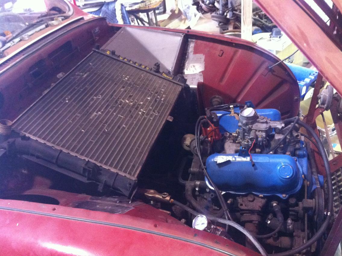

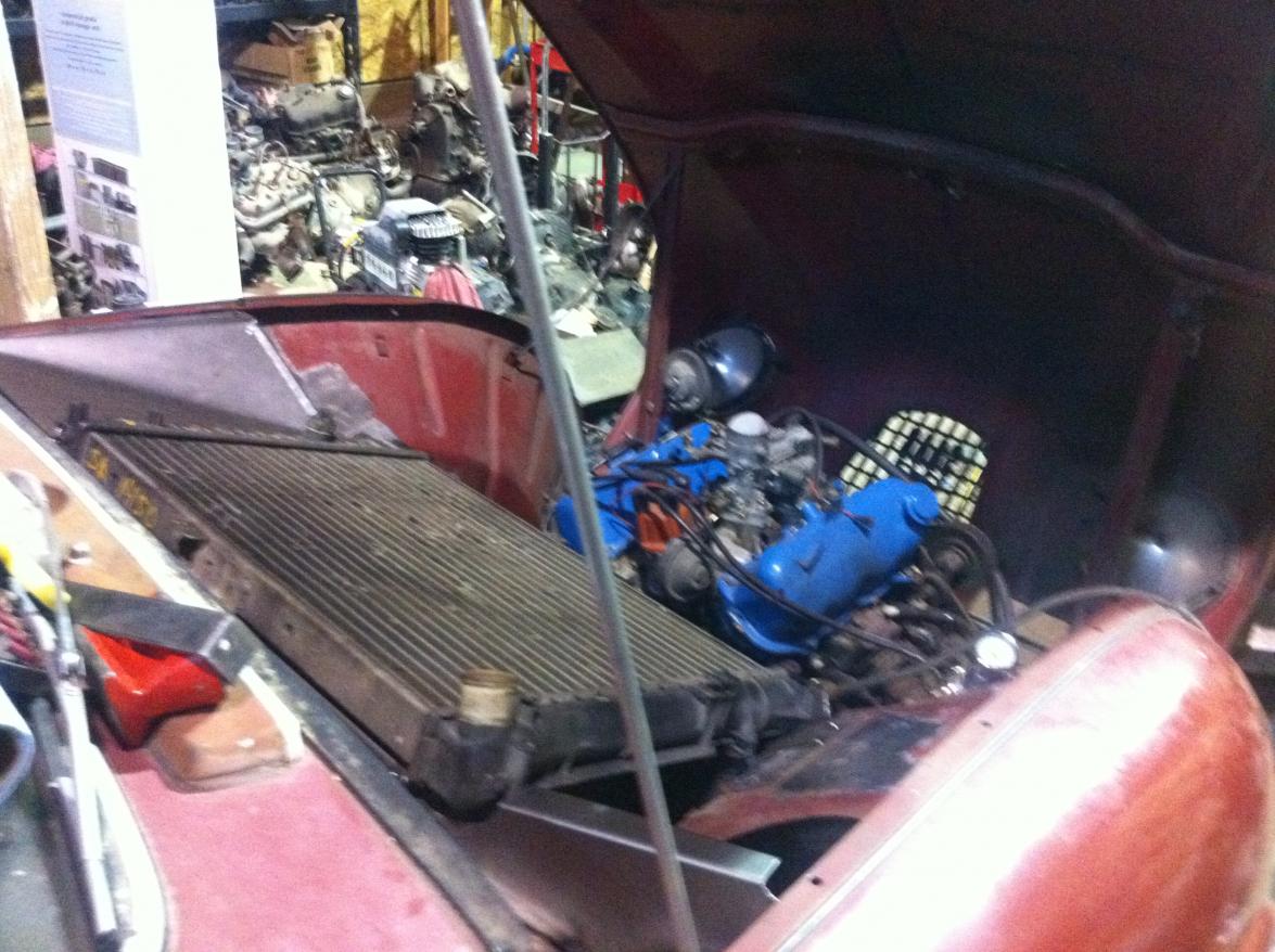

    with radiator in place.
ID:	3602Click image for larger version.
ID:	3610Click image for larger version.
ID:	3603Click image for larger version.

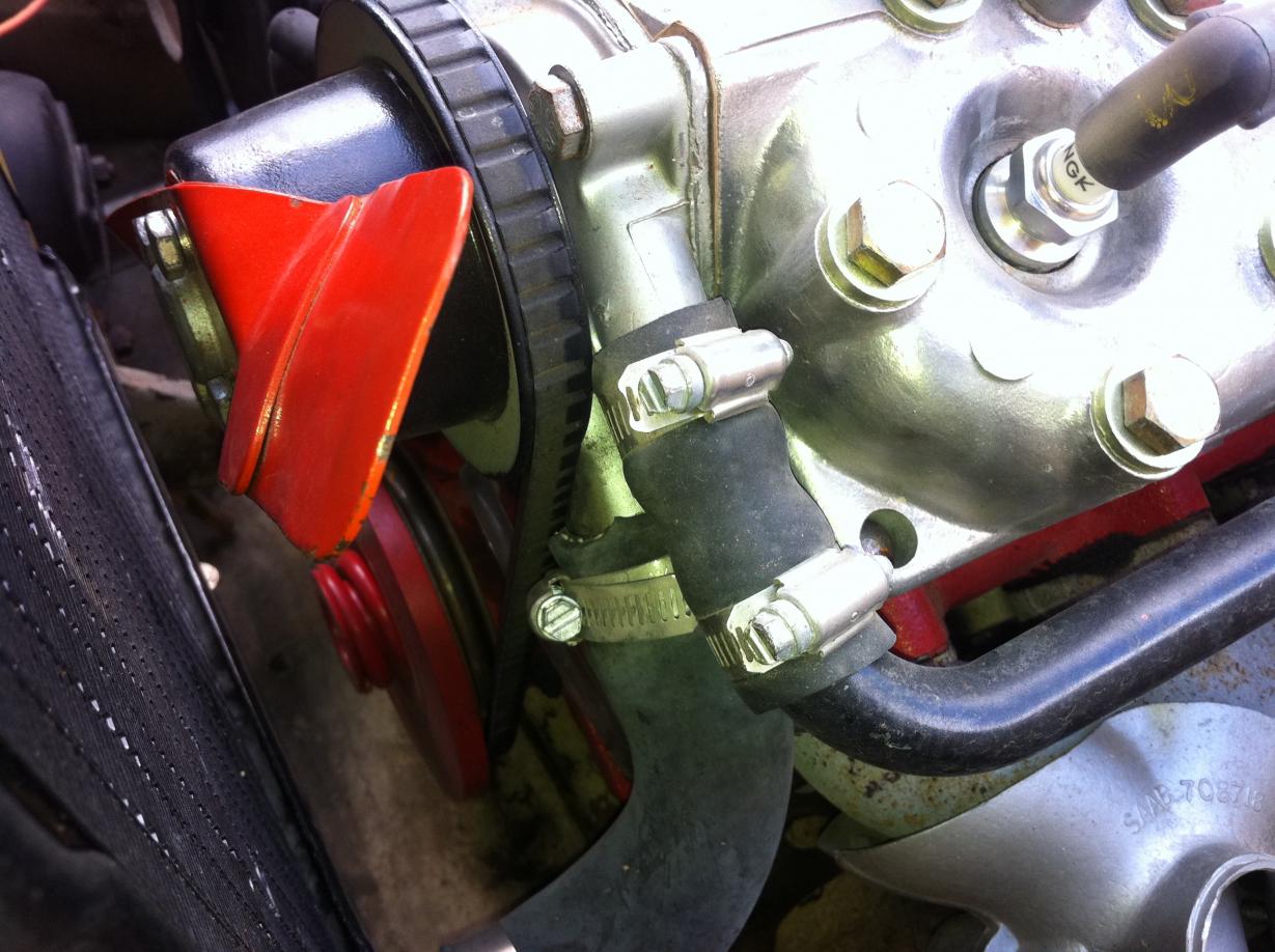

    you can see the alternator pulley cut into the hood and the timing cover peeking out in this shot. it's a real tight fit up front.

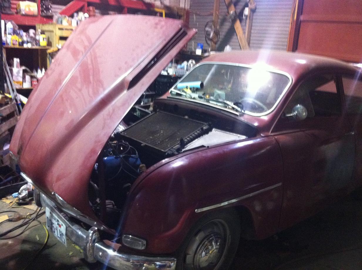

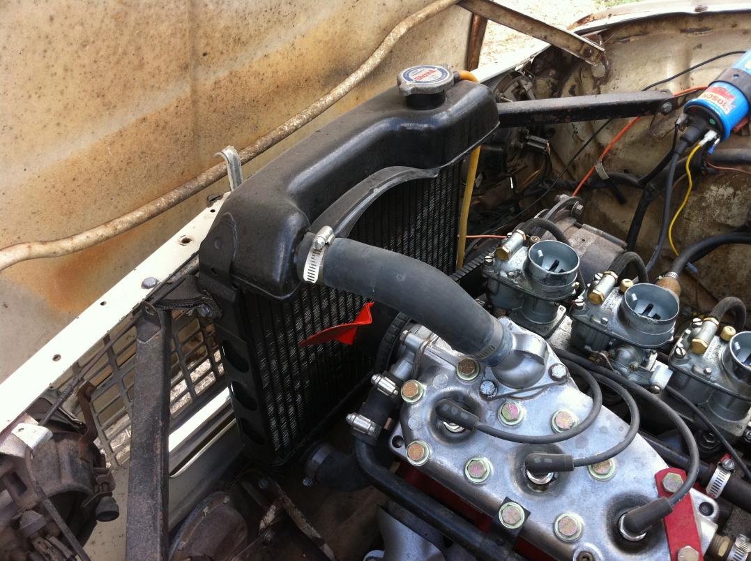

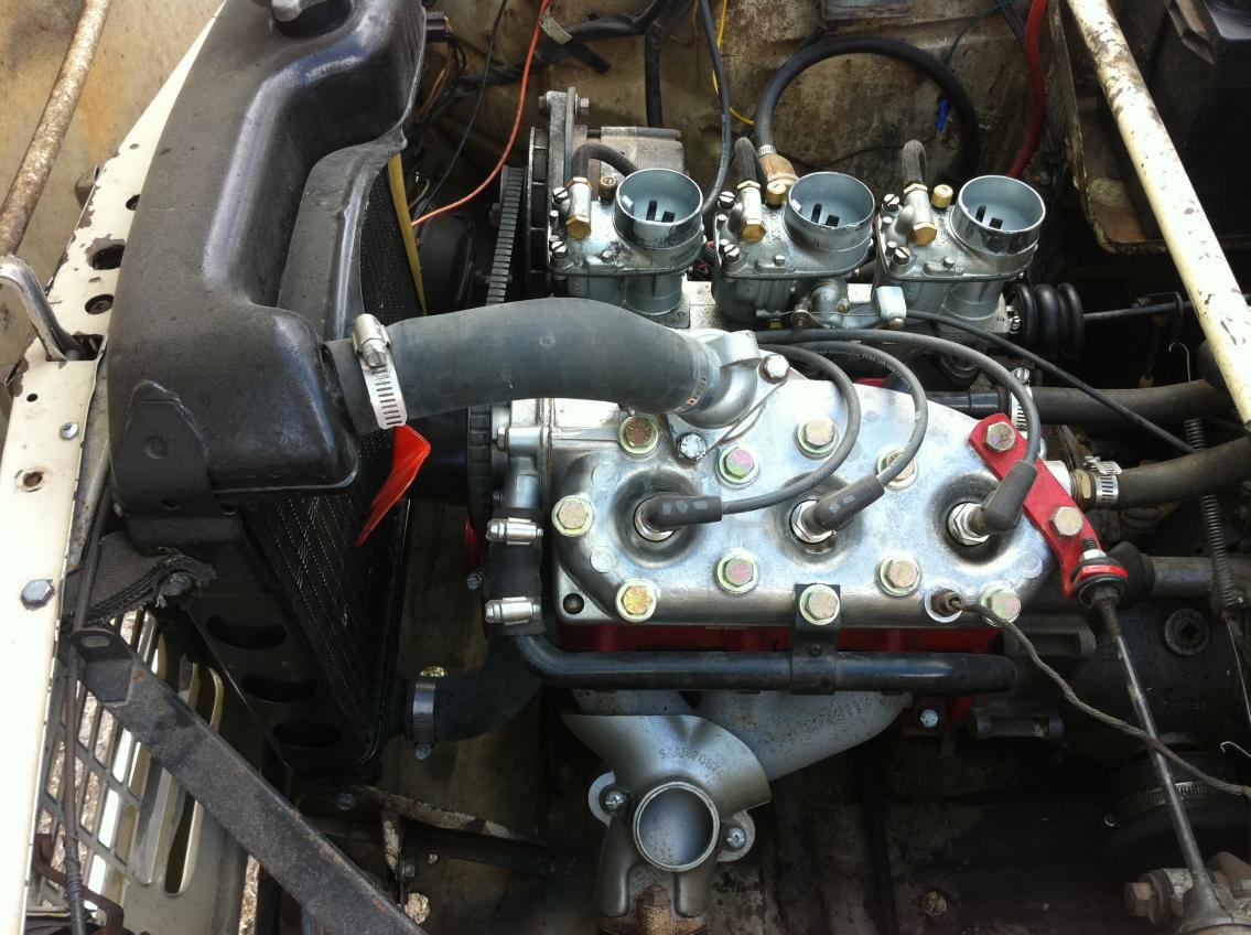

    here's the other car I'm sticking a big radiator in:

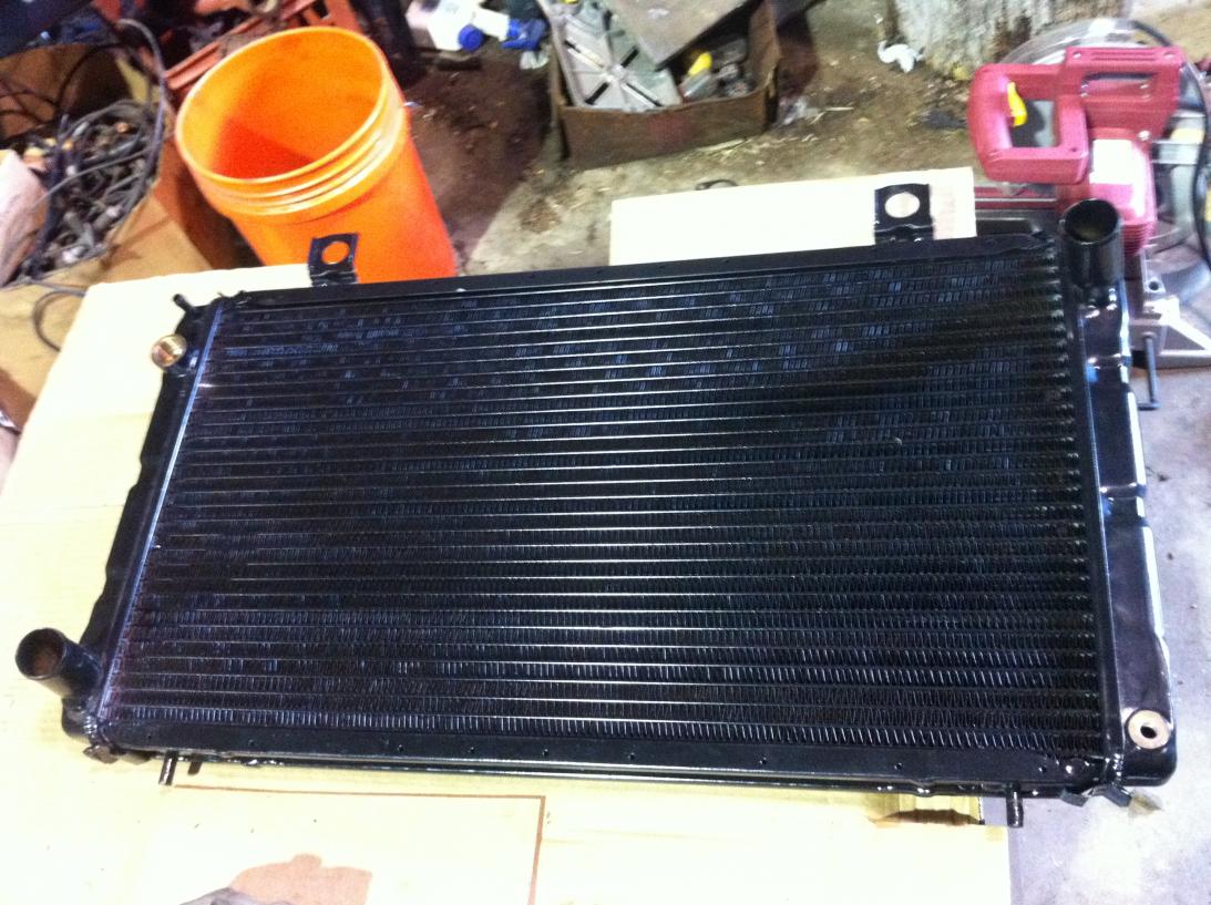

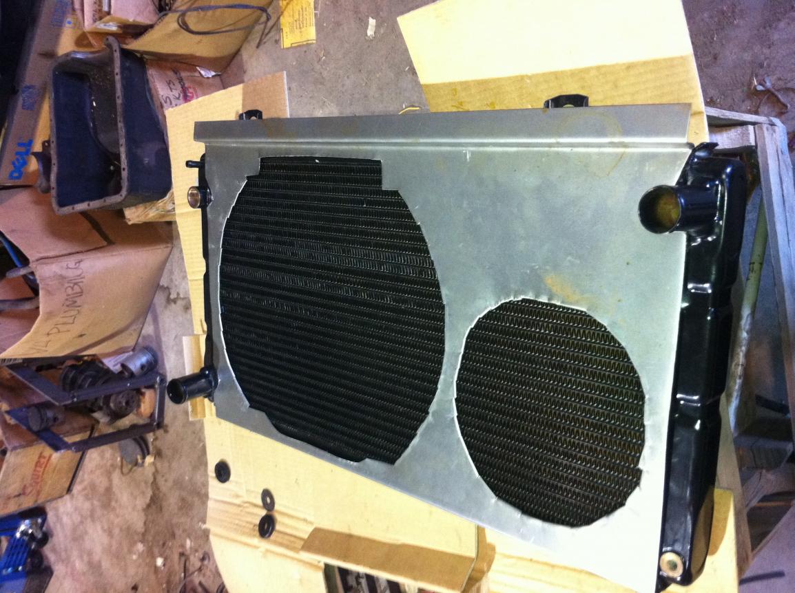

    the big radiator:

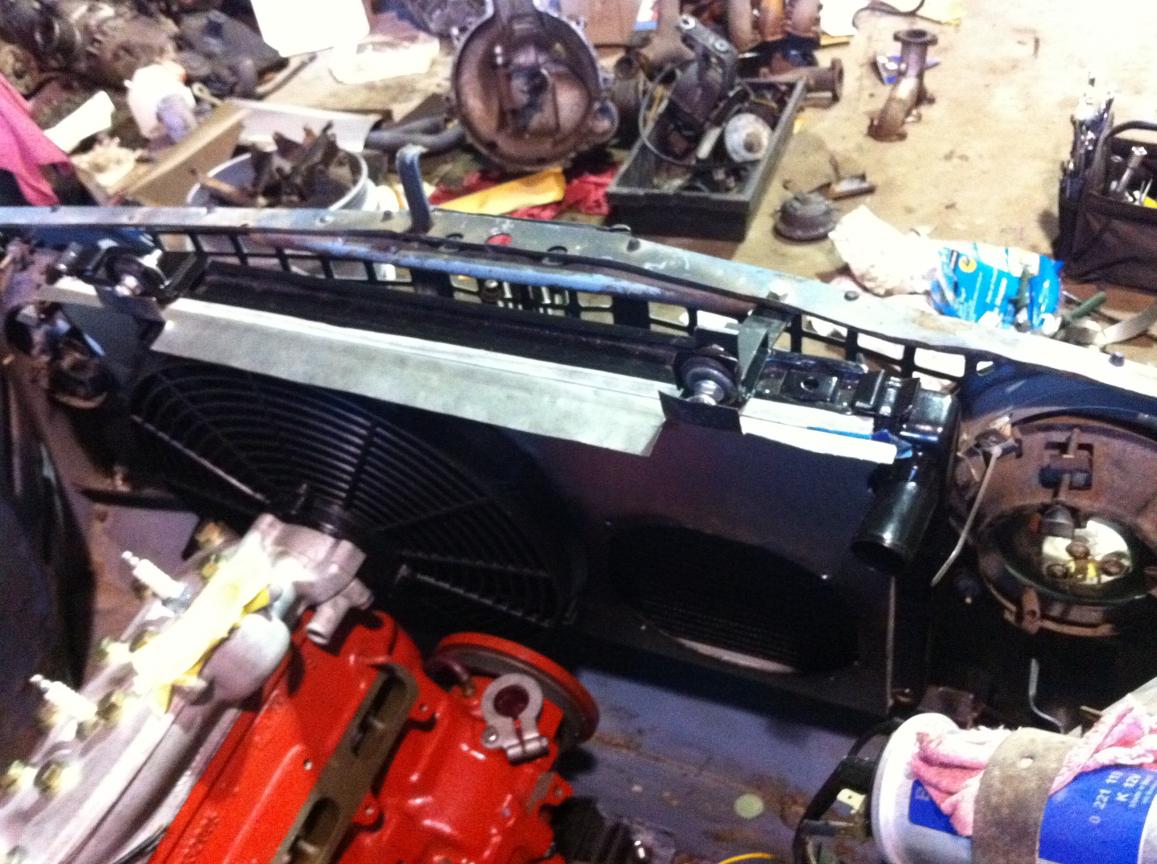

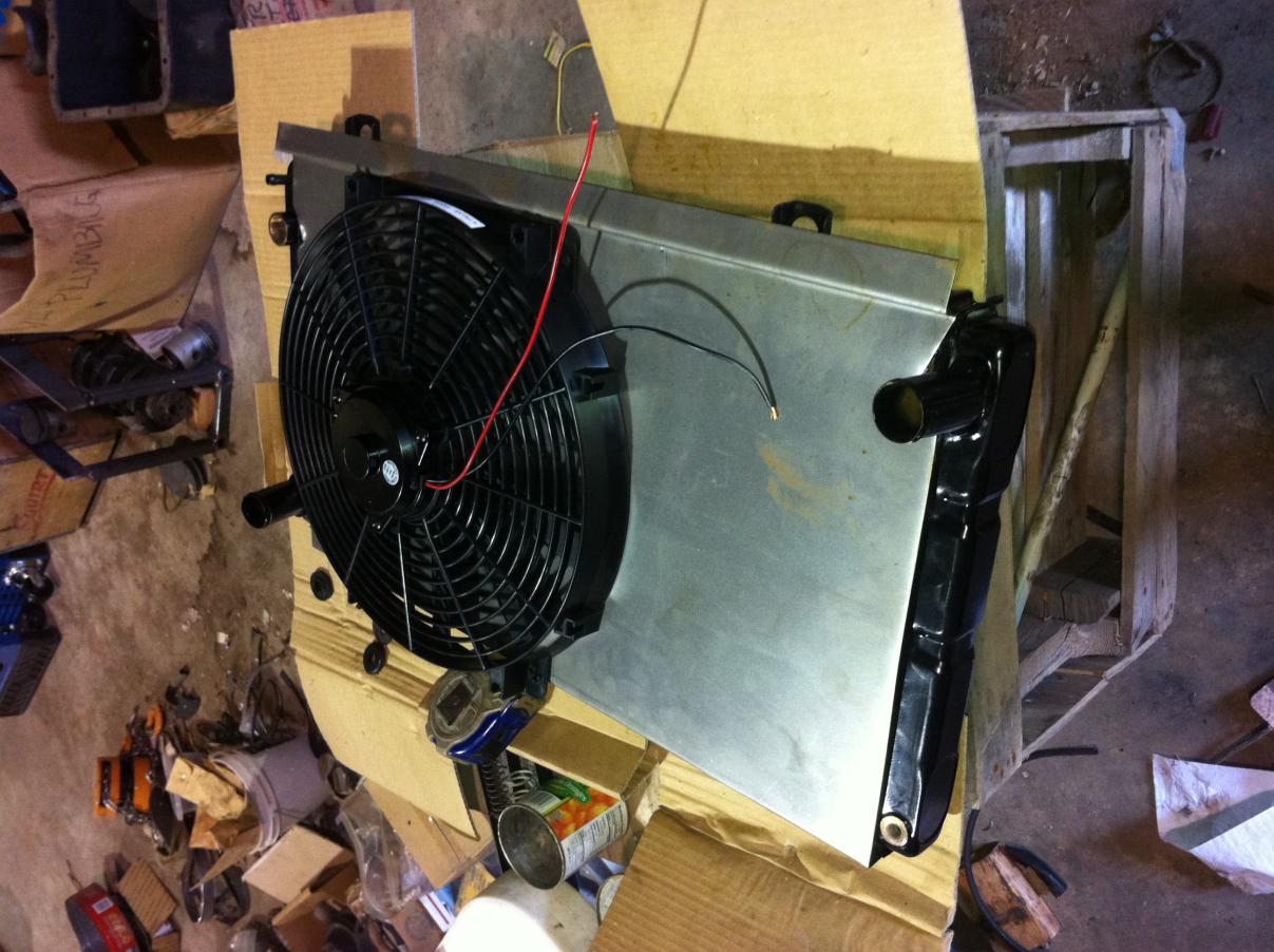

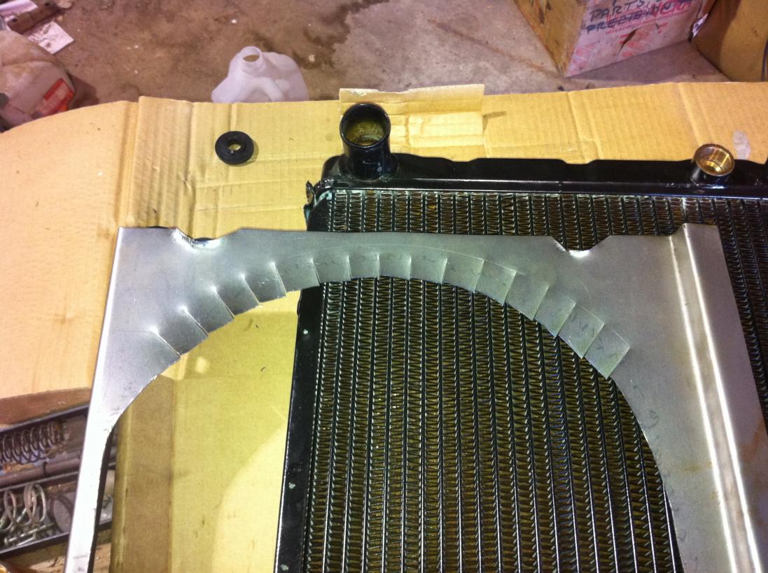

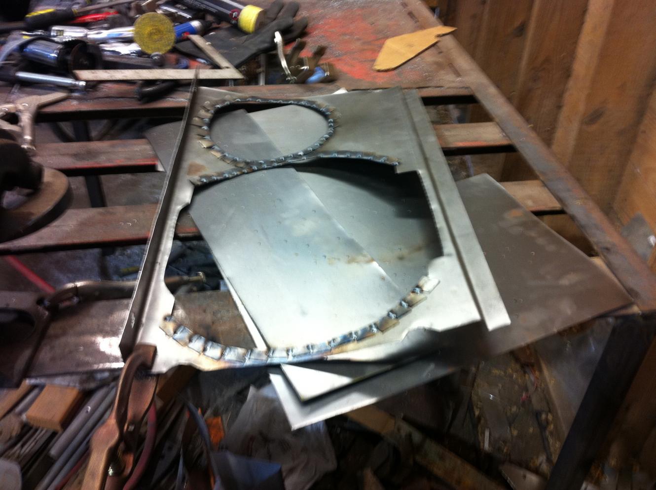

    starting the fan ducting:
ID:	3649Click image for larger version.
ID:	3648Click image for larger version.

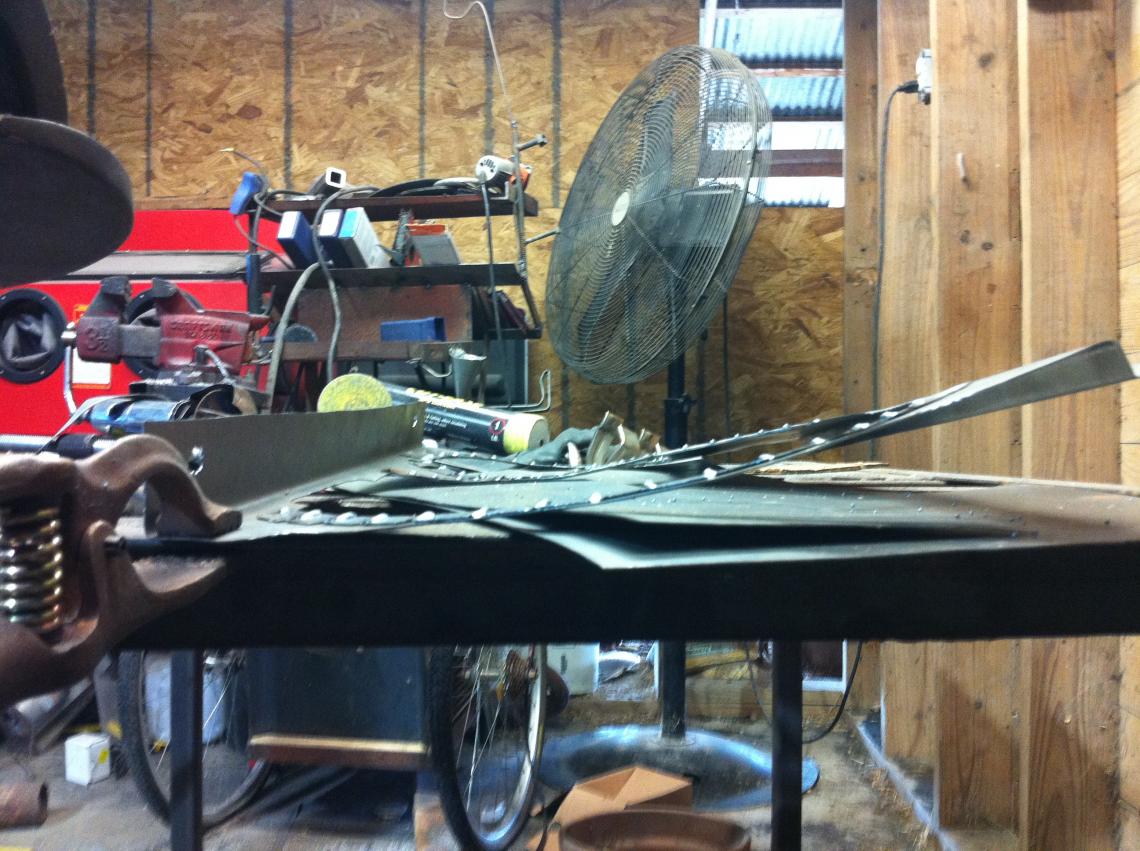

    tack welding the splits for a bit more strength(note how much it warped after welding). even just tacking those cuts brought the strength back almost to where the panel was before the holes were cut:
ID:	3651Click image for larger version.
    the radiator in the hole:

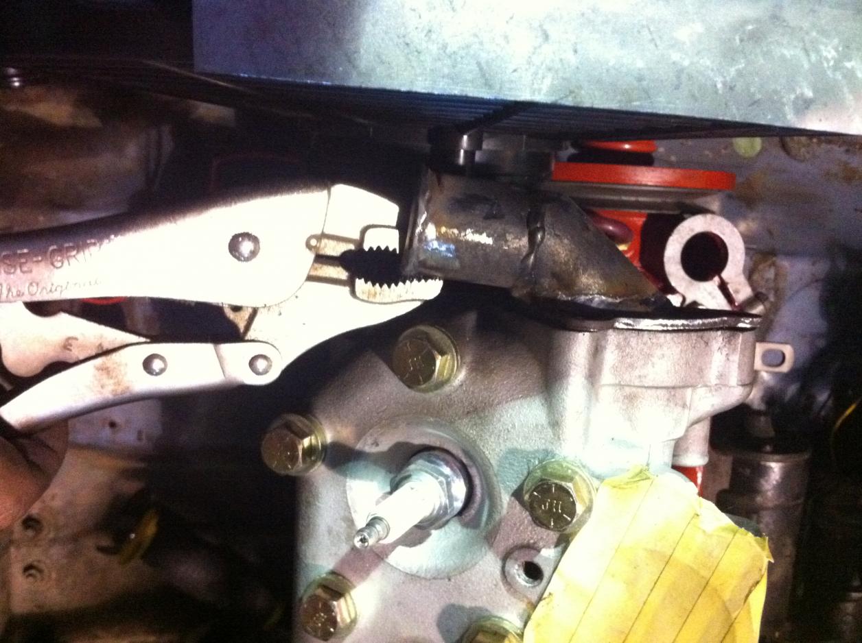

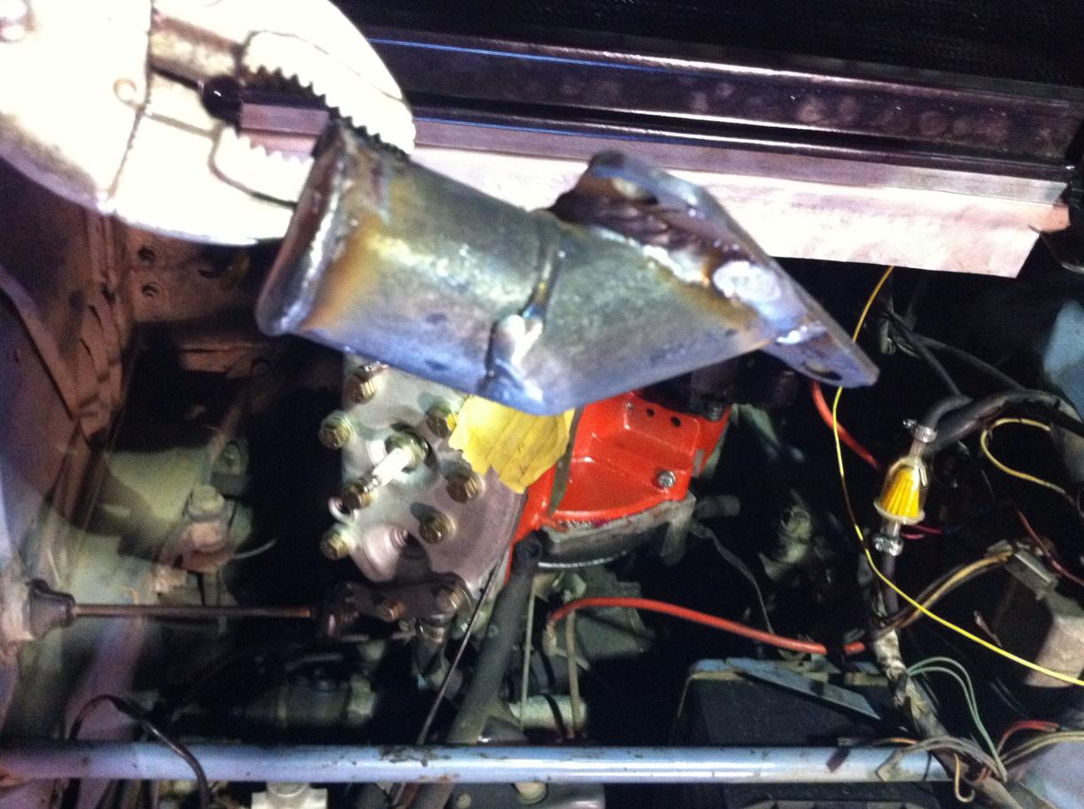

    I modifed the back plate from a water pump to make a second water neck to feed the remote electric pump:
    (more pics next post)

    water neck again:

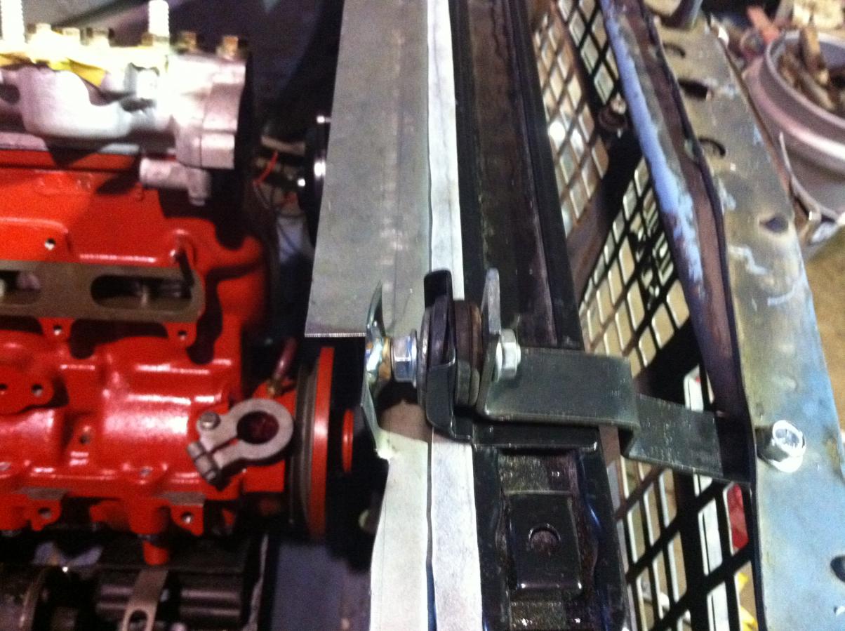

    the bracket that holds the top of the radiator to the grille. I'm going to need to weld another bracket to that one to triangulate to the inner fender. originally there were 2 angle steel brackets that did the same thing, but the corners of the radiator are in the way now, so I need to fab new ones:
    you can see that the water pump has two outlets. one feeds the bottom of the radiator, the other feeds the water inlet at the bottom of the block.

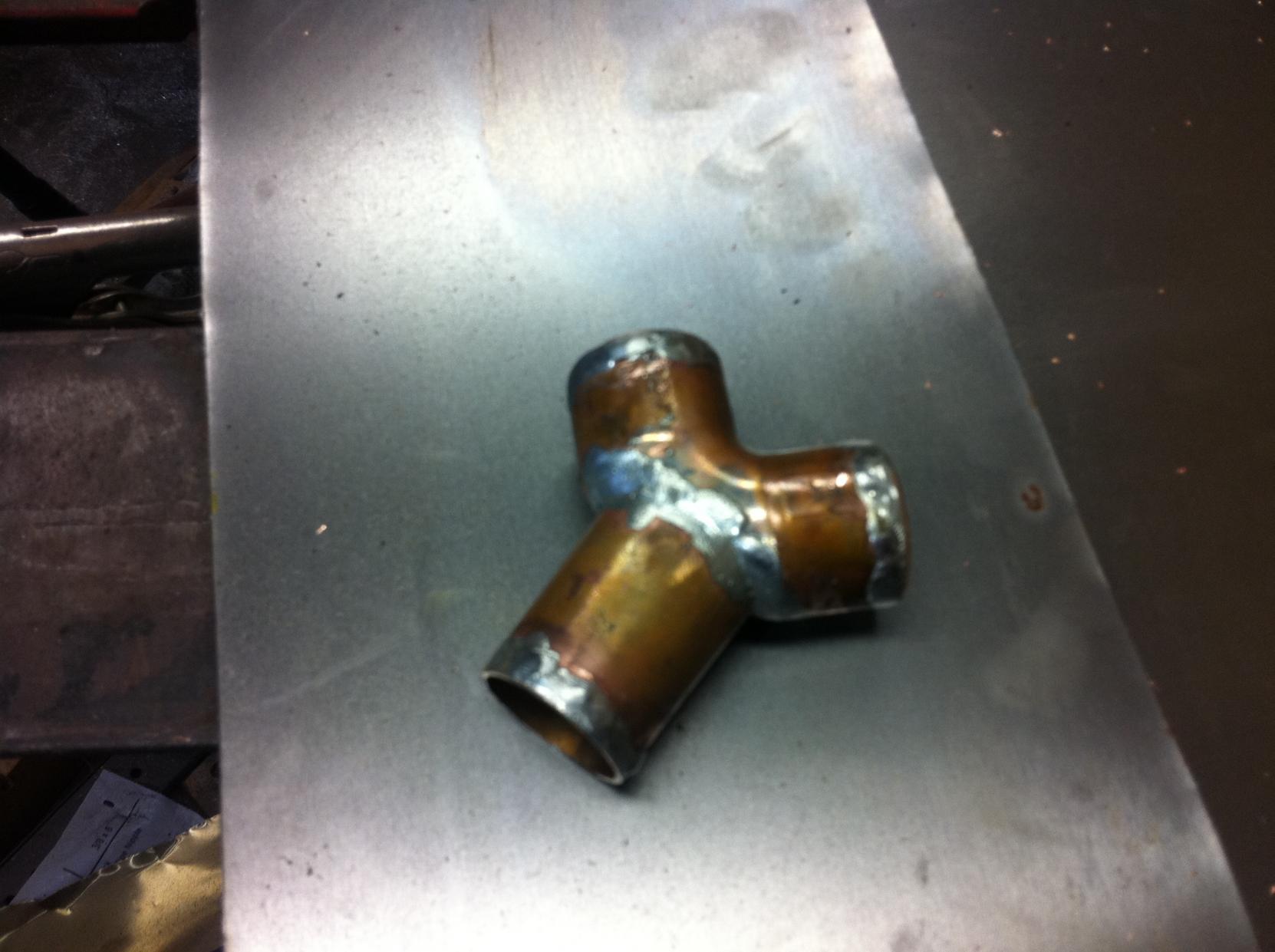

    I made this y connector to split the output from the water pump between the two inlets. it might've been moot, as I may end up running everything in dash 16 AN hose and using an -AN T fitting, but I have to run that by the boss. the fittings and hose to do that will be close to $350.
    I've started the search for molded hoses I can re purpose, I think I've found a few, but they're all $30, and we need 4, so even standard hoses are looking like $120+

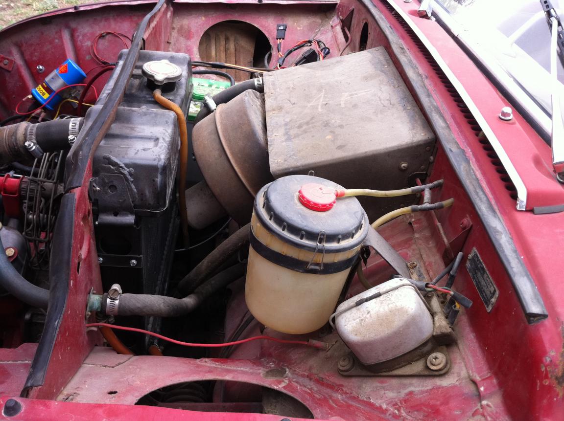

    this is a stock engine compartment:

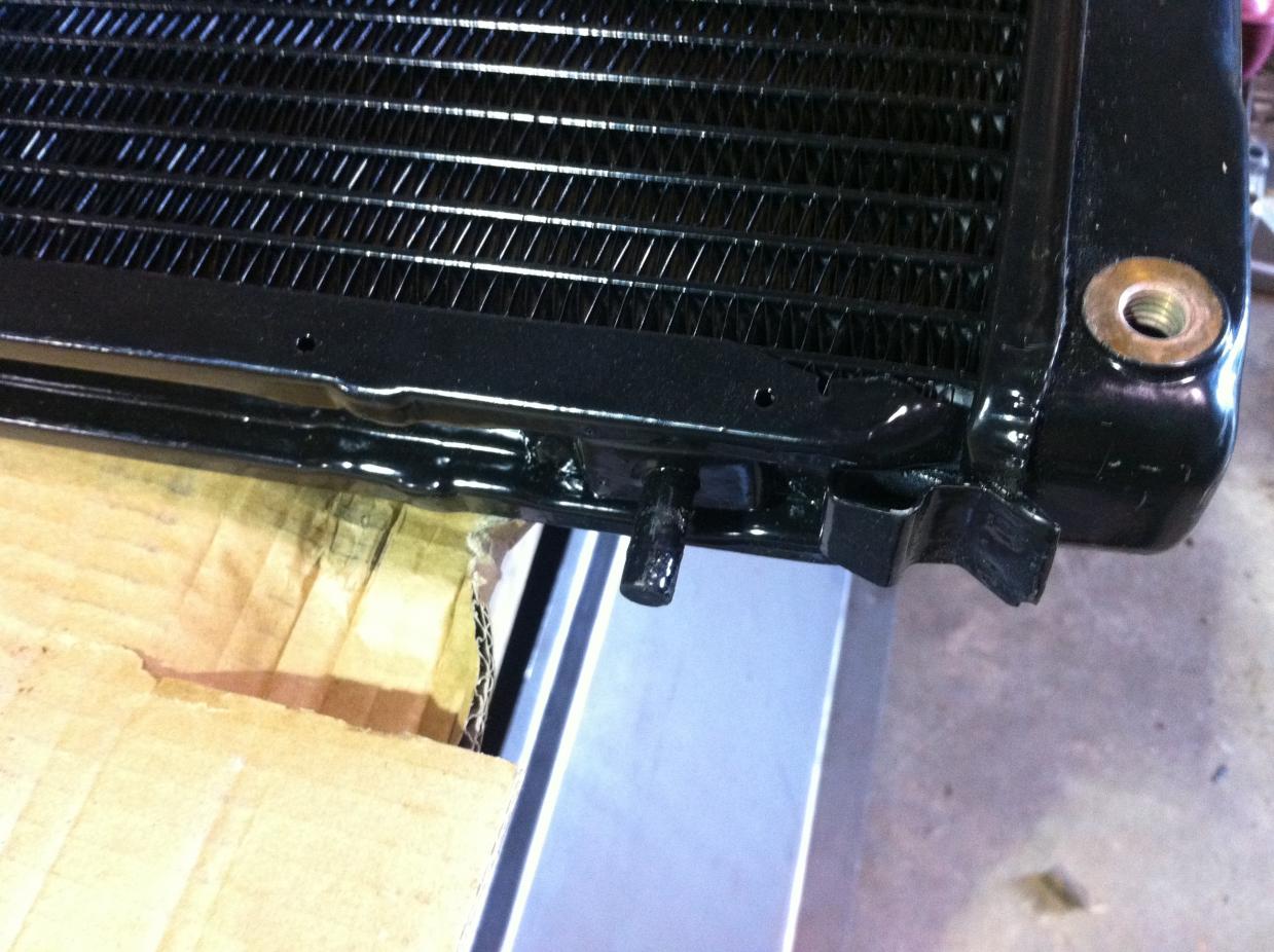

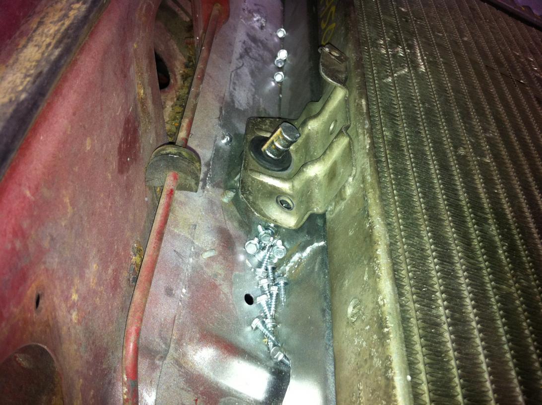

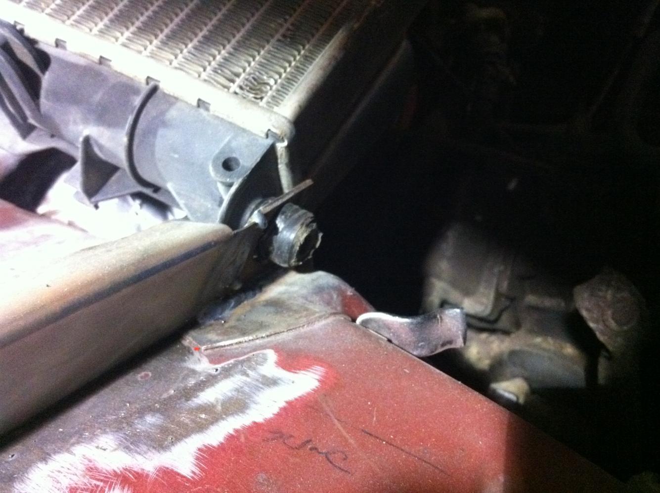

    a few pics of the other car of the radiator attachment point details. you can see the broken stud corner, the stud corner (wrapped in electrical tape for a temporary grommet), and the rebar pin up top. I might replace that with a bolt at some point.
ID:	3664Click image for larger version.
ID:	3662Click image for larger version.

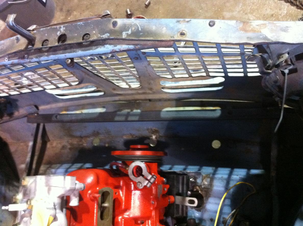

    also a better shot of the drivers side inner fender where I opened up the holes for better outflow. this is under the cover plate on the drivers side in the other photos. I still need to add a brace back across the hole:

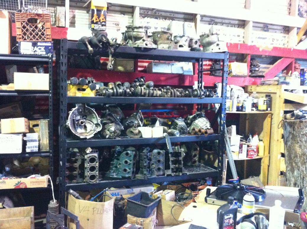

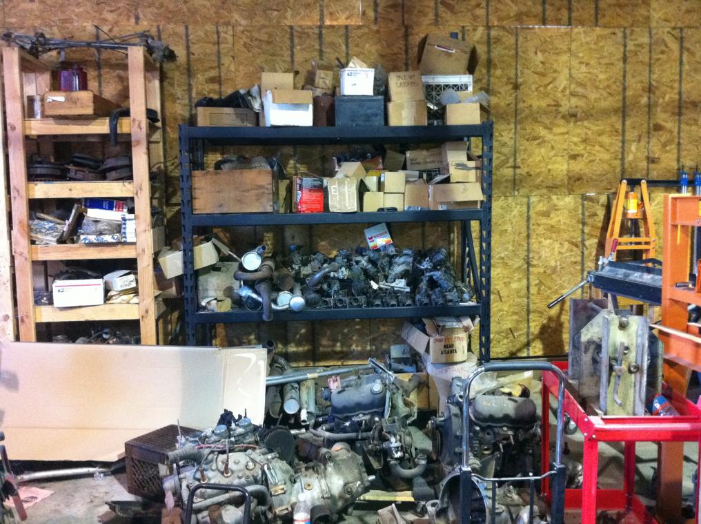

    an idea of the parts yet to be reconditioned:
ID:	3663Click image for larger version.
ID:	3665Click image for larger version.

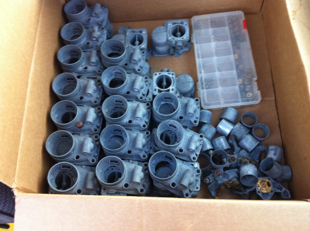

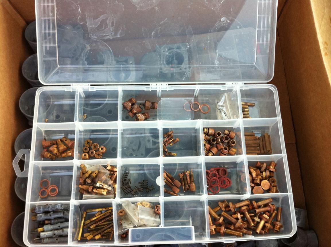

    and a pile of newly cleaned carbs awaiting new gaskets and re-assembly:
ID:	3668Click image for larger version.
