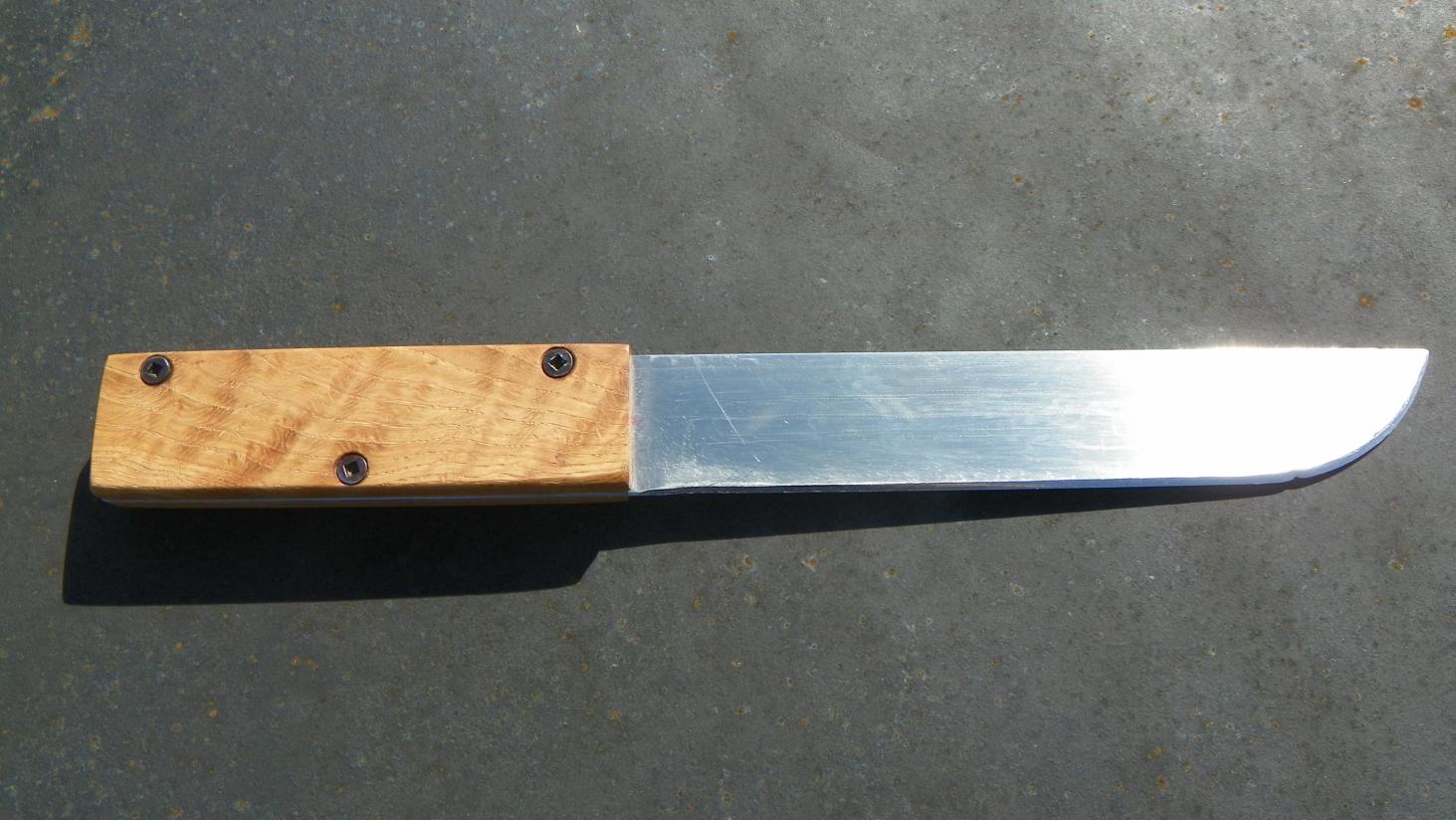

    Well here is the finished knife.

    Normally I would use dowel on the inside of the handle, but since it's just for me... Would have rounded the edges with a router too...
    I found some curly quarter sawn white oak in my mom and dad's show room.
    Yep...I just went in there, grabbed a board, chopped off a chunk, and put it back lol
    Okay...Mom was there when I picked it out...

    In my opinion ya need to grind down the curve further to get more of a point cause using it for field dressing poking through the hide and anything really ya need a good sharp pointy tip on it.

    What did you use to sharpen the knife? Do you have a belt grinder.
