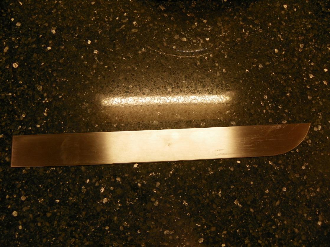

    Well I'm working on a deer field dressing knife...

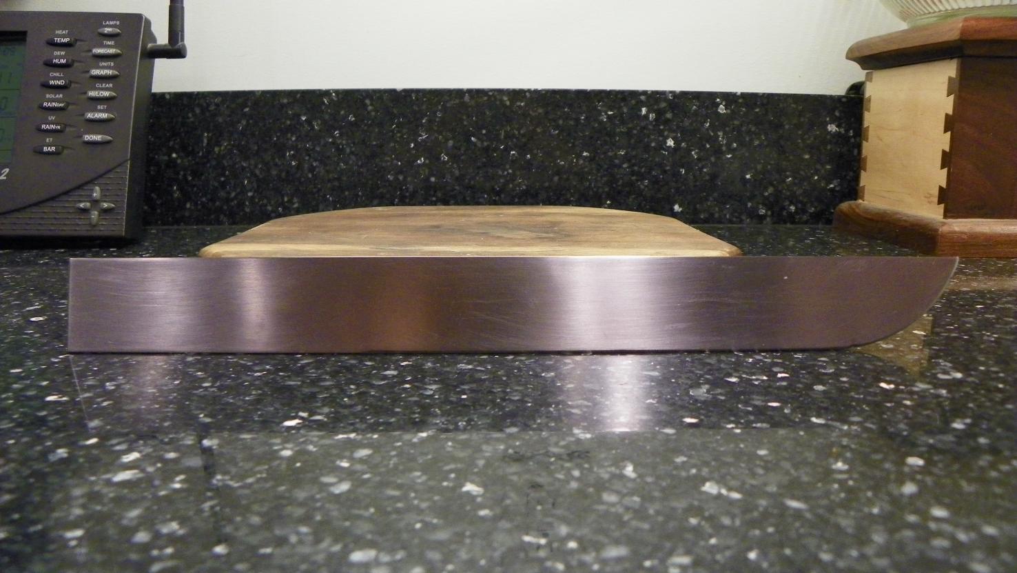

    The knife is stainless steel 1/16" thick 12" long and 1.25" wide.
    Not done yet... I still have to make a wooden handle and sharpen it...
    Will post more pictures later...
    Using this as my fifth project.
    Benjamin

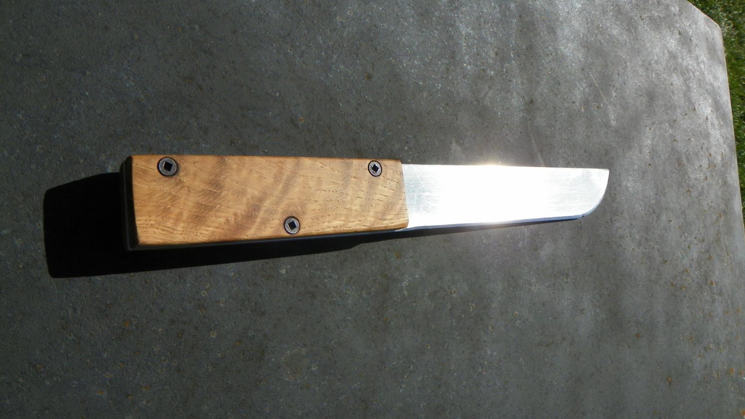

    Pictures 1 and 3 appear identical, picture 2 looks like the handle tapers more than 1 and 3. Is that a different knife, or is it a trick of the photo?
    alll three pics have the same nick in the blade, so I'd presume it's the same knife. what'd you use for steel stock and are you planning on hardening it? I've been curious about knifebuilding for a while, but I haven't actually done any yet. well, apart from the time a friend and I forged a sword out some flat stock on his great-grandpa's portable coal forge. good times.

    12" seems kind of long for field dressing - I like a short blade some where about 3" - 4" for working in tight spaces. Plus it folds up and is easy to fit in my pack

    That looks like a pretty nice start. What alloy of stainless is it?

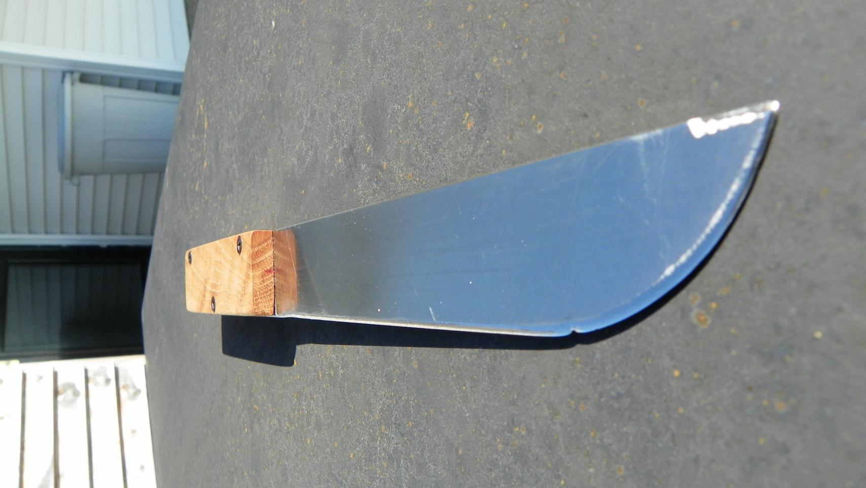

    In my opinion ya need to grind down the curve further to get more of a point cause using it for field dressing poking through the hide and anything really ya need a good sharp pointy tip on it.
    They are all the same knife... It's the way I took the picture. I hade to take the pictures at an angle because it's so shiny that it hives it that brownish look in the pic...
    Haha gotta love the good old times... Like it says in the first post 1.25" wide, 12" long, and 1/16" thick. I had it sheared at storm steel...It's 304 grade because they don't have 316. No I'm not going to harden it...But if I was how would you do that? Never done research on it...
    Yeah it might be...But if it is we have a Super Cut 50 so no problem lol. Gotta start long and shorten because it's really hard to put back on
    304 Stainless
    Maybe I should sharpen the back side too.

    I was going to say that is awful long!!!! Will it be strong enough since it's 304? I would think you need to harden it somehow?
    I built two throwing knives awhile back, but I guess I didn't think about trying to harden it...They both bent so I gave up on them after bending them back every 2-5 throws.
    I missed that it was stainless until after welderdude asked what series it was. unfortunately, you can't really harden 300 series stainless. marstenic stainless can be hardened, though. wikipedia lists 17-4ph as an option, but my guess is that it's going to be incredibly expensive.
    I was looking at using o-1 oil hardening tool steel blanks the last time I looked at making a knife. I didn't pull the trigger on that project, so I can't tell you how it worked out. I'd be inclined to go tool steel for any knife, but having used a set of (nice quality) stainless kitchen knives, I personally think they're about useless.
    Throwing knives are a lot of fun! I should make a couple of them to keep the squirrels in check. now that it's finally rained, they're everywhere.

    pretty much any 300 series stainless steel alloy is useless for a knife blade. Even 17-4 ph wont get hard enough to keep a nice sharp edge at a max HRC of 45. 17-7 ph would be a little bit better, it will get up to HRC 49. A good alloy would be something like 440C or 420HC or even S30V if you can afford it. Here is a good website with a bunch of different alloys listed.

    Just a note, not trying to take anything away from your project, but you're not going to have much luck hardening or heat treating it...
    300 series stainless can only be work-hardened, same with half the 400 series, the ferritic (can't remember all the numbers off the top of my head). The Martensitic 400's can be heat treated.
    That said, I've always preferred non-stainless blades, much easier to get the qualities that make a good knife out of them, and if you play the heat game right, you can get them to hold an edge for quite some time.
