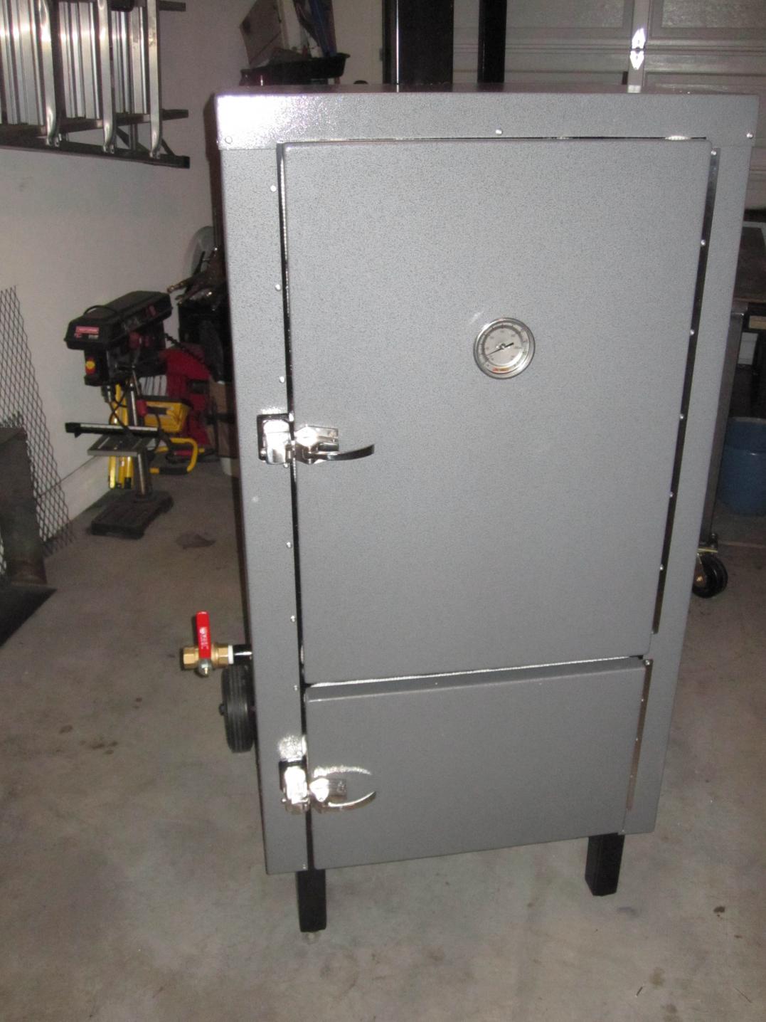

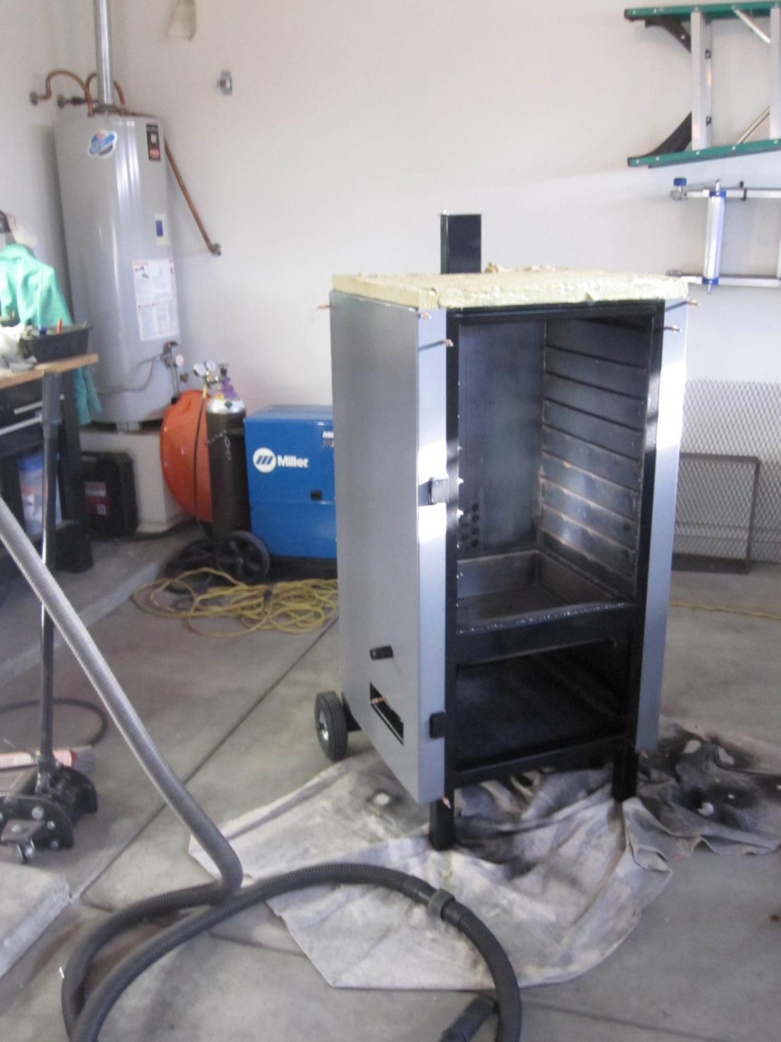

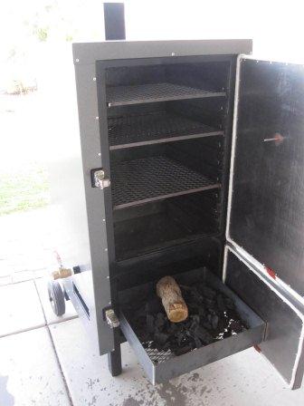

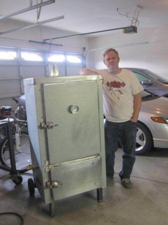

    I started an insulated smoker project last year. This thing is a vertical smoker with the fire in the bottom and cooking chamber in the top, it looks like one of the fridges with the freezer in the bottom. The only thing different from the freezer type design is I put the fire in the bottom and the heat raises up inner walls holding the cooking grates and smoke pores over the top of the inner walls to flavor the meat. Smoke drops to the bottom of the cooking chamber and exits up a chimney that starts at the bottom of the cooking chamber. The smoker a 20 inch wide by 20 inch deep by 30 inch tall cooking chamber that will fit up to 8 cooking grates.

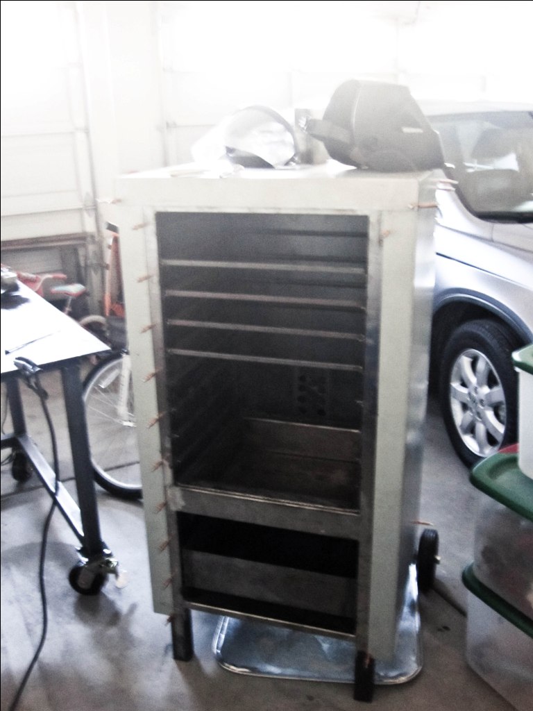

    The internal frame was fabricated out of 1 inch tubing and 2 by 1 inch 16 gauge tubing. The walls are 14 and 18 gage material as it is what I had available at the time. I had to seam weld all of the sheet metal on 5 sided to make a leak proof smoker.

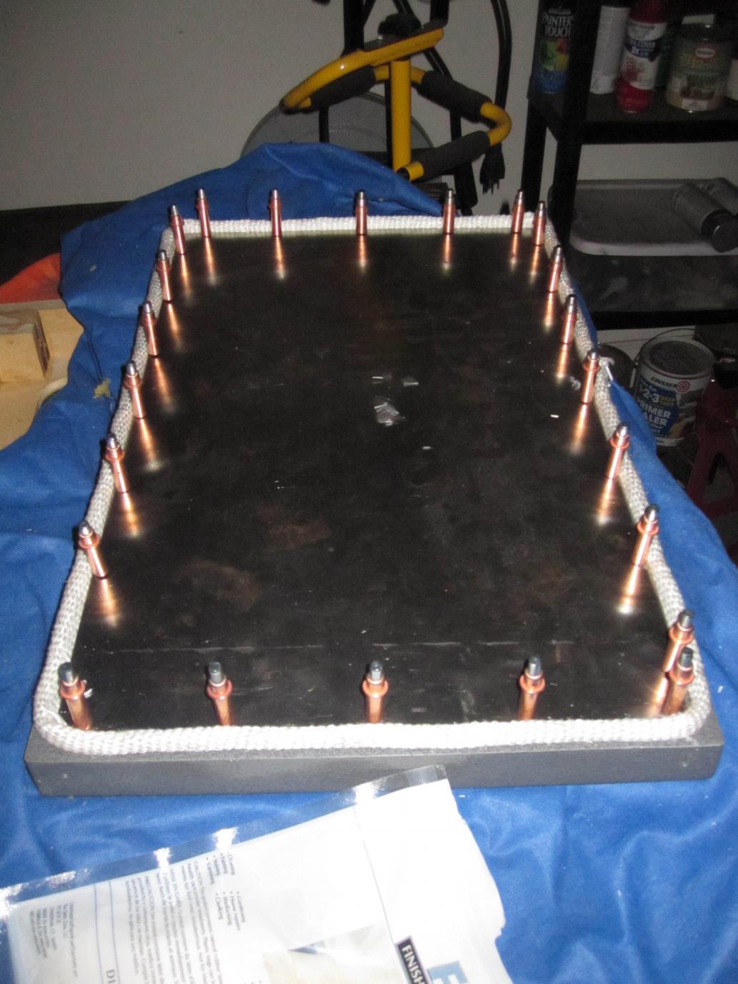

    The doors are fabricated out of 16 gauge sheet and have used tadpool fiberglass gaskets for the seals. I used stainless steel piano hinges and purchased some spring loaded push to close freezer latche (the coolest addition to the prject).
    Between the cooking chamber and the fire pit I have welded in a water pan fabricated out of 11 gauge steel that holds about 5-6 gallons of water and water is drained out of a 1 inch ball valve on the side of the smoker.

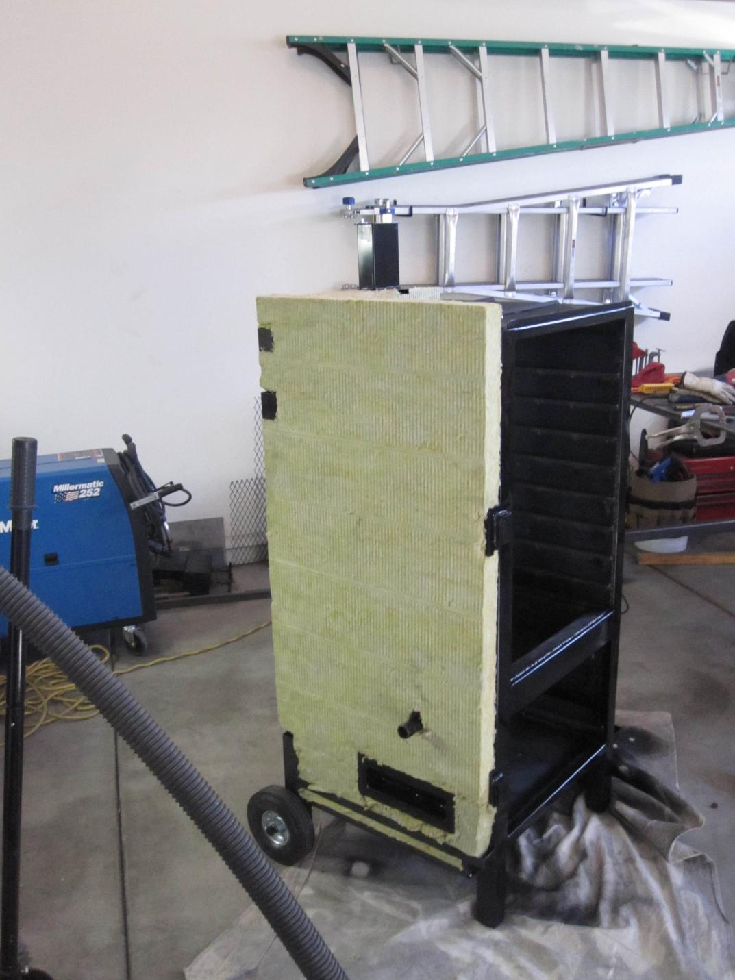

    The smoker has two inches of insulation and 16 gauge sheet metal cover on the outside. The outside sheet metal was powered coated and the outside of the smoker was painted with BBQ paint to protect from rust.
    This project took about 150 hours to build but well worth the experience and the smoked food is always appreciated by my family and friends.

    Really nice smoker.
    What did you use for insulation?
    Just starting in Aug '10
    Hobart Handler 187
    Oct 2011
    Litchfield Park, AZ
    370
    I used mineral wool insulation; it is good for 1200° F and I spent about $40 dollars for five 2X4 foot 2 inch thick sheets. The insulation is common in industrial applications and can be found at any industrial insulation supply location.
    Miller 252
    PowerTig 250 EXT
    I used the pink stuff from home depot when I built my powder coating oven. No problems with it and I run near 420 degrees for some powders. I think smoking you would run maybe 250 degrees so the pink stuff should work fine there too. Just remove the paper backing.

    My brother uses one of the Wal-Mart propane smokers and has good success. I am sure if you were to add insulation you would be required to cut back on the gas flow to control the temperature as there is a lot of heat loss from the outside surface. My first smoker was an insulated smoker with one 22.5 inch diameter (397 in2) cooking grate and my new insulated smoker has eight 20 inch square cooking grates (3200 in2). The non-insulated cooker went through about 1 lb of charcoal per hour where my new smoker is at about 0.5 lb per hour.
    Before insulation the first thing to look at air leaks (more critical on non-propane smokers). After the leaks are under control insulation will always help. To insulate the smoker you can have a sheet metal shop bend up some 24 gauge sheet metal to cover the outside of the insulation. There are many types of insulation to use but mineral wool is stiff and will stand up on its own and has very good thermal protection properties to boot. The pink insulation would work on most smokers because the temperatures are relatively low. Fire box chambers can get an upwards of 500°F but it all depends on the design of the smoker and the proximity of the fire to the walls of the fire box.
