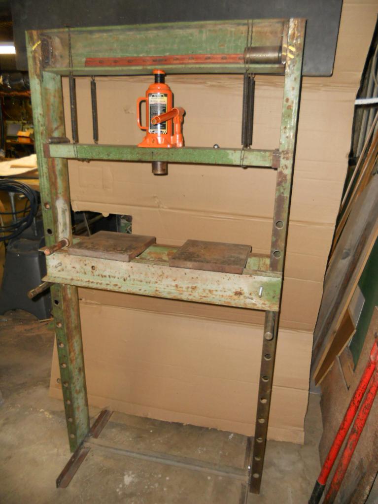

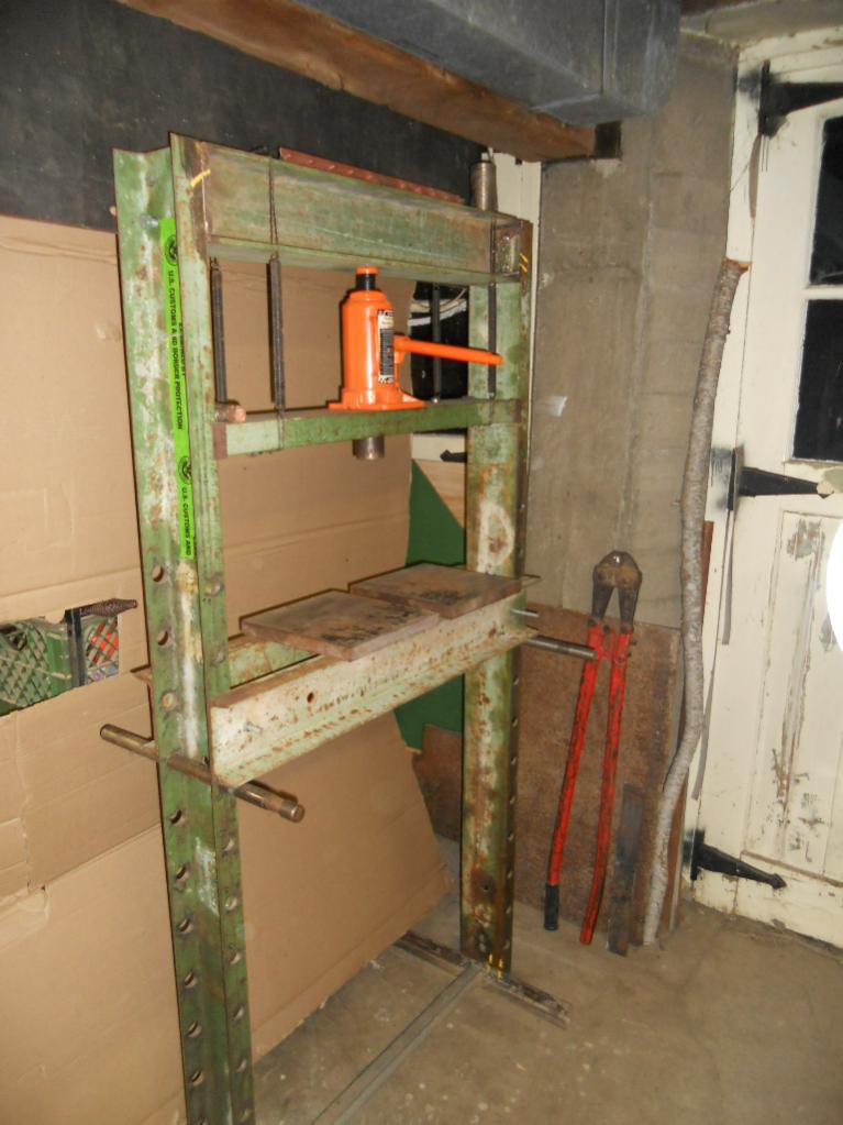

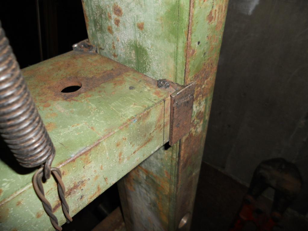

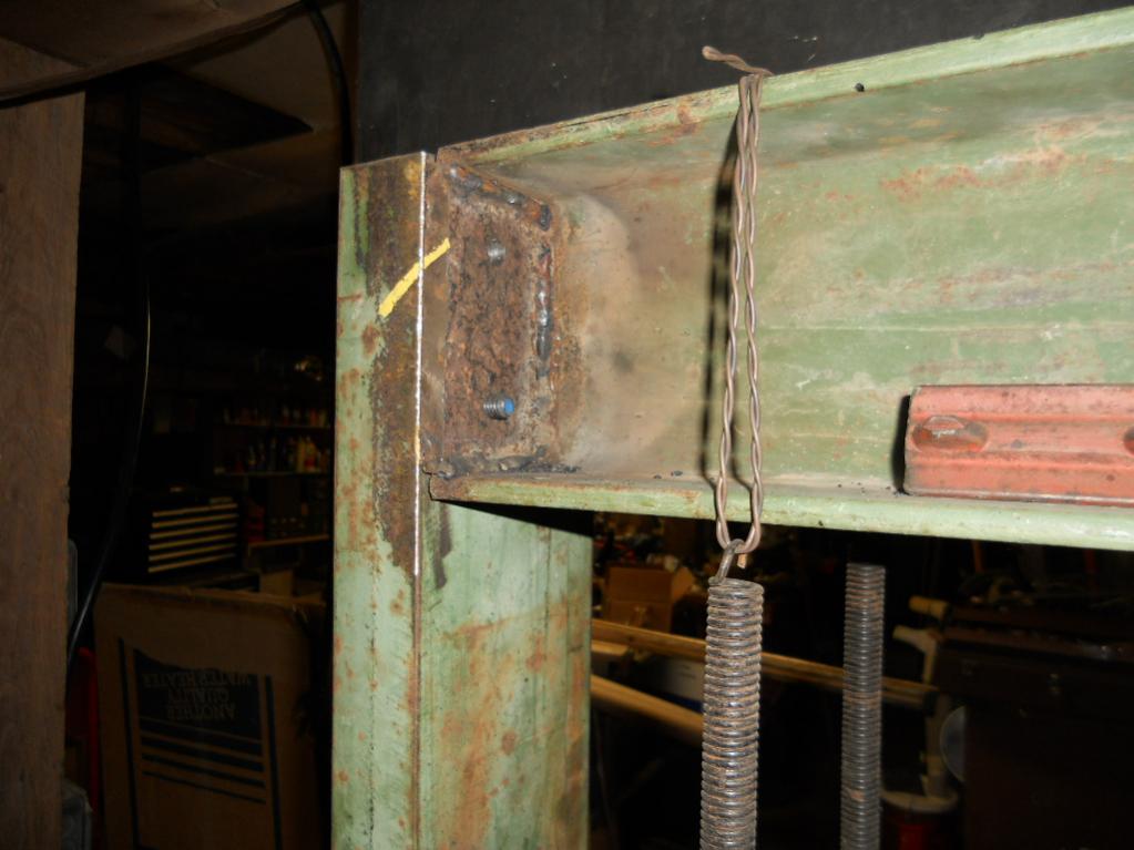

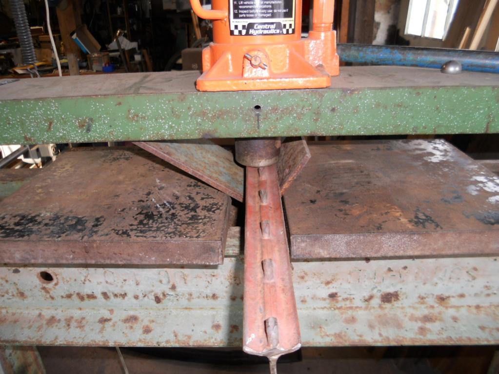

    This is a shop press I built a couple of years ago. The outfit I worked for long ago during my life as an air compressor mechanic had one, and it didn't look too hard to build, so I figured why not. I acquired and cut the steel quite a long time ago and finally got it together after getting the HF 3-in-1 to drill all the holes.
    The overall height is 6ft with a bed width of 32in. The I beam is 5 x 5 x 5/16 and all channel is 1 3/4 x 5 x 3/16.
    Everything except the jack and grade 8 bolts was scrounged or gifted so total cot was around $20. I don't remember how much time it took, other than that it was way too long.
ID:	3300 Click image for larger version.

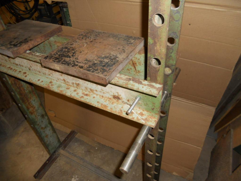

    Details of the top attachment, guides and table.

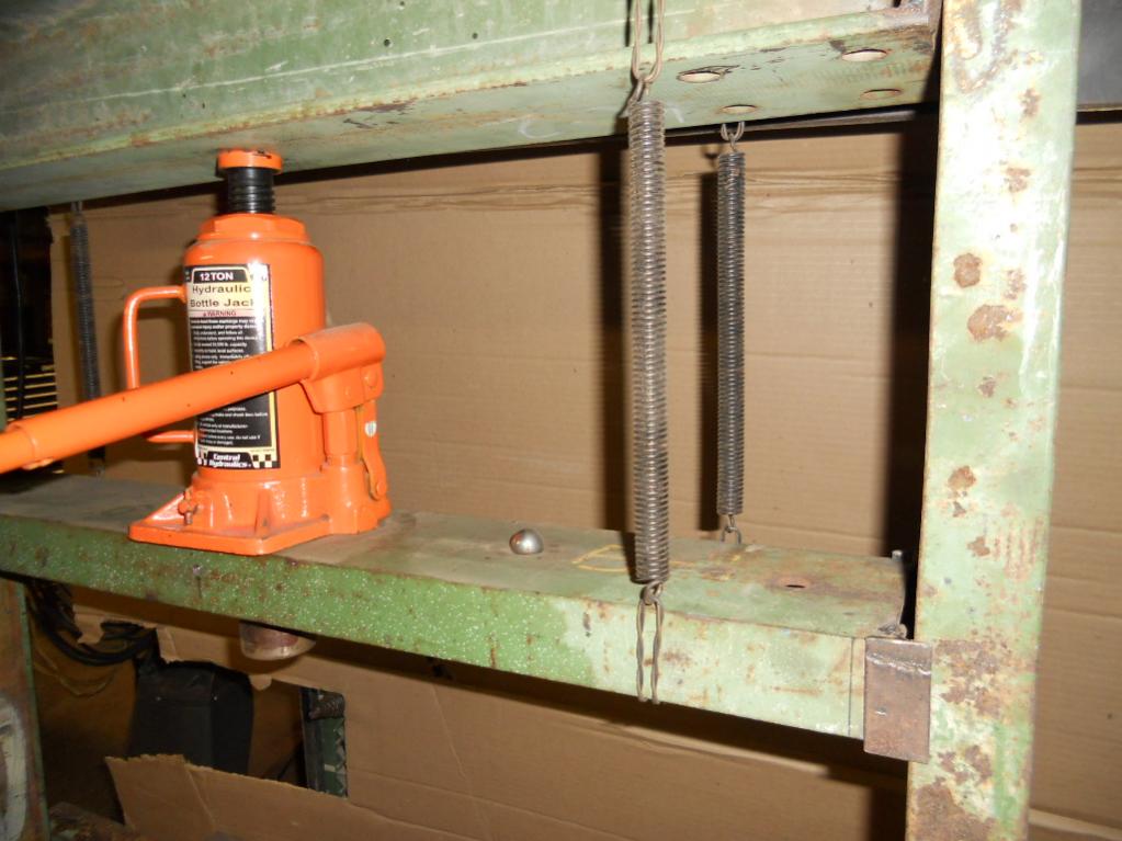

    The HF 12 ton jack (I was too cheap to spring for a bigger one) also doubles as the ram for my cherry picker.

    Improvements for when I finally get that elusive "round tuit":
    Tap the die holder for a setscrew
    Drill, tap and install 1/2 grade 8s for top beam.
    Install real hooks for springs.
    Prep and paint (ha ha ha).

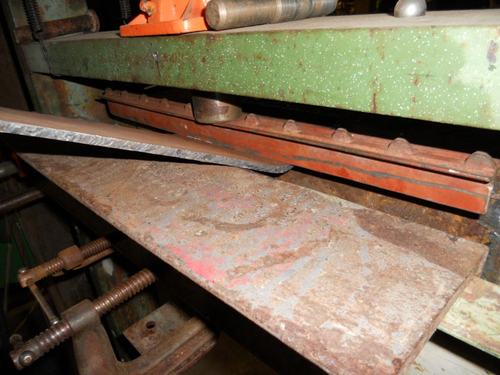

    Oh, and I almost forgot, it bends 4" worth of 1/4 without breaking a sweat.

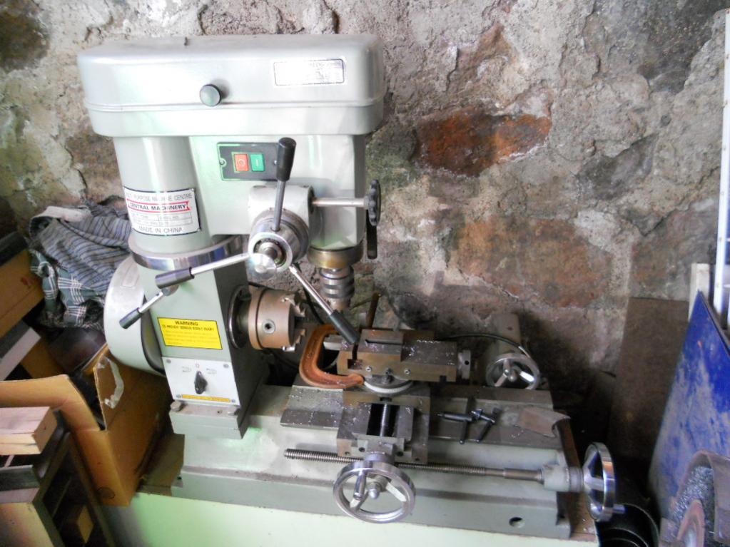

    What type 3-in-1, the multi-purpose machine? If so figure you got $300 back on that investment.
    And here I was kicking myself because I hardly ever use it. It is a now discontinued HF T5980 mill/drill/lathe from 4-5 yrs ago. About 600 if I remember correctly plus another 150 or so accessorizing at Enco. Still haven't gotten around to teaching myself basic machining yet, so it sits forlorn in the corner waiting for me to build it a bench.

    Was wondering if you might toss up a pic of the setup you used for bending that 1/4"?

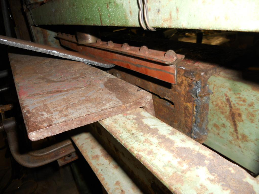

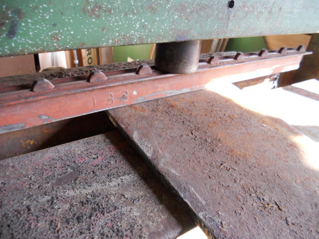

    Sorry I just came back to this thread to look up that handy chart and noticed that I was remiss in responding, I hadn't yet discovered the subscription function when I first posted I guess.

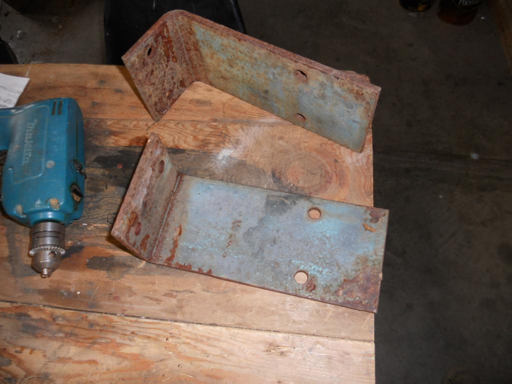

    Anyway, I wound up doing a couple different setups for the different sizes I've done so far. The latest one for longer stock looks like this:
ID:	3979 Click image for larger version.
ID:	3977 Click image for larger version.
ID:	3978 Click image for larger version.
ID:	3976 Click image for larger version.
    I just used a couple pieces of stout angle clamped to the channel with spacers for the bottom, and a piece of T-post with the center nubbin ground off as the top die. It held up well for the 4" bends, but it did bend a bit when I went for 8".
    Although I didn't notice any signs of bending, if I was going for anything bigger, I would probably take the precaution of running a piece of allthread through the table to keep the channel from splaying.

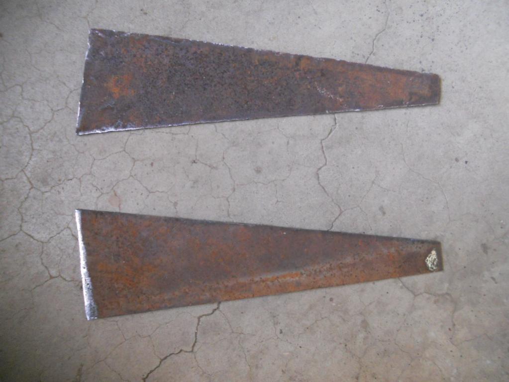

    This is a recreation of the original setup I used for the shorter brackets, a bit simpler just using the plates with spacers on the sides (not the one in the picture obviously) to fill in the space to the legs. If I remember correctly, I used pipe clamps to hold the legs together just for safety's sake.
