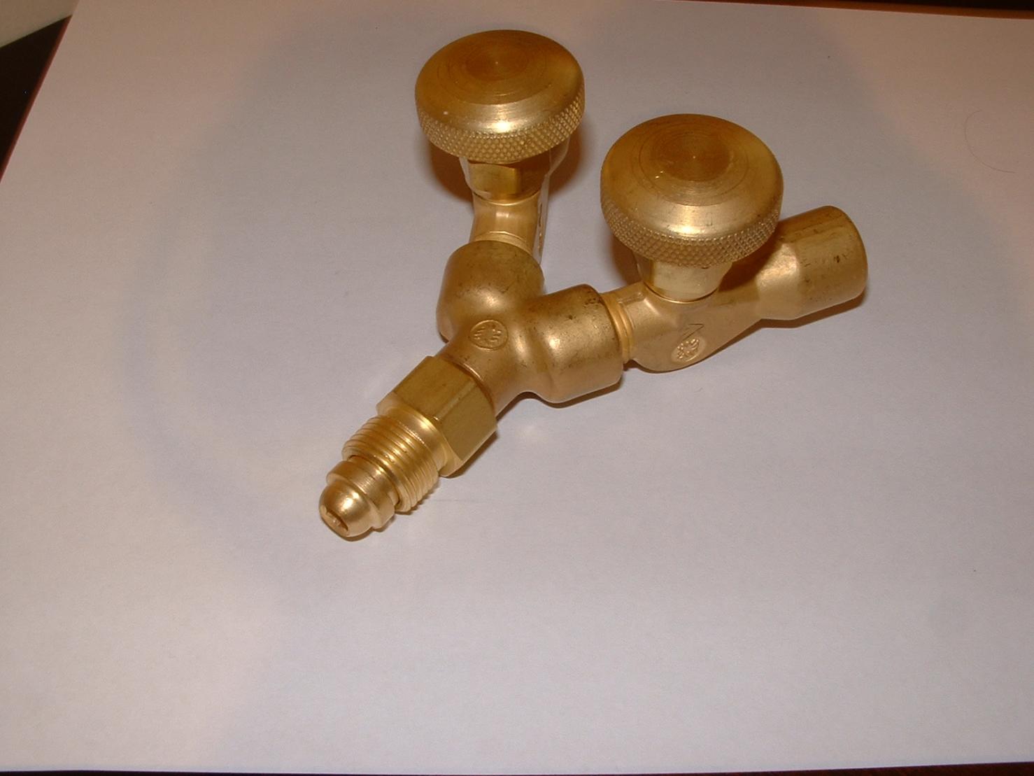

    Here I put a 1/4" NPT quick-connect that is normally used for compressed air.
    Then I created an adapter from by B-size to 1/4" hose barb/nipple to 1/4" NPT. I used normal plumbing soldering flux and solder to attach a 1/4" NPT female coupler to the hose connection that came with my argon regulator. This allows me to attach a quick-connect compressed air style hose to the argon bottle and connect it to the regulator on the back of the welder. I can set the pressure to 65 psi with compressed air attached for plasma cutting. Then I can quickly switch from compressed air to argon.

    Finally, you can purchase quick release fittings for gas that are standard inert threads for coupling. But if the fancy strikes you, this is an excellent "fix". to a common issue. In the future, we will have a different set up that will erase any need to switch hoses.

    The issue that you cite about the changeover has been already addressed for the future. The solution that you created may work okay. But the water separator really should not have argon run through it. Rather, it would be better and far more efficient to make a "permanent" T connection between the water trap and the gas inlet with shut off valves attatched. You can buy a specific valve just for this type of setup from welding supply stores for your gas connections. This is what many customers find to be the best solution, by twisting a valve to shut one off and twisting a valve to open another.

    Hope this helps. See the picture for the argon connector which can serve as a unifying valve for the argon versus air changeover issue you have noted. This is standard, off the shelf welding supply parts.
