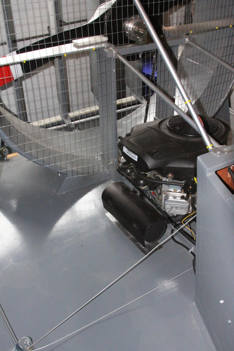

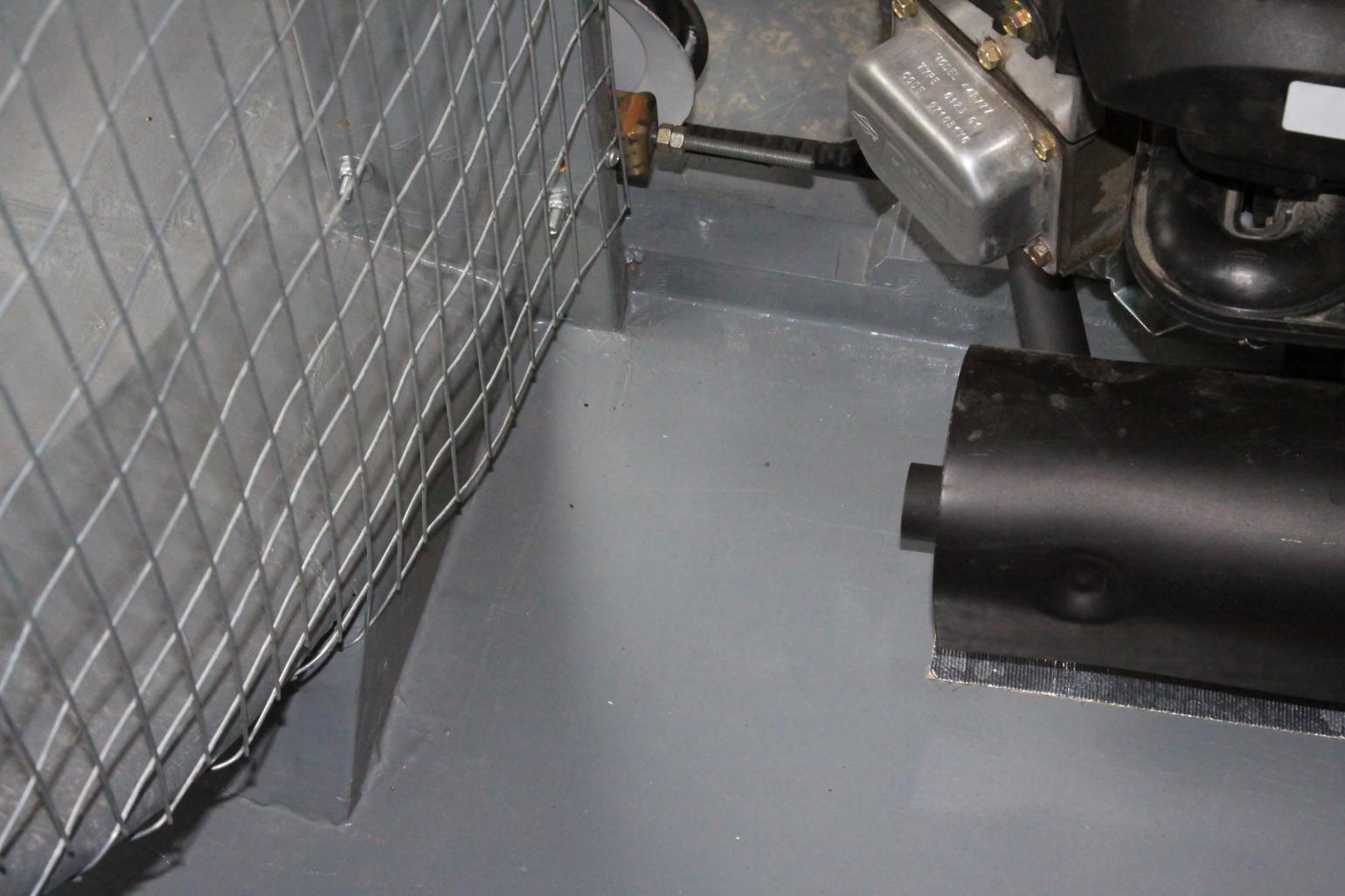

    Zoama - I'm glad you asked
    It does have a muffler. Originally, the engine was mounted per the plans with the muffler facing forward. However, my muffler goes lower than the engine mount. Because of that - I had to increase the forward up angle of the engine so the belt didn't hit the muffler. As a result of the up angle, I had issues with the rear/drive belt coming off.
    My last mod was to rotate the engine 90 degrees and remove the added up-angle on the engine. One of the problems with the current mount is that the output of the tailpipe is only 8" from the base of the lift duct. In the last test (probably only 15 or 20 minutes of running), the heat of the exhaust gas cracked the fiberglass on the duct.
    I need to figure out how to divert the exhaust. The problems I have are two-fold:
    - finding the right diameter and type of pipe to use
    - getting a bend in it with a radius that will fit the space I have (both how to get the bend done, and how to get it to fit)
    The exhaust ID is around 1 1/4" and the OD is around 1 3/8".

    Any suggestions would be appreciated.

    Mandrel bends... cut and use what you need http://www.ebay.com/itm/Exhaust-U-Be...d34c94&vxp=mtr and header wrap http://www.ebay.com/sch/i.html?_trks...+wrap&_sacat=0

    Oh.... excellent, thank you!
    I had been trying to figure out what do to do for a while and hadn't come up with anything good. This is perfect.
    For the mandrel, I assume that the 1 1/4" is the OD. Is that right?
    I'll order that today!
    Tubing is measured by OD.

    Another possibility is to bend a piece of PVC pipe to the right shape and length with a heat gun.
    Take it to a muffler shop and have them replicate it, all in one piece.

    How about just using a piece of sheet metal as a deflector? A few simple cuts and bends should make something appropriate. Tack it to the back of the muffler so that it scatters/deflects the exhaust into the air stream.

    I had thought about sheet metal, but one of the things I've heard is that diverting the muffler from in front of the prop will decrease the noise. (Apparently, the prop magnifies the exhaust noise.) I had thought a pipe would do that better, I just hadn't figure out what to use and how to get the tight bend.
    I had gone to a local muffler shop, but they didn't have anything that small (I think 1 3/4" was the minimum they had.)
    Never thought about amplifying the noise, I guess it would bounce off the prop every time it passes and would get scattered or concentrated in various ways.
    A pipe would look more professional too, it is just the frugal bastard inside of me trying to save you a buck.
    I wonder if somebody who does motorcycle mufflers could do something for you.

    I took Zoama's advice and ordered a mandrel. I had talked to a local muffler shop, but I'd rather do it myself. It probably won't look as good - but it's another learning experience.
    I'm just waiting for the mandrel to arrive. When I do it, I'll post do a project post thread for it.
