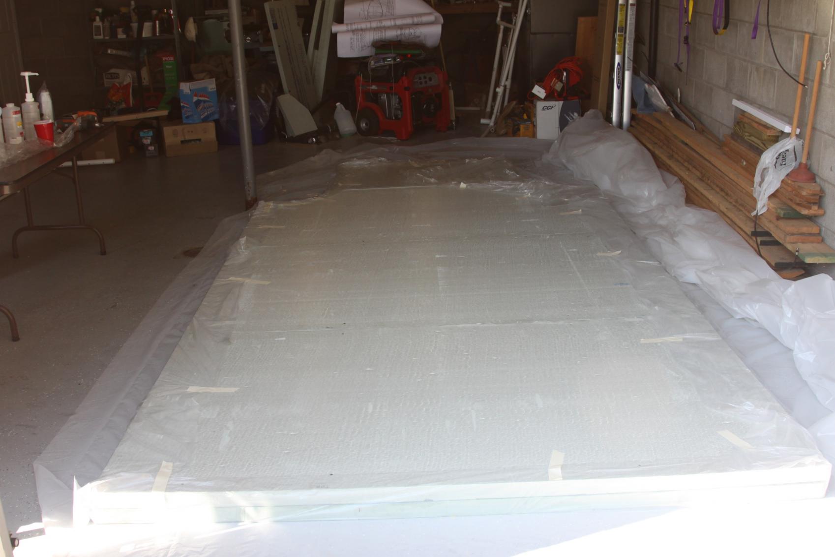

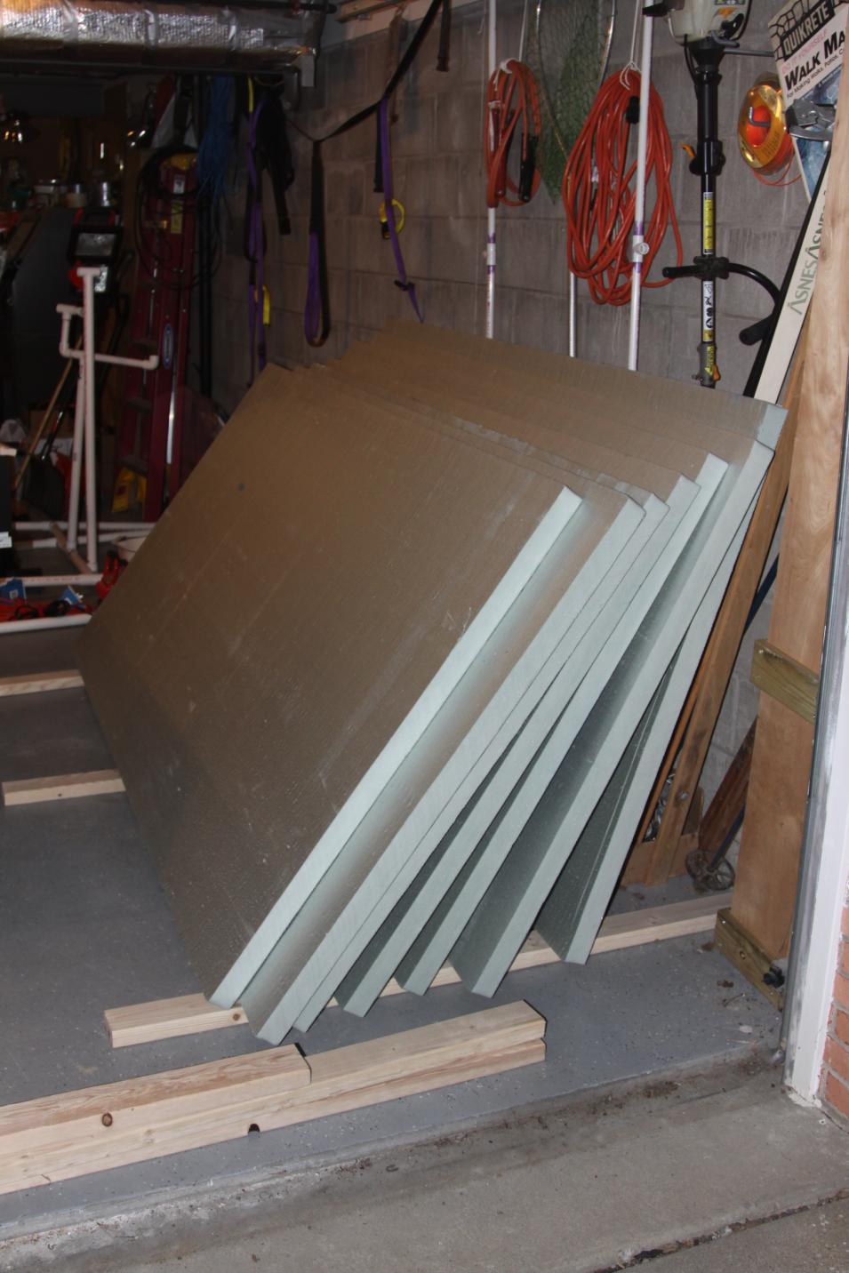

ID:	3284The main body is 2" foam insulation board used in homes. I ended up using "green" from Lowes instead of the normal Corning pink. So, it started as a bunch of foam sheets.
    The first step was to epoxy two layers of foam together in the rough shape of the hull. It is vacuum laminated using a big sheet of plastic folded over and duct taped together and a shop vac. Since my shop vac is crappy, I bought a refurbed vacuum pump to laminate. The second picture is of the hull while laminating (left under vacuum for about 30 hours).
    (You have to put blankets over and under the vacuum hose to allow even air flow through the vacuum bag.)
    I think I get what you're saying, is that inside the bag top and bottom and going to the nozzle so it provides air passages to the far end of the bag?
    Did you just duct tape the vac hose into the bag at a seam?
    Very cool project, looking forward to seeing how the powerplant and drivetrain is done.
    Ed -
    The detailed answer is, you have the following layers.
    Bottom to top you have:
    1) heavy gauge plastic big enough to fold over on top of foam
    2) light gauge plastic to catch excess epoxy (and protect heavy gauge)
    3) foam being laminated
    4) light gauge plastic to catch excess epoxy
    5) blanket to allow air flow underneatch vacuum line
    6) vacuum line (hose/pipe with holes)
    7) blanket to allow air flow
    8) folded over plastic from bottom
    You then seal the entire thing with duct tape. It's easy to find leaks as you can hear them and some leaking is okay. I've been told shop vac's use air flow for cooling, so they have to have some leakage to prevent overheating.

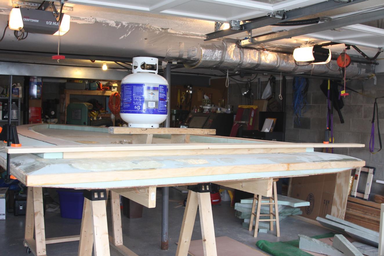

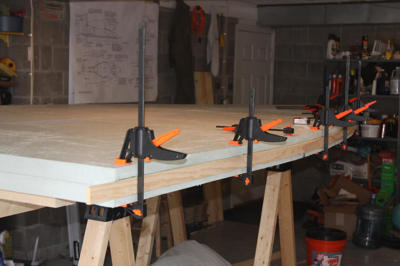

    After vacuum laminating the two layers of 2" foam, I used a hot wire cutter to get the rough shape of the hull. I cleaning it up with a "sure foam".
    After the shape was complete, a wood strip was attached to the sides. It will be the attachment point for the outer side of the skirt.
    After that was done, the top of the deck is shaped with a downward slope. In the second picture you can see a dent down the middle of the foam. I used PVC with holes drilled in it for distributing the vacuum. The vacuum was a little too high and it ended up compressing the PVC into the foam.
    That was a pain to fill. I used epoxy and glass microspheres.

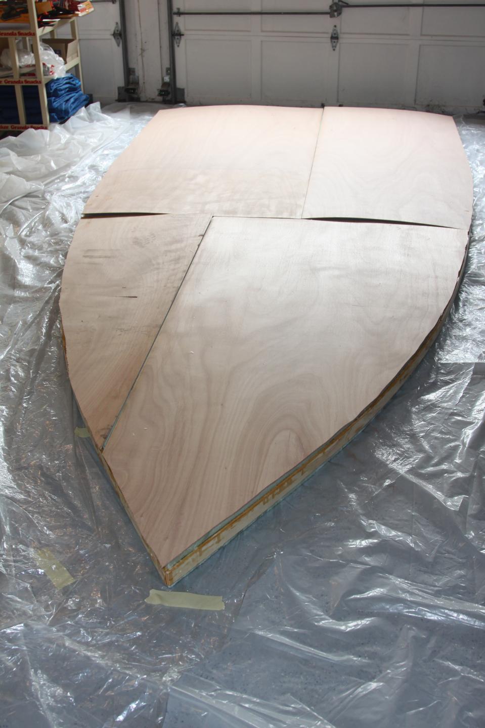

    After the hull is shaped, 1/8" marine plywood is attached with epoxy and vacuum laminated onto the foam hull. That's the layout in the first picture.
    After the top of the hull is done, the bottom of the hull gets a foam "runner" around the edges. It's toped with plywood and will have a wood strip glued on for the inner skirt attachment.
    The LP tank is to put weight on plywood expoyed into the hull. It is used for reinforcing the bottom of the hull to bolt the engine on.
