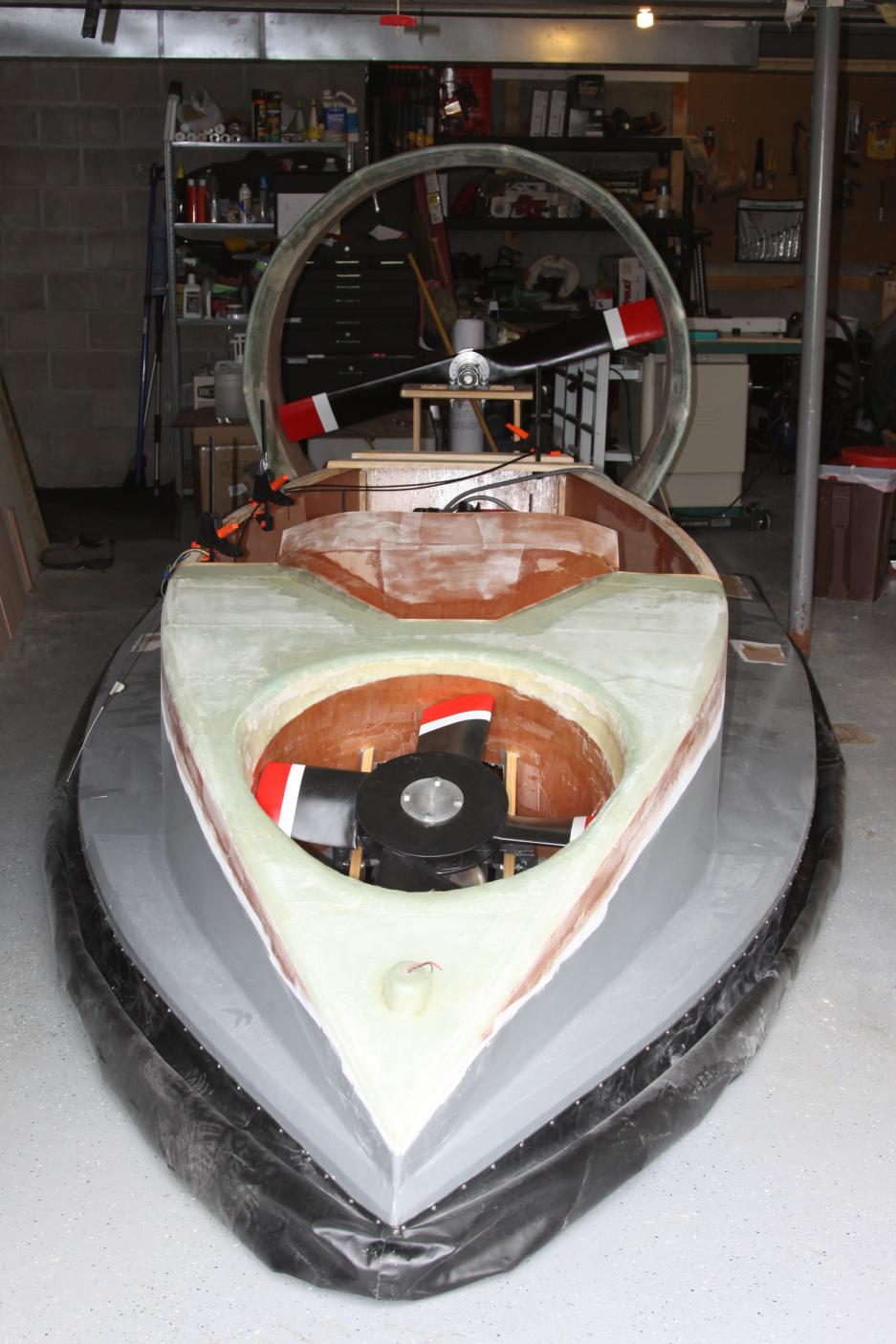

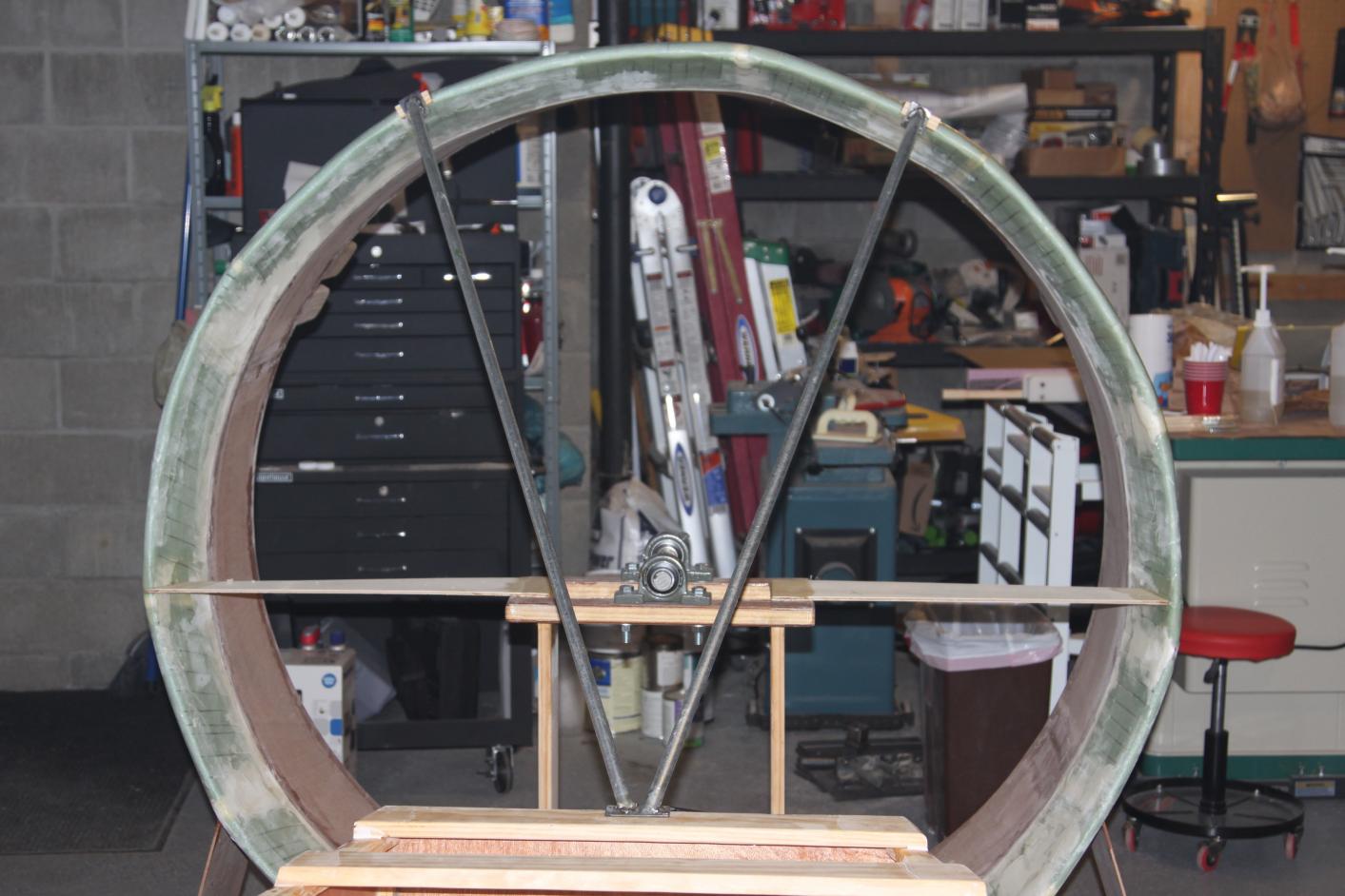

    Default Coming to the end of the history....
    These pictures will bring the thread up to the current state with respect to the major stuff.
    The first picture is the completed thrust duct. Didn't turn out nearly as nice as it was supposed to, but after putting 50+ hours in on it - it stopped being fun. I'm under orders to have the garage cleaned up by the time snow flies so that my wife can use her side Given her tolerance for this project, that's a "gotta do".
    You can see from the picture that there are cut outs for where the duct mounts to the deck. There are two 2x2's on the deck. In front of the duct the prop platform and engine are mounted on them. Behind the duct the rudders and trim wing are mounted on them.

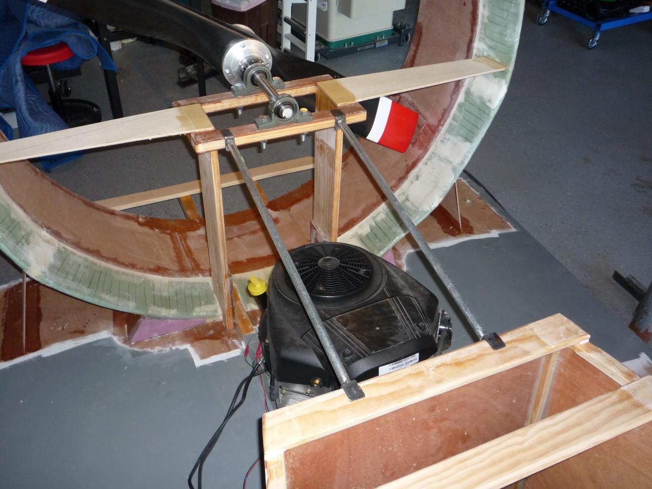

    The next shot shows a head on view with the duct attached. I've since added a horizontal duct support that goes from the prop platform to the duct. I need to add a support to the top of the duct yet. I was thinking of fabing a support using conduit.
    The final picture shows my Project #2 already posted. This reinforces the prop platform to prevent serious danger on failure. You can see the horizontal support there.

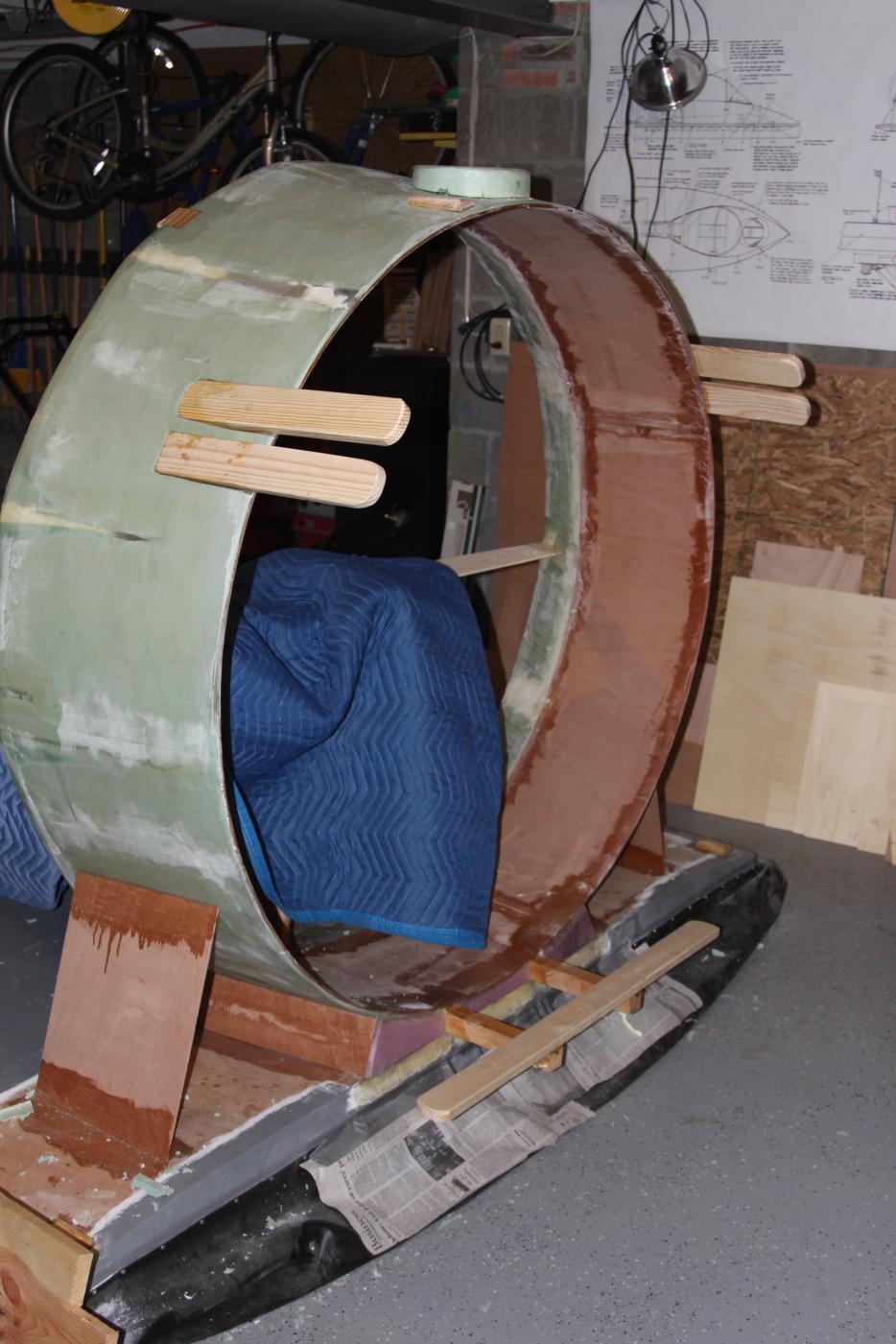

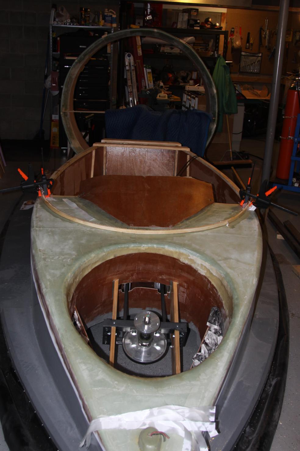

    Default Good weekend of work
    On Saturay I got around 12 hours of work on the hovercraft (mostly fiberglass) and today I got about 9 hours of metal fab done (other posts for an update on my project 1 and also did project 3 and 4 and started work on project 5).

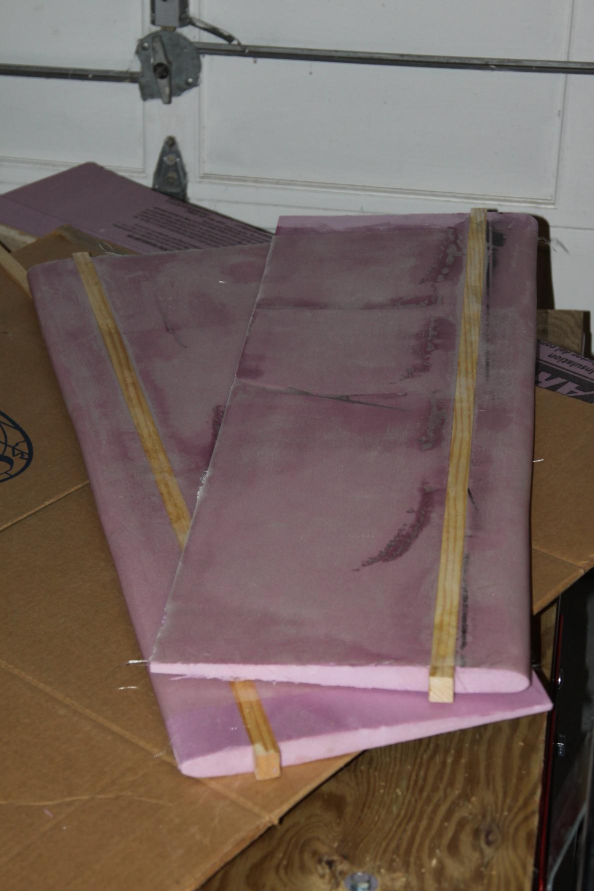

    I made major progress on the rudders (there are 4). I had to shape then. I did the front with a small stationary belt sander. I cut the shape on the back with a little 6 amp battery charger and ni-chrome wire as a homemade hot wire cutter.
    After that I sanded them down to get them in decent shape. I also got one side fiberglassed on all of them.
    I did some fiberglassing inside the cockpit. The big things on the outside were installing the wood strip that the bottom of the windshield will mount to. I got it epoxied down and partially glassed in place.
    It's not obvious from the picture, but I also got 4 layers of 2" wide 6 oz fiberglass at the top of the lift duct. That's there so that I have something to I can screw into to attach the safety fence above the fan blade.
    The last thing I worked on is the back. I got a piece of foam mounted and a piece of wood mounted on top of the thrust duct. The foam is to mount the strobe light and the wood is to mount a boat running light.
    The wood tabs a little more than halfway up the sides are to mount the trim wing and rudders. The top tab was installed first at the wrong height. So I got the second one mounted at the proper height. I figured I'd just leave the first one there and think of it as the "fins on the cadillac".
    I also got the wood cross member at the bottom in place. That's to support the bottom of the rudders.
    The blue moving blanket is there because I started fabricating the upper duct supports out of angle iron and 1/2" conduit. I put that in place for when I did tacking. Not the smartest thing, since it's not fireproof, but it does the job in a pinch. (I have an extinguisher handy, just in case.)

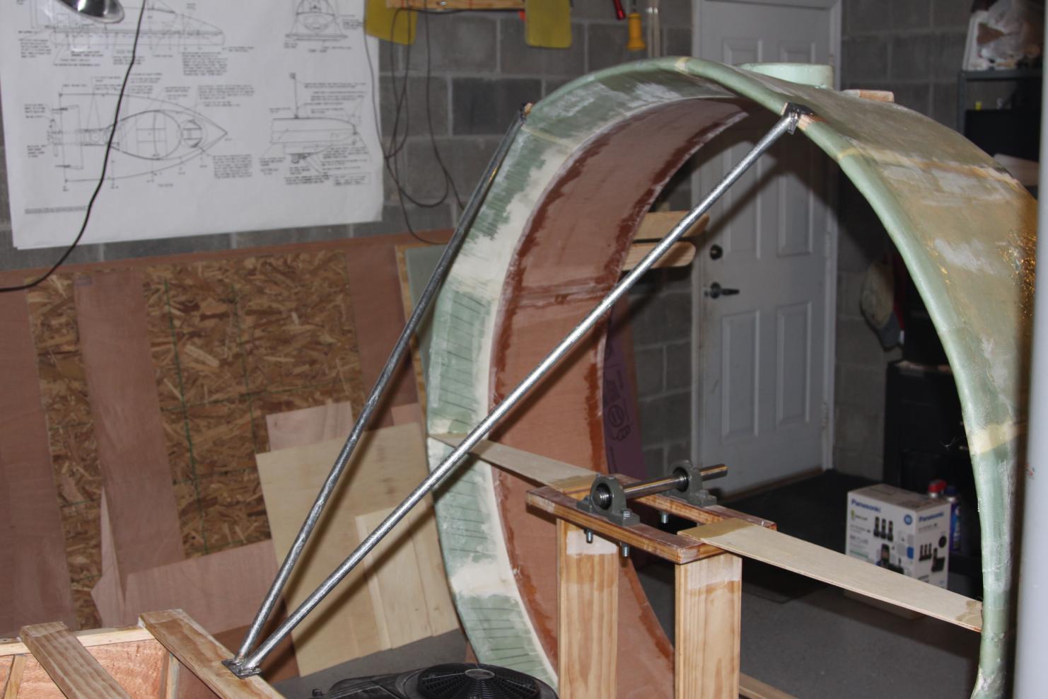

    My fifth project was a duct reinforcing bar. The plans called for aluminum mounting plate and 1/4" plywood.
    I guessing that if this is heavier, its only slightly heavier than a wood and aluminum strut.
    I built the reinforcing bar today and also fiberglassed the second side of the rudders as well as some other small things.
    Next I'll sand the exterior of the craft that hasn't been painted and paint it. I'll probably do that while I'm finishing the rudders.
    After the exterior is painted and the rudders are done - it's just the interior. I'm going to use indoor/outdoor carpeting on the floor and walls. I'll also need to build and wire the dashboard and put the controls in.
