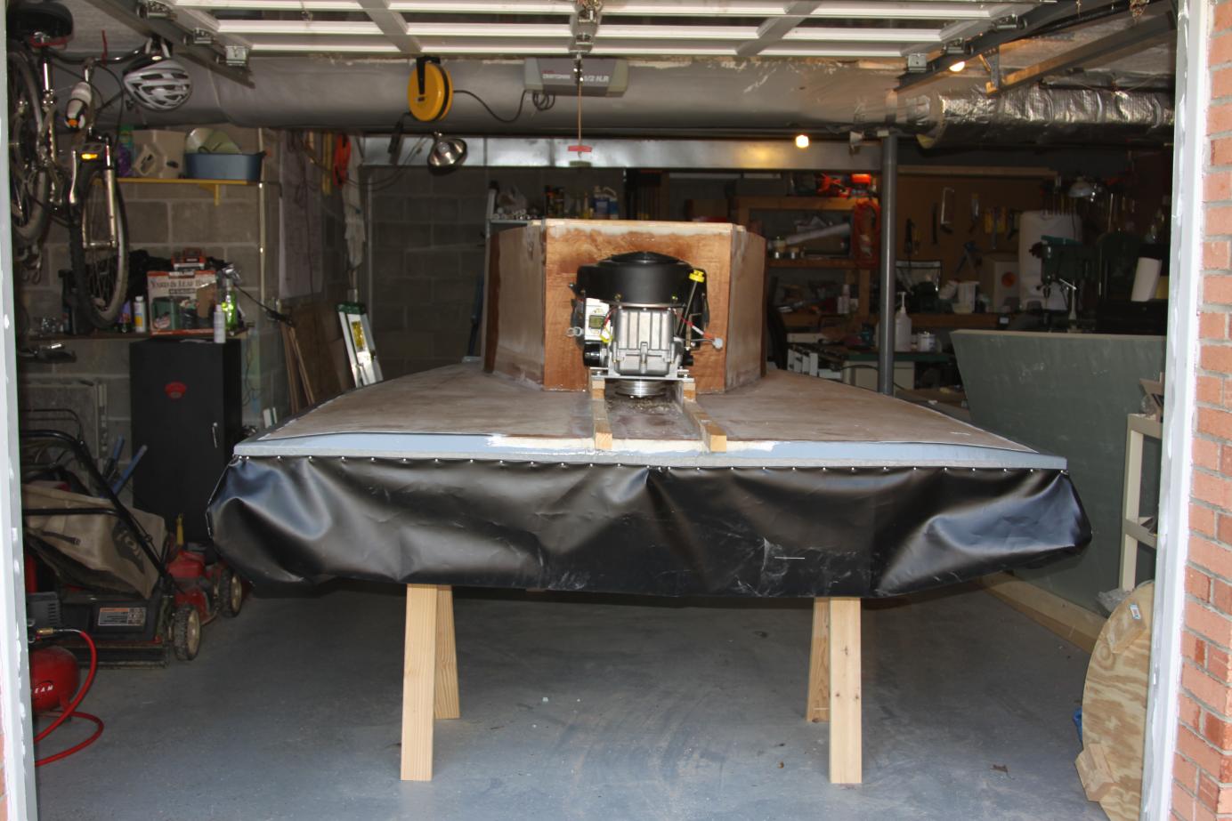

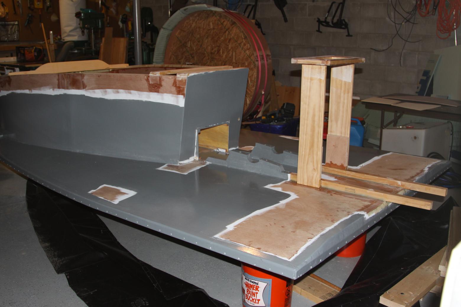

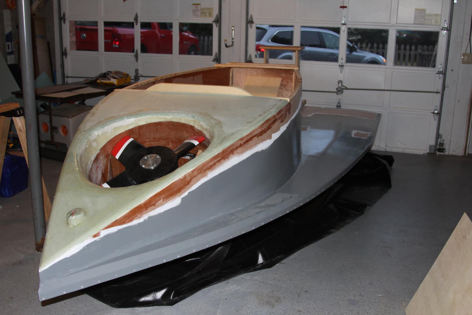

    These shots show the skirt laying on the floor before I attached it. I started painting the hull but didn't paint around areas that I though I might need to do more work.
    The front has a mount for the forward navigation light. I'll still have to put a dashboard on the front and a bottom attach strip for the windshield.

    The rear shot shows the engine mount (angled wood painted gray). Right behind that is the platform that the prop shaft and bearings connect to. Where the wood sticks off the back will become the bottom attachment point for the steering system (rudders).

    The next welding project will be building braces out of angle iron (1" long) and conduit. The first angle will go against the top/back of the cockpit, the second will go against the top of the prop platform and the conduit will be between the two.
    There will be one on each side of the prop platform. It's to prevent a catastrophic failure of the prop mount from killing you.

    Tritium - I had thought it would be humorous for my first flight to wear an old leather aviator helmet with goggles and scarf. Then I realized that could make the test flight very short and my last flight
    I do have to make guards for the prop and fan. They say to use 4" square wire fence for the prop and 2" for the fan. I'm trying to figure out the best way to fabricate it.

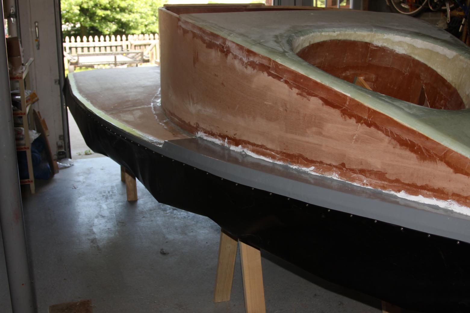

    Default Skirt Attachment
    These pictures show the skirt after just being attached.

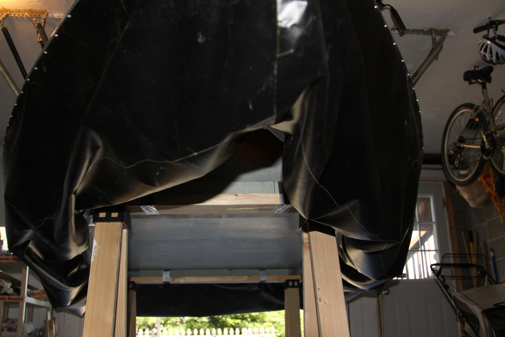

    The skirt is PVC covered cloth. I had to cut the fabric in half and then cut the fabric to a specified pattern for the joints. Glued it with a quick setting cement and it was ready to go.
    The edges get folded over and screwed in. It took 300 screens starting with the corners. You have to gather fabric on the inside at the front because of excess due to the curve of the hull.
    I tested it on the horses so that I could see how the skirt was hanging. I could see that there was some severe puckering. After that we took it down and did the test hover.
    That was the big milestone since hovering is an issue if the air splitters aren't done right. You can see the top of one in the picture above. It is a piece of 1/8" wood that goes from the skirt attach strip in the lift duct to the bottom of the fan blade. It ensures that you get high pressure air in the skirt.
    With my kids help, we did a test hover. Worked great! At high motor rpm the rear skirt would flap. After talking to tech support, I found out that I didn't add and extra 4" piece to it.
    300 screws off, a little glue and 300 screws on - and it was good to do. No more flapping. On the reinstallation I used nylon string trimer line inside the folded over skirt material. It kept the skirt from twisting and make the installation go smoother.
    This is the view of underneath. I marked the ground contact line with a paint pen so that I could ensure it was installed straight.
