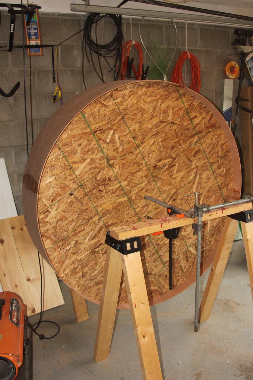

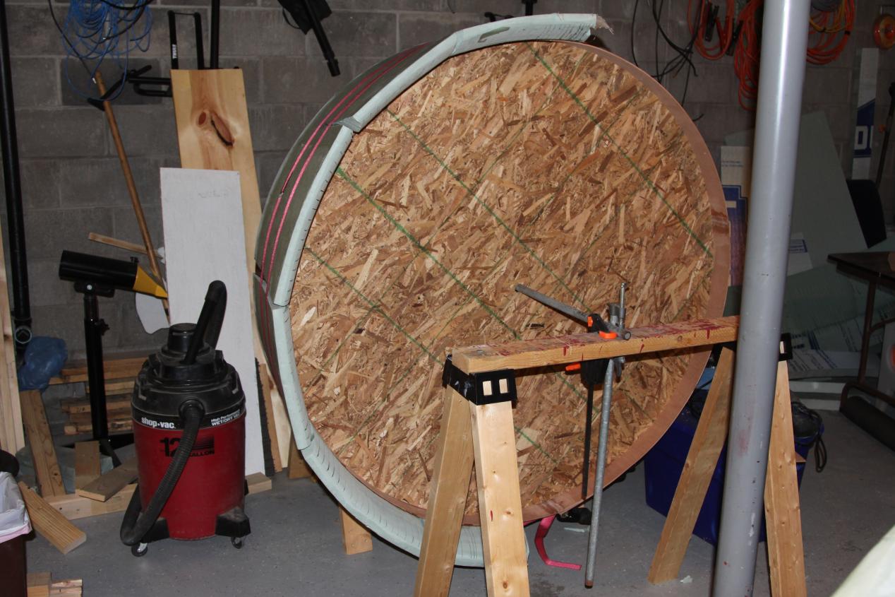

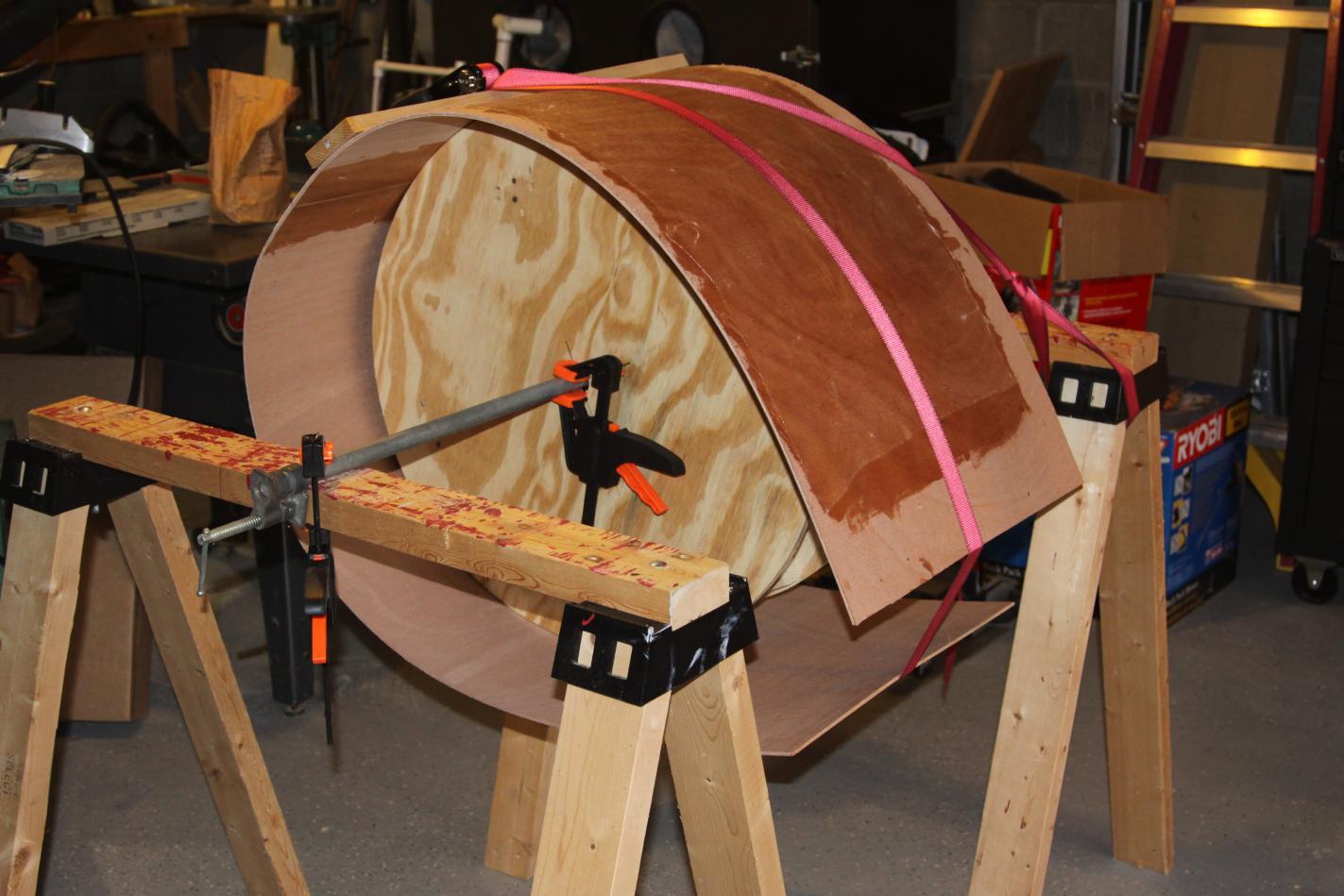

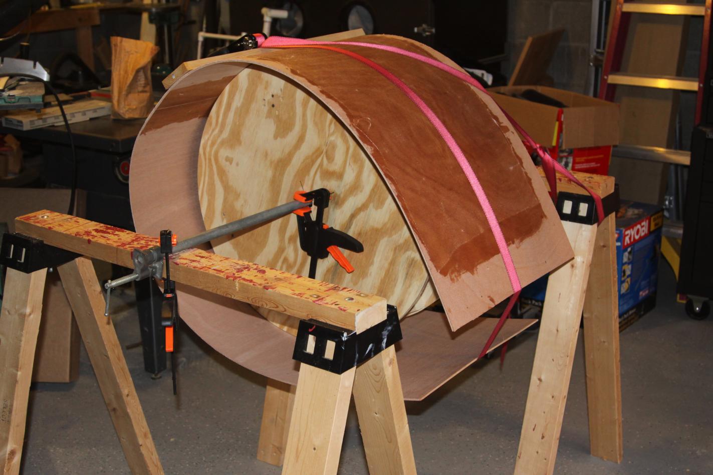

    The next step I did (last November) was to build the duct for the lift fan. They recommend an 1/8" clearance between the fan tip and the duct wall. The wall is made out of 1/8" marine plywood. It's amazing how you can bend that stuff. You glass two pieces together, then glass the outside of the wall. After that you wrap it around a form.

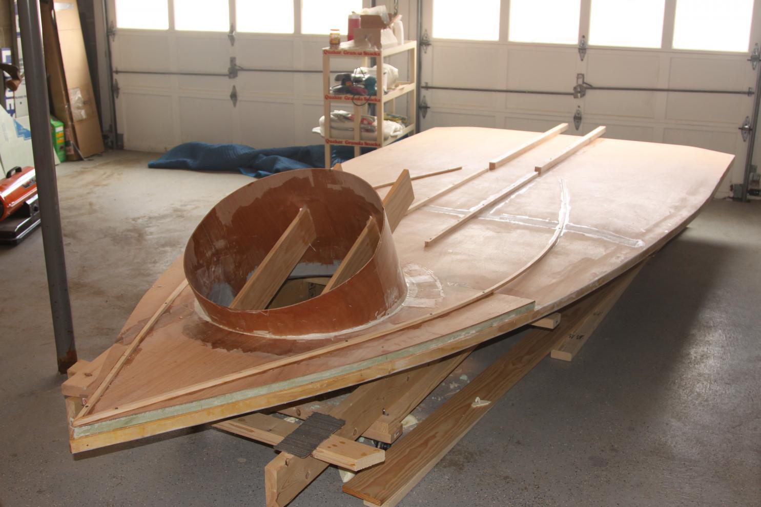

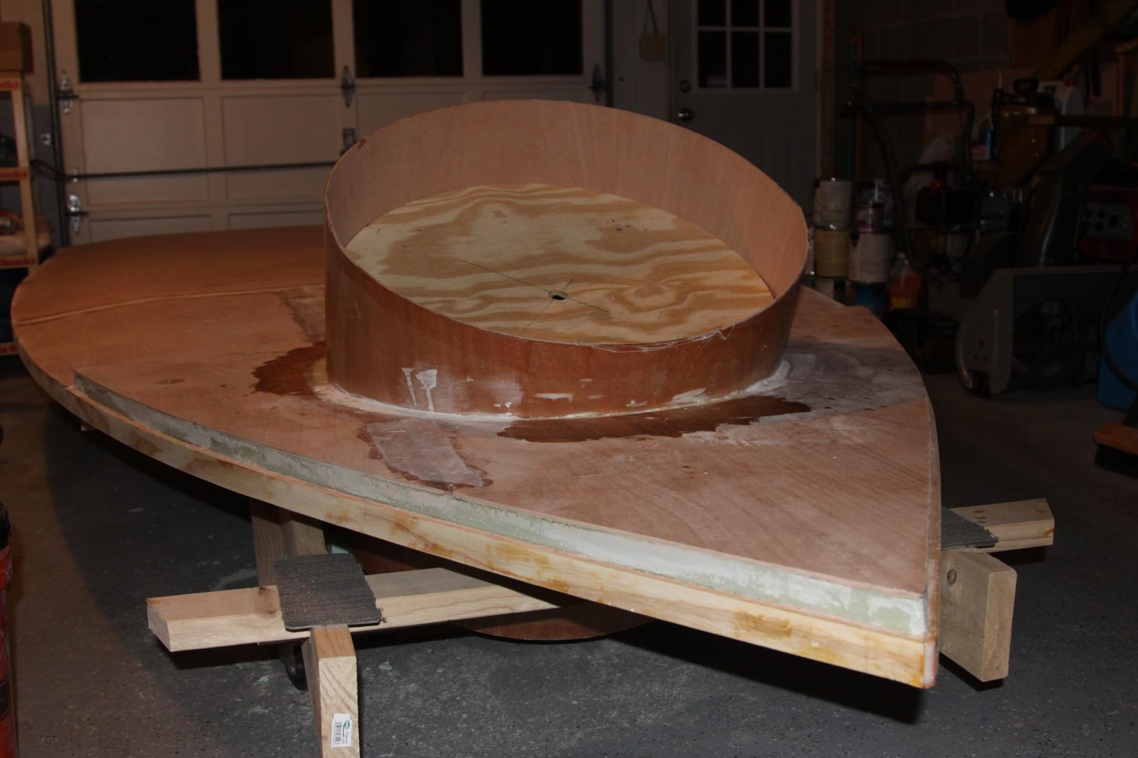

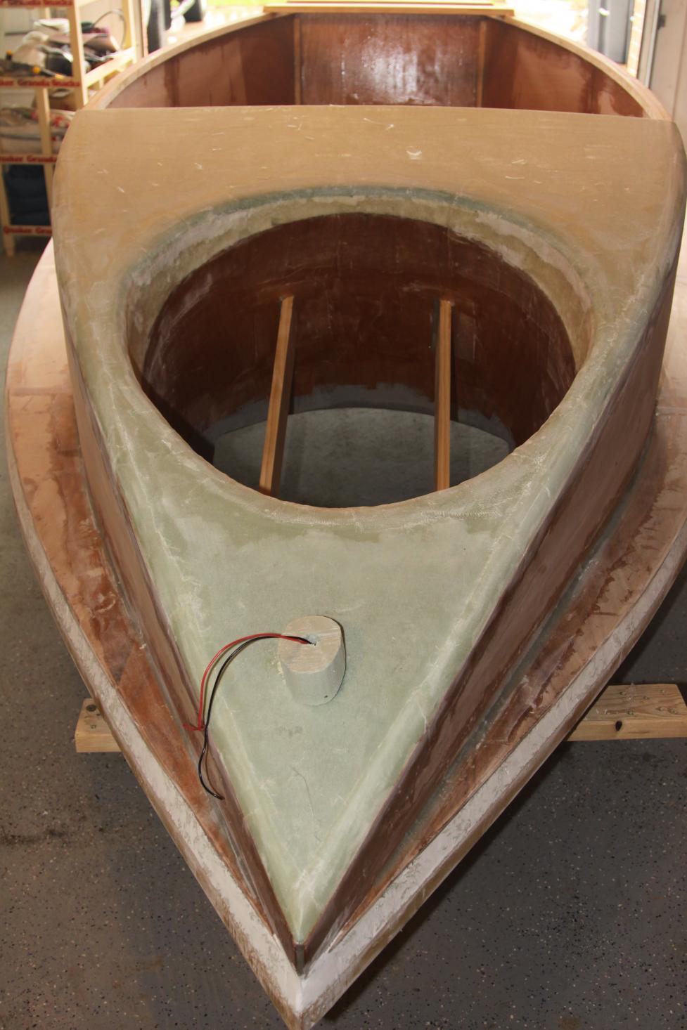

    The next picture shows the top deck after I cut a hole in the hull and fiberglassed the lift duct in it place.

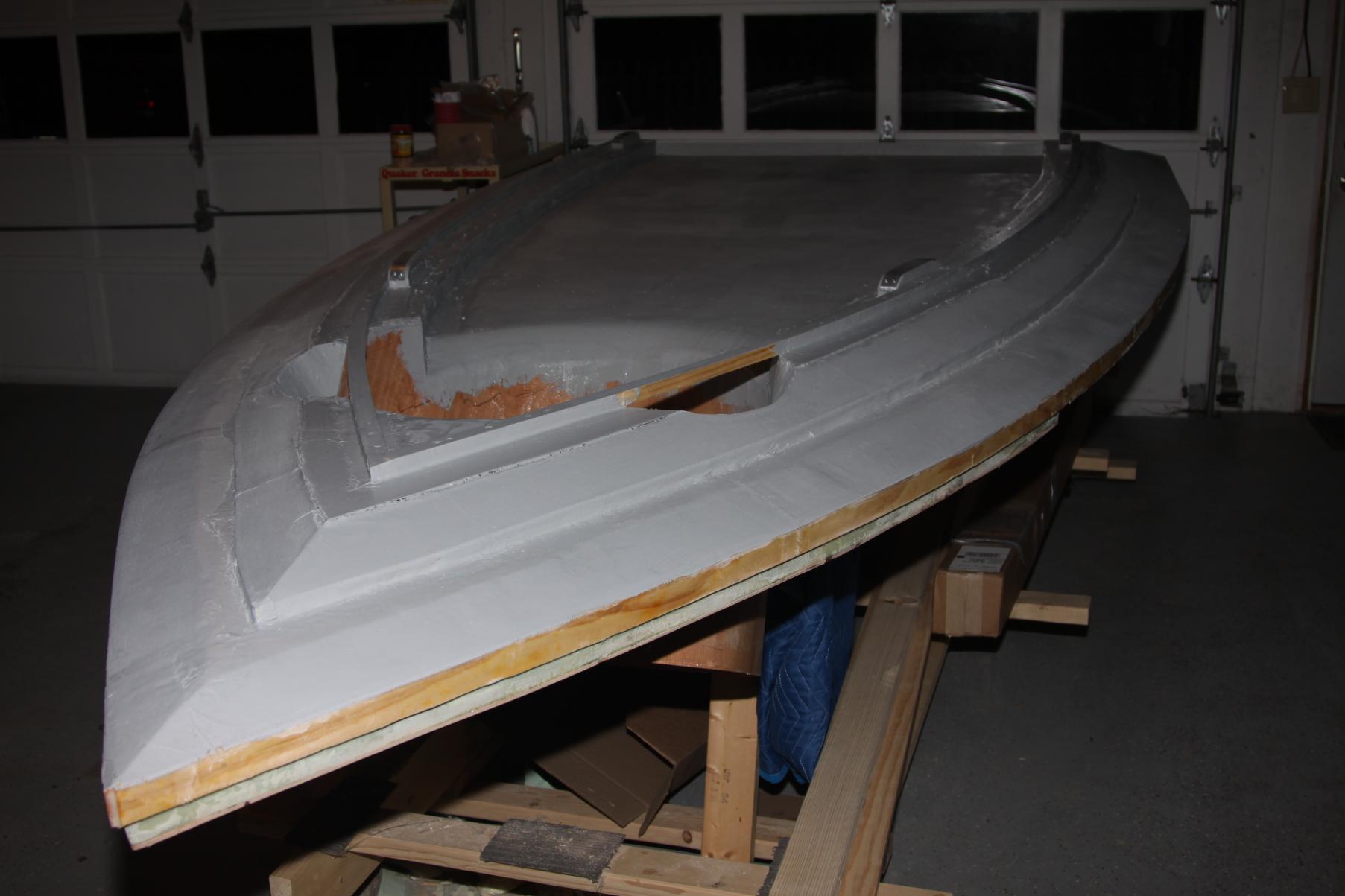

    Default Finish the bottom and lay out the cockpit
ID:	3311The first picture shows the bottom after it's been finished and painted. The skirt attaches on the unpainted wood on the edge of the hull and the inside attached on the wood strip at the top. You can see a hole between the inner skirt attach strip and the outer edge of the lift duct. That is how the skirt is inflated.
    The next picture shows the mounting strips for the cockpit wall and the center seat. The center seat also covers the steering mechanism and the lift fan drive belt.

    The thrust duct goes around the prop. If built correctly, they say you can get up to a 15% performance improvement. The first step was to build the form to bend the 1/8" plywood on. Then, cut the wood and fiberglass it together to get one long piece. The first picture shows the wood duct build on the form.

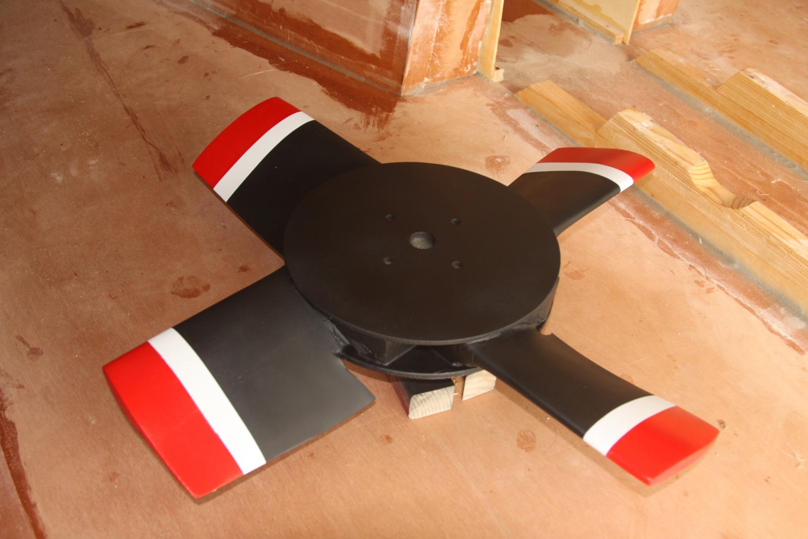

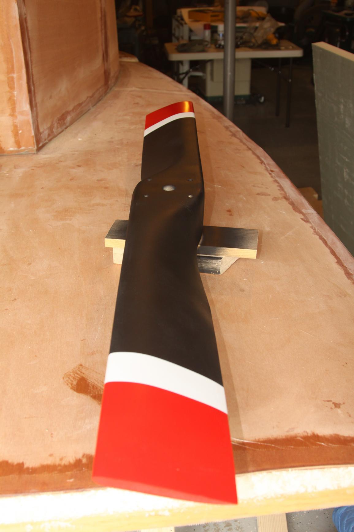

    Default Fan and Prop Paint Scheme
    Not being a particularly artsy or talented at graphics design - I decided to go with a military look. I used "battleship gray" for the paint and I painted the props similar to military plane props. (Cheesy - but hey, it's the best I could do.) Friends have suggested I mount guns on it
    The model is called the UH-14P, so I figured I'd do a big "UH-14" on the sides of the thrust duct.
