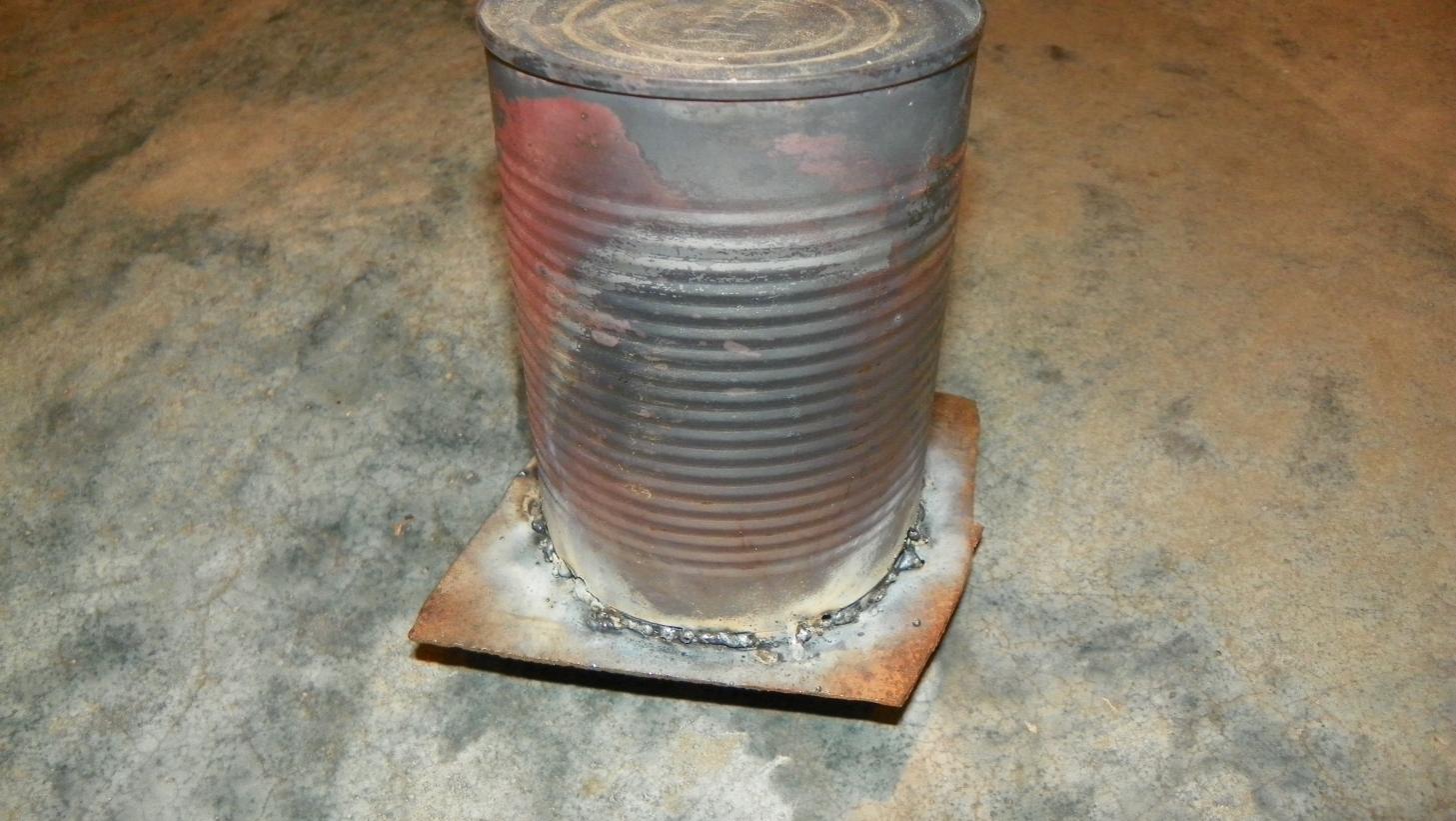

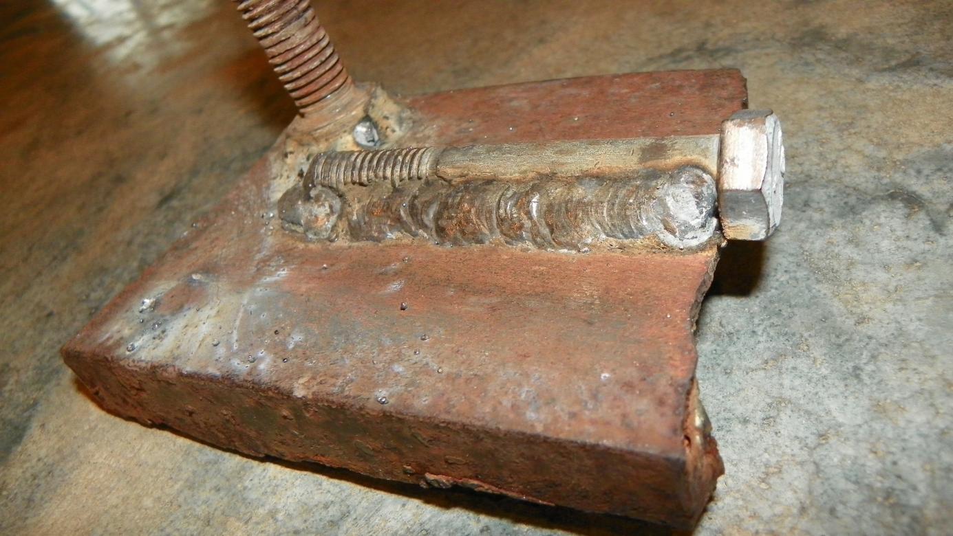

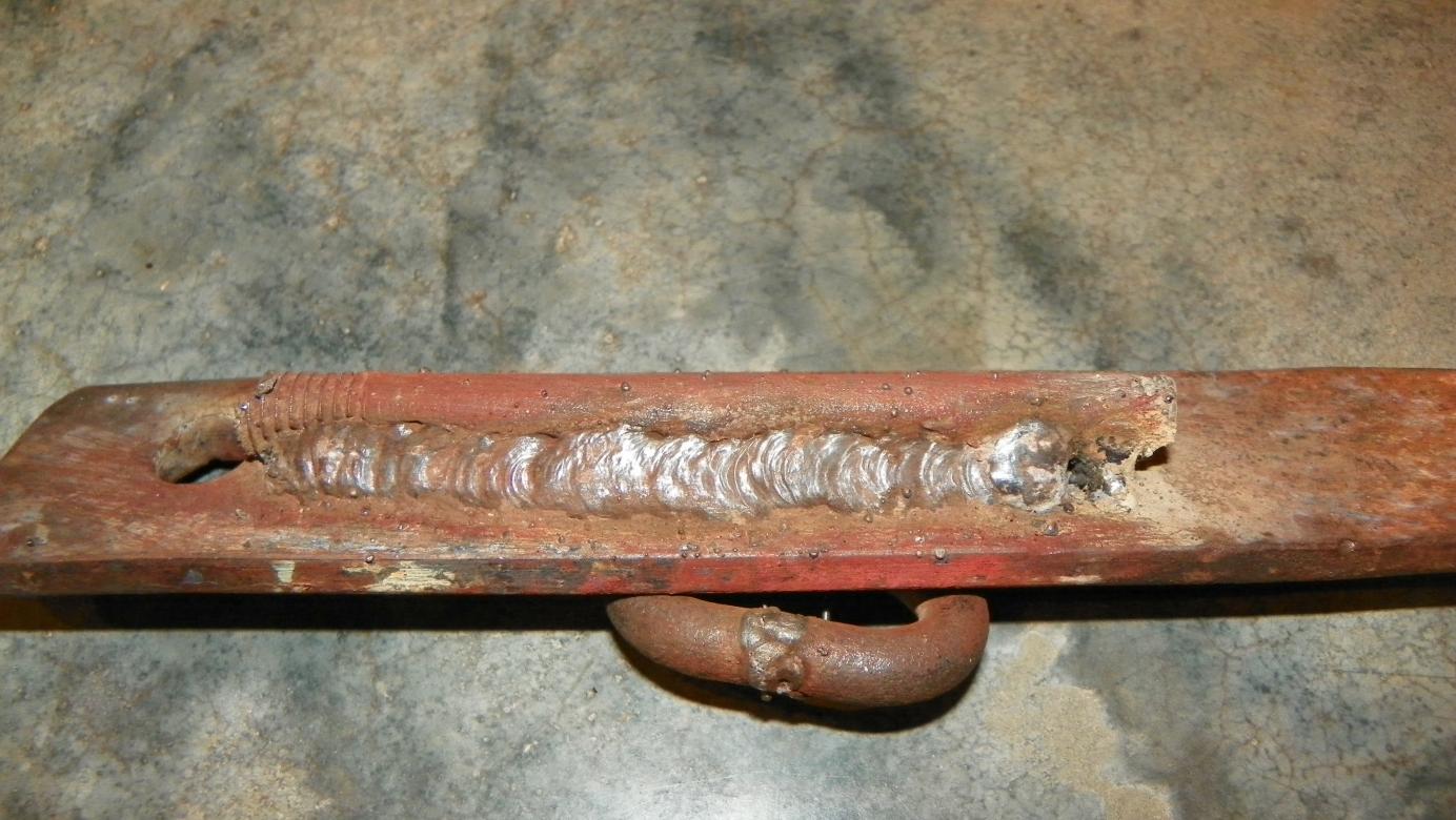

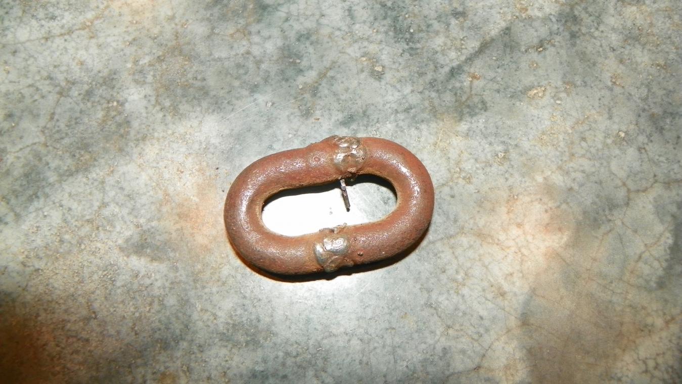

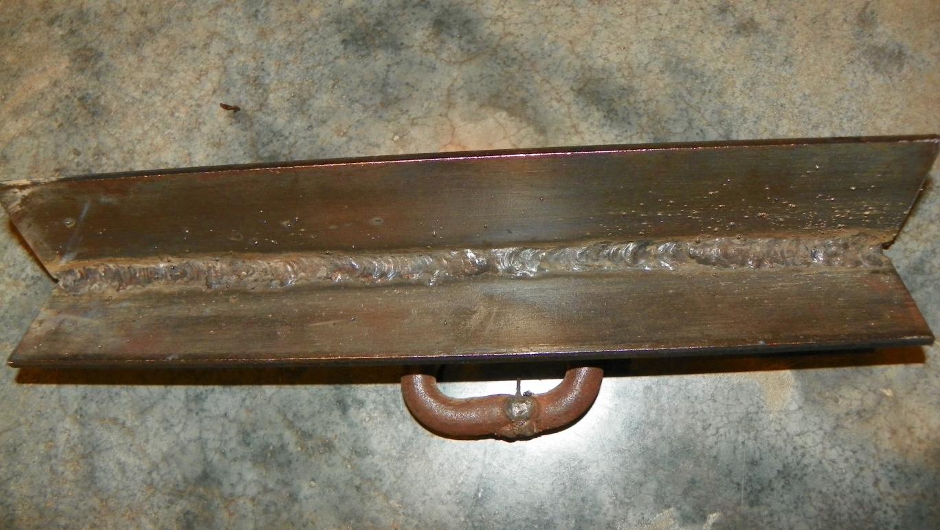

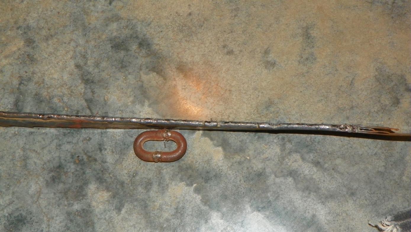

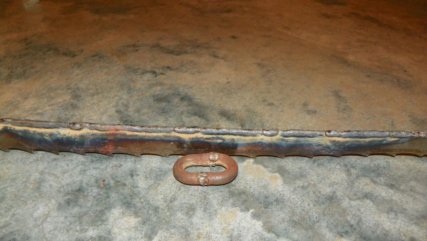

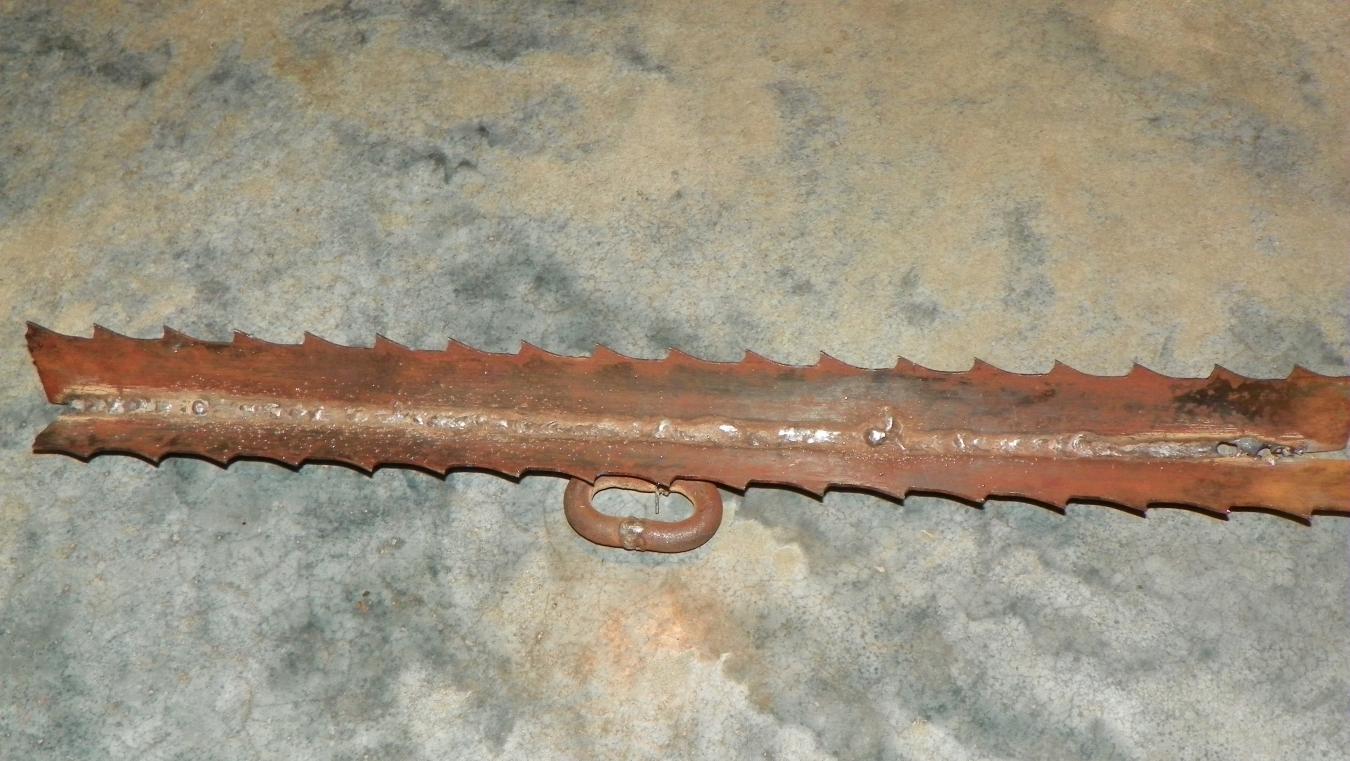

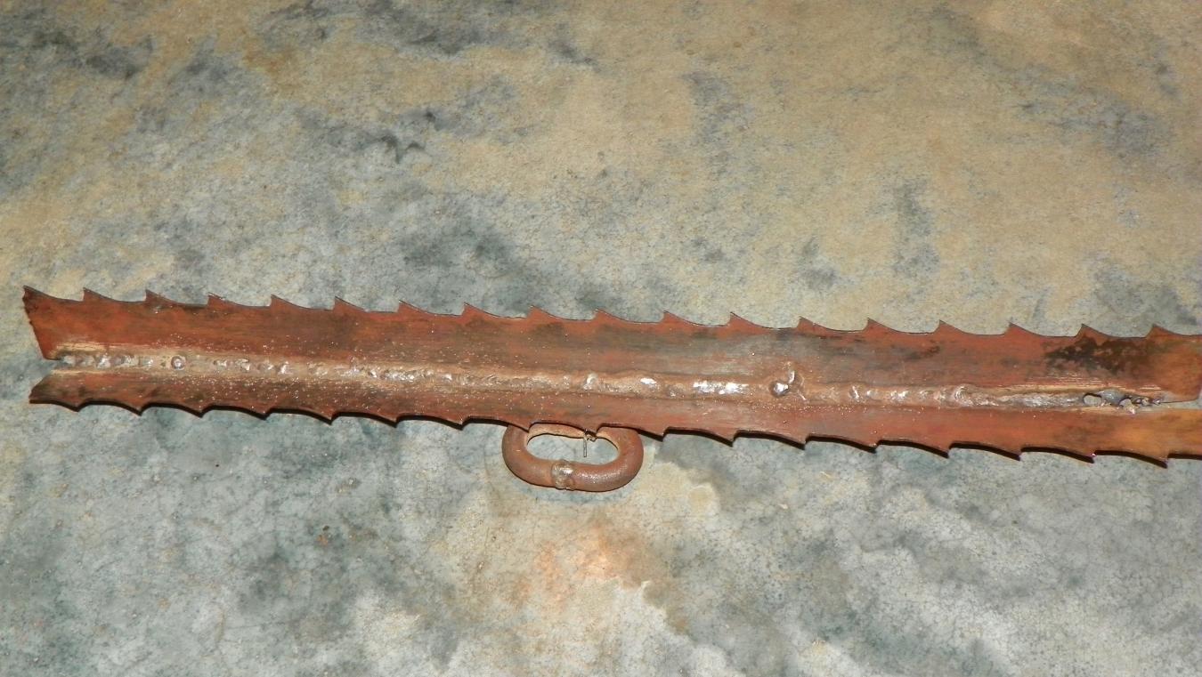

    The band saw blades are approximately 1/16" thick. The shiny welded angle piece (100_2755.jpg) is 1/8" thick. Chain link was cut on both sides. The pack of welded band saw blades is composed of 4 1/16" thick blades. The two bolts (one welded parallel and the other perpendicular to the steel base pic 100_2760.jpg) are 1/2" diameter. The tin can was obliviously too thin for 30amps and .035 wire. The part of a bolt (pic 100_2774.jpg) is 3/8" diameter.
    Half decent welds for a young guy that has done less than 20 small projects in his lifetime...
    I am using this project as "project 1."

    Next time, try cleaning up the metal before welding if you can. I think that it makes a big difference and makes it easier to see how well the weld was I think. Other than that, good job..
    What machine are you using ?
    Does your wire always feed smoothly ? If not you can go up a size on the tip. Some brands of flux core wire aren't very clean and uniform, causing inconsistent feed and sometimes gets stuck in the tip. I use an .045 tip with .035 flux core and it works perfectly.
    You need to keep a tight arc and move at a constant speed... and at the very least, brush the loose rust off but it's best to clean it with a grinder.
    Thanks for the suggestion! I was just kinda practicing so I didn't clean it up much...Just enough to get an arc
    Benjamin
    Thanks! I was just practicing so I didn't do much to it... What brand wire do you use? Got Praxair and it is so dirty that it plugged up the sleeve back by the welder...It's a thick bread dough like stuff. Ended up putting a wire cut off in a drill and boring through the junk. It took several passes, but it got most of it out. Afterwards I was able to turn the feed rate down to 4.5 from 6 lol. Hobart Handler 120 and It's just about ready to blow up lol. Yes, it normally does feed smoothly, but I just don't have much practice... The only time it gets stuck is when I manage to accidentally burn the wire up to the tip . On 100_2755.jpg it just looks rusty from the burning flux and the wire brush which I used on other rusty metal The rest are rusty...
