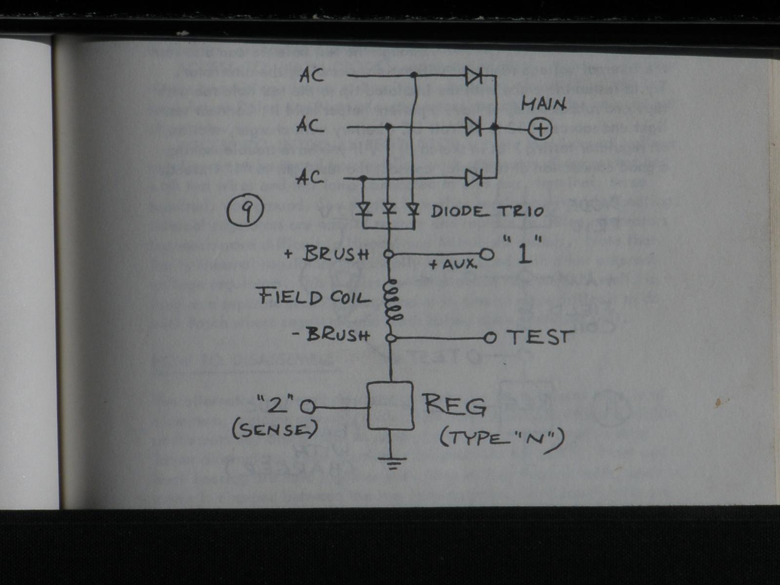

    The picture of your alternator seems to indicate that's it's internally regulated. If so, you do'nt need to remove the regulator. Just bypass it.
    See that little D shaped hole in the back of the casing just to the left of that 2 wire connector ? Have a look inside that hole, with a light if need be. You should see a small metal spade lug, just like the ones that your above-mentioned connector plugs into.
    Those three lugs are part and parcel of the regulator and the one behind the D shaped hole is to test the alternator output. If you short it to ground, (the alternator case) with a screwdriver, you effectively bypass the regulator and maximum output is produced.
    The alternator output would then be varied by the voltage applied to one of the other two lugs under the connector.

    Ok rivets your just saying to ground out whats behind the hole and it will bipass it. Would you have to keep the screwdriver in there. Im confused?
    Hi Bobwills,
    The "screwdriver in the hole" is a quick and dirty way to bypass the regulator and determine if the alternator is producing full output.
    To permanently disable the regulator, I would slightly enlarge the D hole so as to make it round, then I would tap it.
    Screw in a bolt so that the bolt tip contacts that lug on the regulator and you're done.
    Also, put a nut on the bolt and tighten it against the alternator case to lock everything in place.

    A couple questions:
    When you enlarge this hole, presumably with a drill, do you run the risk of metal turnings from the drilling process getting into the regulator and shorting things out?
    Does the end-product welder require a cooling fan? Blasphemy, did you incorporate a cooling mechanism in your welder?

    Bobwills,
    My last post above has a significant OOPS, so you can't hook up as per Blasphemy's schematic, because I forgot about the diode trio.
    Unfortunately, you'll have to open up the cases and dive in.
    See schematic below. (The 12 Volt Doctor's Alternator Book - Edgar J. Beyn - Spa Creek Inc.)
    Remove the diode trio, and while you're at it solder a lead to the test lug and route it outside the case where you can easily ground it. Then you don't need a threaded hole.
    Also, the + charger lead goes to lug #1 and the - charger lead goes to the casing and NOT to lug #2.
    You can also remove the regulator, but then you'll have to connect leads to the slip rings and bring them outside the case.
    There is an even neater way.
    If you keep the diode trio, and hook up the rheostat between the test lug and the case, then you need the battery charger (or a battery for that matter) for only 1 or 2 seconds after start up.

    [QUOTE=DaveO;15396]A couple questions:
    QUOTE]
    DaveO,
    It could be an issue, but my thinking was to use a drill bit in a threading tap chuck and enlarging the hole by hand and blasting with compressed air.
    No longer relevant since the cases have to be opened. Easier and neater to route grounding wire outside the case - see post above.

    Im still a bit confused. So whats a diode trio and what does it do that you would have to remove it sometimes. And ok so your saying to open it up and just put a wire grounding out the regulator. Is that really all you all are saying to do. Sorry i dont understand too much. Not the best on some of these types of things. But hey ya gotta learn somehow.
