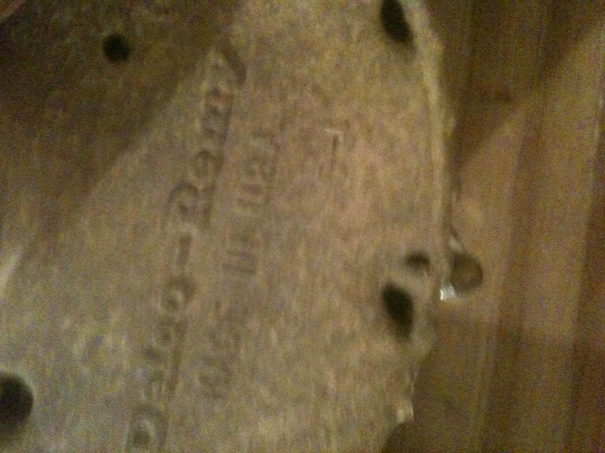

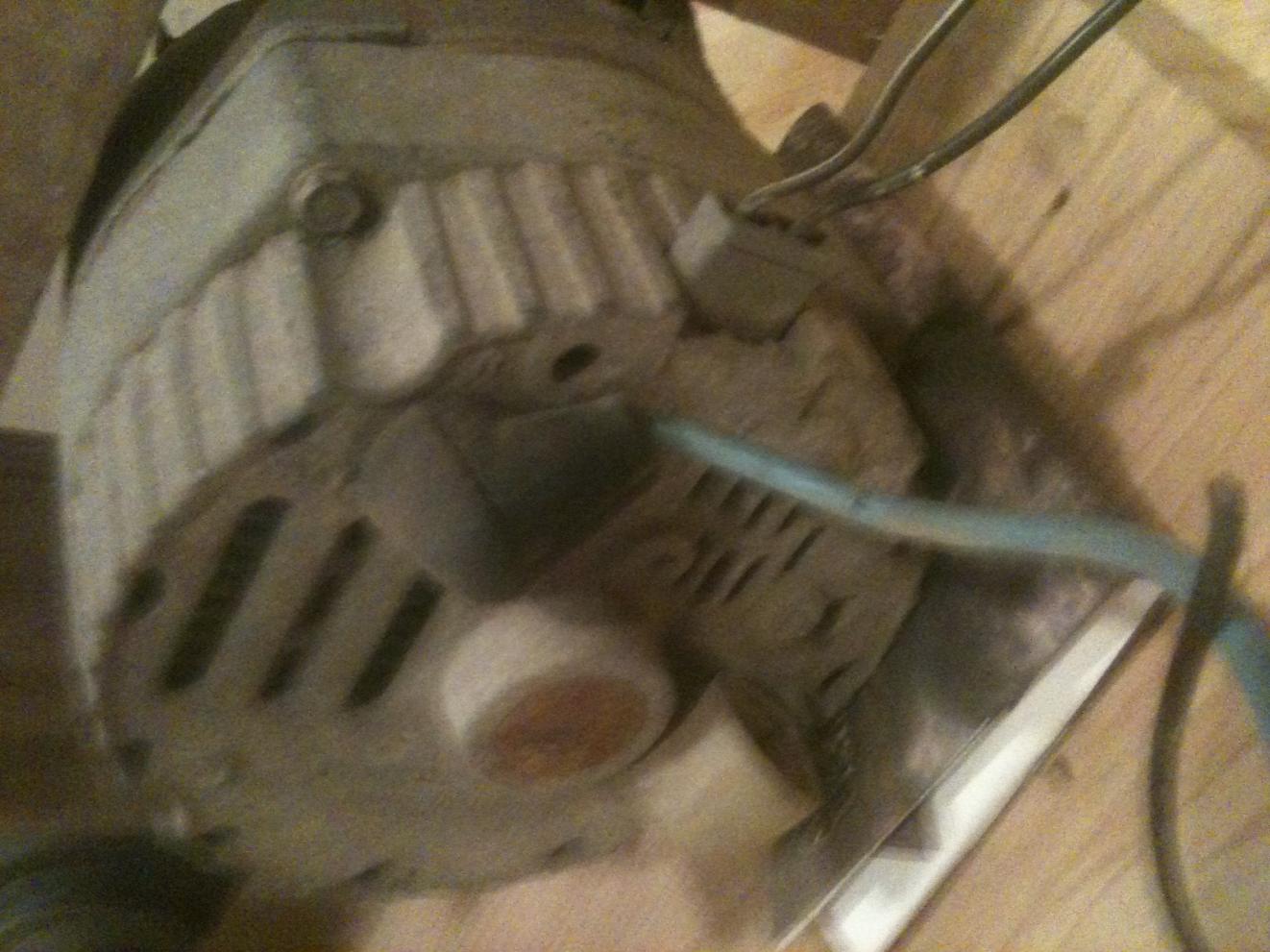

    Well I dont know if this one is internal or external regulated, so heres some pictures, Im guessing its internal. Its pretty old. I dont even know how many amps it is or anything.

    I don't think any of the AC Delco's put a amperage stamp on it. Just a guess, 60 or 70 amps. I have a 119 amp ac delco remy on my "roach" It has a much bigger power + lead. I just searched my self mad trying to find any specs on it..nothing really. except they are selling a "guaranteed fit" alt that is 60 amp. I believe your alt should be relatively close to that. Looks really close to mine. Kinda does look like an internal unit..

    I dont think so either. My guess is its about a 50 amp or so. But thats still enough to burn 3/32 6011. Be good just for field quick repairs and suck. So the first step is seeing if it still works though. So i built a stand for it, its hooked to a moter. So which wire powers the field then? And does anyone know what the other one does.

    It should be external. You see the two wires coming out of that plug on the side. Those wires should go strait to the brushes to control the field. That looks like an older GM unit. I've no idea how many amps they are but I'm thinking they're not very much. I could be wrong though as I'm not up on GM alts. But yes, your battery charger or 12v supply(will need to put out 10 or so amps to get full power from the alt) would hook to the wires on the side, I used an old dash-light dimmer switch(it's a rheostat not a potentiometer) to handle the current from the charger, and vary the input voltage so I can vary the output current. Your TIG torch would hook to the case of the alternator(The Negative) and your work clamp would hook to the positive post on the back of the alternator where that heavy blue wire is now. Then you just need a beefy engine to keep it spinning under load. Good luck!

    Good question. I'm not sure, because mine is one wire so it obvious. They both may be power wires. Or one may be for 6volt and the other may be for 12. When I was researching it, I found a lot of those trucks had alts that were for both 6v and 12v. IDK how close you are to any town...but you could try a generator alternator repair shop. Or a garage that's been around more than a week. The repair shop should be able to tell you. If not, PM me everything you know about it and I can call my guy up here. or i can PM you their number whatever works sweet for ya.

    Well i have been doing a little research. I think that it is a delco remmy 10Si. And the link below shows some sort of wiring way. I read that the delco remmy was introduced in the 70s and it came out of a 70s international and it was also the first internal regulated.

    If that is only around 60 amps you could probably get away with a 1HP electric provided it was a 220v motor. I'm running my 90Amp from a 1.5HP 220v motor and it barely slows down at full power. With an electric motor it becomes less about the HP it makes and more about the torque it generates. I'm not sure exactly what kind of alternator that is but it looks just like any old style GM 2 wire alternator and they are externally regulated. Just hook 12 volts across the 2 side terminals and spin the thing and see what kind of voltage you get from between the positive post and the case of the alt. Beware if it is externally regulated, the OCV will be WAY higher than 12v. At full power I'm getting close to 100v OCV out of mine.
