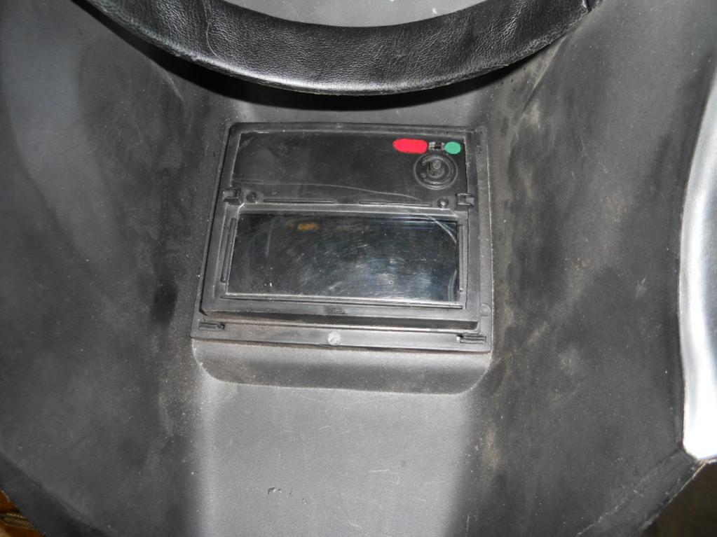

    My generic Chinese auto-darkening helmet is acting up and I'm trying to take it apart without much success. I can get the corners of the unit separated slightly, but then it doesn't seem to snap apart like most plastic housings I've run across. Any ideas before I resort to brute force?

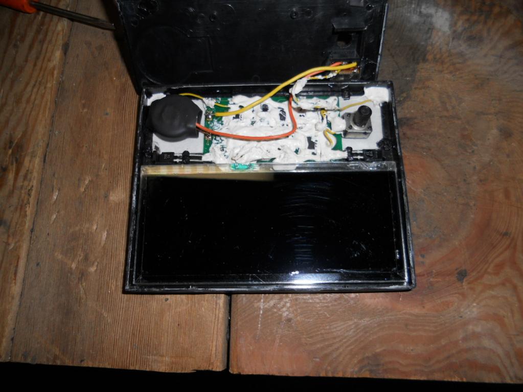

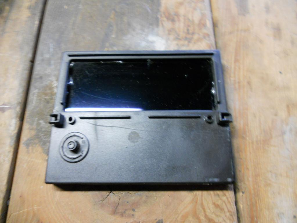

    Woohoo! Got it working again. Living 150 mi from the nearest welding store kinda ruled out just going out and buying a new one. I'm just glad I didn't have to resort to the old pill helmet with the #13 lens, would have been cutting with a white cane.
    I do think a quality one will be in order before too long, but at least I can keep working. It is amazing how much the view improved just by peeling off the protective film, wish I had done that years ago.
    Now, for anyone who might want to do this someday:
    Turns out it was glued, but it popped right open without damaging anything.

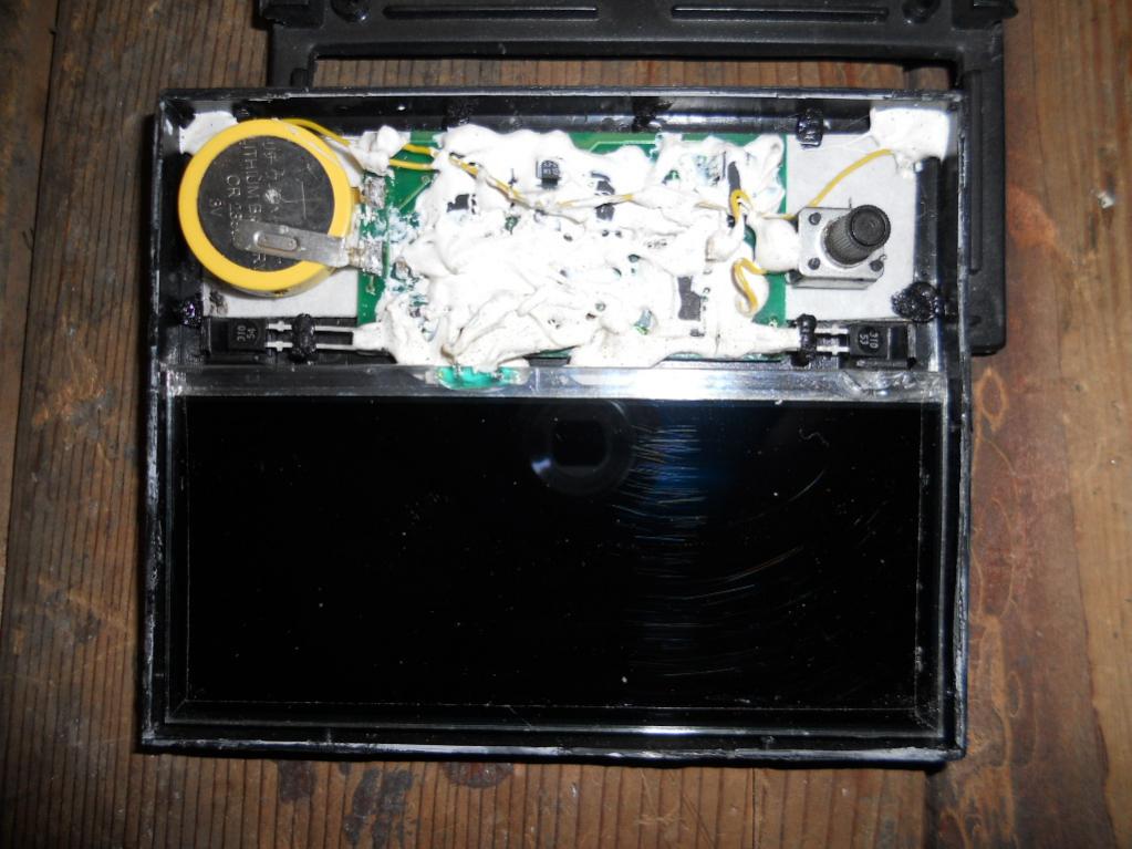

    Yet another reason I want a TIG, properly made battery packs. Between the wires and the heat shrink, it came out quite a bit thicker than the original and I wasn't able to reglue the case shut. Fortunately, the front bezel on the helmet keeps it sandwiched satisfactorily.

    While I was at it, I decided to put a switch to kill the power from both the solar cell and battery (the negatives had a common tie-in point) and give myself a grinder mode.

    Northern tool and equipment sells the 3v lithium batteries 9 for $4

    If you can wait a couple of weeks, DealExtreme has batteries even cheaper, with free shipping. They don't seem to have the exact size, but in this case there was no holder to fit, so no biggie. YMMV
