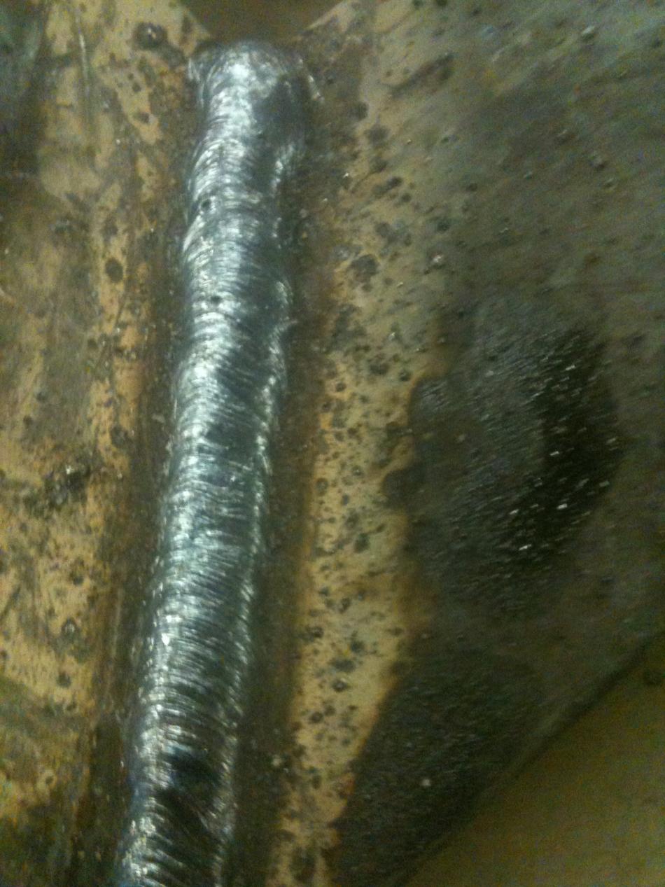

    So i was wondering what everyone's input is on these welds. I used 1/8th inch 7018 ac at about 125 amps.

    Nice straight welds, the speed gives the ripple shape. One thing, on the angle joint, because 7018 is a low pen. rod you could expext a stronger flatter joint had you gapped the jointed wider. Sometimes our fit ups are too tight to get the rod deep and we end up with a weld on top that has to be ground down and then it is weaker.
    Thanks. And yeah if it would of been something that needed to be strong i would of put a gap in it but really it aint gonna go through much stress and it is welded on the inside on both parts so its gonna be plenty strong. Some of my welds had tiney holes in them as you see in pic 1 and 4 on the top side. Do you know what causes that. A few on the inside has a bunch throughout it but they dont show so it dont really matter but im just wondering what might be causing that

    Pinholes can be caused from too long of an arc, or contamination from the metal.

    Rod angle can do it as well.

    porosity can come from alot of different places. oil is definatly a big one, make sure that the metal your welding is CLEAN CLEAN. the bead looks like it is a little large, a little faster travel speed and a longer arc will make the puddle more fluid and "wet" out more. if your only using 1/8 rod i suggest turing the heat down a bit. unless your going for production and on a time limit, a lower heat setting will give you more control over your puddle. i also see quite a bit of spatter, that could be from dirty base metal, or just too high of heat setting again. 7018 is a great rod to burn, and you can make it look real nice too. keep up the good work. does your highschool provide a trade program so that you can get into the trade earlier?

    Porosity can be caused by Arc blow (too high rod to metal distance), and in the case of 7018, old rods that have sucked up moisture. Rule of Thumb for rods is: a 60 series rod has between 1/8 to 1/4 arc gap and a 70 series rod has between less than 1/8 to a drag on the base metal

    Jerkey your prolly right. It might of been some oil on it. And they porlly would of been a bit smaller if i gave it a little gap but i was going for A good tight fit. And 7018 burns good at like 120 usually. So i was close to that. And O i will. Hoping to find more projects to do soon. And yeah next year and the year after im going to go to a career center for half the school day. Get a good head start then after that im planning on going to tulsa welding school.

    Them holes are caused by gas coming up from some where, 7018 rods can get moisture in them in a very short time frame, right out of the air, in an hour or two after the package is opened.
