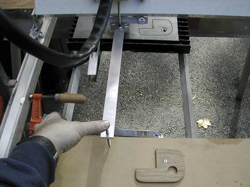

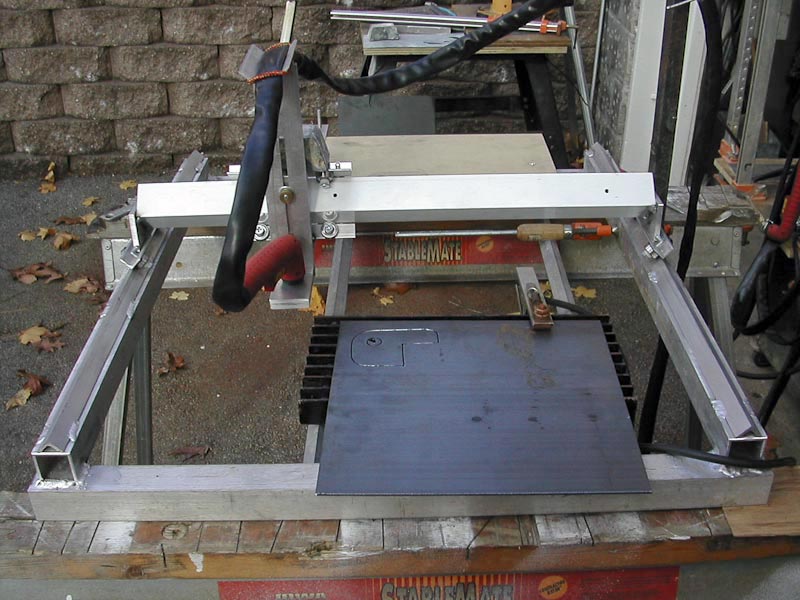

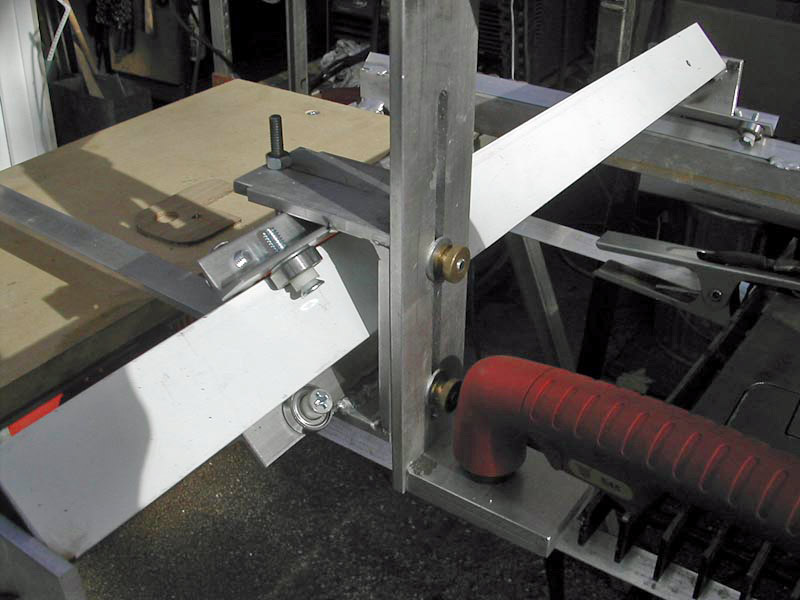

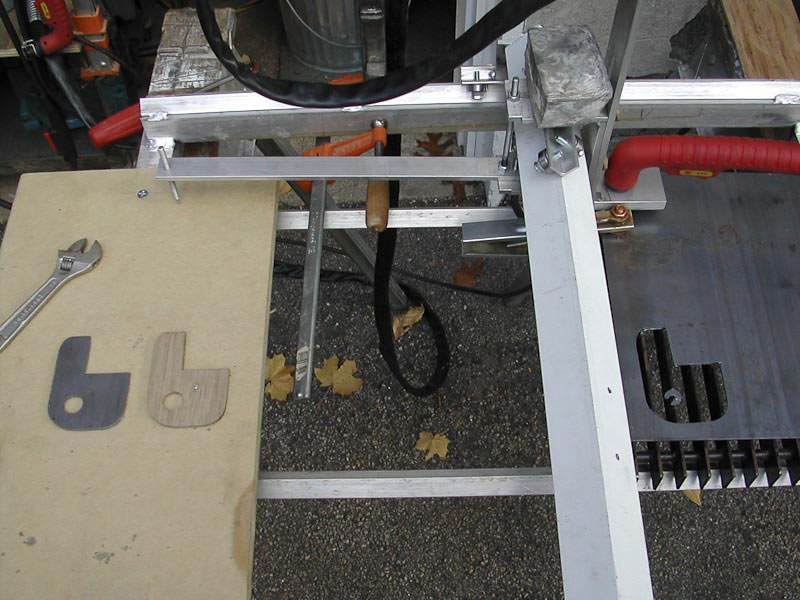

    I bought the PP50 and quickly figured out that I am terrible at cutting out parts with it. So I thought get a small CNC machine until I looked at the prices ! That is how I ended up with this project. It is small and very easy to setup and put away so I find myself always using it. I first make a pattern from 1/4 plywood or similar and screw it down and then just trace around it with the stylus.

    That is pretty cool. Very simple.
    Do you hold onto the torch as well and pull the trigger yourself? Looks like it would be pretty stable and easy enough to hold both the stylus portion and the torch.
    That's a very clever pattern tracer. I'd say that has commercial value for those you can't afford to build or buy a CNC. Care to post any plans?
    I like the idea that the patterns are so simple. You could design in CAD, print out a 1:1, and then cut even very complex parts out with a scroll saw or similar and still maintain high accuracy.
    Great idea. I'd like to see video of it in action as well as plans if you're willing.

    That's awesome! What size bearings did you use for wheels? The arm you attached the stylus to, have you had any torsional issues, or does it slide smooth enough?

    I presume you would just use the 4T setting, pull the trigger once for on and pull it again for off.
