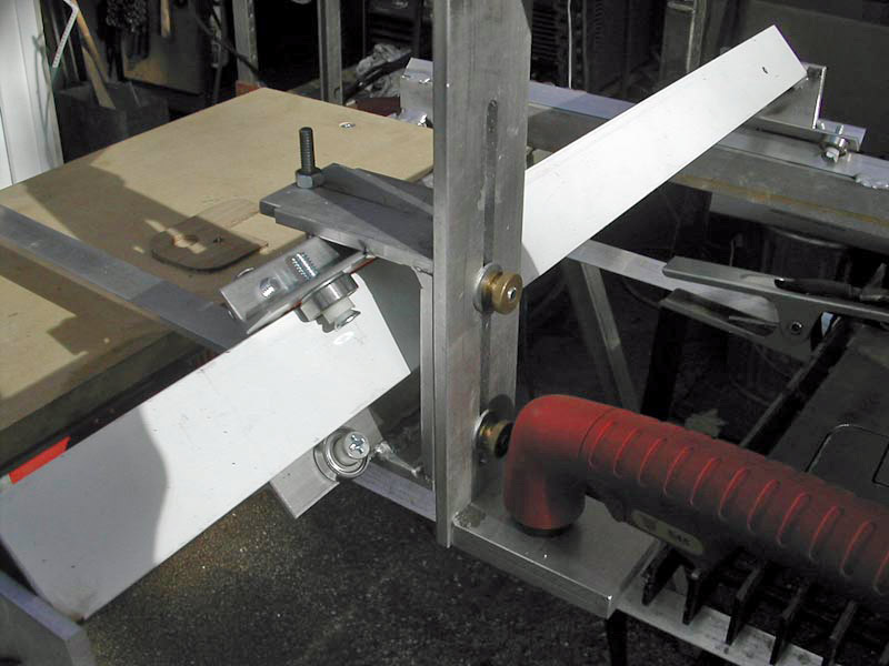

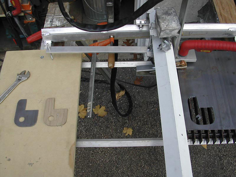

  1. Default Project 1 Plasma Cutter Pantograph
    I bought the PP50 and quickly figured out that I am terrible at cutting out parts with it. So I thought get a small CNC machine until I looked at the prices ! That is how I ended up with this project. It is small and very easy to setup and put away so I find myself always using it. I first make a pattern from 1/4 plywood or similar and screw it down and then just trace around it with the stylus.
