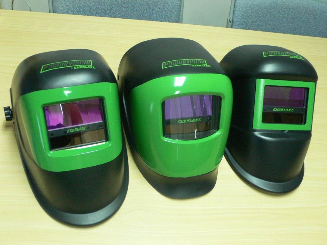

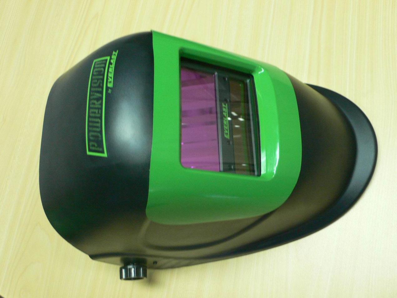

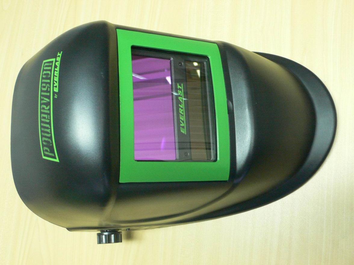

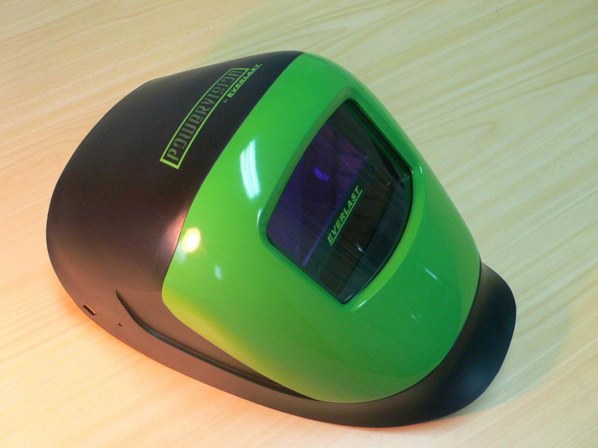

    Default Everlast Welding Helmets PowerVision series
    You have been asking for them... They're here!!!...well on the way.... This is a sneak peak and prices are yet to be determined. Detailed specs well be posted later, but we will have auto-darkening, 4 sensor units with 9-13 shade, units with 7-15 shade, 2 sensor units with 9-13 shade.
    In September, we will offer an auto adjusting shade unit that senses the flash intensity and adjusts the units to the appropriate shade automatically.
    All units feature temperature compensation technology that automatically adjust the shade to compensate for temperature changes that affect LCD technology.The switching time is among the fastest in the industry at 1ms.
    They have a wide range of rated operation temperature from 14F to 140F.
    They have changeable lithium ion batteries with solar assist, up to 5000 hours of operation time before changing. They have audible low battery alarms so that it will alert you when the time comes.
    They also have digital controls and read outs. Even the cheapest model will have full analog controls over shade, sensitivity and delay.
    The filters and helmets carry CE certification, real certification, not just a stamped logo.
    And, the prices will be the best in their class...watch for them soon.

    The helmets also offer 100percent UV/IR protection at clear state, even with battery failure.

    We may have a new helmet design to offer so we will make the decision on the final helmet configuration this week...After that it is a simple matter of confirming and then it goes on from there. We want to be absolutely sure that the helmets are in as good as the filters. The current helmets are good, but the factory has offered us a new design possibility that would reduce the styles/parts needed to support the after sale customer care. So, we will review it in the upcoming week and finalize that decision. I expect helmets here in time for an early Christmas present....Maybe earlier.
