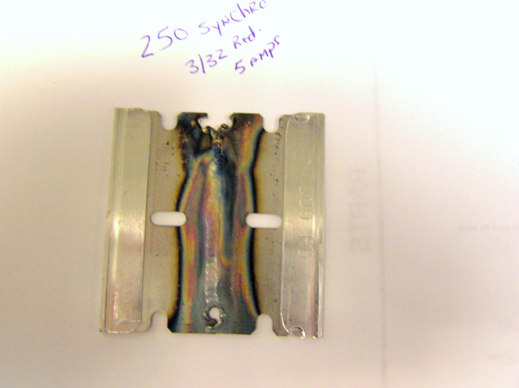

    Most seem to be using 1.5% lanthanated around here. The two lws stores here stock 1 lb containers of filler, and one of them if they are out will sell you out of a 10 lb box by the pound if need be.
    I think most people would be fine with 1/16" and 3/32" 2% lanthanated tugsten with an inverter machine. I have welded 2 razor blades together with a 250 Synchrowave @5 amps with 3/32" tungsten. It wasn't easy to start but got it done by scratch starting because the HF blew out the metal before the arc started.(see leading edge in pic.) Can't wait to try this with a 250 EX. This sounds like it will go over good with customers as long as u can keep the $ at a decent level.
    I am working with Oleg to become a dealer in the PA MD area. i also was thinking of this same package and also would like to give some customers that need it, some low cost lessons with purchase of a unit.

    Quote Originally Posted by Velocity View Post
    Either at their place or mine.
    Price is a very important point that needs to be considered but in all honesty i think it is something that we can be very competitiive on. You also need to keep in mind that offering filler rod is not something we expect to make a lot of money on but it is something i would like to offer to our customers. I feel by offering the Variety pacls we are in fact helping our customers in getting started in a fairly cost effective way. This gives them the opportunity to to try a variety of sizes ( and materials if it comes to that ) without putting out as much as they may have to by purchasing individual sizes.
