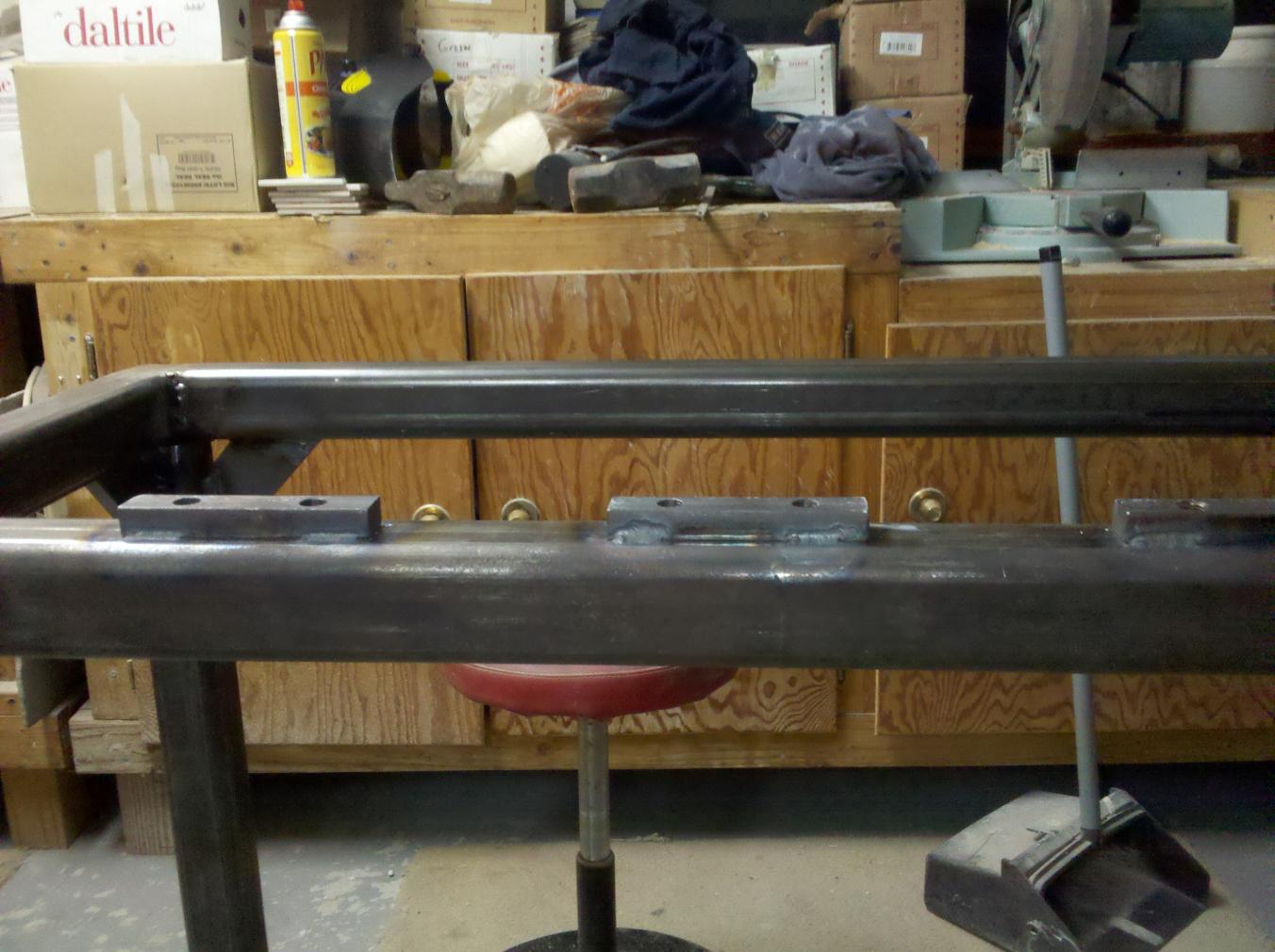

    well I got the Table framed up 2" square .250 wall throughout, 1/2 plate gussets on the legs and 1000lb casters. started welding the Plate risers in place. Just a short update and a pic for now. will have more this weekend. Everything is flat too I can put my straight edge across any point and no gaps or high spots. Just need the money now for the 6 5/8 x 6" x 48" Plates .... $300 +-

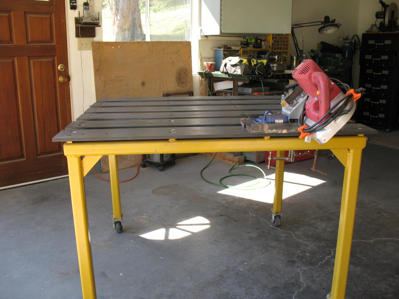

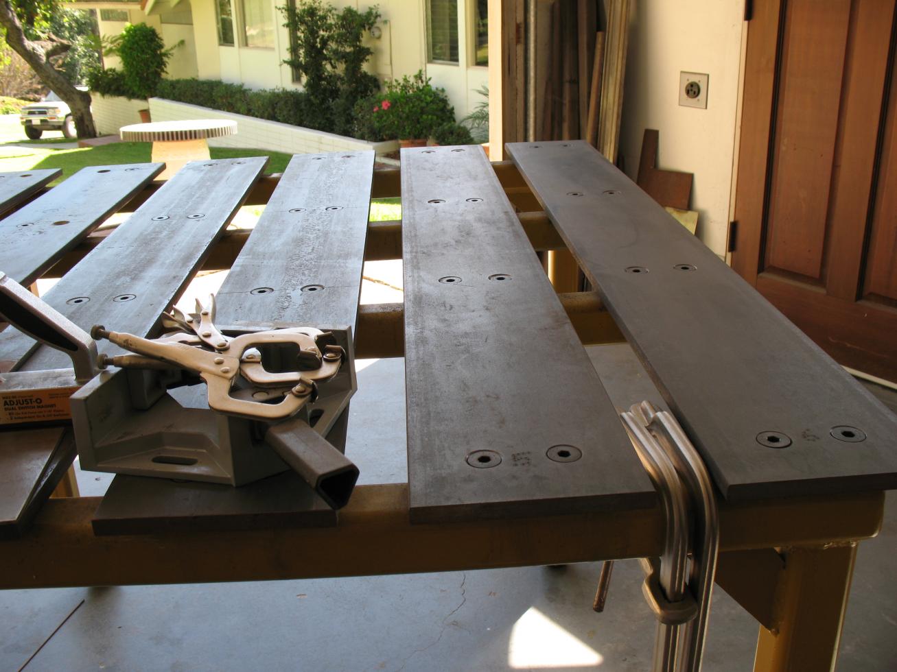

    Just a quick update, i totally forgot about using this thread with the finished product. Any way, this is what i finished up with, very happy with it for under $400.
    Took this picture a while back. As you can see the top plates bolt on so replacing the plates is very easy. Since i took this picture i have made a couple of mods. I have an adjustable height 2" receive on 2 of the legs this allows me to "plug-in" a couple of small tables. One is just a grate for doing my cutting on and the other top tilts fwd/back - left/right . Really nice... once i have my work clamped in place i can get to all sides from my seated position.
    The biggest pain was truing up the top, started with shims at first but since then have installed .250 set-screws that i can access from the under side to level each plate independently and in relation to each other. Accurate to as few thousands, good enough for my needs.
    Another option would be to hand scrape those mounting blocks. That would give better bearing and you wouldn't have to worry about the screws putting dents in the plates.

    Cost: about $450 compared to 1900.00 for an actual strong hand unit, since I have more time than money it's well worth it to me. On the new table I will be drilling the holes for the fixtures as I just got a new mag drill , I picked up a new rotobrute that accepts annular cutters which will make light work of the 57 holes per plate. I've already sold this table to my brother in law for 600.00 and he is delighted with that price.

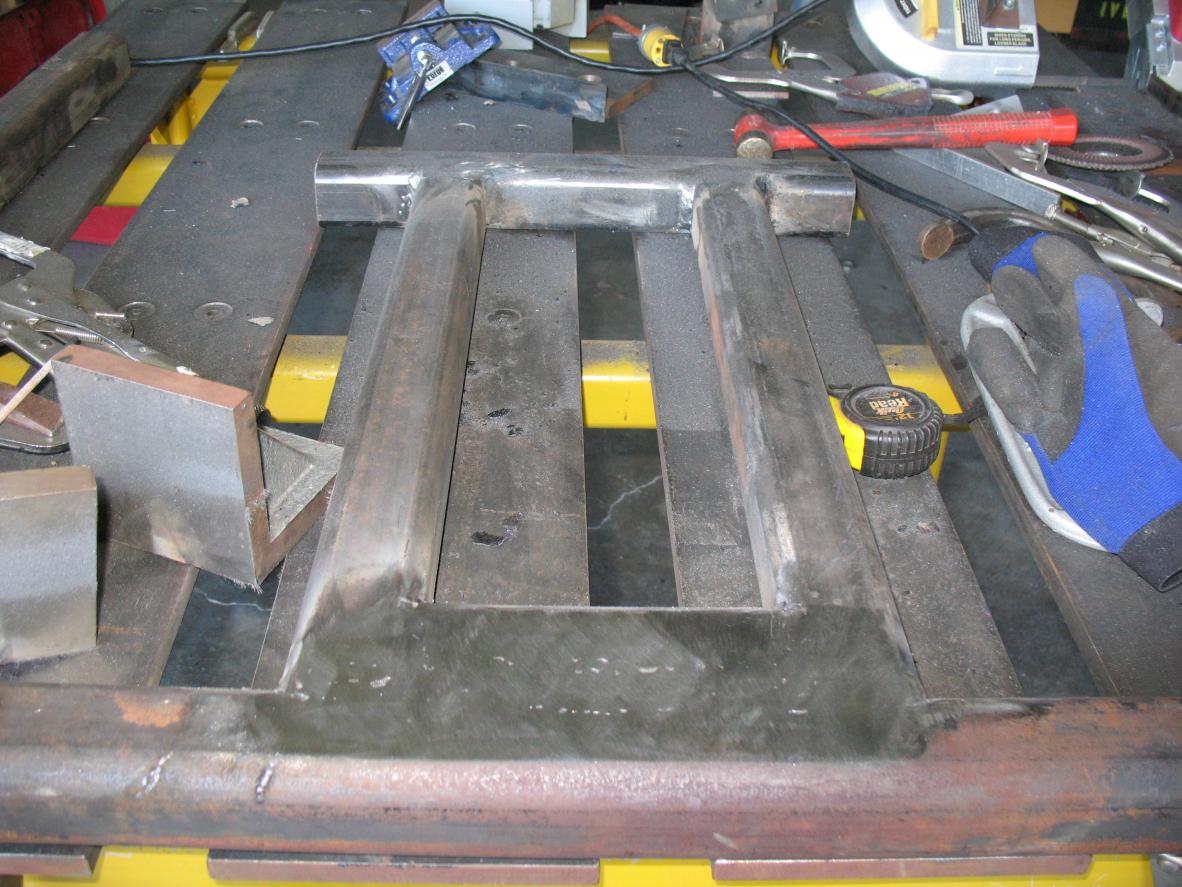

    OK I know I'm a Procrastinator but I finally got the pictures of the Table I built and the start of another tubing bender can't go in to to much detail on the bender as the plans are sold but will put it in projects, but can only show the build as the plans are sold here.
    http://www.gottrikes.com/Tube_Bender.htm
    anyway here is the table it's only taken me like a year to get around to posting the pictures LOL . also check out my Harbor Freight bandsaw mounted in chop saw fashion. Will eat a piece of 2" sq .250 wall tubing in 20 seconds and it's quiet. that could be a whole nother project. I'm switching the saw to a Milwaukee deep throat soon as it has a slightly wider opening as well as being able to cut thicker material. Right now I can cut a 45 on 2" sq as long as I trim it close first with the Milwaukee I wont have to trim it to 45 the 2" sq tube.
    the last 2 pictures are the base of the tubing bender before and after cleaning it up a bit. Im just welding in the support for the end of the ram, Im just arc welding it because it's fast and I've got a lot of arc rod I need to use and I don't have a mig welder ( I really need one for this kind of stuff ).
    And I know Im a messy worker. and I still havent got around to drilling the top plates ( that doesn't bring in any cash LOL )
    And I know there are a few bolts missing from the table top, they got thrown away by mistake while I had the end plate off and had to steal a few random ones to reattach it till the new ones arrive from McMaster Carr.
