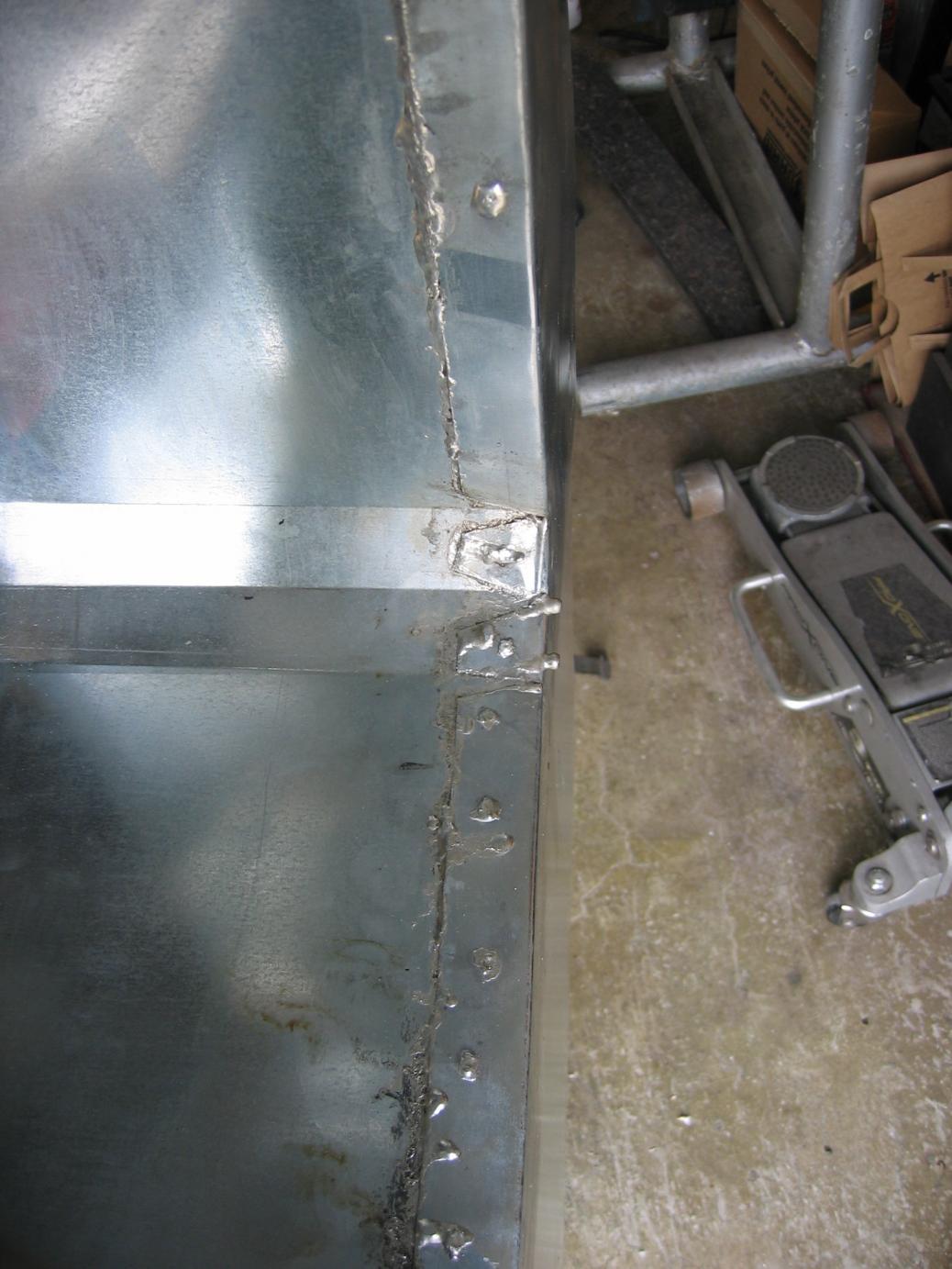

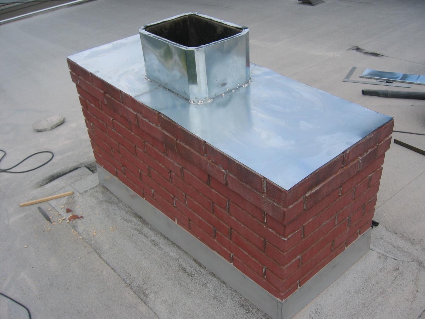

    I'm building a sheetmetal base for a new chimney cap for my house. Sheetmetal thickness is in the area of .010"-.015". It will sit on top of the brick chimney, and will have a cast in place concrete cap poured on top of it. The completely waterproof sheetmetal base will be another layer of water protection. I am going to put some drip edge flashing pieces around the perimeter (and the cap will overhang over the brick a little bit.) All the sheetmetal joints are lap joints, although there were a few spots where I had to fill some gap, and I also filled some screw holes (where I had some self-piercing sheetmetal screws I used to temporarily hold the sheetmetal pieces together.)
    I haven't had any luck getting my aluminum-zinc brazing rod to stick to bare steel. It just sits on the surface of bare steel, but has no or very weak bond. I wonder if I am just missing a special flux that would allow it to wet out and adhere better? I have a high zinc content, "cold galvanized" spray paint I used before, but unlike a solid metal coating, it's not as durable. (Little impact strength; easy to scratch it off.) That is why I have tried to preserve the zinc plating by soldering. If I knew how to reliably reapply a zinc plating or similar, it would be really good to know.

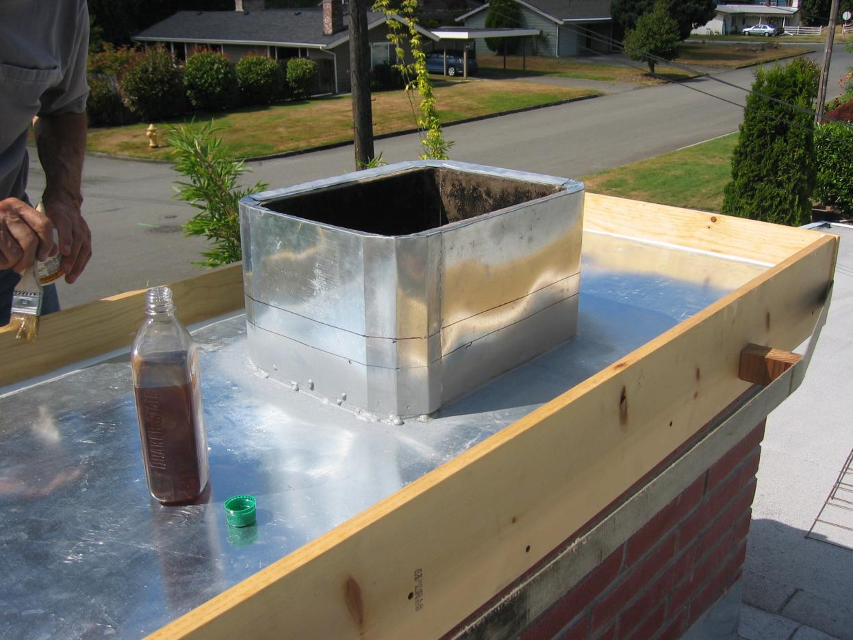

    I got the project all done guys, it's ready for the rain.
    The sheetmetal is buried under 4" or so of concrete chimney cap slab. It turned out really nice. Dare I say, the best looking chimney cap in the neighborhood.
    I am new to concrete work, this was my first concrete pouring (but I enlisted the help of a skilled old hand at it; my old man.) I'll have to post some pictures of the end product (with the formwork removed and everything) if anyone is interested in seeing. Here are some before the formwork was removed.
    I ended up spraying the cold galvanized over the flashing after all (and it got harder than I thought it would, after a few days baking in the hot sun, which I was happy about. To scratch off with fingernail, had to be pretty aggressive):

    Here is the flashing installed, with formwork around it, before the concrete pouring:

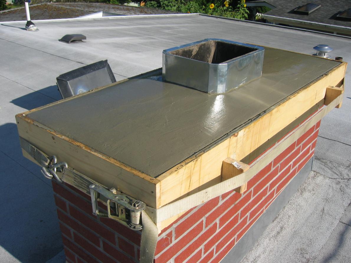

    And after the concrete pour:
    I hope it fixes the pesky water infiltration problem around the chimney I was having last couple winters. Last summer I re-flashed the roof around the chimney, but it leaked again last winter, and there was efflourescence (whisish powder) out of the brick as well, all indicating moisture problems. So this summer I repointed all the exposed brick, and re-did the chimney cap. If that doesn't solve it, there must be some problem with one of my flat roof seams. Part of the joys of owning a "retro modern" 1950's era home I guess.

    Mike - That's motor oil. Keeps the concrete from adhering to the wood form. It worked like the charm - the wood form practically fell right off.

    Regarding why the concrete, it is the material of choice for chimney caps; much more long lasting than a mortar chimney cap. Apparently the lime in the mortar gives it a reduced life expectancy. However, it is the stuff of choice for something to put between the bricks.

    How I joined the flashing: I joined the sheetmetal in the middle around the flat flashing piece to the piece that goes around the flue liner with solder as I have shown in the pictures. The first batch of solder nice ol' good tin/lead without flux core, and the second batch of solder lead-free with flux core. For joining the sheetmetal around the outer edge (there is a drip edge piece along the edges of the cap, I used silicone caulk to join that. Waterproofing is not as important there. Anything that leaks out there is just going to run down along the drip edge anyway.

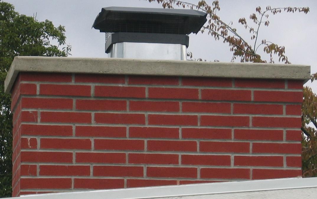

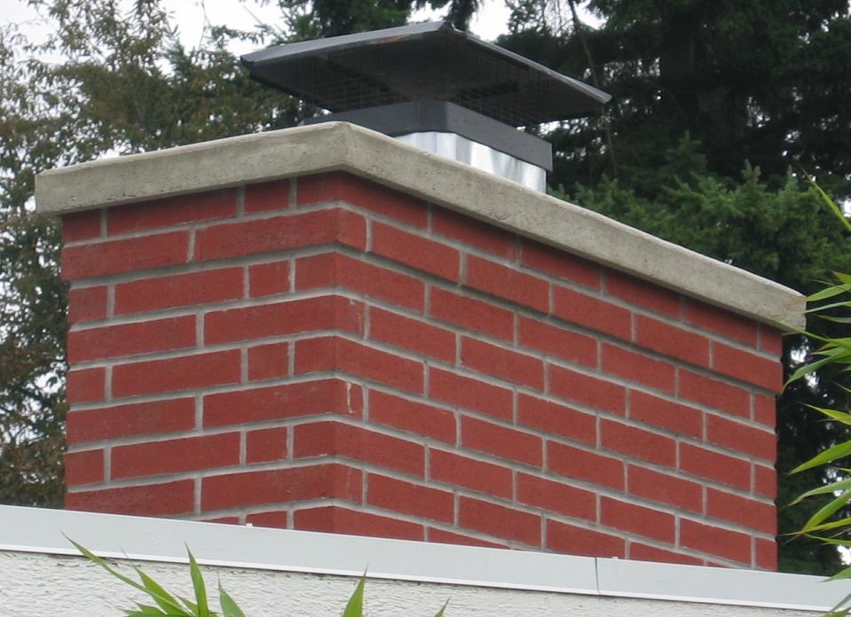

    I took some pics of the completed chimney cap from below (didn't get up on the roof):
    The drip edge under the concrete cap turned out really good.
