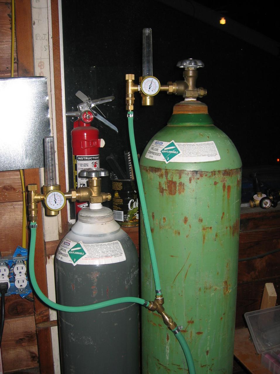

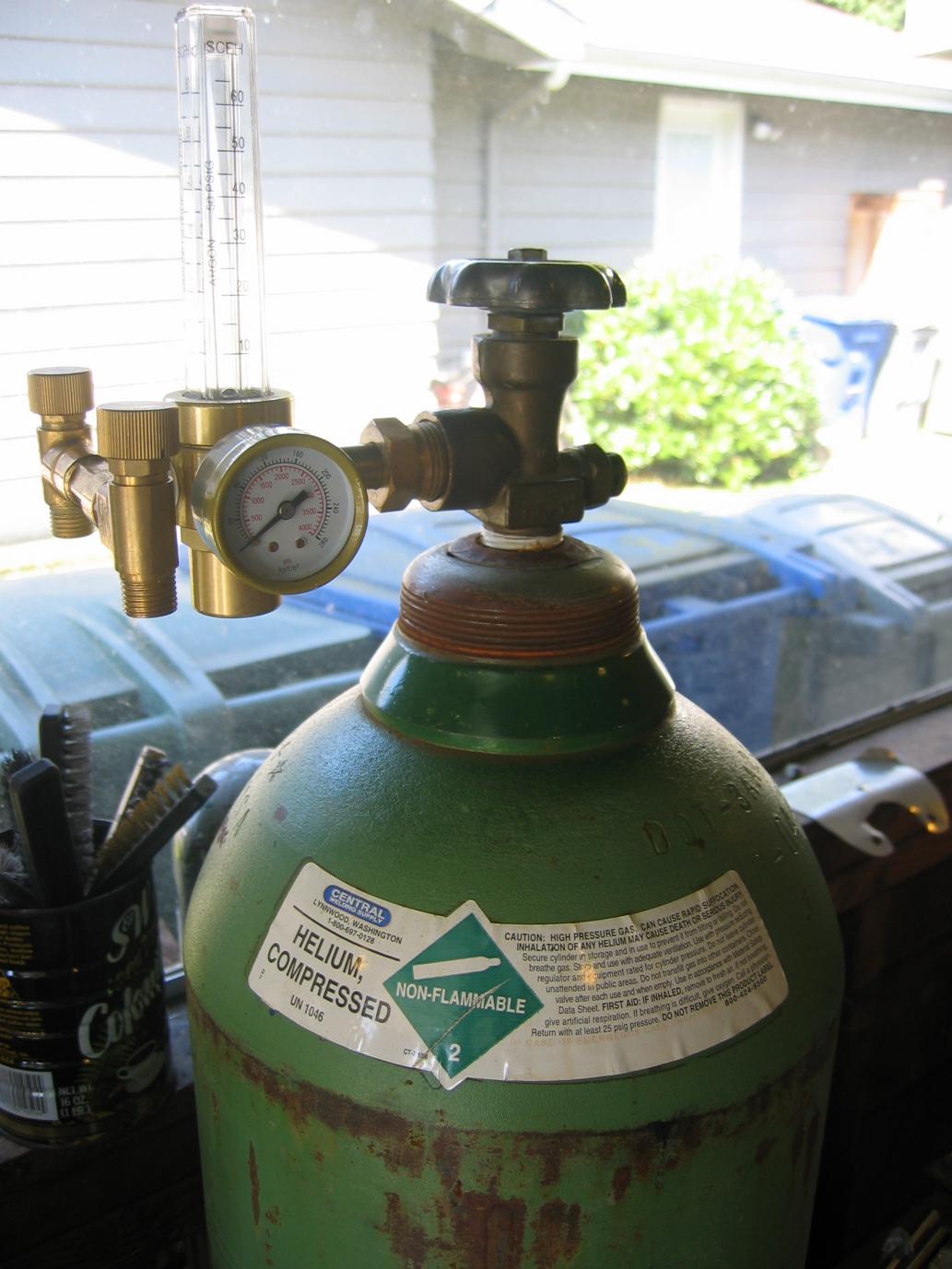

    I got a new welding toy to play with... a bottle of Helium! (Old 155cf Argon, meet your new pal: 330cf Helium!)
ID:	3021 Click image for larger version.
    I found the tank on craigslist as basically an empty tank for $100, and it came with a balloon filling gauge/regulator. I then got the tank filled (exchanged) from my local welding supply for another $120 out the door.
    I was hoping to be able to mix the helium and argon with a "Y", but I measured one of my regulators puts out 30 psi and another puts out 50 psi, (so I think that might not work too well.)

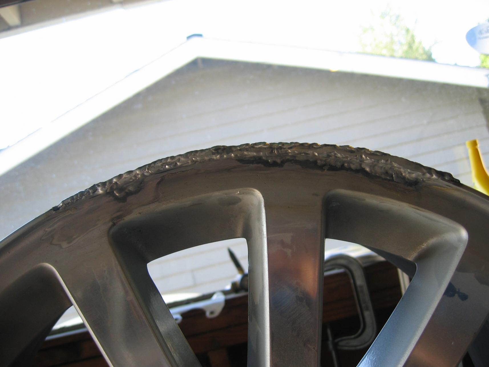

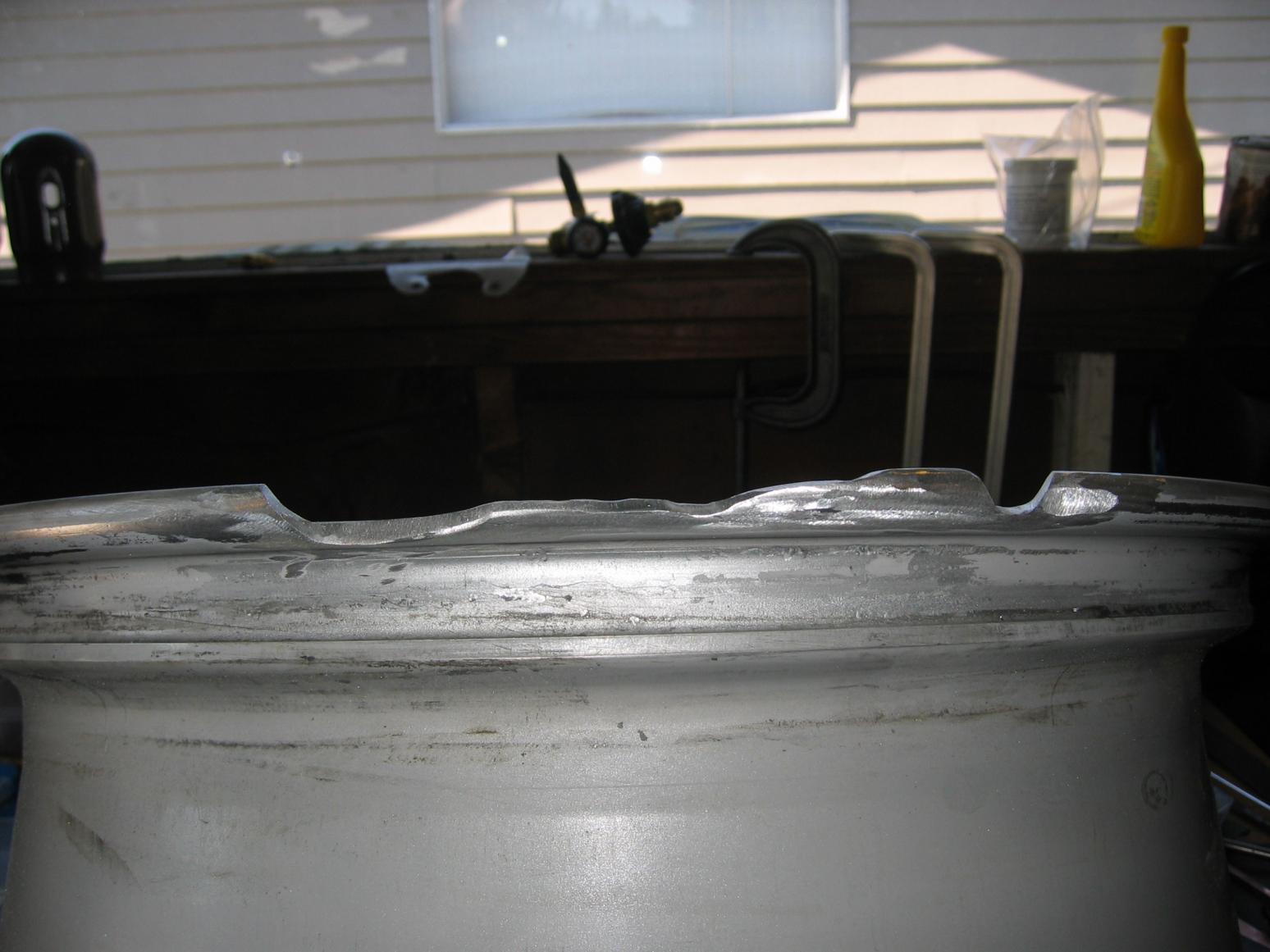

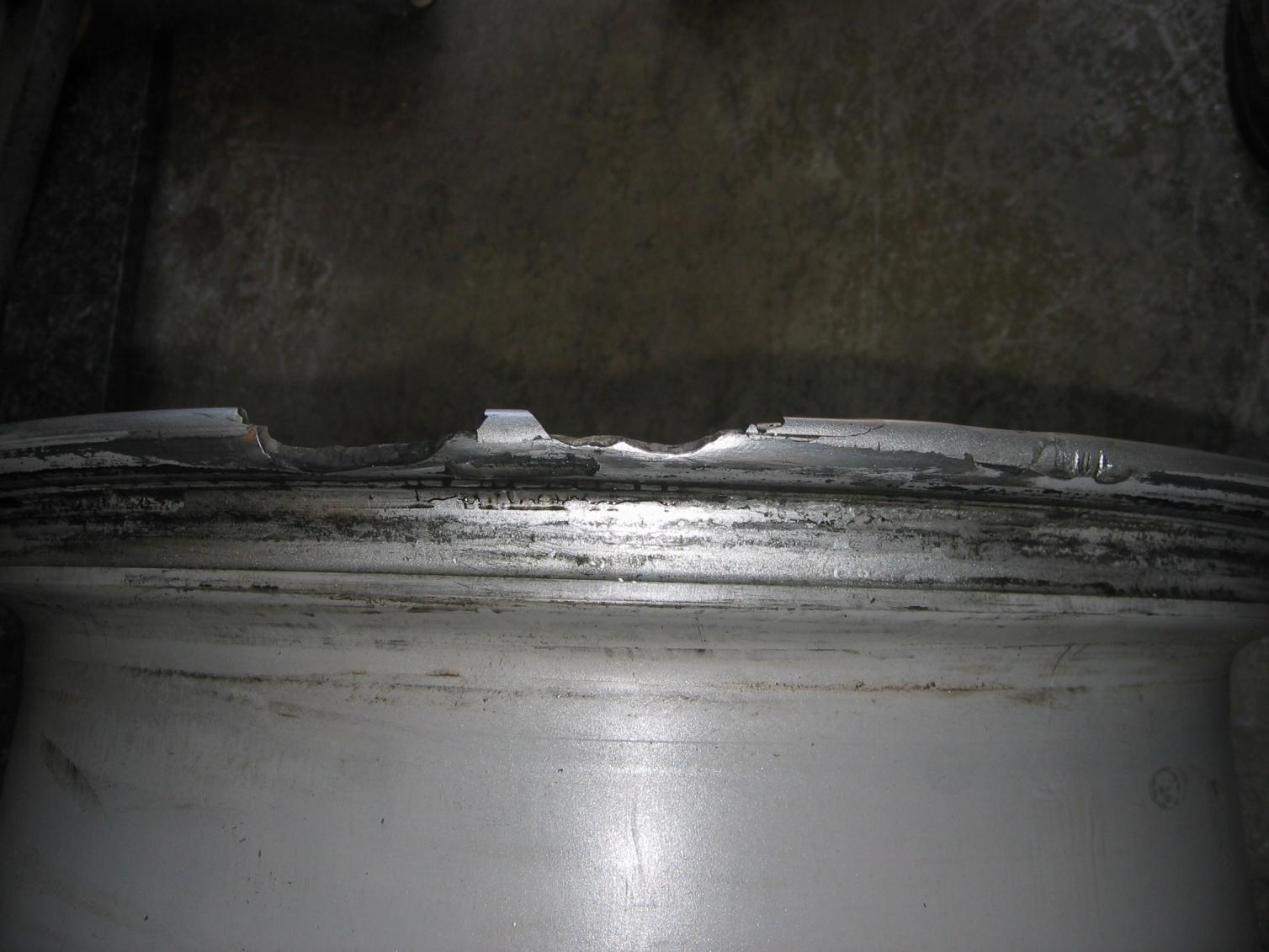

    This aluminum wheel will be my first experiment (and also a paid welding job) where I will try the Helium. The outer wheel lip was previously repaired with bondo/body filler, which cracked out when a tire was being mounted, a poor repair solution. I hammered and ground it all out (and I even found an extra "hidden pocket" of the stuff! Tapping with a hammer, the filler sounds dull compared to the sharp metallic ring of aluminum), and prepped it down to fresh aluminum surfaces with a flap wheel.
    Before prep:
ID:	3024 Click image for larger version.
    After prep:

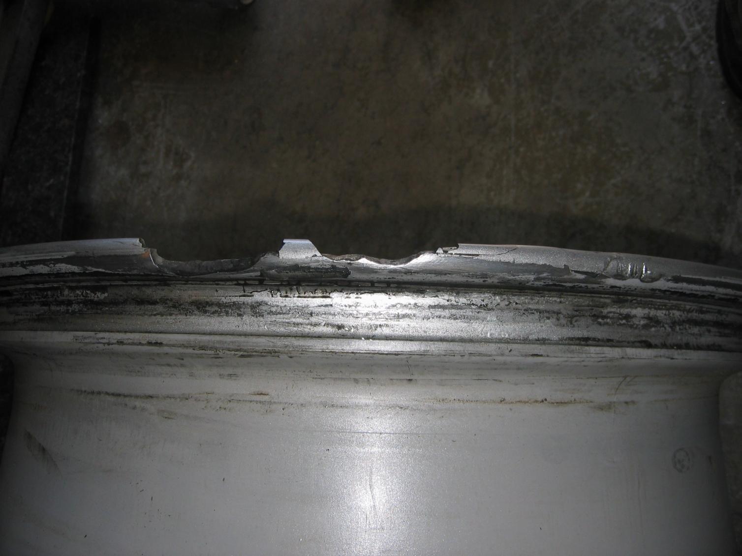

    For the Helium test, I set up everything up for welding just as I would if I were using Argon: 3/32" 1.5% lanthanated tungsten (sharpened with blunted tip), 20%EP (AC mode), and footpedal for current control (with full machine output of 200 amps current at wide pedal down.) And I used a #6 stubby gas lens with 15 cfh gas flow.
    First thing I noticed when starting the pre-flow, was the floating ball in the regulator floats up and down with some more "springiness" in Helium than it does with Argon. And the sound of the Helium coming out of the torch even sounds different (quieter) than argon.
    The arc through Helium was definitely harder to start than it was through Argon. (I was thinking, it was good that I was using a lanthanated electrode and not pure or zirconiated, which tend to be even more difficult to start!) I was really amazed how I had an instant puddle on the cold aluminum wheel, even with very light current. The footpedal position that what would have just "etched" the surface with cleaning action on Argon, actually left a 3/16-1/4" wide swath of melted metal surface on Helium! So with Helium, it wasn't possible to just "etch" the surface, it was melted aluminum surface, or nothing at all. (Crazy stuff!) I don't think I ever floored the machine; it felt like I did most of the welding at 20%-40% pedal depression. I have a feeling I would have been running double the current or more if I was using Argon and may have perhaps floored it, at least at the start.
    Anyhow, I was getting some black "smut" on the outer edges of my weld area I haven't figured out yet, but I think it's because the lightweight Helium shielding gas is doing a 180 degree turn out of the cup and floating upwards. I'll have to try pumping up the cfh and see if it cleans up the dirtiness next time. Amazingly, it wasn't anything that posed any problems welding over - I was able to melt through it effortlessly with a new puddle. It did just look a little bit like hell. (No problem on this application, all the surface will be getting ground off anyway.) The surface of the puddle however looked bright and shiny under the arc - no oxides floating on the surface were noted.

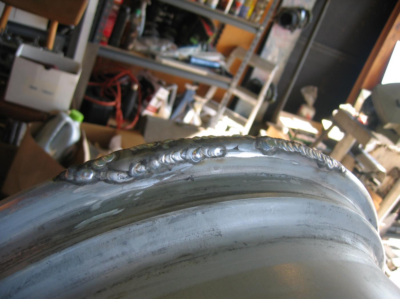

    After some grinding (because I got a little filler rod feeding happy on the first pass ), I did a second welding pass to further fill in and 'touch up' any low spots. I also noted that the aluminum deposited in the first pass I ground down, was totally solid and free of porosity and inclusions (a good thing!). And after the second weld pass I'll say, it's ready to go back to my wheel repair customer for them to further work over. (They will further grind/smooth, straighten as needed, and paint.)

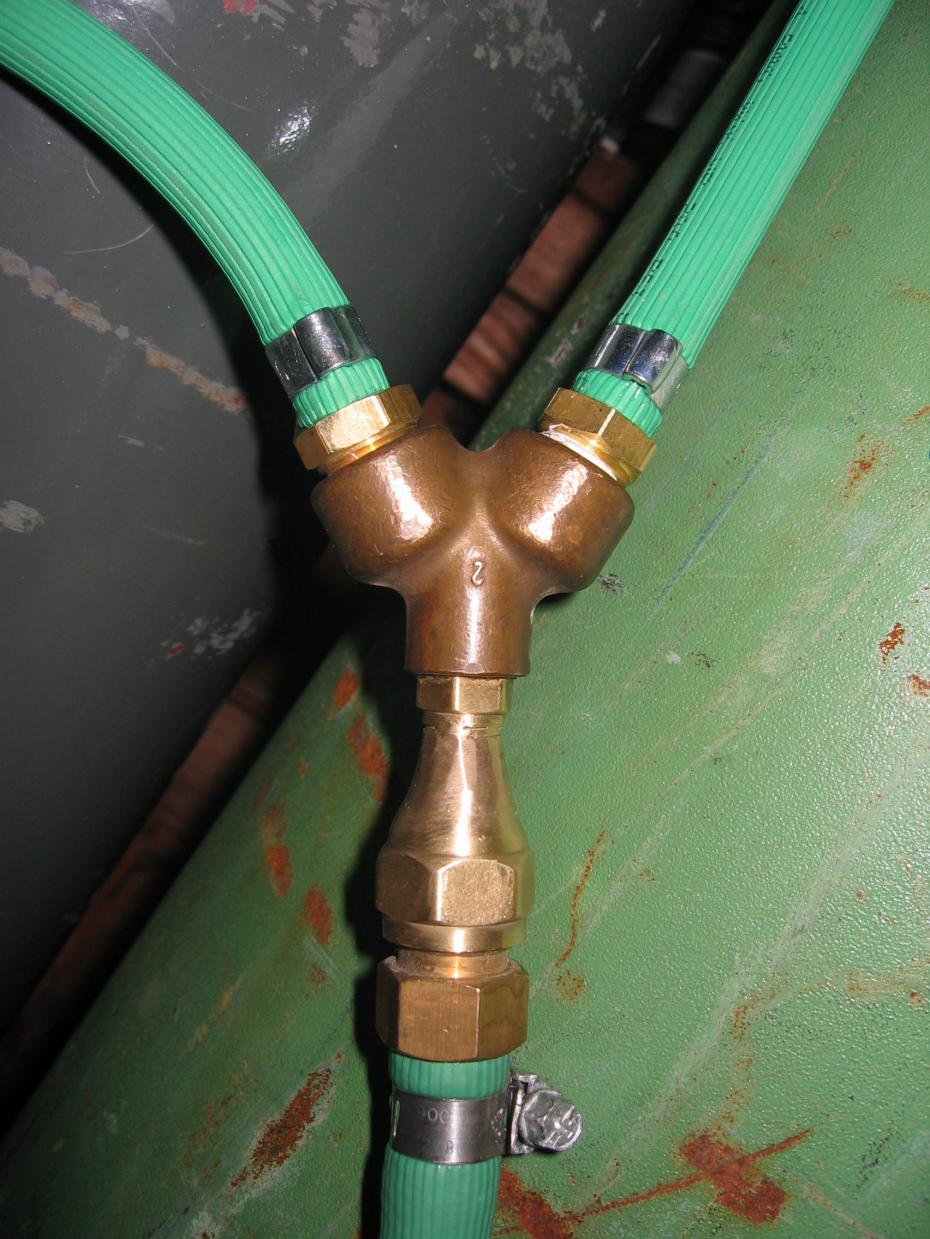

    I'm excited because I'm up and running with not only a fresh argon bottle, but I also now have a "Y" setup. I've tried it so far, just flowing gas out of the torch (haven't done any arc tests yet), and so far so good. Both floating balls respond instantly when the gas solenoid opens, and adjusting one of the gas flows does not impact the flowrate of the other - perfect. I incorporated 1/4" NPT fittings into the "Y" connection, so I may be able to add checkvalves on later if desired. I put a standard outlet fitting (5/8-18 flare I believe) on the outlet of the "Y", so I can connect the same hose that connects direct to a regulator to the outlet of the "Y" (or back the other direction) as needed. (This was easier said than done... I had to weld two brass fittings together to make it happen!) Good stuff.
ID:	3071 Click image for larger version.
    Edit: I just did some quick tests on various He/Ar mixes, run back to back. 0% He, 33% He, 66% He, 100% He, then repeated the sequence again, and a few other things. Just small 1" long beads run on 1/16" flat stock with 1/16" filler rod. I found something interesting only on the pure (100%) He, the glow of the arc was actually red in the middle, just off the tungsten. Around the red glowing zone, it had the normal green glow. On all other mixes, the arc didn't have the red glow at all, it was only the usual green. (This is though my auto-darkening lens, of course.) Pretty cool.
    I did all my test with 20% EP (minimum AC Balance my machine goes to), and it seems the 33%-66% He mixes could be useful in reducing the ethed zone while still providing some necessary cleaning. The 100% He had oxides in the puddle and a "crazed" cathodic etch pattern in the surfaces around the weld bead. I used 15 total cfh for most of the tests, but I did try boosting the cfh with heavy He concentrations to improve cleaning (I think I boosted it to 20cfh, which didn't seem to do much; maybe I need to boost to something crazier, like 30cfh.) This is with a #5, non-gas lens cup. I wasn't finding any evidence of smut or soot (of any kind) on any of these tests. I'm really glad I have the ability to vary the mix, and didn't get a pre-mixed bottle, this is cool. Oh yeah back to back going from He mixes back to pure argon, definite increase in the amount of foot pedal depression to get a puddle. I was using a 1/16" tungsten.
    There is a definite difference in noise of the He vs the Ar (as well as any major change in the relative mix) coming out of the TIG torch cup. In fact, after I vary the mix, I can hear it when the new gas mix starts making its way out of the TIG torch. (Doesn't take long for the new mix to get to the cup, about 2 seconds with my setup, I'd say.) Different noise the gases make "whistling" or "hissing" out of the cup, (or through the orifices in the collet body, perhaps.)

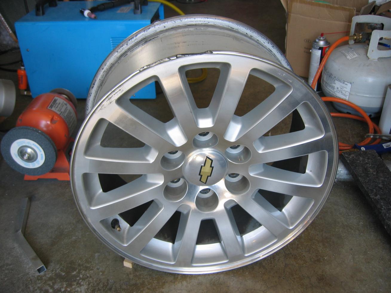

    Any finished pictures after grind and polish? Or did you hand it off and say "there ya go".
    The customer is a professional wheel repair company, (and they are very skilled at grinding, straightening, and painting), so when doing welding jobs for them I worry about: leaving no low spots, leaving no stress risers (especially if it is likely that they will be bending them straight afterwards, as they usually do this immediately after receiving my welded wheels before and grinding), and leaving no porosity in any weld deposit. I don't need to worry about grinding, polishing, and painting, as this is what they do (and they do it really well; you usually can't even tell the wheel was worked on after they are done with it.) I'm pretty happy with the arrangement.
    I have done some final grinding/polishing on wheels but they are usually one-off projects for friends, and for some reason I seem to never take pictures of those projects. I did one for my brother about a week or two ago, it was an old bare polished aluminum wheel for a 1960's Chevy van. (They call them "mag" wheels but they were really aluminum.) Reconstructed the inner wheel lip where it was broken off. Ground the welded bead down with a flap wheel using a light touch and taking my time. No paint. Oh, we did do some "hot bending" with a weed burner and a big hammer on the wheel lip beforehand on that wheel too.
    Just last night, I ground some "curbage" out of the outer wheel lip of a painted cast wheel for a friend. (Purely for cosmetic reasons.) He had selected and tested a spray paint that was a near perfect color match, he was going to shoot over it. Didn't get any pics of that one either.

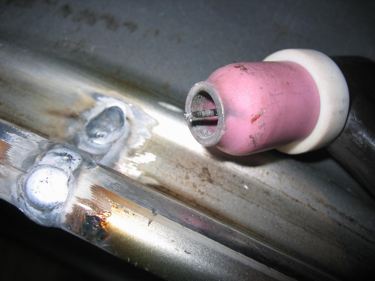

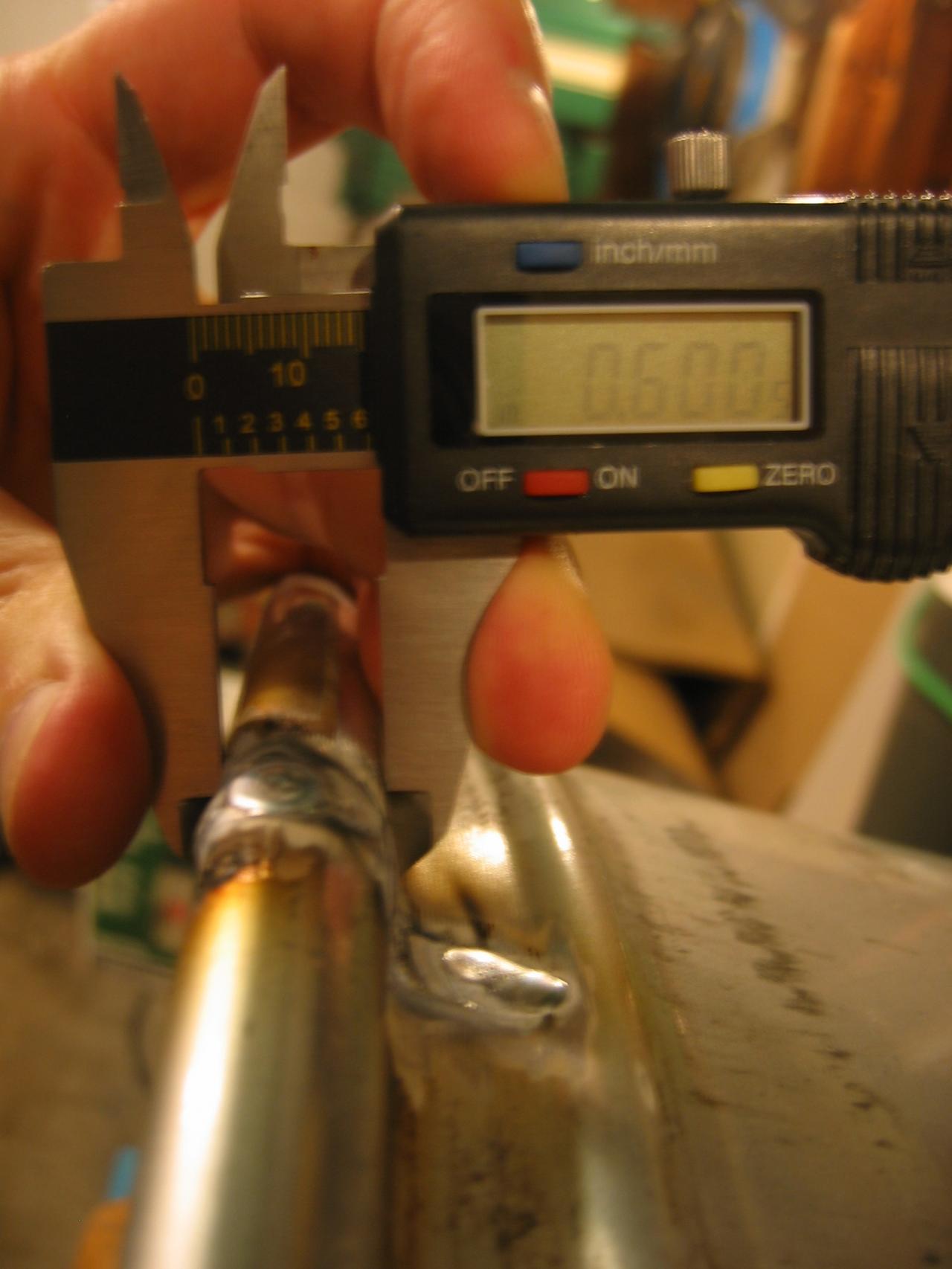

    Something remarkable I've discovered with the helium mix, at least at high penetration AC Balance settings (80% EN), is that it seems to take a lot of heat off the tungsten compared to using the same current with pure argon.
    Check out the pictures below. This was a crack repair of a .6" thick lip of an aluminum, automotive wheel, which is about the thickest wheel lip I have seen in such an application. It was also a 20"x9" wheel, and further stored in below freezing shop, so pretty big heat sink that needed a lot of heat to weld... 200 amps sustained for several seconds at a time, to be precise. I did grind a vee with a carbide burr on both sides and weld both sides, as was necessary to pull this off with full penetration with anywhere near of as narrow of a weld bead as is shown.
    I used the same helium mix I have been using for a few months now for a lot of my aluminum, which is, in the general ballpark mix of about 25% He. But get this... I did this with a 1/16" tungsten! Sorry I didn't take a before pic, but it started out as a truncated point, like a crayon shape. It is a 2% lanthanated. Here is what it looked like after:
    It's got some "multiple protrusions", (so is definitely pushing the current limits on it without balling it), but, what's amazing to me is, how the tip didn't melt right off and drop into the aluminum puddle, or even completely "ball" at this current level! I am almost certain if I were using pure argon at 200 amps sustained for several seconds, it would have melted at least a pretty nice sized ball, and maybe even dripped the molten tungsten tip right off. What do you guys think?
    So, putting aside the benefits of the extra and penetration per amp that Helium allows, it seems like there is an additional benefit, that it allows you to run a smaller tungsten (providing further more focused, controllable, and penetrating heat on thick materials.)
    End result: the crack in the .6" thick wheel, I was able to repair with full penetration (from both sides) with the Helium mix and a 1/16" tungsten, with a measured bead width of only .35", (that's just a little bit over half the thickness of the material) without really even trying that hard. I don't think that would have been possible with pure argon.
    (Now in hindsight, I could have further turned up the He% to try further increasing heat per amp, and probably welded this without even needing 200 amps, but I wanted to try this thick wheel with my "usual mix" to see how the tungsten would hold.)
