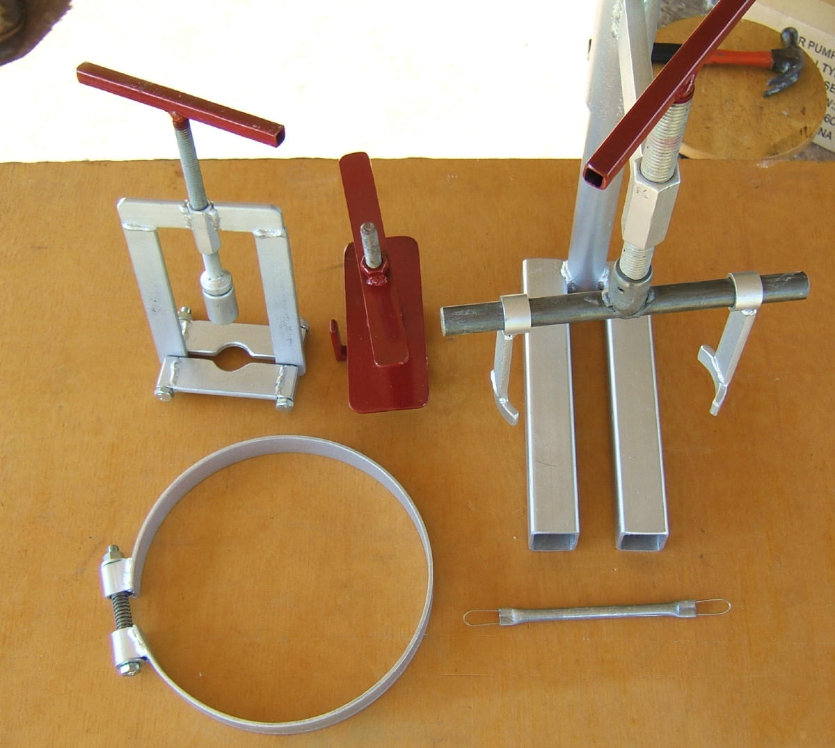

    Hi A coupling nut is the better way to have a longer threaded part.
    Here are some trans tools I made years ago one is a pump puller and the other is for compressing clutches. Worked great on th350 and 700r4 trans.
    You can buy them at Home Depot or hardware stores many sizes.
    have fun
    Tom
