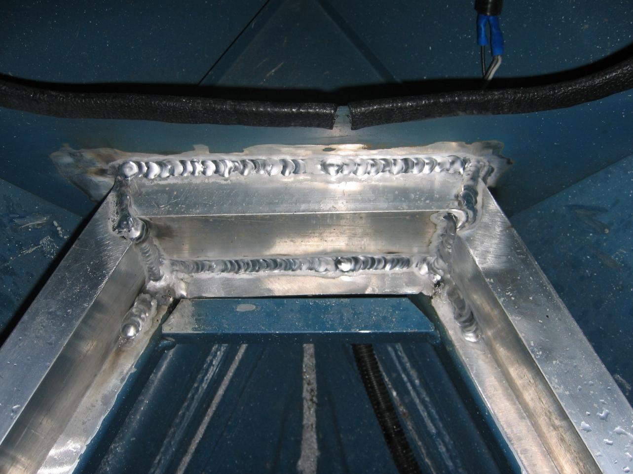

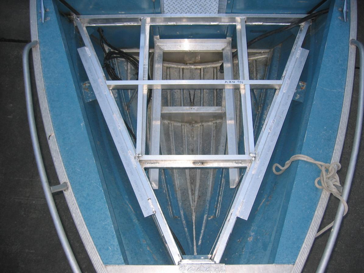

    I welded a fuel tank support into the hull of an aluminum boat, and a structure to raise the deck above it up higher, to provide room for the top of the tank.

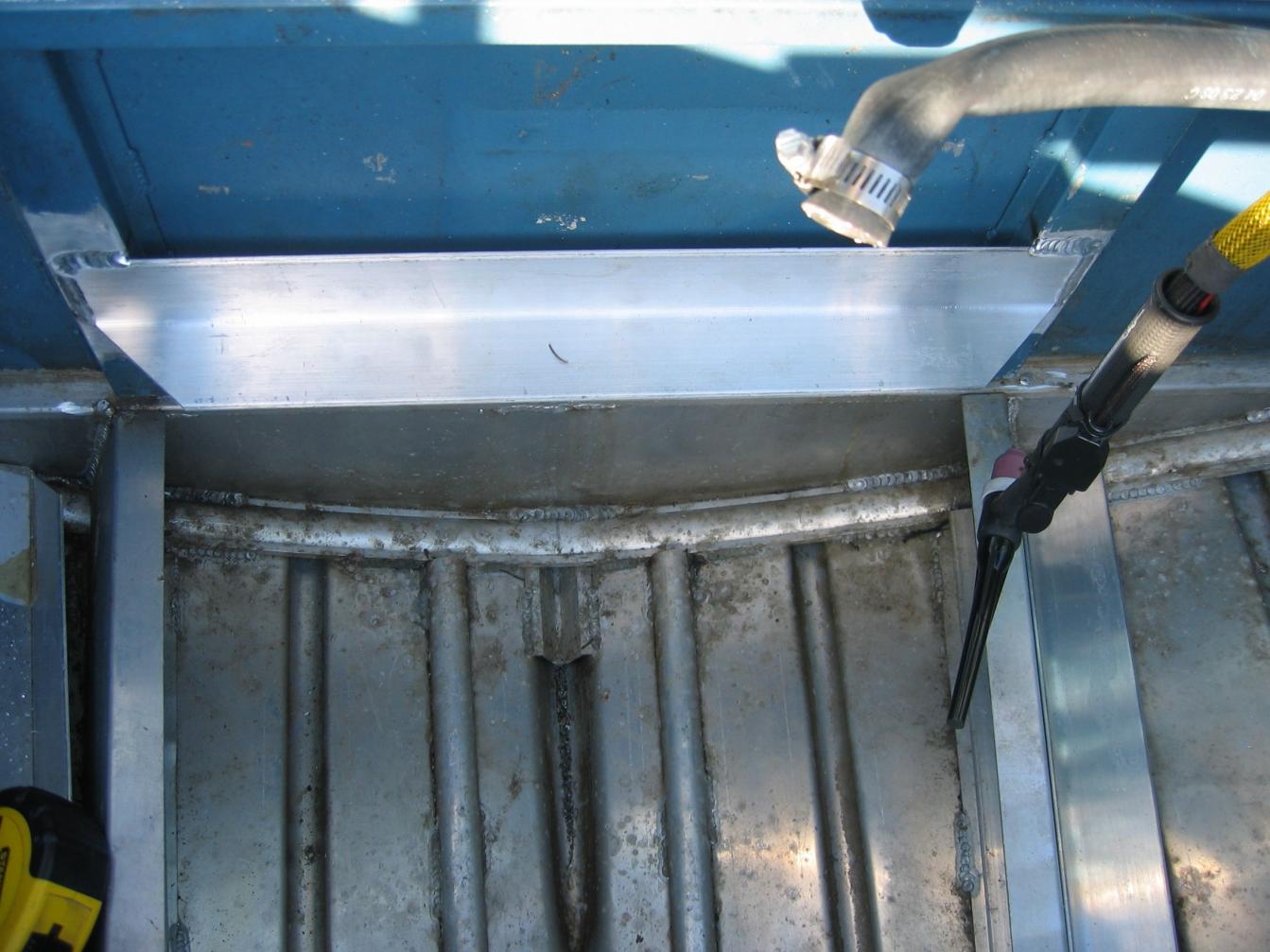

    Here are the welds on the actual fuel tank support, down low in the hull of the boat. I used the torch switch at I think somewhere in the area of 180-190 amps, with 1-2 seconds of post-flow to feather the heat down where needed. Went through quite a few sticks of 1/8" 5356 filler rod on this.
ID:	3005 Click image for larger version.

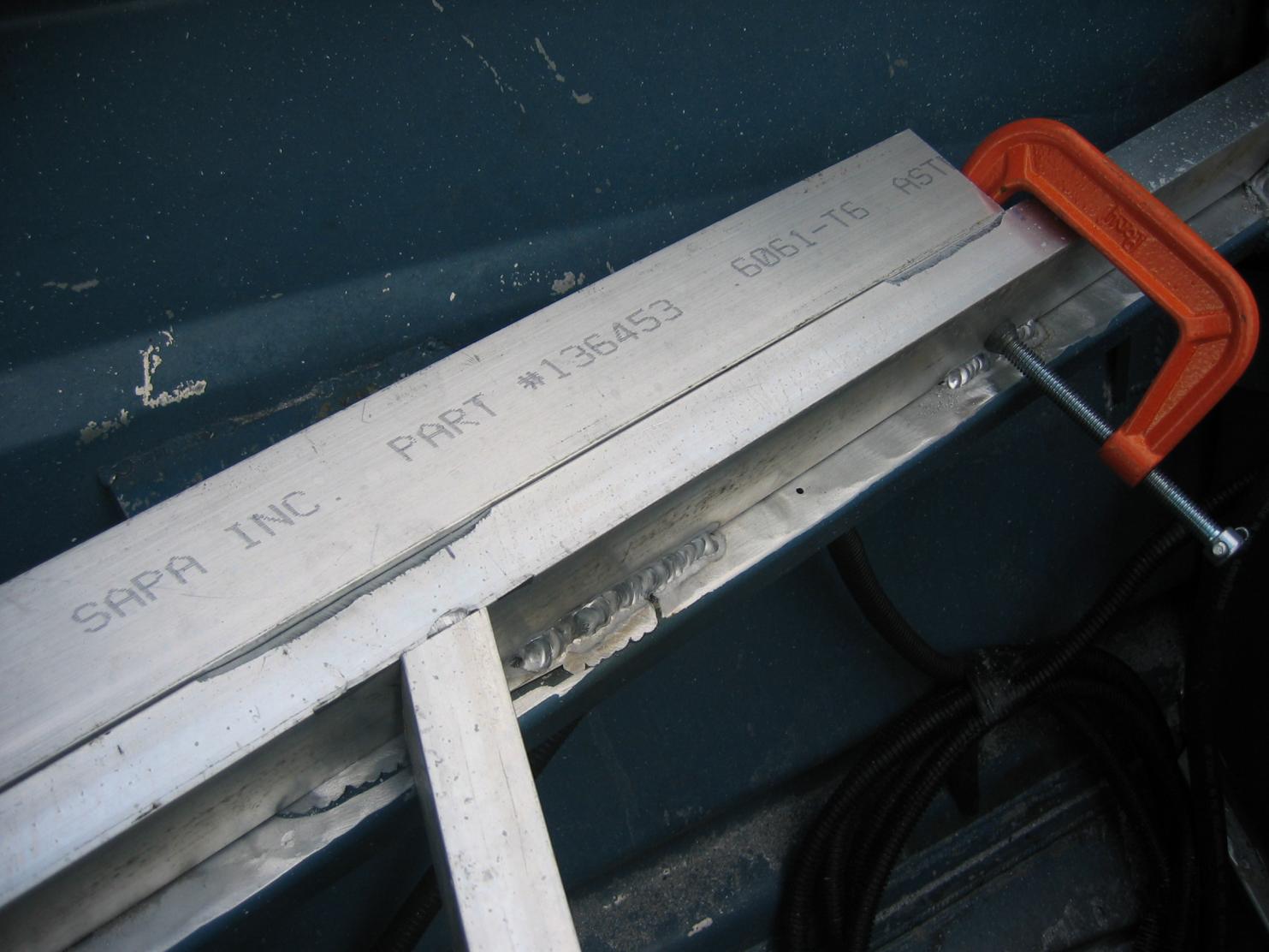

    A lot of this extruded aluminum alloy was 6061. When welding 6061 to 6061, it's important to provide a space for filler rod to be added into, to dilute the puddle and avoid hot cracking. You can see I beveled the edge of some rectangular (6061) tubing where some (6061) angle would be stitch welded to it. I did not want to build up a tall raised bead, because this structure needed a flat surface to support a deck above it.
    Here is how those top surfaces turned out:
ID:	3006 Click image for larger version.

    The piece labeled "no weld" is removable (tight-fitting in its slot) for being able to access the fuel tank below.
    This section in the bow was tricky to weld with the torch switch, thin wall it had to be welded to, etc. But, think it will hold?

    Overall shot
