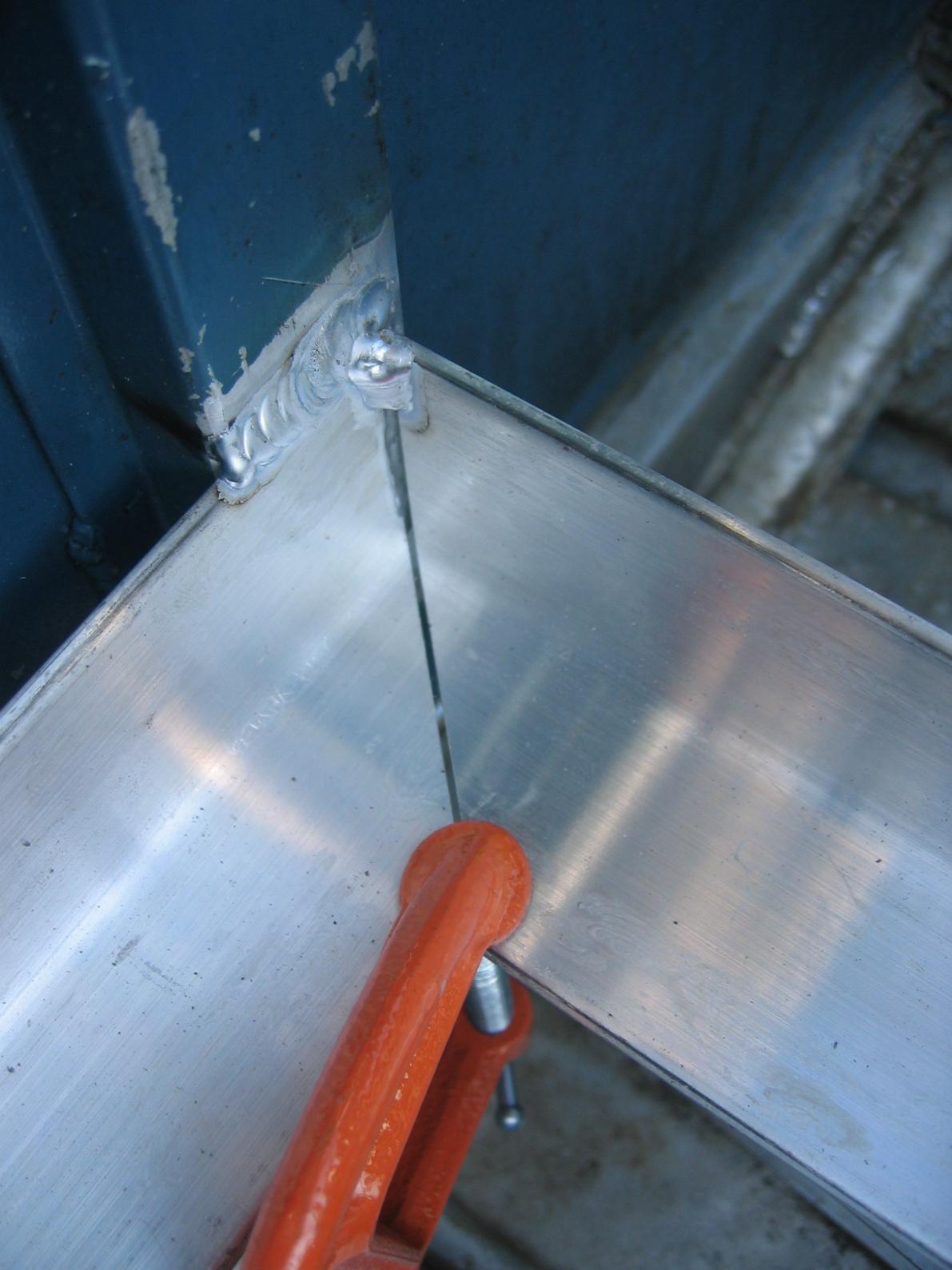

    Here are the welds on the actual fuel tank support, down low in the hull of the boat. I used the torch switch at I think somewhere in the area of 180-190 amps, with 1-2 seconds of post-flow to feather the heat down where needed. Went through quite a few sticks of 1/8" 5356 filler rod on this.
ID:	3005 Click image for larger version.
    C-clamps were useful for jigging up the pieces.

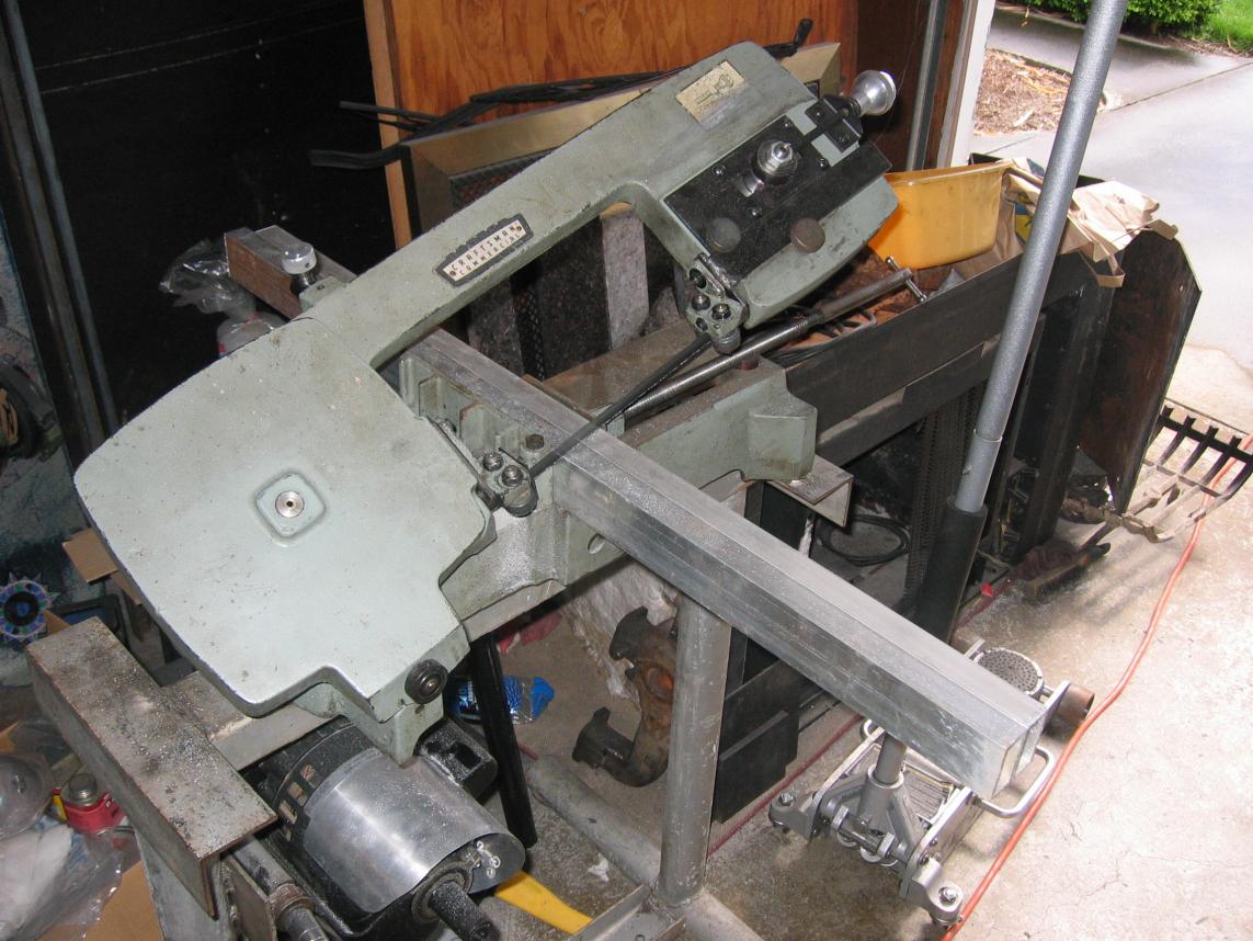

    I cut some pieces with the horizontal bandsaw (It's a natural for cutting tubing/bar stock, such as this)
    Other tools I made use of are, a 4.5" angle grinder with a flap wheel (for removing paint to prepare surfaces for welding) and also a nonferrous grinding wheel (for removing material, to fine-tune the fitment of the pieces.)

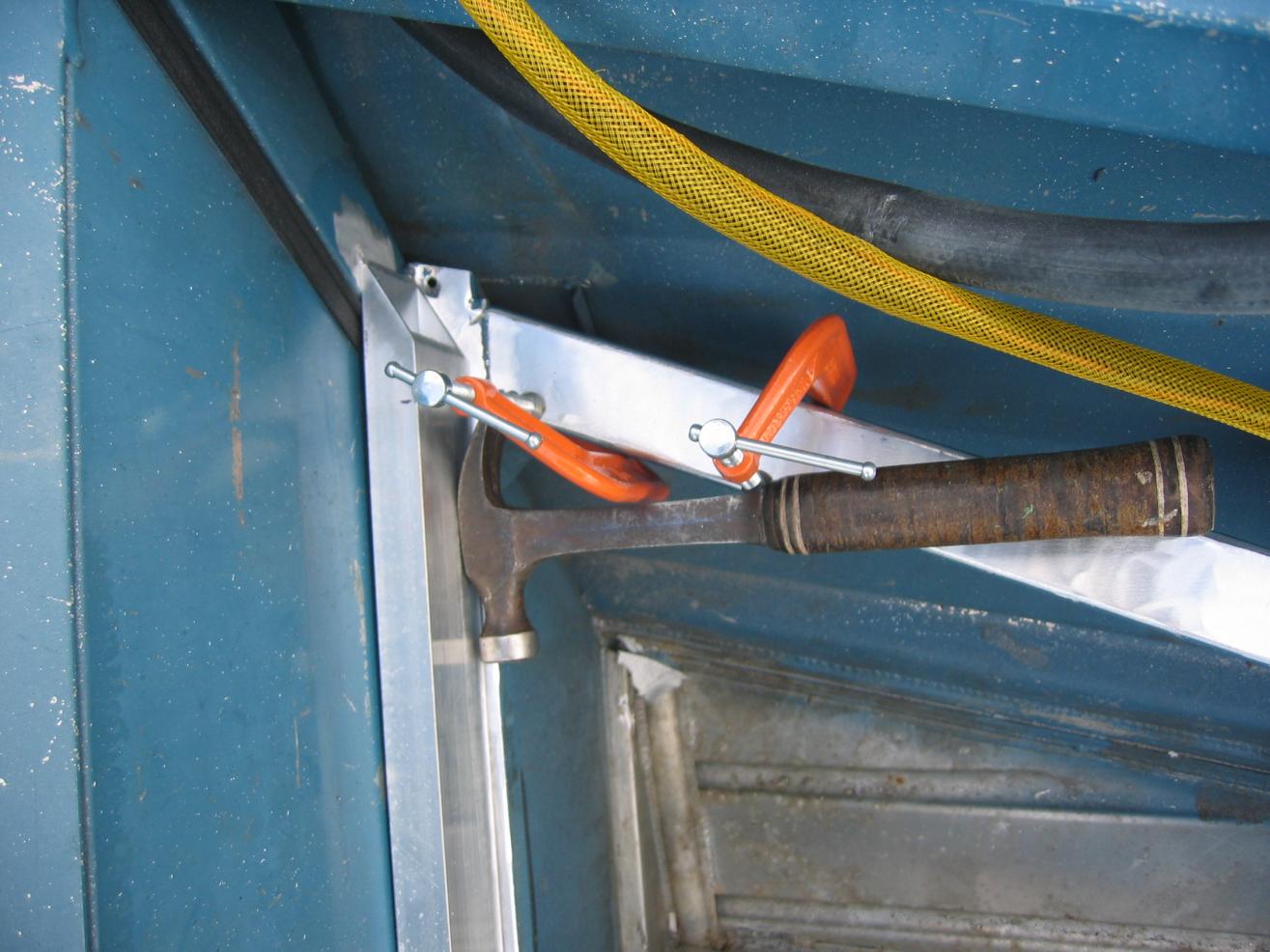

    Sometimes you get creative with methods to clamp, pre-stress, and hold pieces in just the right position to get those tack welds on there. Here I used a claw-hammer and two C-clamps to pry and hold a piece into position for tack welding with both hands free (to manipulate TIG torch and filler rod.)

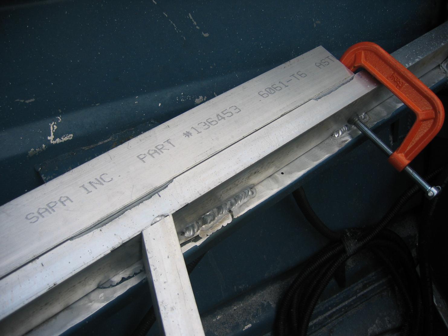

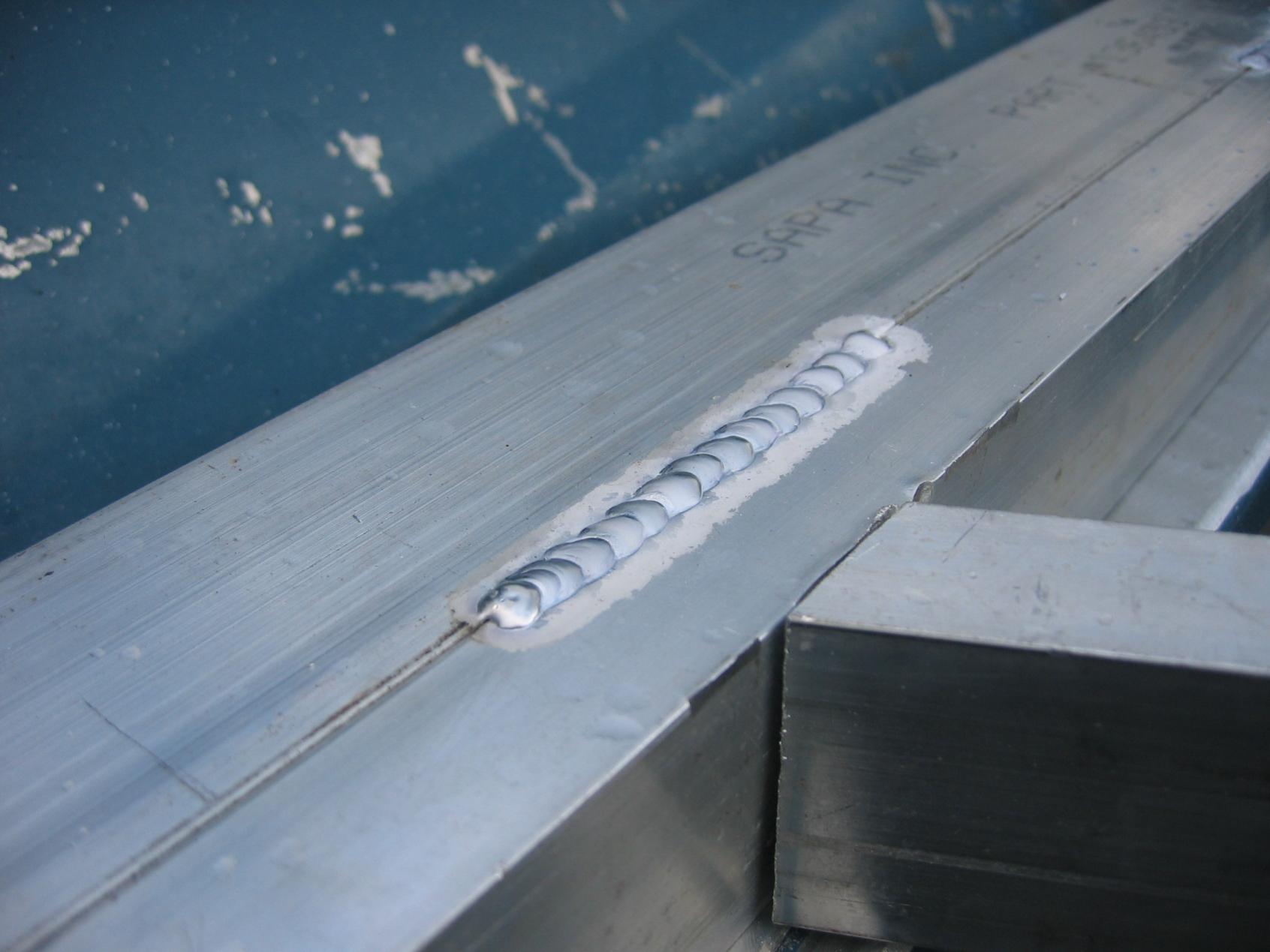

    A lot of this extruded aluminum alloy was 6061. When welding 6061 to 6061, it's important to provide a space for filler rod to be added into, to dilute the puddle and avoid hot cracking. You can see I beveled the edge of some rectangular (6061) tubing where some (6061) angle would be stitch welded to it. I did not want to build up a tall raised bead, because this structure needed a flat surface to support a deck above it.

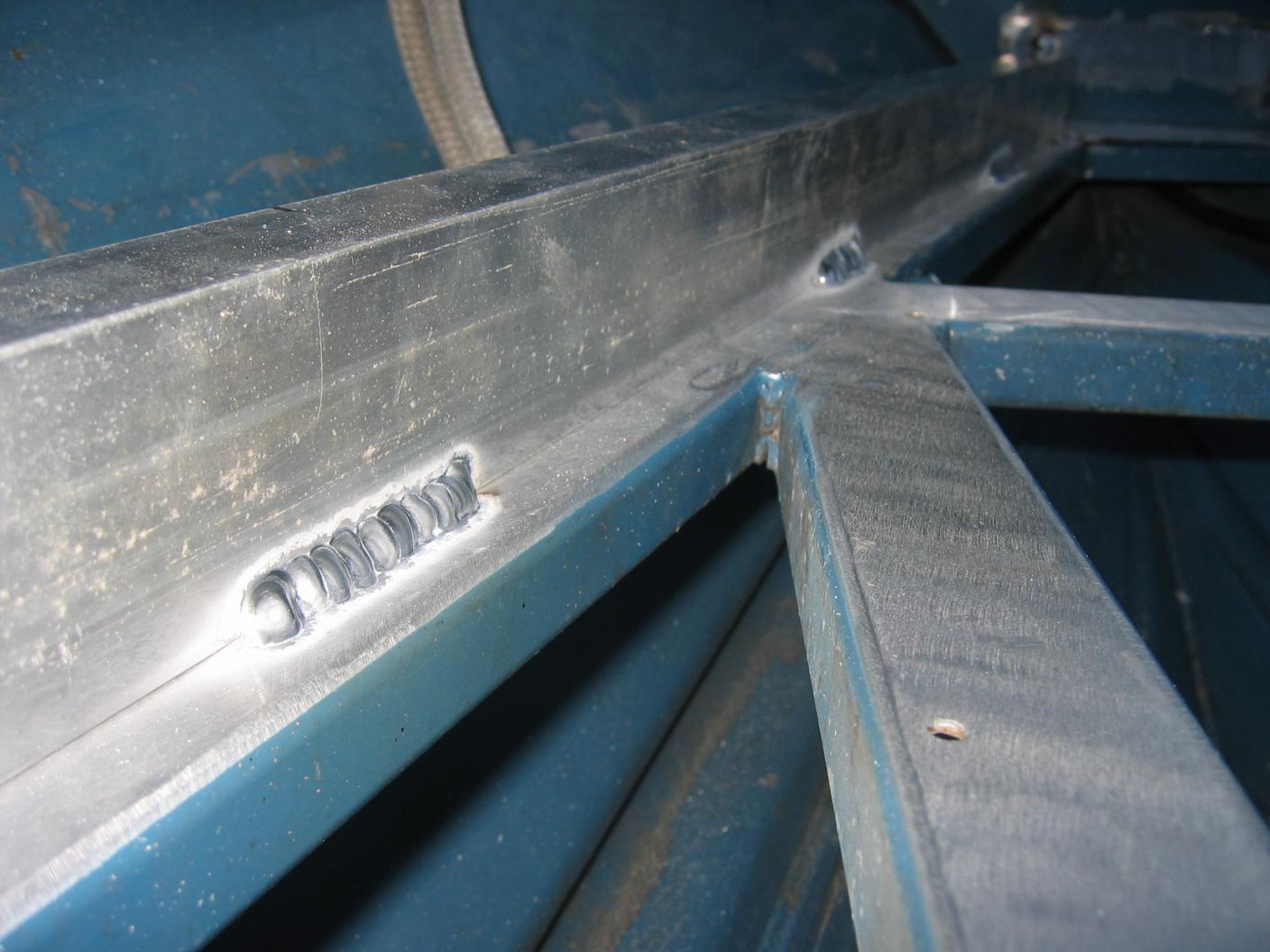

    Here is how those top surfaces turned out:
ID:	3006 Click image for larger version.

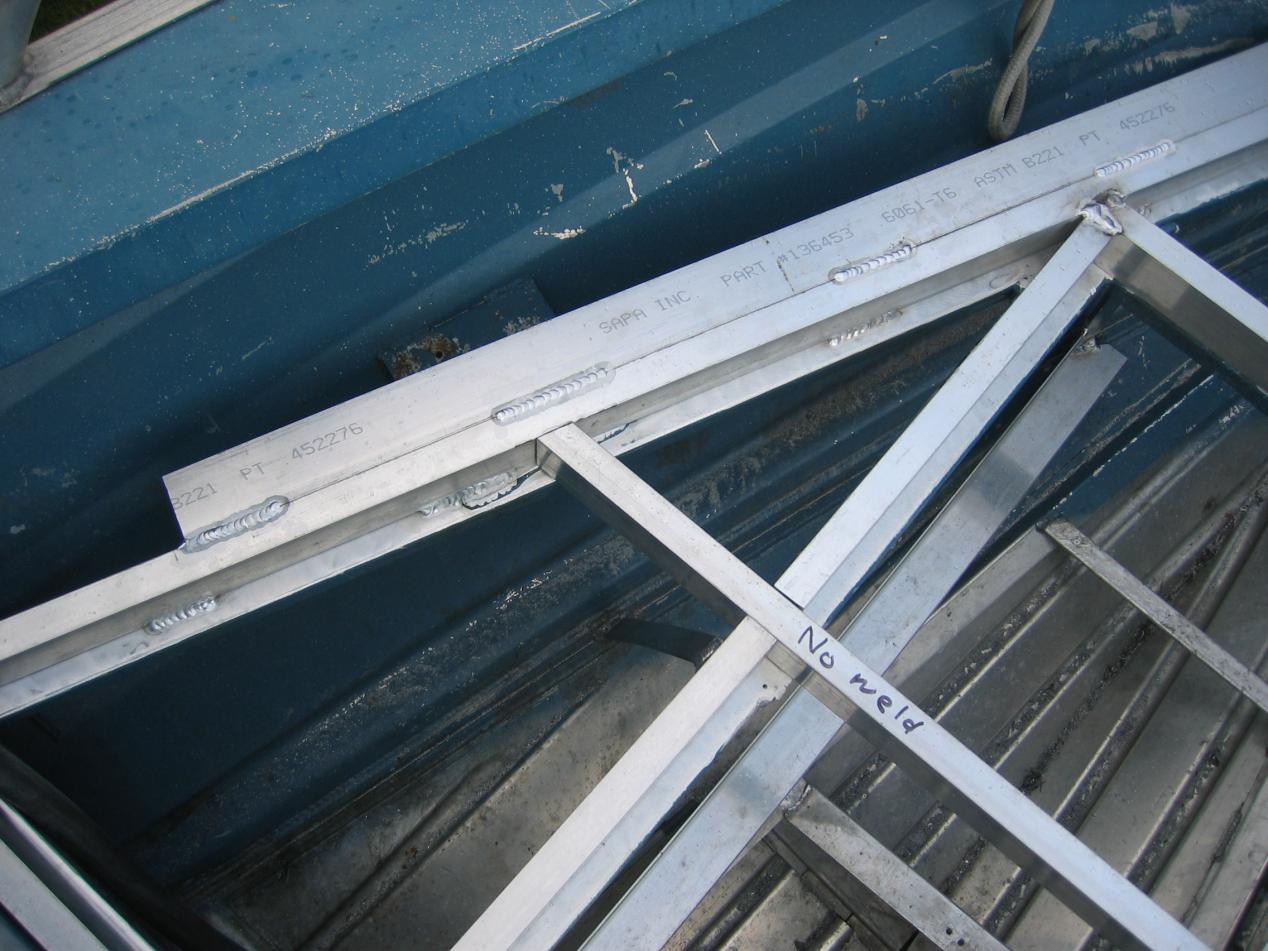

    I wanted to get in a few more pictures that wouldn't fit in the first post...
    The piece labeled "no weld" is removable (tight-fitting in its slot) for being able to access the fuel tank below.
    This section in the bow was tricky to weld with the torch switch, thin wall it had to be welded to, etc. But, think it will hold?
    Overall shot
