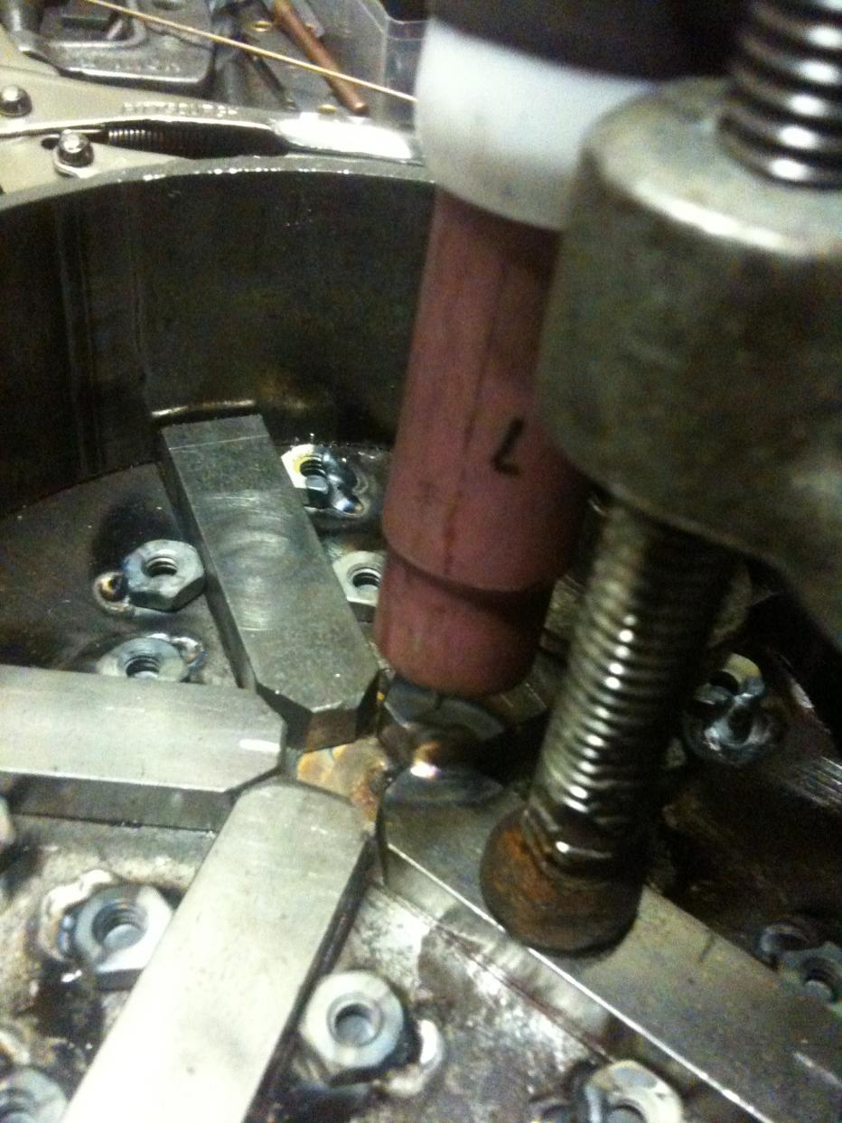

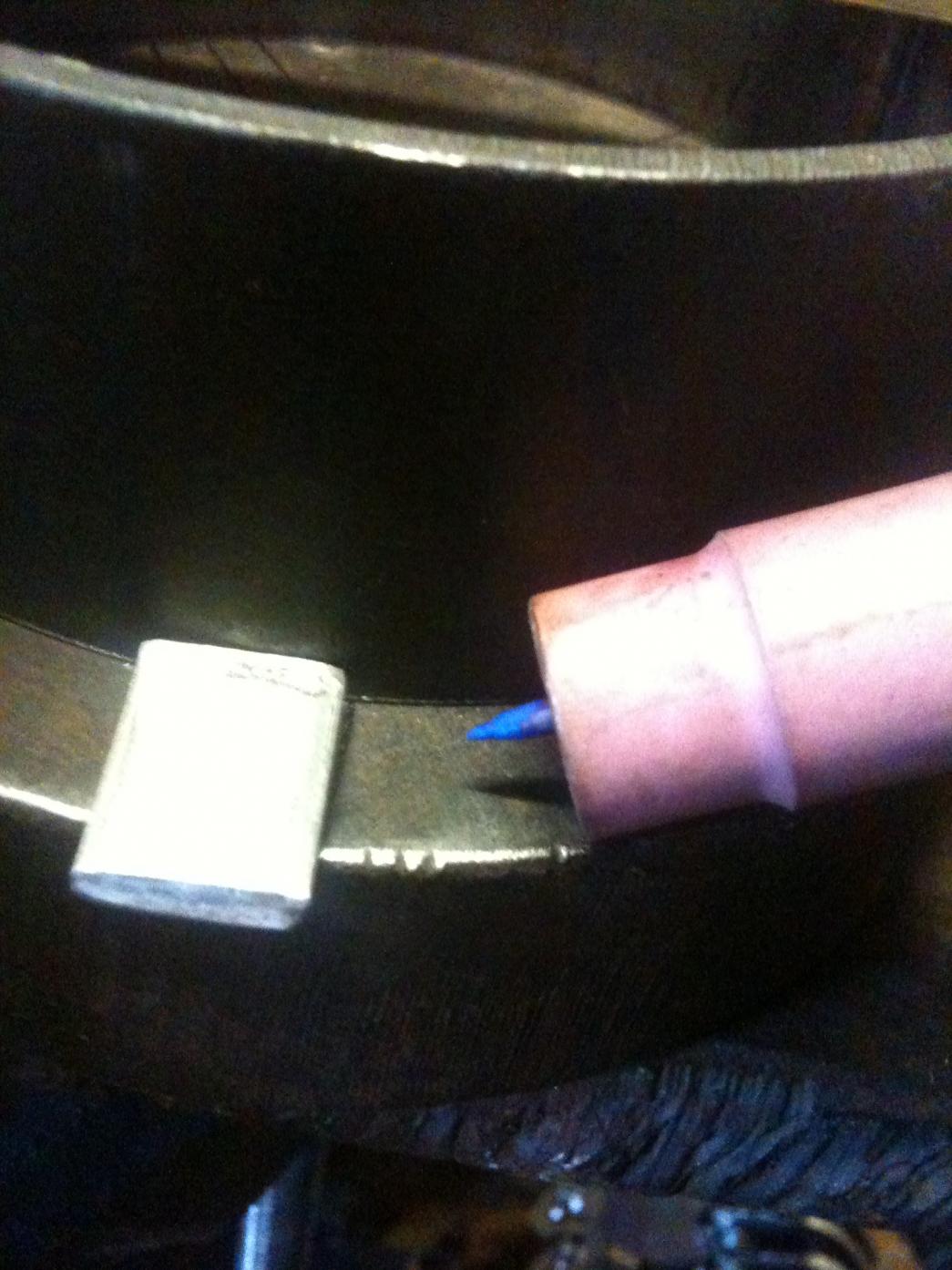

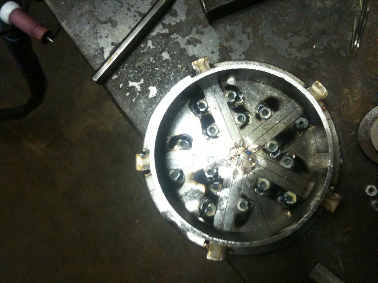

Here's a few images of a jig I worked on this evening
ID:	2984 Click image for larger version.
it's for a small scale wheel I'm designing for a small scale concept vehicle/RC model. I favor this five spoke design to the previous 6 spoke for fab reasons....
I choose 4.5" od x 1.5"w x 1/8 wall crs pipe for the base of the wheel well...
the spokes are 1/4" x 1/2" crs. So far. With the jig there is faster production which may allow me to skip a mold process & just fab my way to a rolling chassis.
