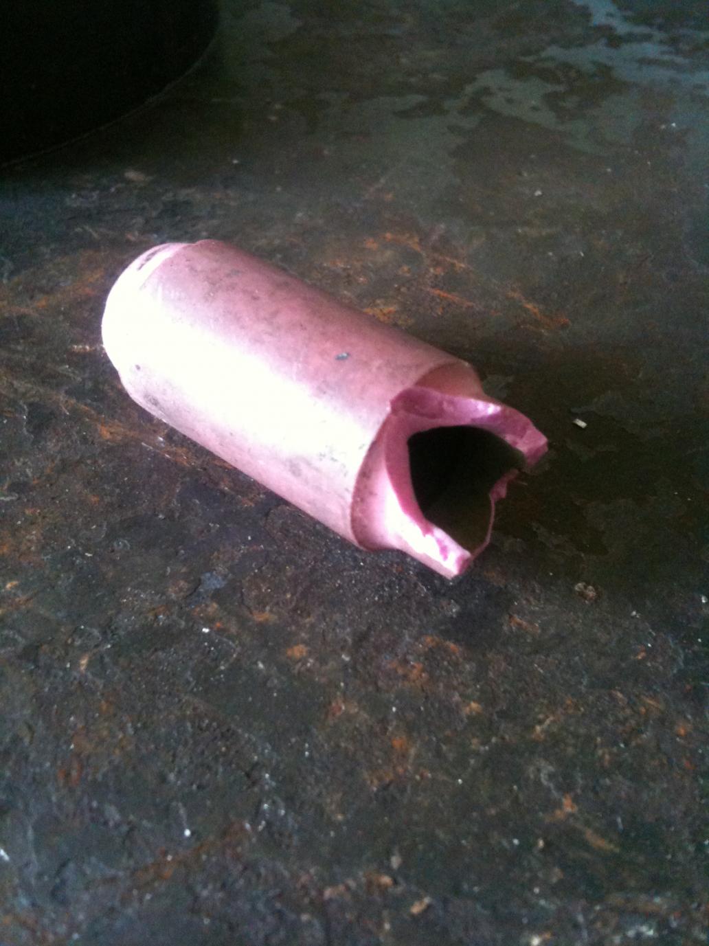

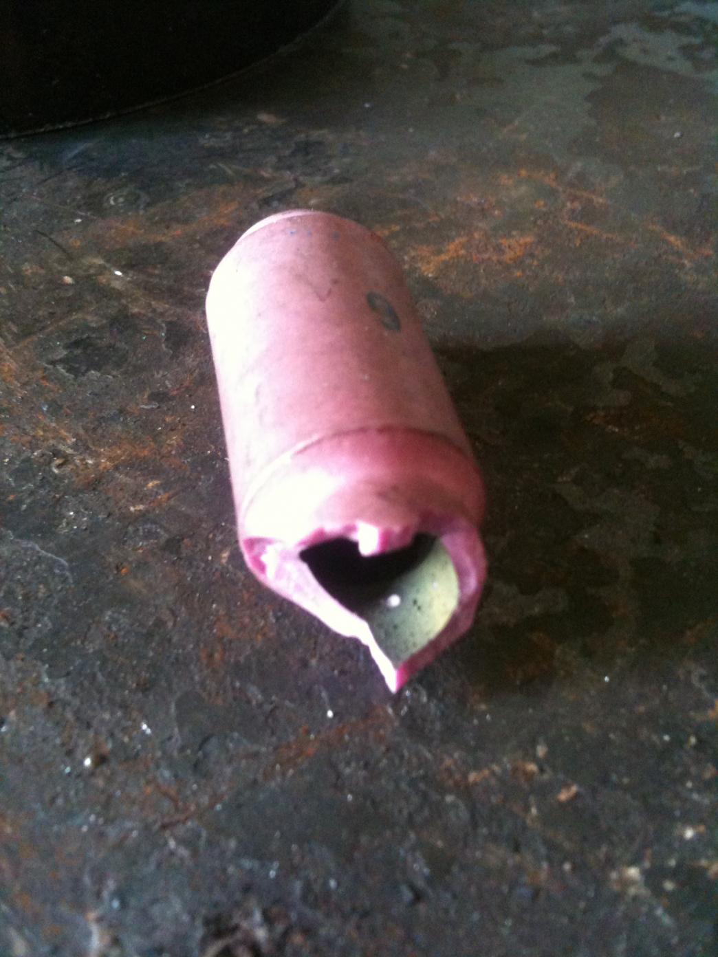

Hello again forum... If your a welder, & most of you are than you know what this means, & hate it when it happens...

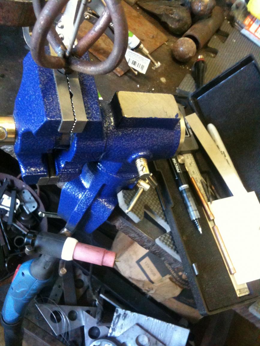

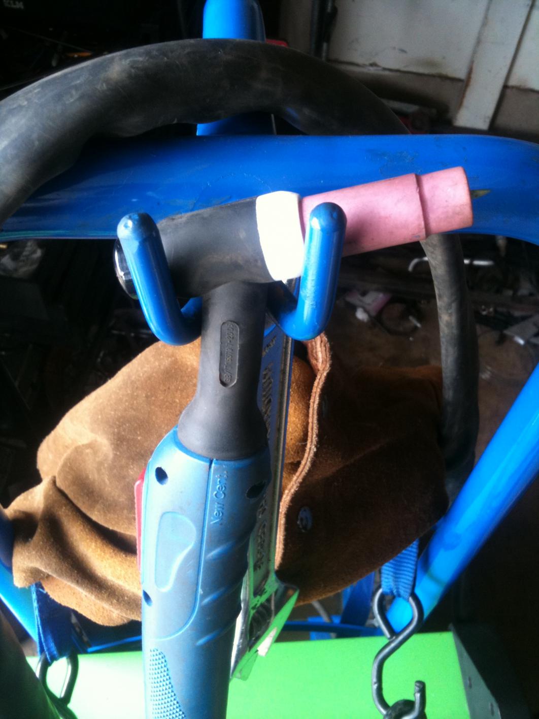

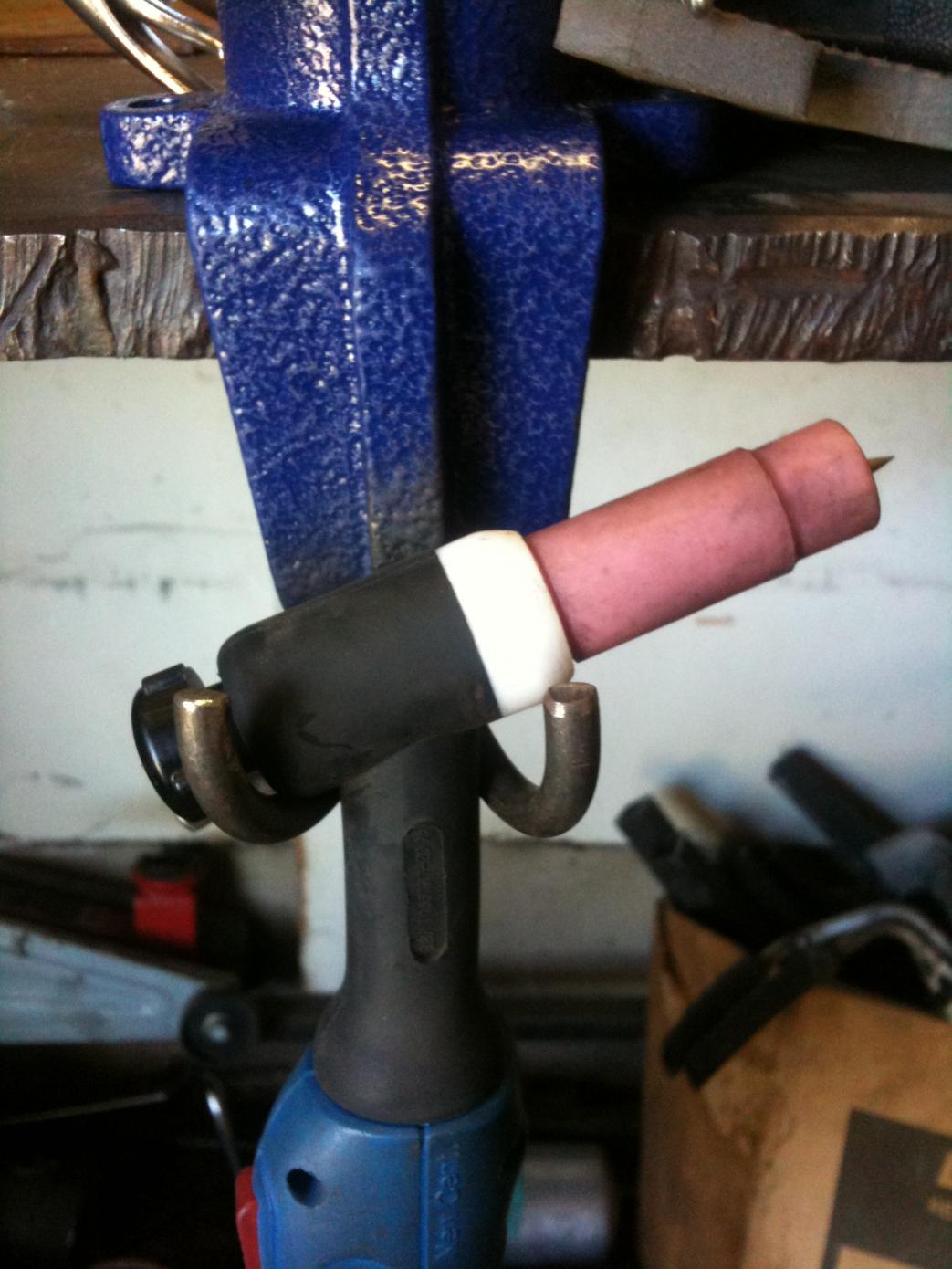

Last night I decided to throw together some holsters for my tig torch, because I'm tired of it sliding off the table & shattering 1/50 times.

This project took less than half an hour, considering most of the parts came from my scrap pile. The one mounted on my weld cart/ dolly, is made from 3/8' round bar, & is welded to a 1" bolt which allows it to be removed when i need the dolly by itself. The other holster is made from 1/4" round I welded to a small vise I recently p/u from harbor freight tools fairly cheap seeing as how I don't always weld in one place.
