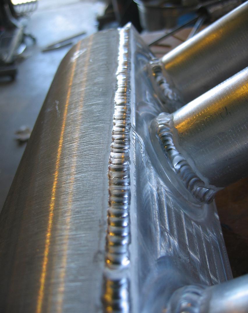

    The plenum was built from a cut piece of large diameter pipe/tubing, which had to be positioned precisely and tack welded,
    ...before doing the final welds. (Which I did making good use of Jody's "TIGFinger" heat resistant finger sleeve.)
ID:	2952 Click image for larger version.

    Filler rod was 3/32" 4043, current control was done by footpedal, AC Balance was 20% DCEP (min cleaning), front end was stubby gas lens w/ #6 cup and ~14 cfh argon, 3/32" lanthanated tungsten was ground to a crayon shape.
