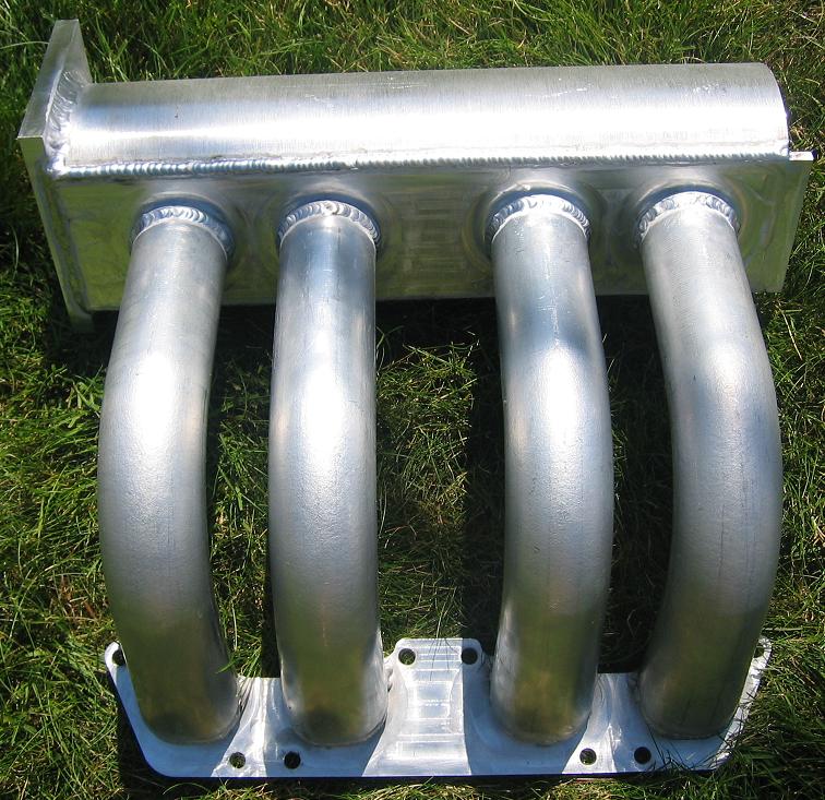

    I welded a custom automotive intake manifold this weekend for a Toyota Celica, which was going to be getting a turbo on it as well. Here is the final product:

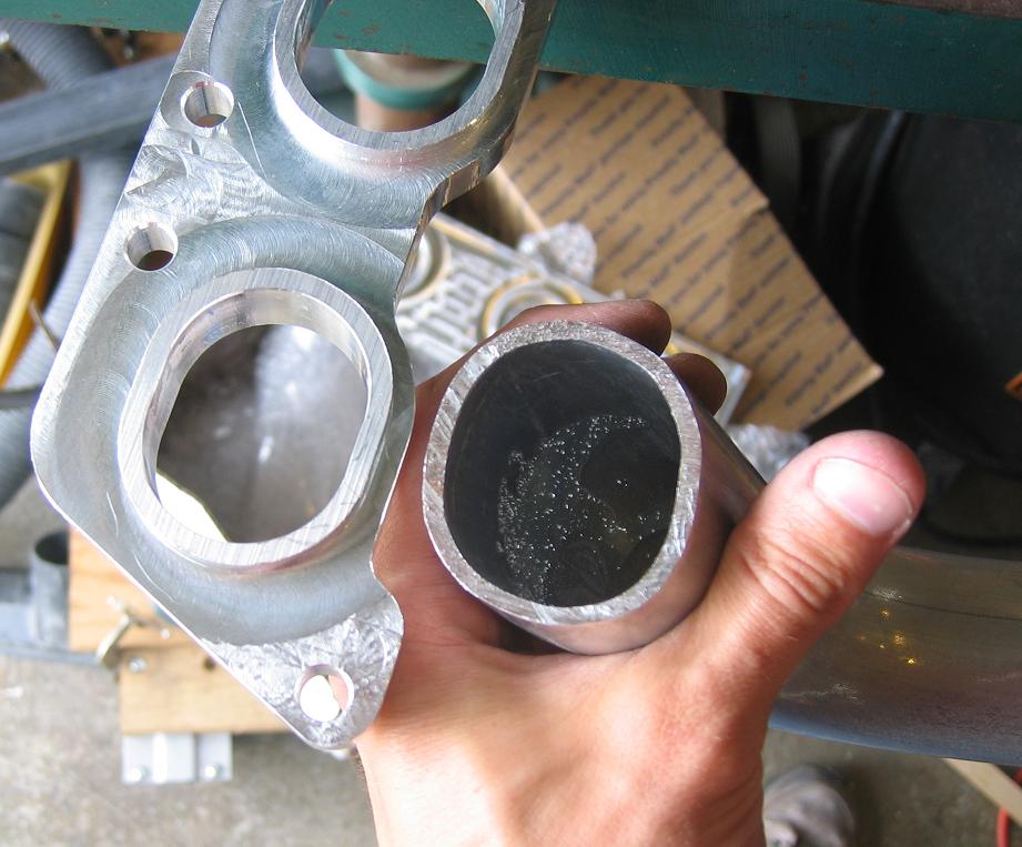

    I started with these "raw materials". Some nice CNC milled pieces. Everything was 6061 aluminum.

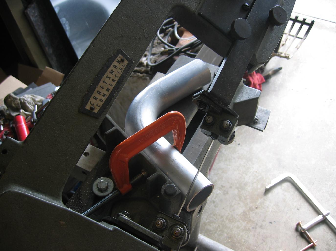

    The intake runner tubes (1/8" thick, 2" OD tubing) had to be:

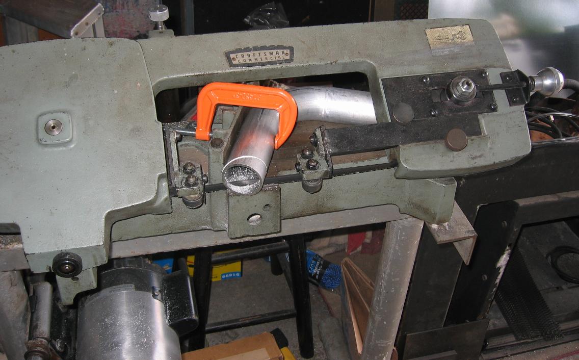

    1. cut to a specific angle, (which I did on my horizontal bandsaw)

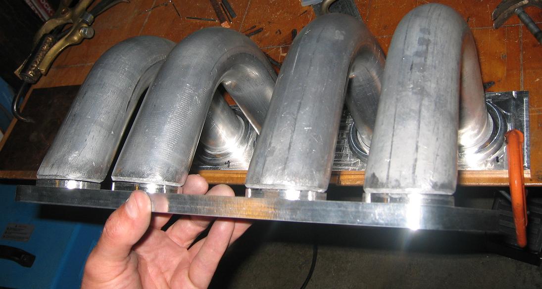

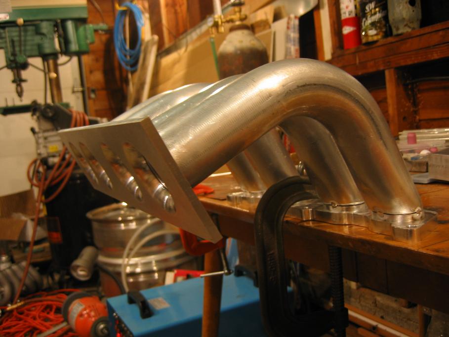

    2. formed into this cylinder head flange shape, (which I did with a vice and a hammer)

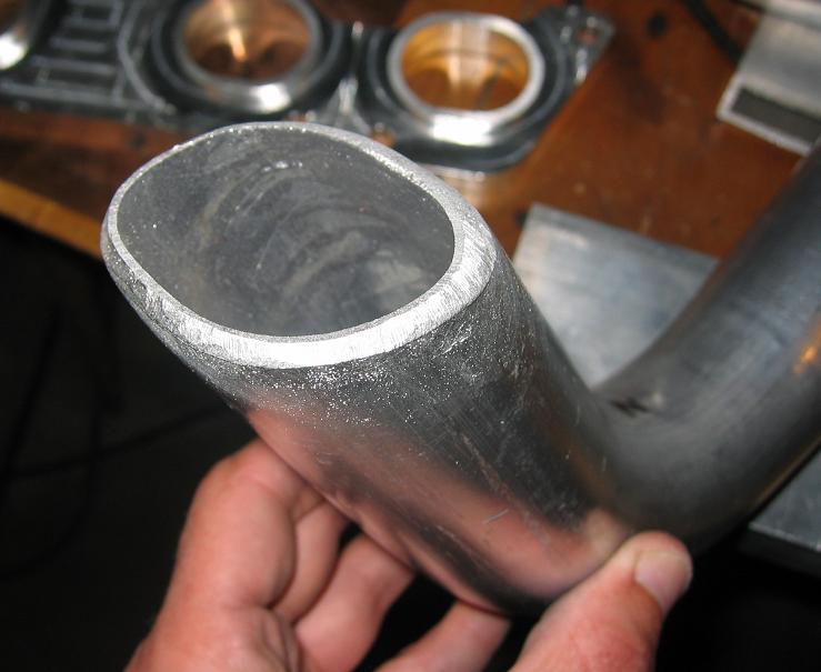

    3. beveled, deburred and cleaned for welding, (beveling helps encourage good, consistent penetration, with no hot cracking on 6061 butt joints)

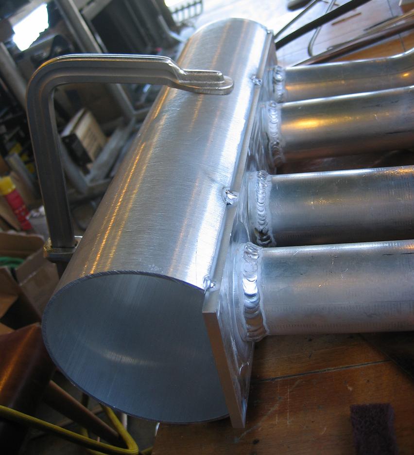

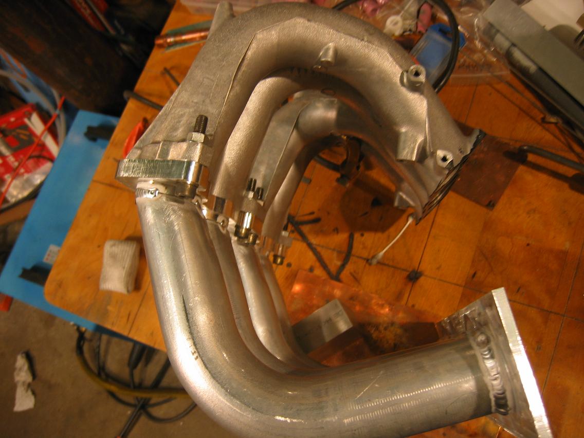

    I then proceeded to tack weld the runners up to the head flange and the plenum base,

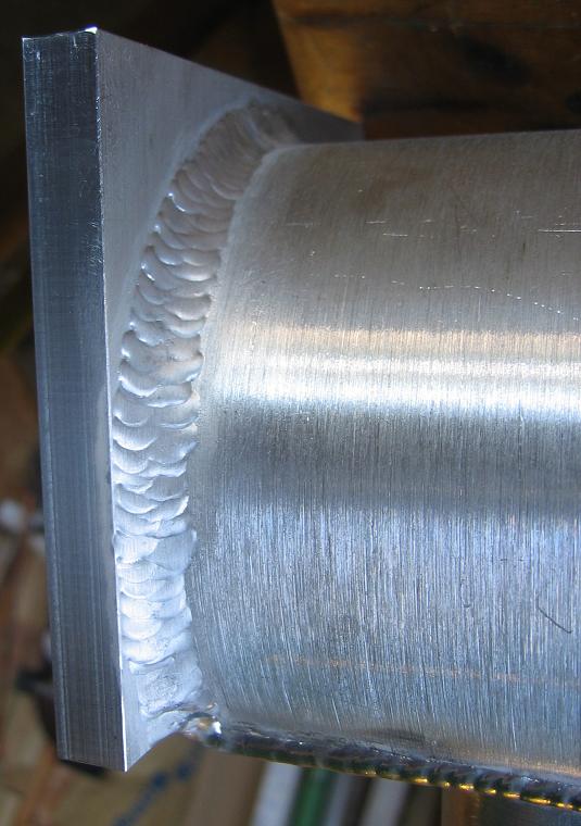

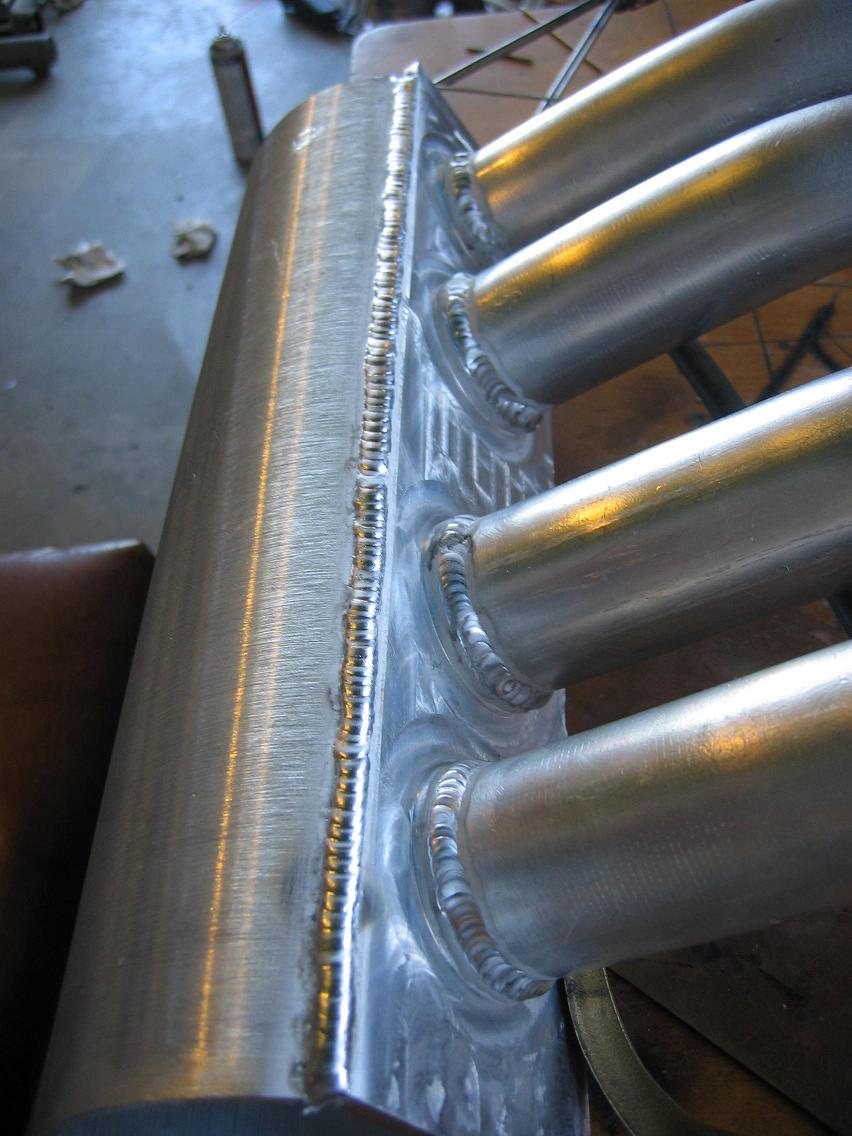

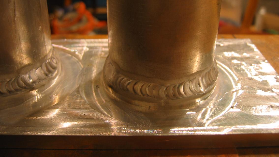

    ...and I fully welded the runners to the plenum.

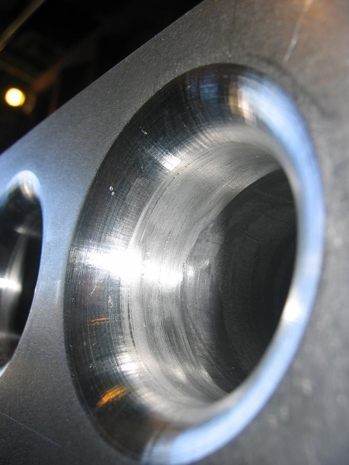

    (On the other side of this joint, I used my die grinder to deburr the transition from the base of the plenum opening to the runner tubing piece.)

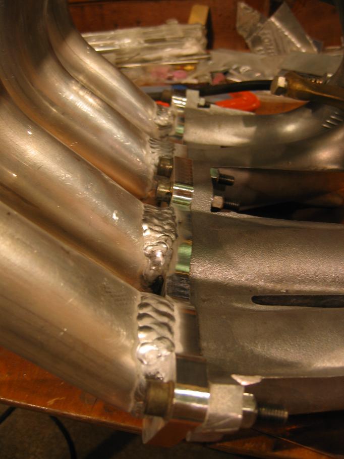

    I bolted the head flange to a fixture to prevent warping during welding (and it worked).
    (...continued on next post)
    I built the runner tubing weld up especially thick on the inside radius of the runner tubing transition to the cylinder head flange (since I would be die grinding material away inside there, to ease the turn) Shown after welding, with fixture still attached:
    The plenum was built from a cut piece of large diameter pipe/tubing, which had to be positioned precisely and tack welded,
    ...before doing the final welds. (Which I did making good use of Jody's "TIGFinger" heat resistant finger sleeve.)
ID:	2952 Click image for larger version.

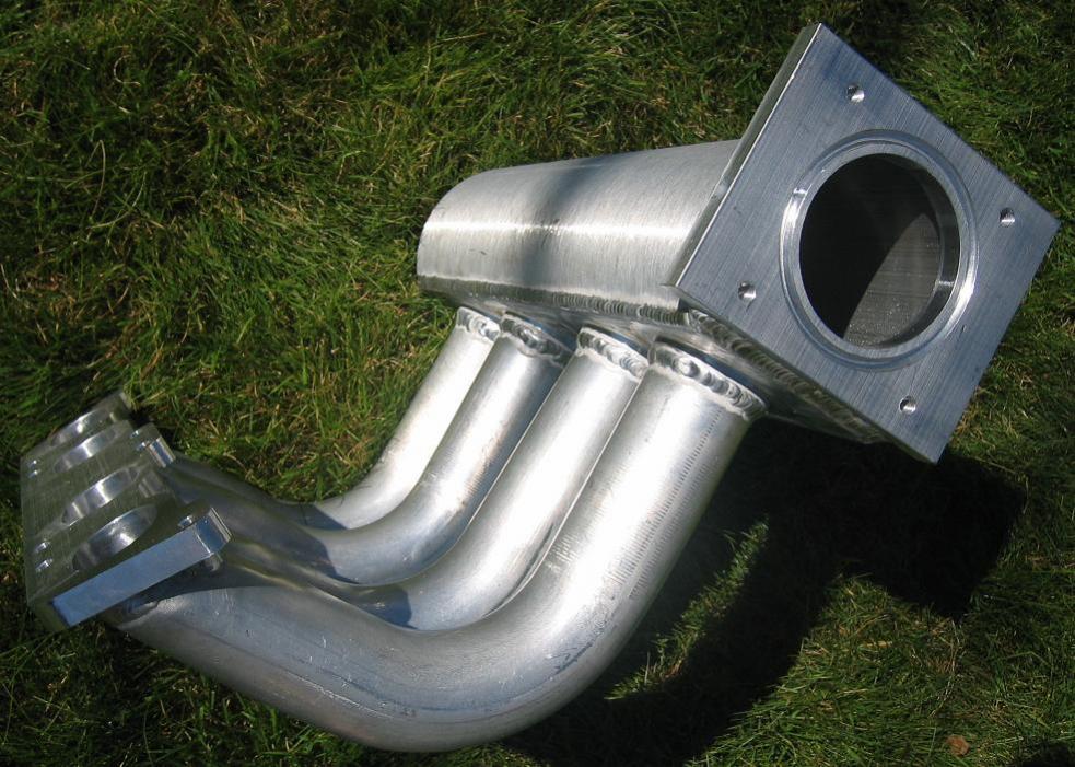

    I then welded on the plenum wall with the throttle mount (this was rather thick, 1/2" plate material, that had female holes blind-drilled and tapped on the throttle mounting side)

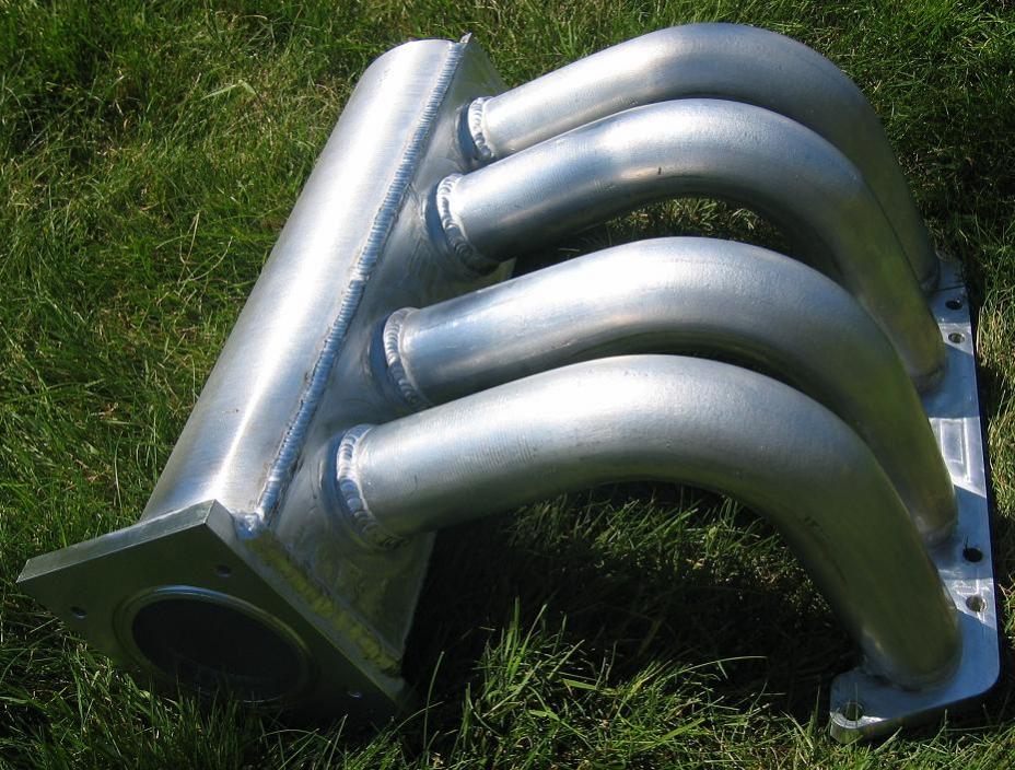

    And after a little porting work to ease the transition from the runner to the head flange, I ended up with a rather beautiful creation...
ID:	2960 Click image for larger version.
    Filler rod was 3/32" 4043, current control was done by footpedal, AC Balance was 20% DCEP (min cleaning), front end was stubby gas lens w/ #6 cup and ~14 cfh argon, 3/32" lanthanated tungsten was ground to a crayon shape.

    wow that came out awesome. How long do you think it took you from start to finish? And on the picture of your band saw, is that how the clamp is made for that band saw or did u just use that c-clamp in order to get that angle for the cut?

    Jake, very nice. Did you fab up all the parts in-house, bending, etc. Looks great.
    Brandon - Good question on the bandsaw fixturing. My horizontal bandsaw, like most has two fences: one fixed, (which can pivot, for angling/mitering ability) and one movable (for quickly clamping/unclamping parts). For cutting these particular bends at the angle that they needed, the other leg of the "El" would have interfered with the movable fence, so I removed the movable fence from the bandsaw completely (it's not that hard, two bolts secure it from underneath in the slider slot.) I just used some c-clamps to secure it instead.
    Here is another angle of the bandsaw setup:
    It took me about 11 hrs from start to finish, and I made kind of a showcase of my work out of it. A good bit of time was spent getting the parts fitted up just right,
    (especially getting all four runner tubes fitted just right at all 8 ends.) Welding around the runners was kind of tricky too; I had to reposition (changing the approach of vision, filler rod, and torch) several times per around-runner weld.
    Mike - The customer supplied all the pieces shown in the second picture; I just put them together for him. It was fun welding on them, because there obviously was a good deal of time/effort/expense in the overall project planning and CNC machining of the pieces. Actually I was in touch with the customer several months before it was time to weld the pieces; that's how long he was planning this.
