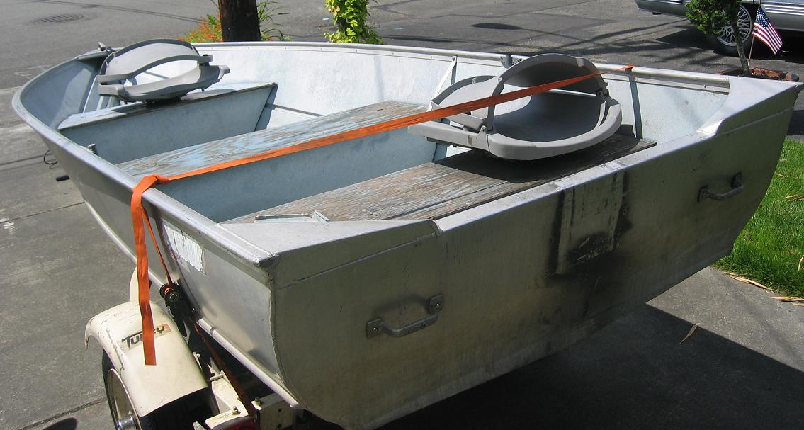

    It seems like I've been doing a lot of marine work lately.
    I did some welding work on a small aluminum boat, which the customer plans on using for recreational crab fishing. This was pretty light weight, I think you'd call it a "car topper". The hull was about 1/16" thick aluminum.

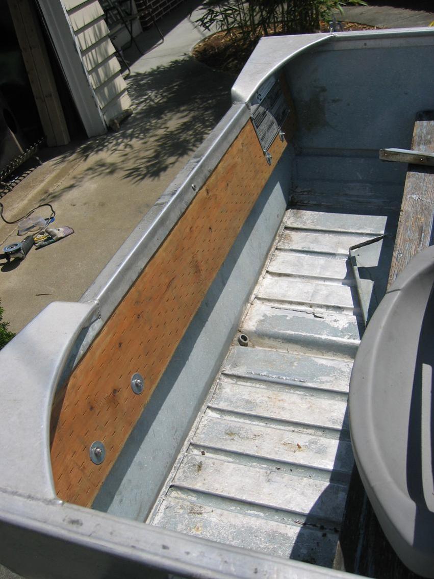

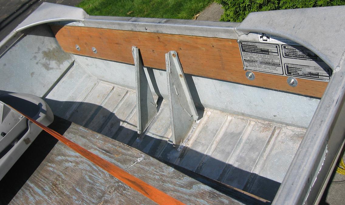

    The owner was modifying/beefing up the transom, probably because he got a new motor with different shaft length, or more power. He snapped the original transom gussets off and installed a pressure treated lumber to reinforce the transom, and wanted me to weld the gussets back on, as well as to fill a couple holes in the aluminum transom.

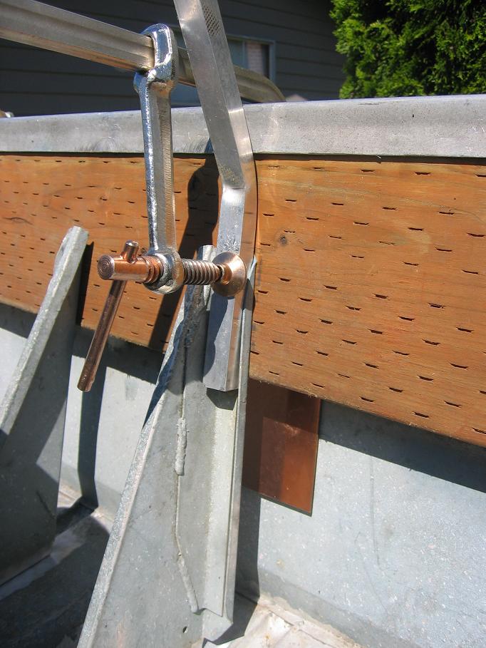

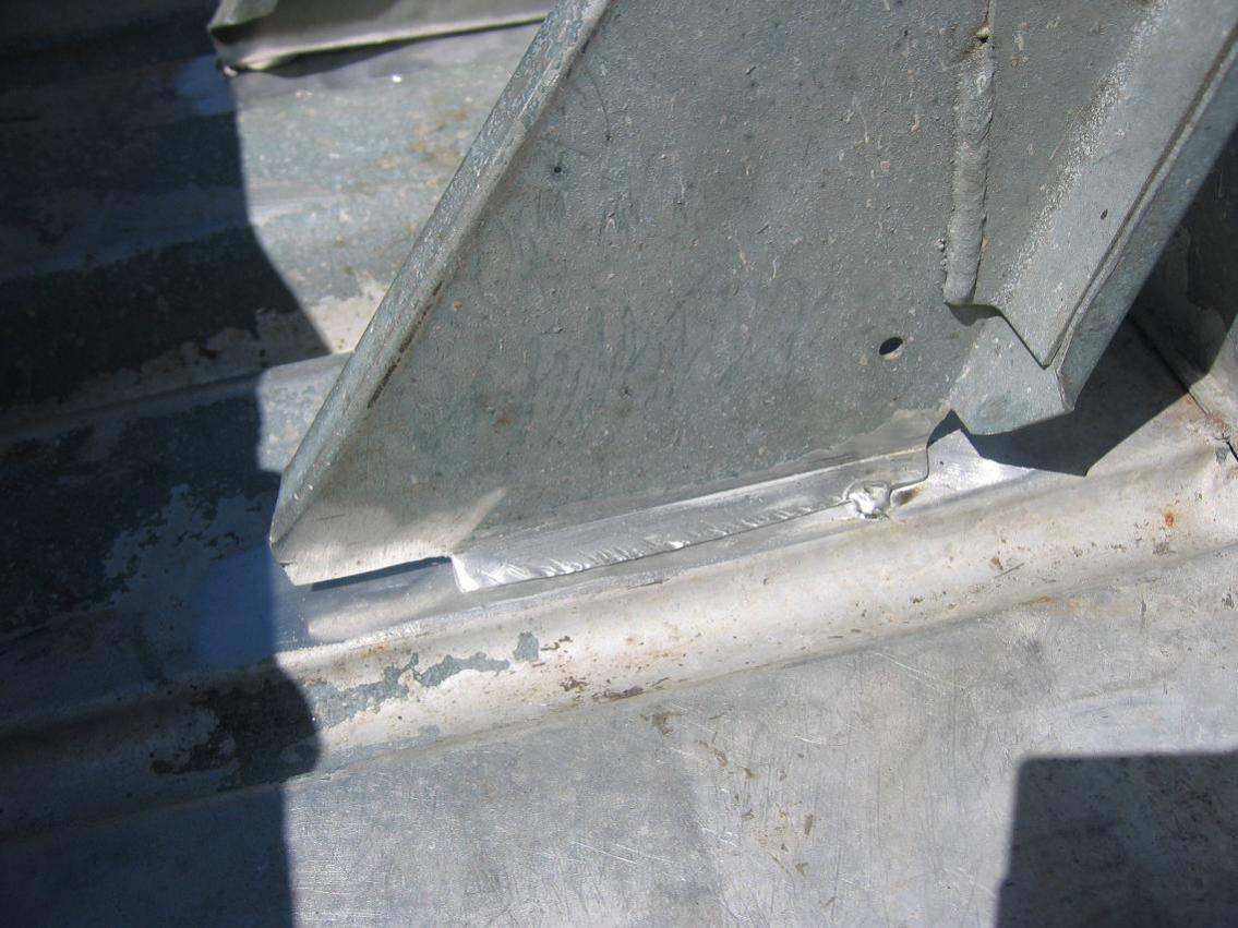

    I prepped the aluminum to remove old welds (kind of nasty, factory MIG welds on aluminum boats seems to be common) which I did using a flap wheel (and light pressure and care where it sanded away material, to keep the aluminum hull material from thinning out.) I used some big "F" clamps to position the transom gussets against the transom for welding.
    Since the gussets were not a perfect fit to the hull with the new/modified transom, I tack welded the gusset to the hull where it fit tight, and then used a hammer to bend the gusset's welding flange down close to the hull for final welding.

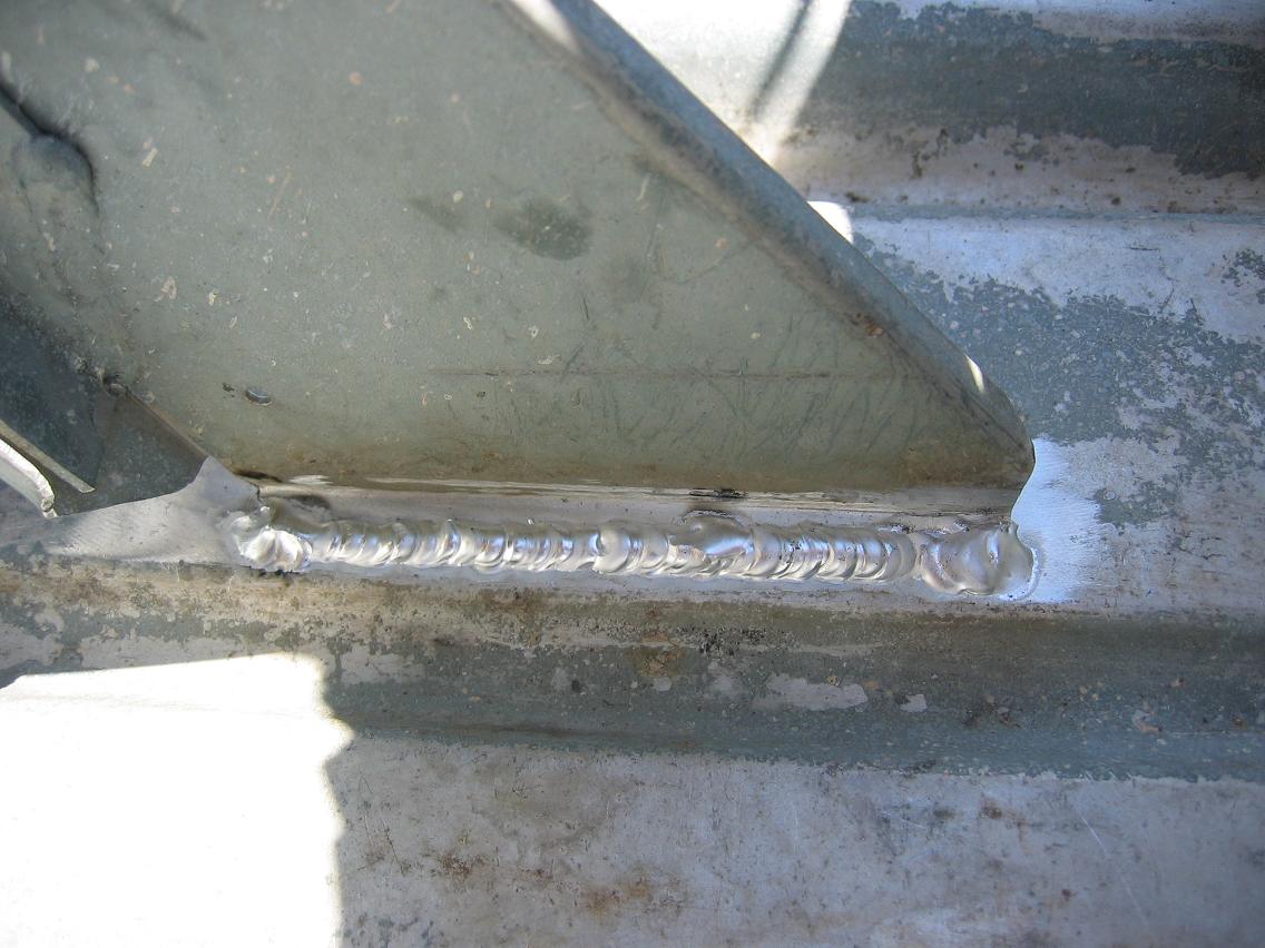

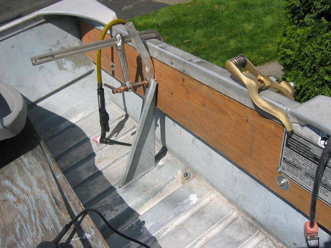

    Then I TIG welded down along one side of the gusset on each of the two gussets. I used my foot pedal for current control and 5356 filler rod. It was kind of an awkward position, as I had trouble getting my head down to where I had really good vision of the puddle. I extended the tungsten out a ways to help me see the puddle. Not the prettiest TIG beads ever, but certainly strong (and good enough for what they need to do.)

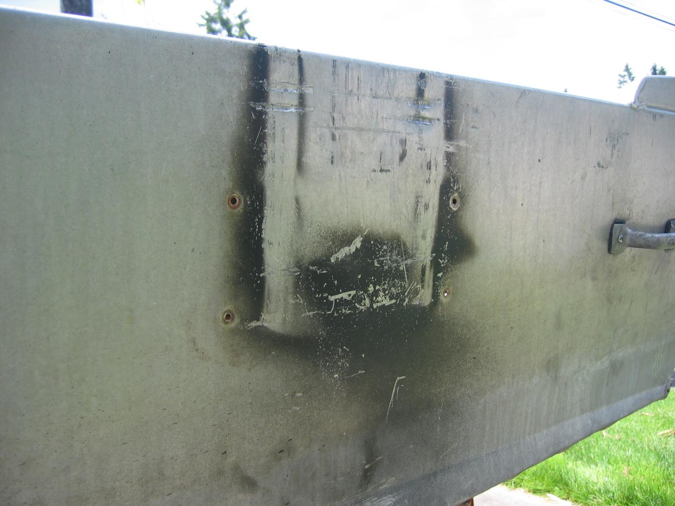

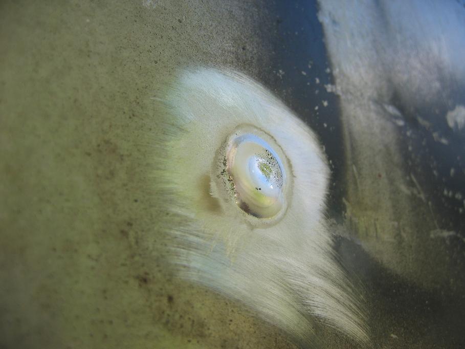

    I also filled two holes at the back of the transom.
    I prepared them by removing the paint and oxidation from both sides the best that I could, and then clamping a plate of copper backing with the F-clamps. (You can see the copper in the picture, below the wood piece.)

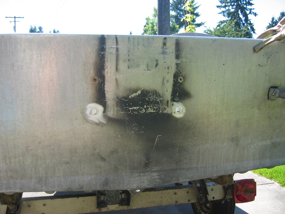

    I then welded them up from the outside (inside was not very accessible as it was just behind the wood transom support piece.) It took a lot more welding current than I would have guessed to fill these holes (probably because of the copper backer!)
