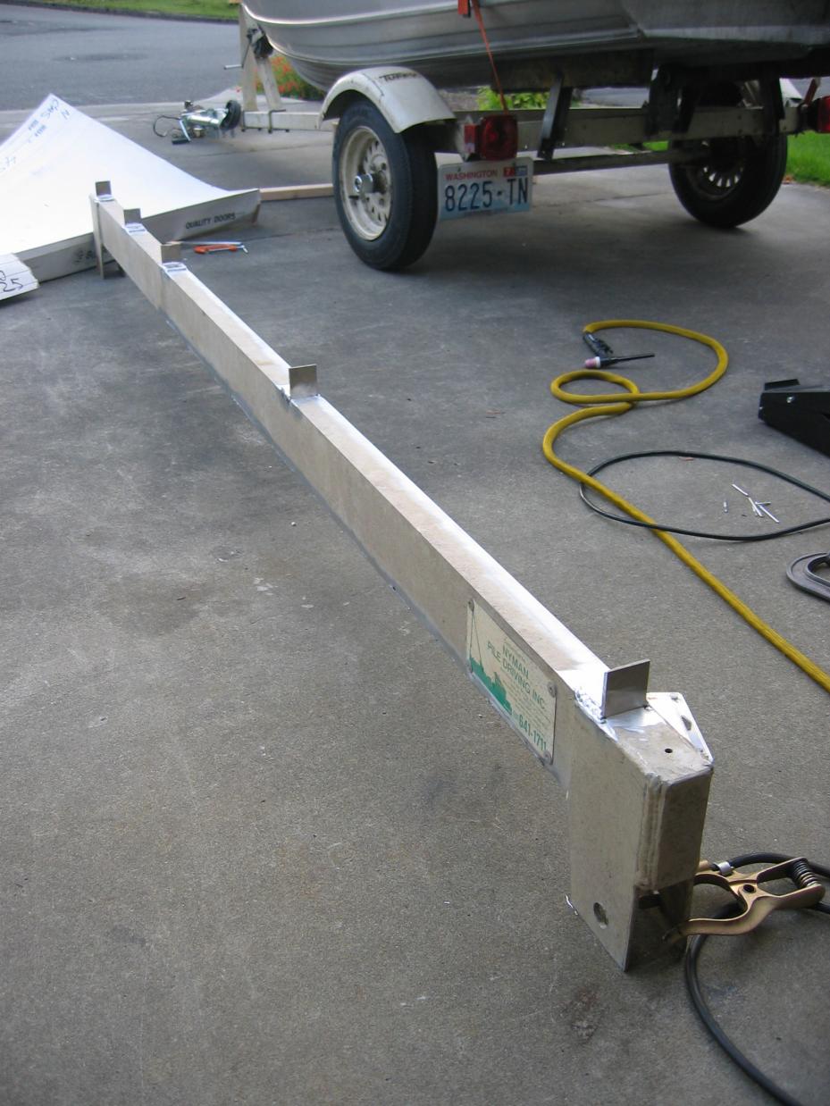

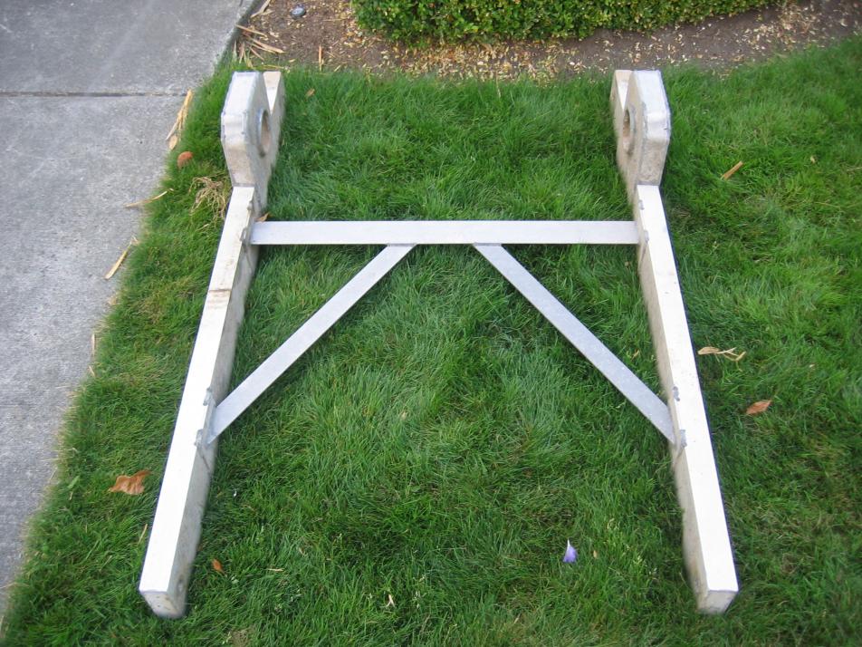

    I did some welding on an aluminum hydraulic lift for a boat dock today. This type of lift uses water pressure (IE: piped from a garden hose, or potable water piping), to raise and large hydraulic ram, which raises the boat up and out of the water, getting it up and out of the waves and keeping it "high and dry" for storage.
    This was apparently an old lift that had some problems, which the customer had just purchased and was repairing it into a usable condition.

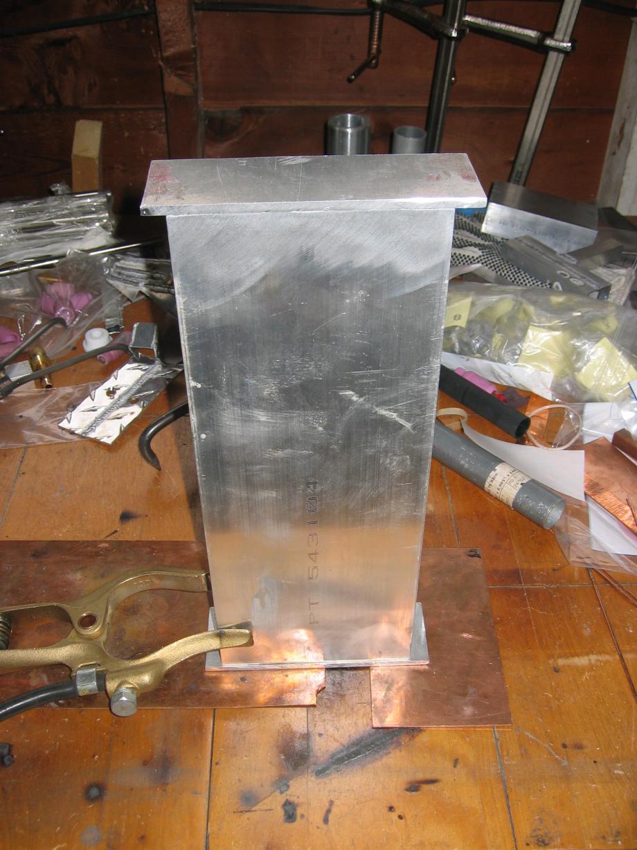

    This was really a good test of my welding machine, as the material was pretty thick in places, and fairly good sized pieces as well. I started off doing some easy warm-up work on the bench using the footpedal for current control.

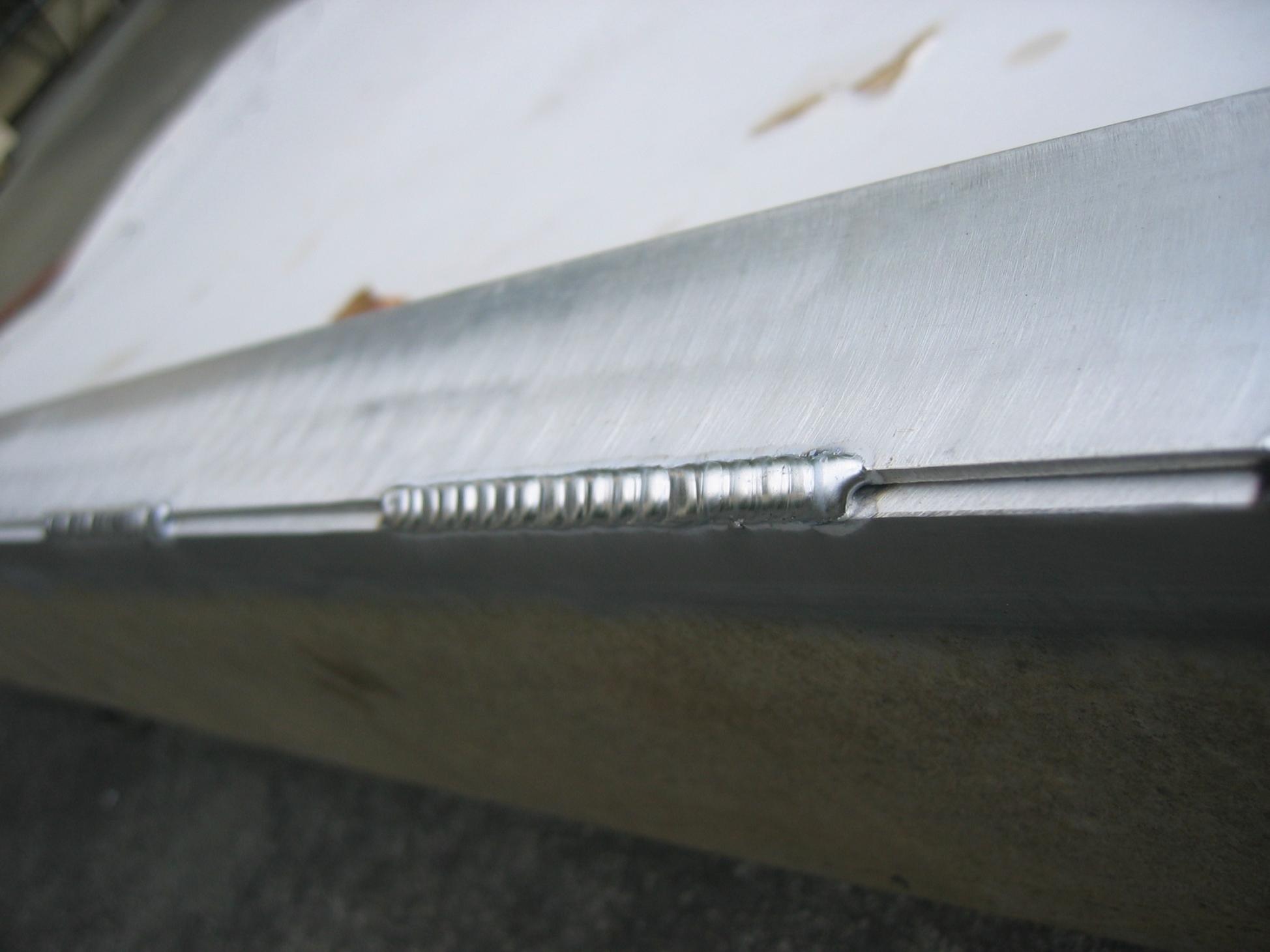

    Then I switched out to my driveway for the big pieces, where I was running flat out (off and on) about ~190 amps (using the torch switch for current control) and at a pretty hefty duty cycle. You'd think in July, we'd be having sunny weather, but NOOOO, it was overcast and actually quite gusty (like a weather front was coming through) so I had the customer (my helper) hold a big piece of cardboard to block the wind. He also stayed busy prepping parts and feeding them to me for welding. It seems like weather never cooperates around here lately.
    I did several linear feet of these stitch welds, (50% lap joint welds and 50% outside corner welds):

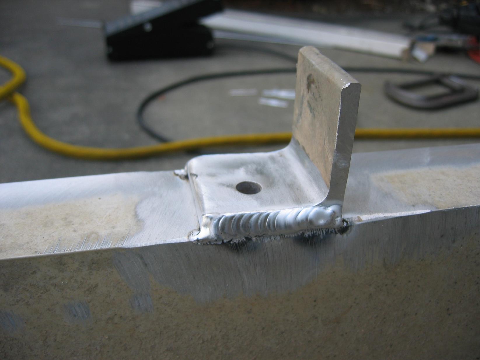

    And I welded on a few of these tabs:
    There were two of these rather large pieces:

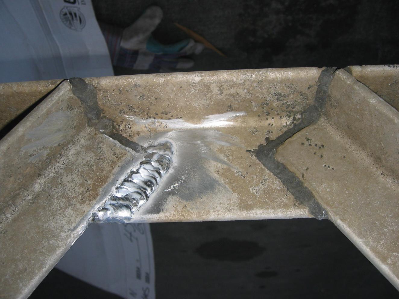

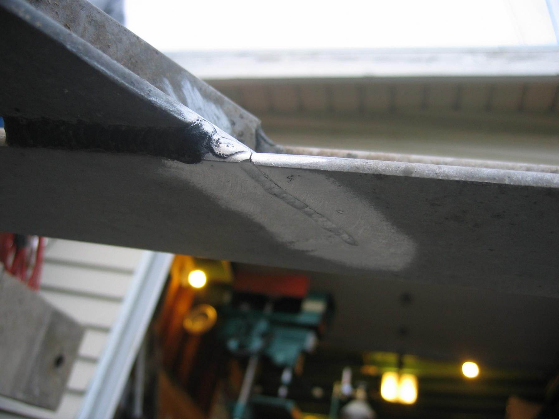

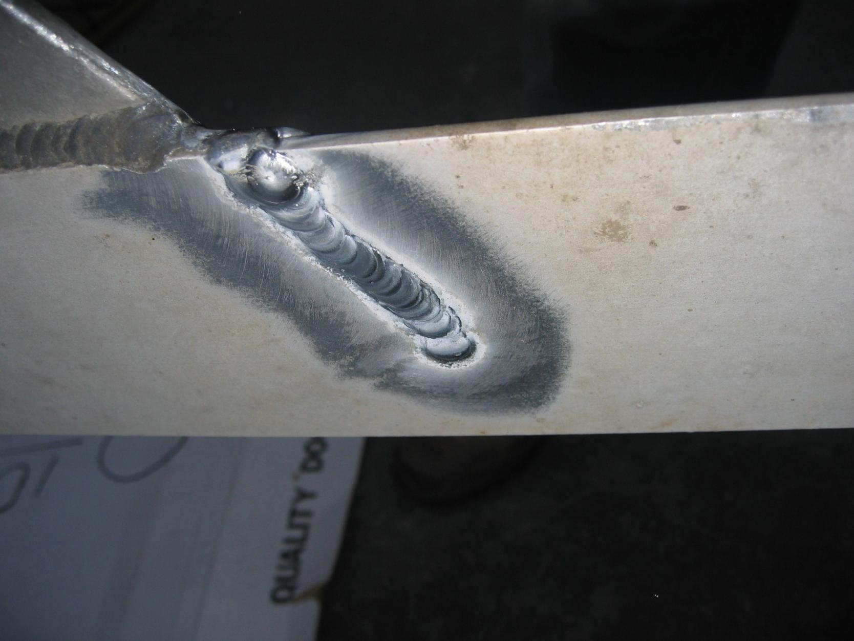

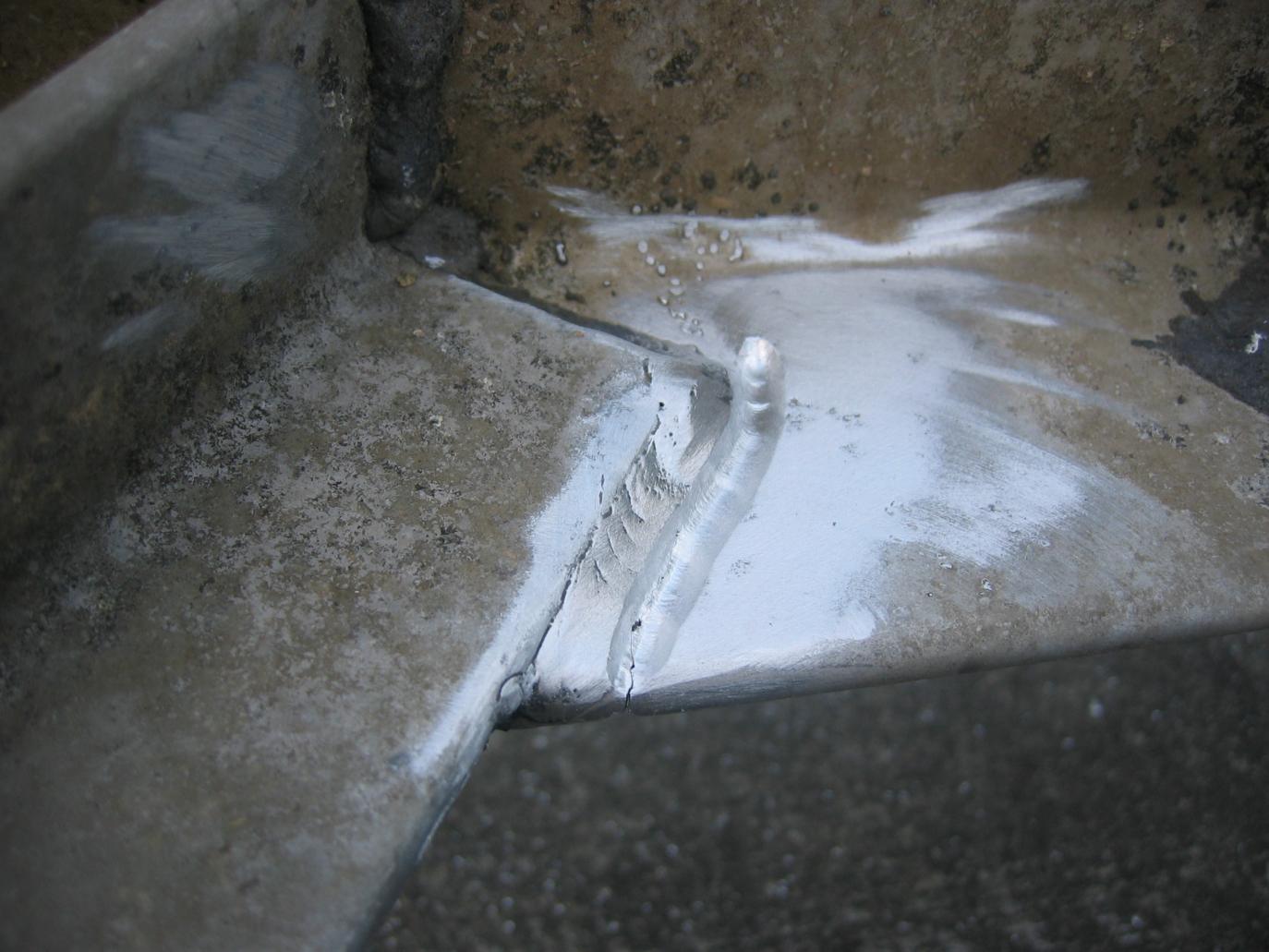

    I repaired a cracked section using similar crack repair techniques I perform on aluminum wheels. Grind a vee in the crack on both sides using a carbide burr, mechanically deoxidize and solvant wash, and then weld on both sides for full penetation without very wide of a weld bead or heat affected zone. (But since this crack was caused bya stress riser next to the filler weld, I feathered the filler weld out on the side with the filler, to distribute the stress out over a wider area.)
    Crack prepped (top / bottom views):
ID:	2901 Click image for larger version.
    Crack welded:
ID:	2899 Click image for larger version.

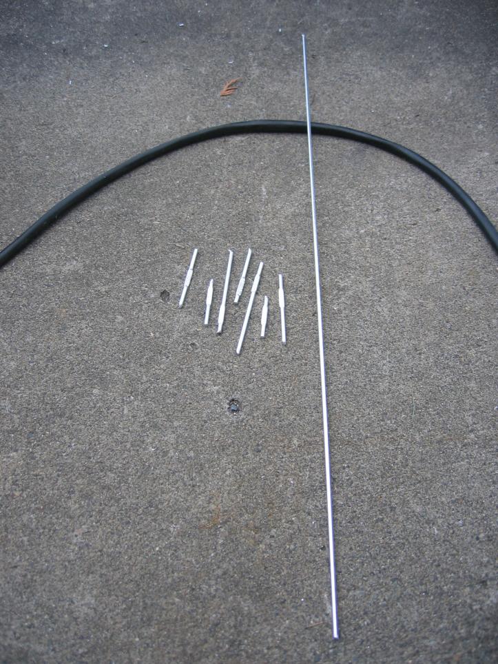

    I went through 8.5, 36" long 1/8" diameter 5356 rods on this repair. Took me 2-3/4 hrs to do the work. The customer did a good job of prepping the parts (and bringing them substantially well-prepped... after apparently taking very good notes during a brief initial consultation) and he kept feeding me prepped pieces to weld together when he was not holding up a cardboard makeshift wind shield to keep my weld puddle clean during the wind gusts.
