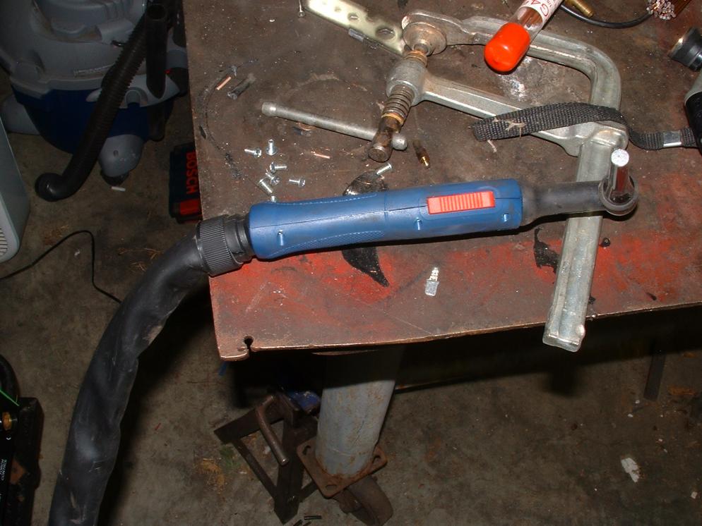

    I'm looking at TIG torch handles, and need to see some information like: it’s Amp rating, if it is air cooled or water cooled and if it has a contact switch built in, contact switch strapped on or no contact switch at all.
    All of our new torches are air or water cooler compatible. And the buttons are built in (there is a picture on our website under details). Only one model is not. Which one are you looking at?
    On your Welders there are two units that I wanted to know what TIG torch handles they come with: the PowerTig250EX and the PowerMaster226
    Thanks in advance,
    Both are air/water compatible. I will check the rating, but I thought it was 300amp +. Mark might know it off the top of his head. Otherwise I will look it up. Surprised it is not on the page yet.
    Both the PowerMaster and the PowerTig carry the extremely ergonomic Trafimet/Binzel designed water cooled torches. The parts are interchangeable with weldcraft.
    The rating for water cooling on this torch is set at the factory with a 300 amp capability. The factory said it was okay to use up to 160 amps air cooled. It will work at that amperage, but the duty cycle is low when it is air cooled, from my experience.
    Here's a picture from the top of the start button, which is not used when the footpedal is engaged. The foot pedal initiates the arc when it is depressed.

    Thanks Performance & everlastsupport!
    The picture helped me too.
