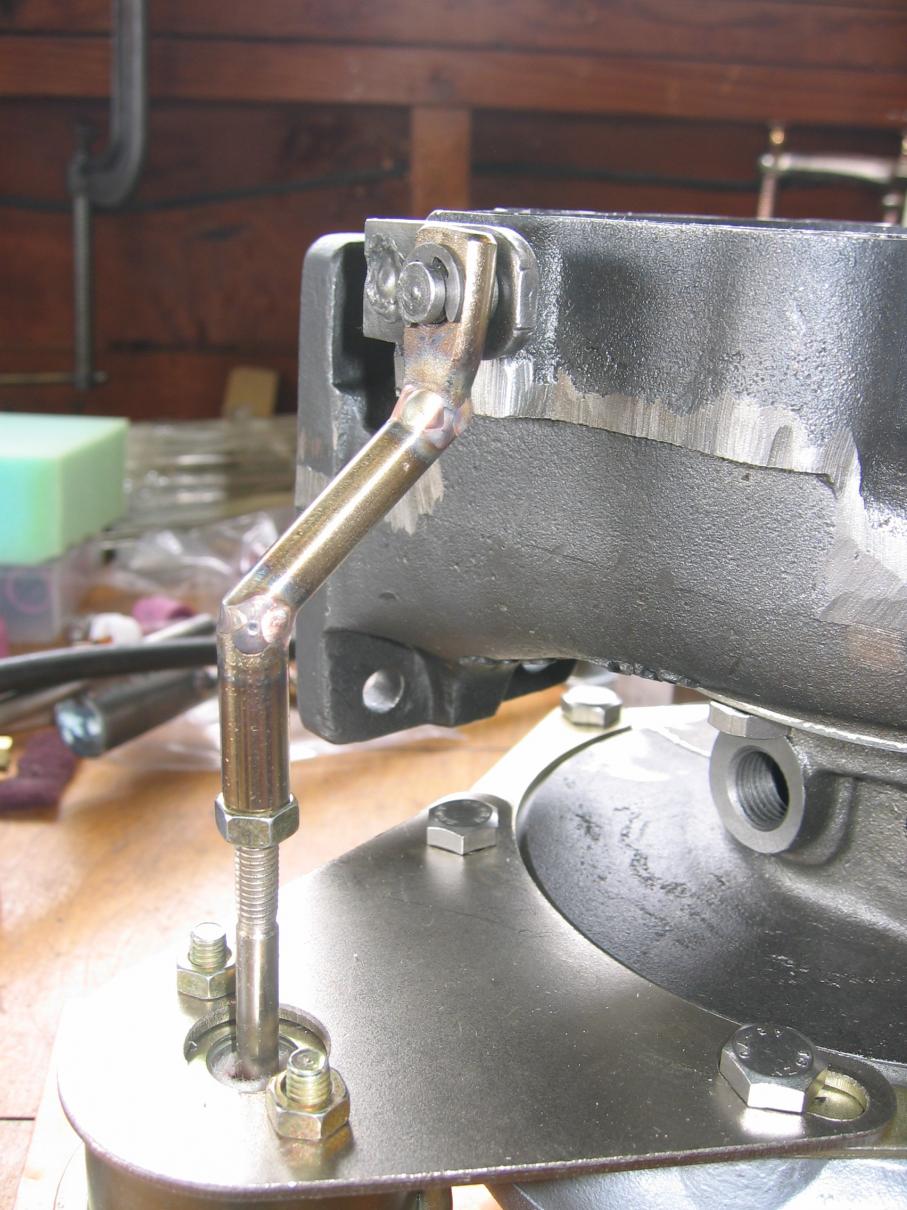

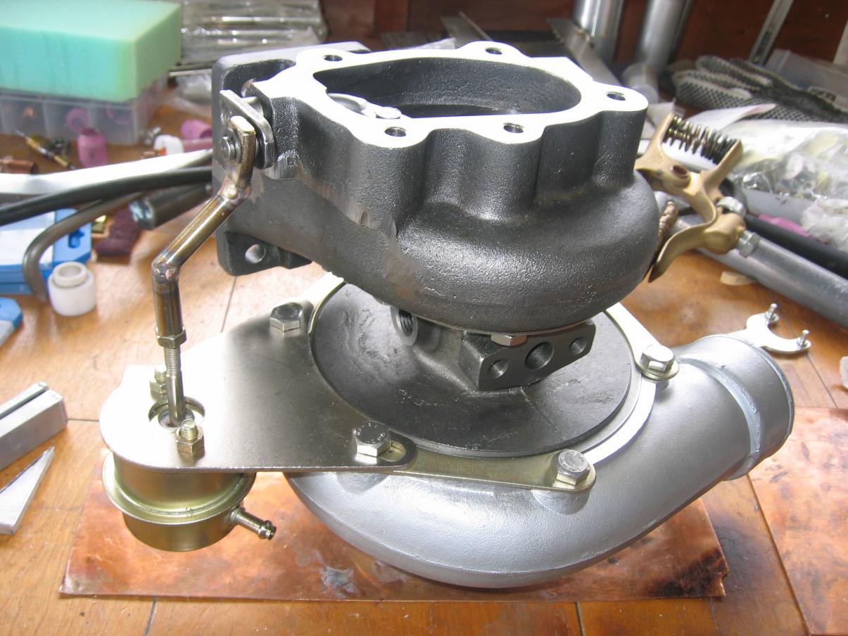

    Here is the completed product after being installed back on the turbo:
ID:	2858 Click image for larger version.
    I used 1/16" 309LSi for the filler rod. 1/16" tungsten with fairly sharp tip (small flat in the end). Low frequency pulsing about 1.5 pulses per second, 60% pulse duty, and 60% background. Footpedal for current control. (Turned way up quite a bit for the first tack welds, then turned down to about 2/3rds of tack weld setting for the full welding.)
