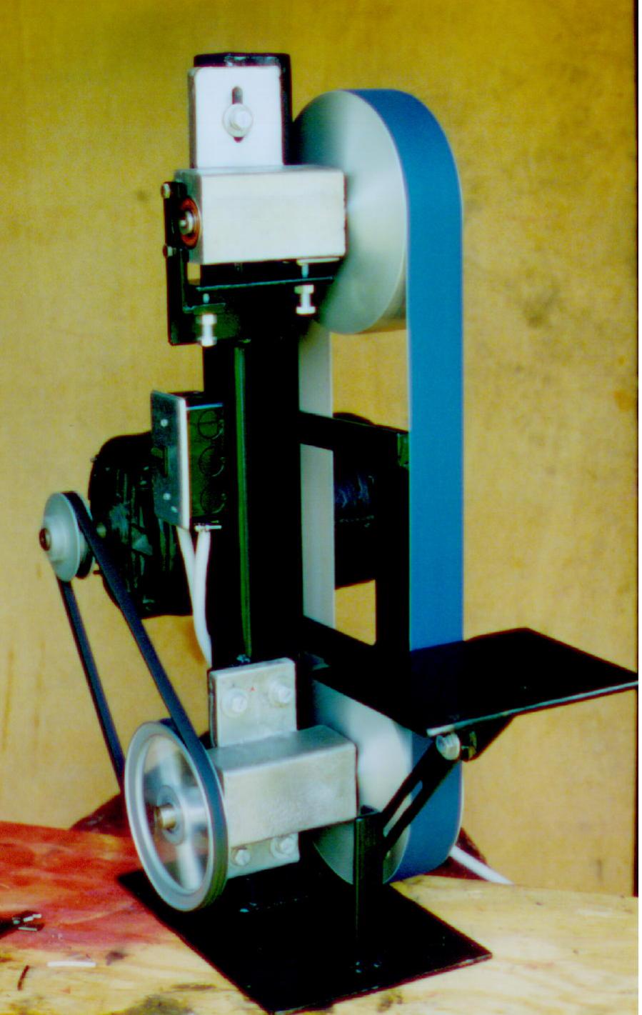

    Hey Oxide00
    You are opening up a whole new world with casting aluminum. Here is a belt sander/grinder I built many years ago. I cast the bearing housings and wheel for it. I also built Gingery’s dividing head for cutting gears. There are many things you will be able to make; it comes down to your imagination as to where you go.
    Have fun
    Tom

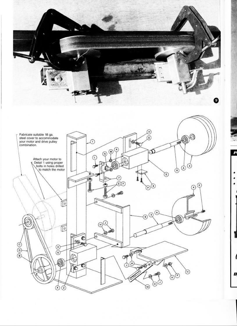

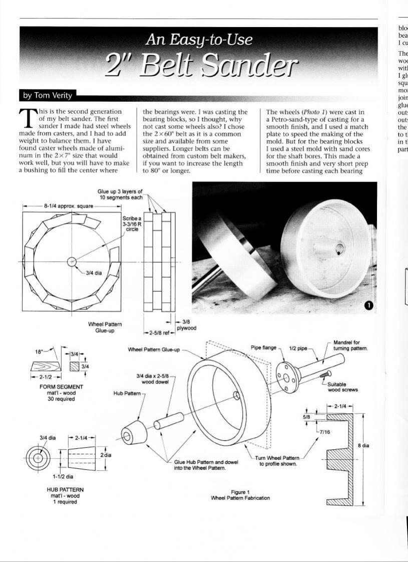

    That a awesome DIY grinder you have there acourtjester, may I ask where you obtained the plans to construct it?
    The Boonies of Texas
    420
    Hey Oxide the article has Toms (acourtjester) name attached to it. Looks like it is his design.

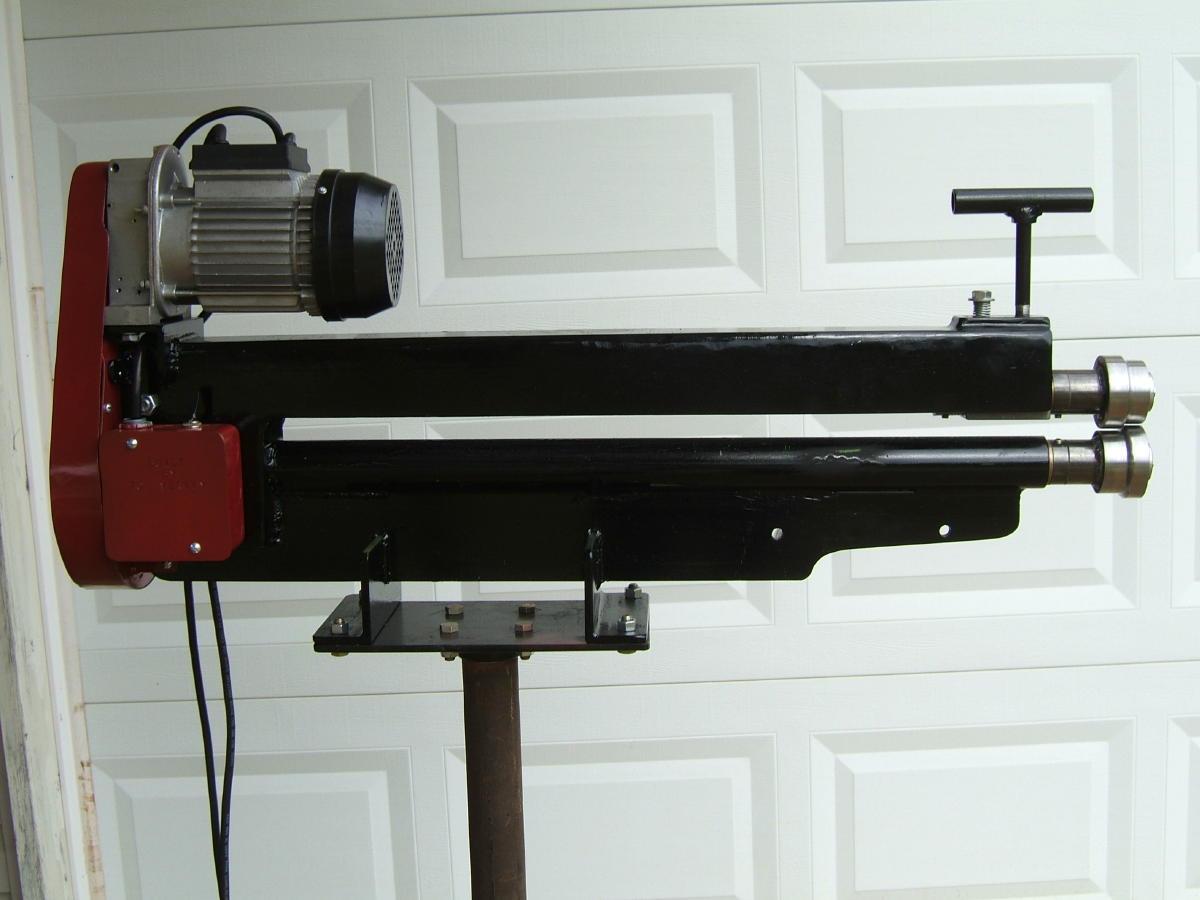

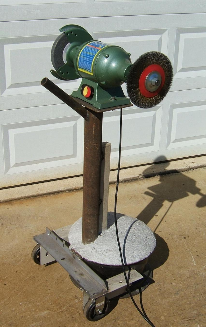

    Default more shop tools he he he
    That be right it was published in Home Shop Machinist about 20 years ago.
    It has a 2HP motor and it is a very important part of my shop equipment. The belt is 2” X 60” I have used a few different grits but 80 to 100 seems to work well. A simple design, easy to build, and easy to change belts I have it on a pedestal. I made a few of these pedestals for grinder, Bead roller, table, and belt sander. A truck rim with a pipe welded on filled with concrete with wheels for mobility.
    Have fun
    Tom
