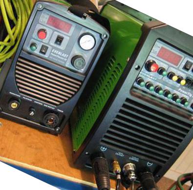

    Default Just don't angle it like this......
    Angling the cart is probably a good idea except don't do it this way......
    Sorry...I had to be a little silly this morning.
