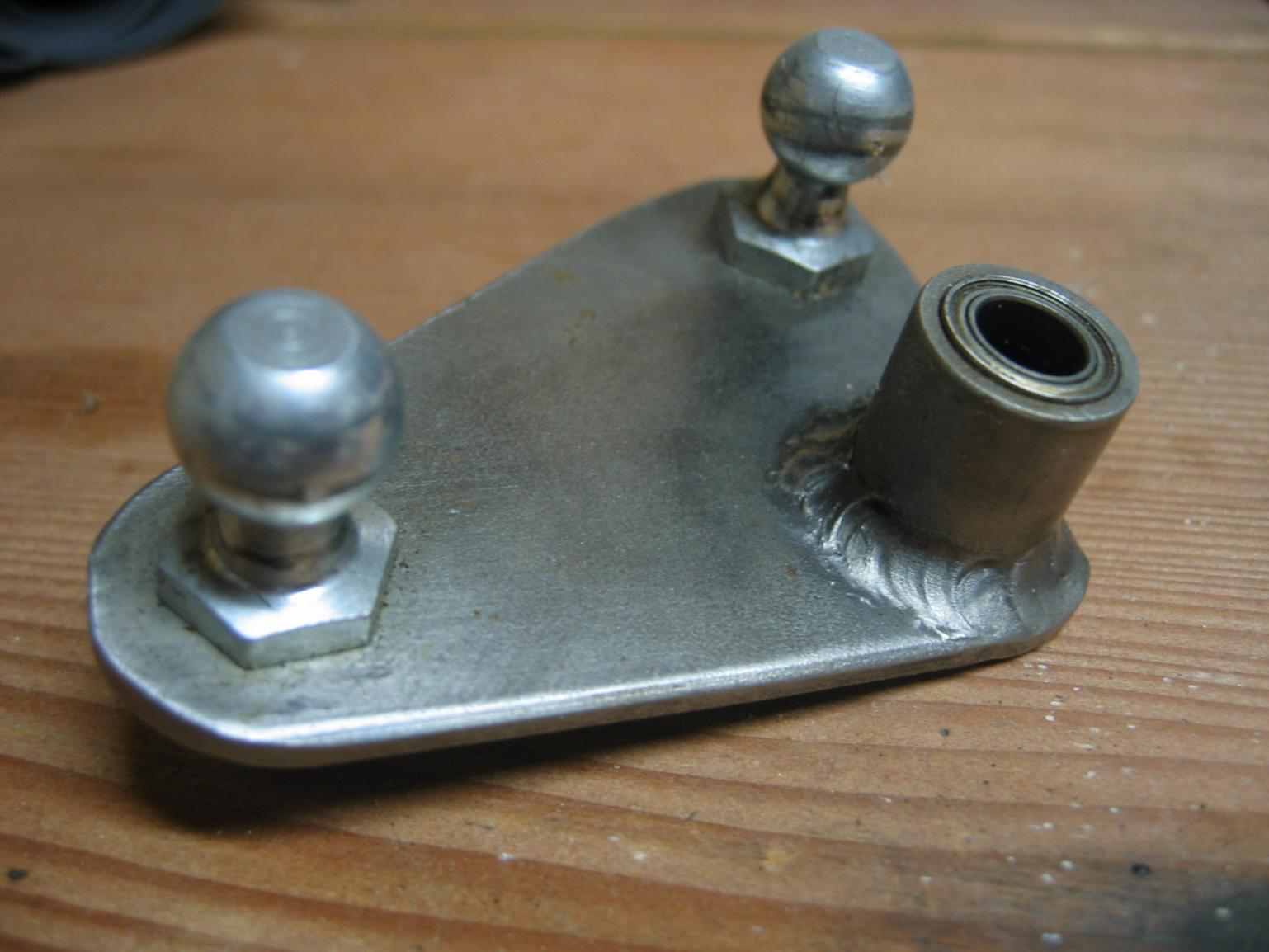

    I recall if you weld lean or without adequate flux coverage, 304 stainless can rapidly "bubble", indicating extreme porosity and brittleness in the bubbled region. That is pretty bad news and if you see it happening, stop and fix something so it doesn't keep happening. It could be making your flame more rich, or it could be adding more flux coverage, or it could be not making something so hot where it doesn't need to be so hot.
    Here is something I stumbled across to get you in the mood. A stainless steel shift linkage I fabricated many years ago, and even used for a while on my race car, I fabricated out of 304 stainless steel and oxy-acetylene welded. This part has never been painted or cleaned, aside from maybe wiped with a paper towel.
