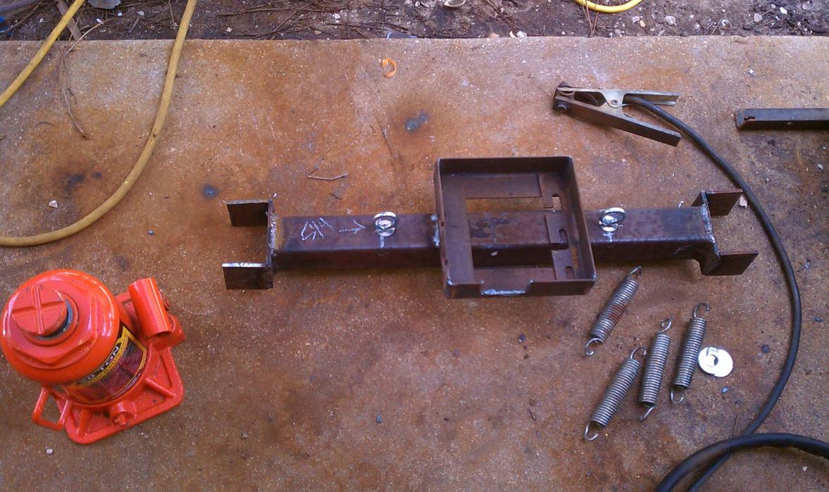

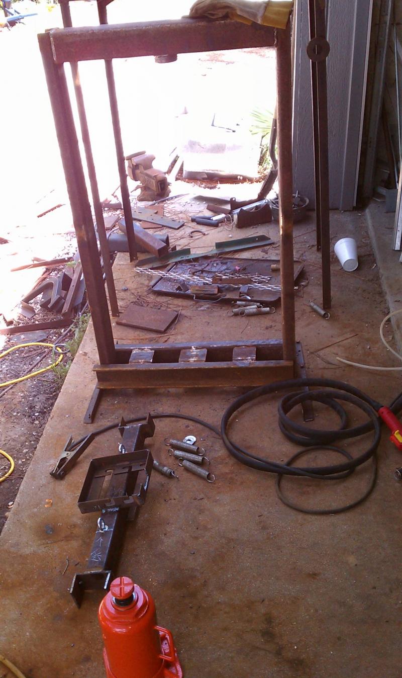

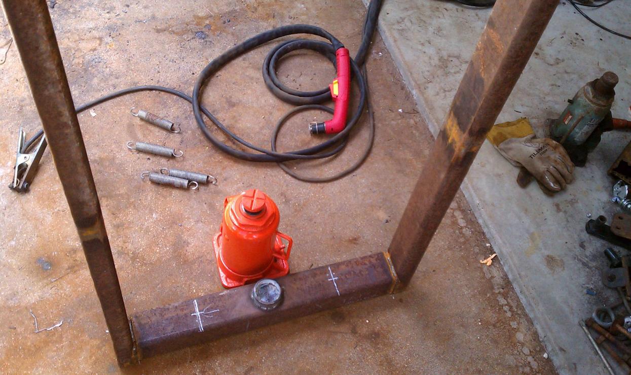

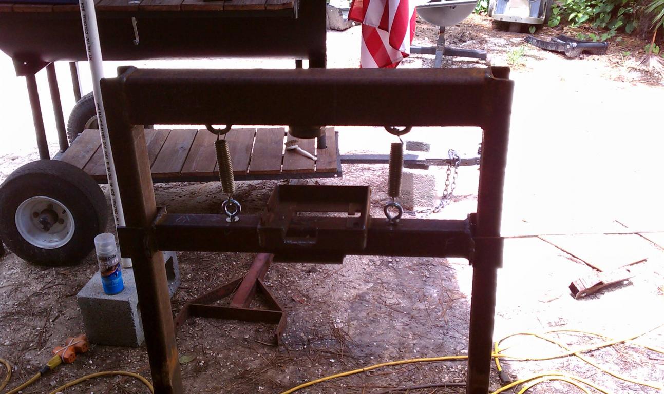

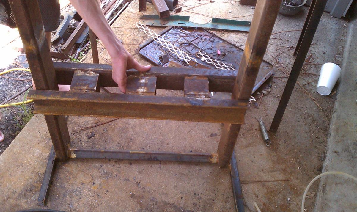

    Here are some pictures of the press. The middle bottom and frame. Not sure what order they are in cause I can not figure out upload.
    Top of frame
    base shelf

    Spring locations
    Complete no sanding no paint but can use it

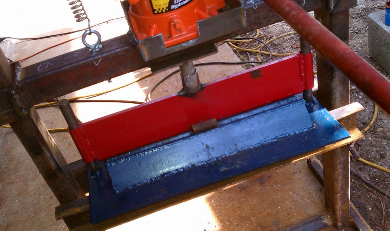

    Brake added

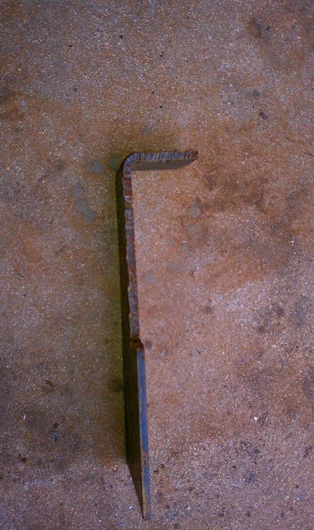

    1/4" piece bent, did 1/2 to and it cracked

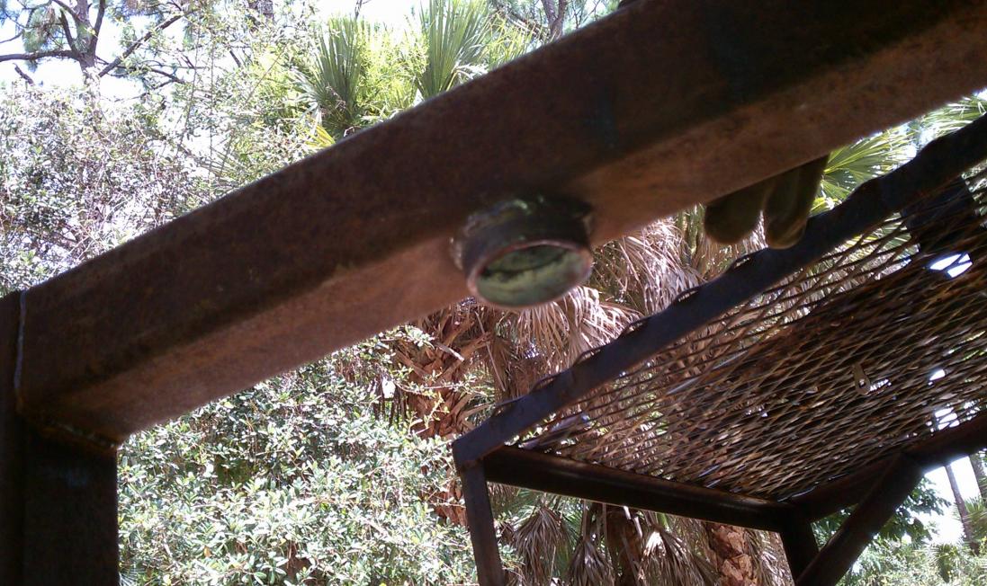

    Middle for jack before welding. They are no in order sorry

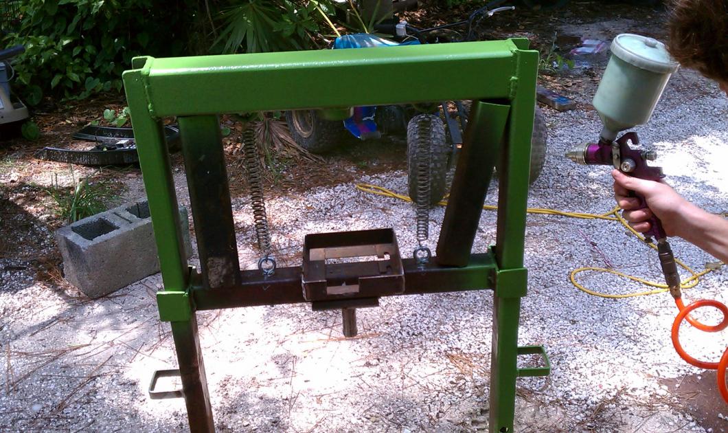

    Well it got paint yesterday. Could not pick a color. Took hunter green and sunny yellow. A lot of yellow. Match the welders now. lol
    Added a place for jack handle
    Used rustoleum

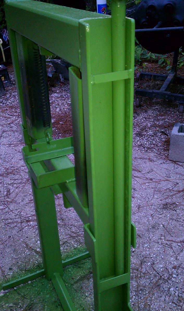

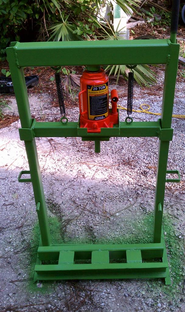

    All done.
    The handles on the sides were bent on the press with the brake I made too
    Nice! What is the largest width you can bend? I would love to build one that could bend 3'-4' pieces of 12 gauge.
    So far 1/2" by 2 I have done with no problem. Last post I did in the brake thread was 6"x1/4" with no problem either. It is pretty strong.
