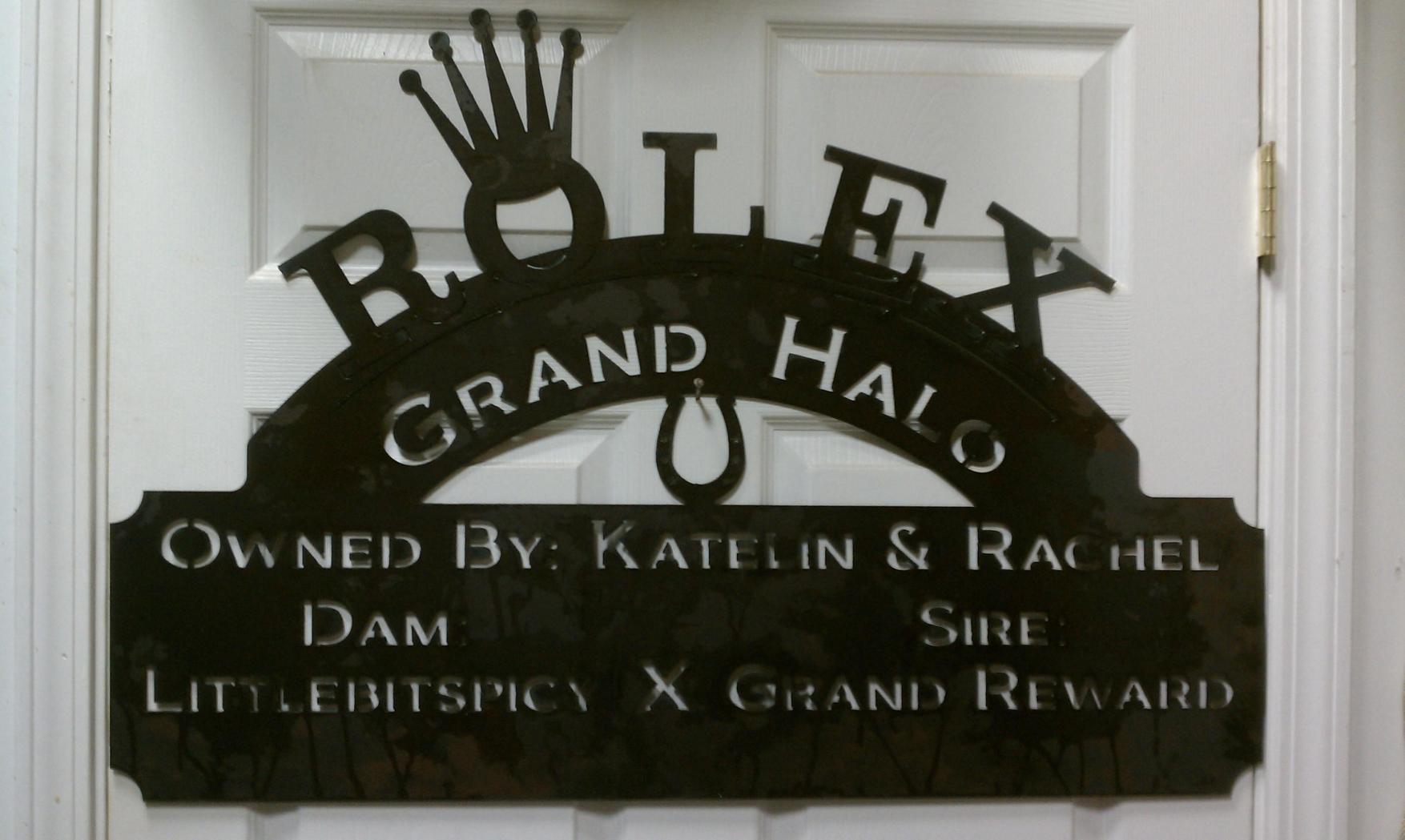

    Made from 16 GA. carbon steel. Took somewhere around 3 hours drawing time and 24 minutes to cut. Cut on a my home-built 50"x96" CNC plasma table using the PP50.
    Althought slightly warped due to the heat and thin material, it was kept to a minumum by spraying it with water while cutting. (No water table... yet)
    The size is 36" wide x 24" high.
    The horses name is Rolex. His racing name is Grand Halo, and the parents names are below.

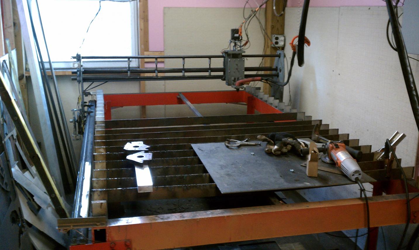

    That looks sharp! Do you have any pics of your plasma table?
    Very nice. I envy you. CNC is on my list, but a long way away for me. Nice size machine you have.
    Like to see table pictures as well if you have any.

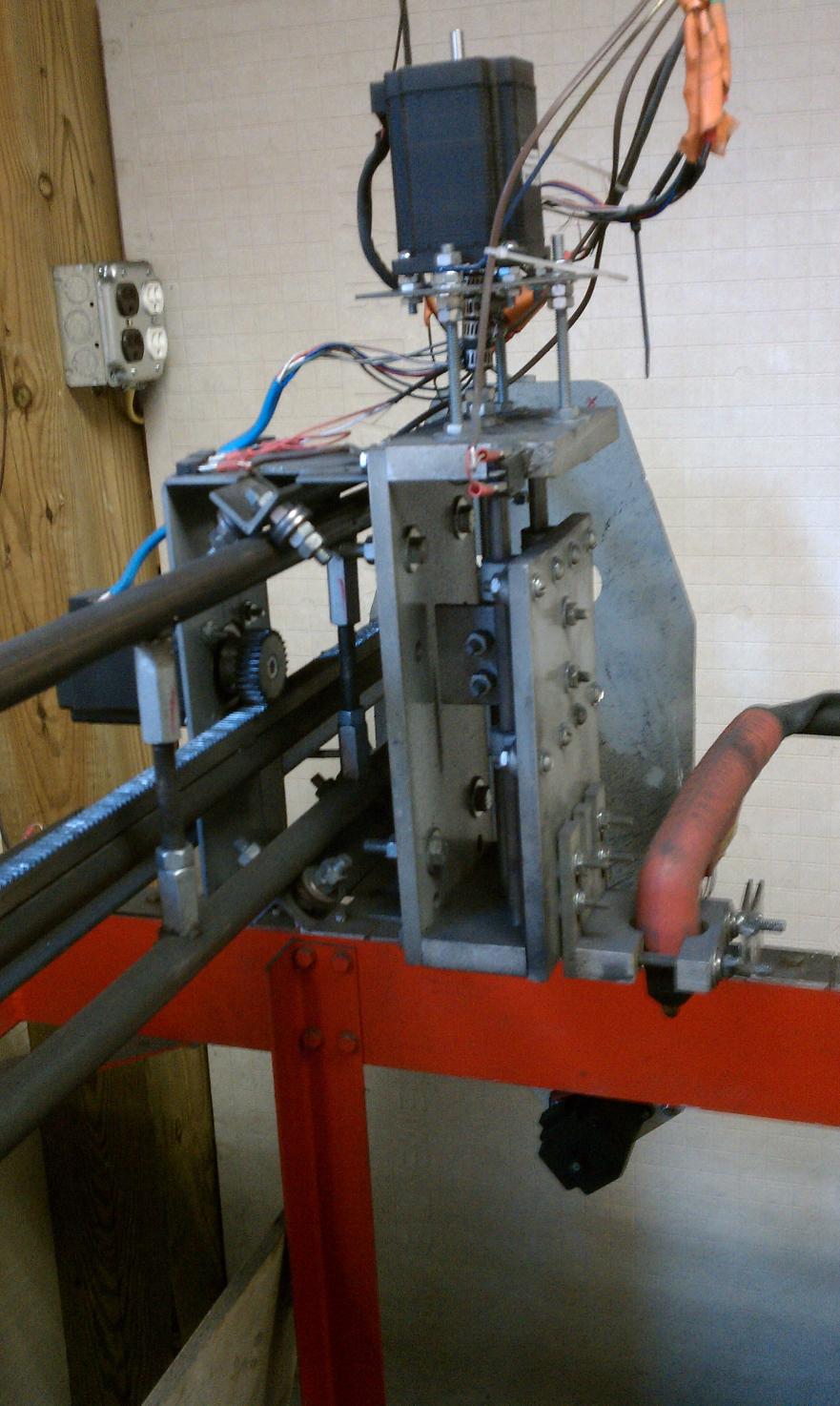

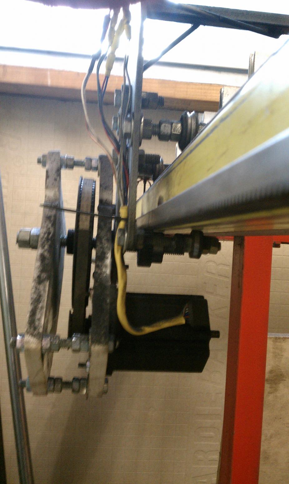

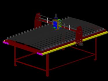

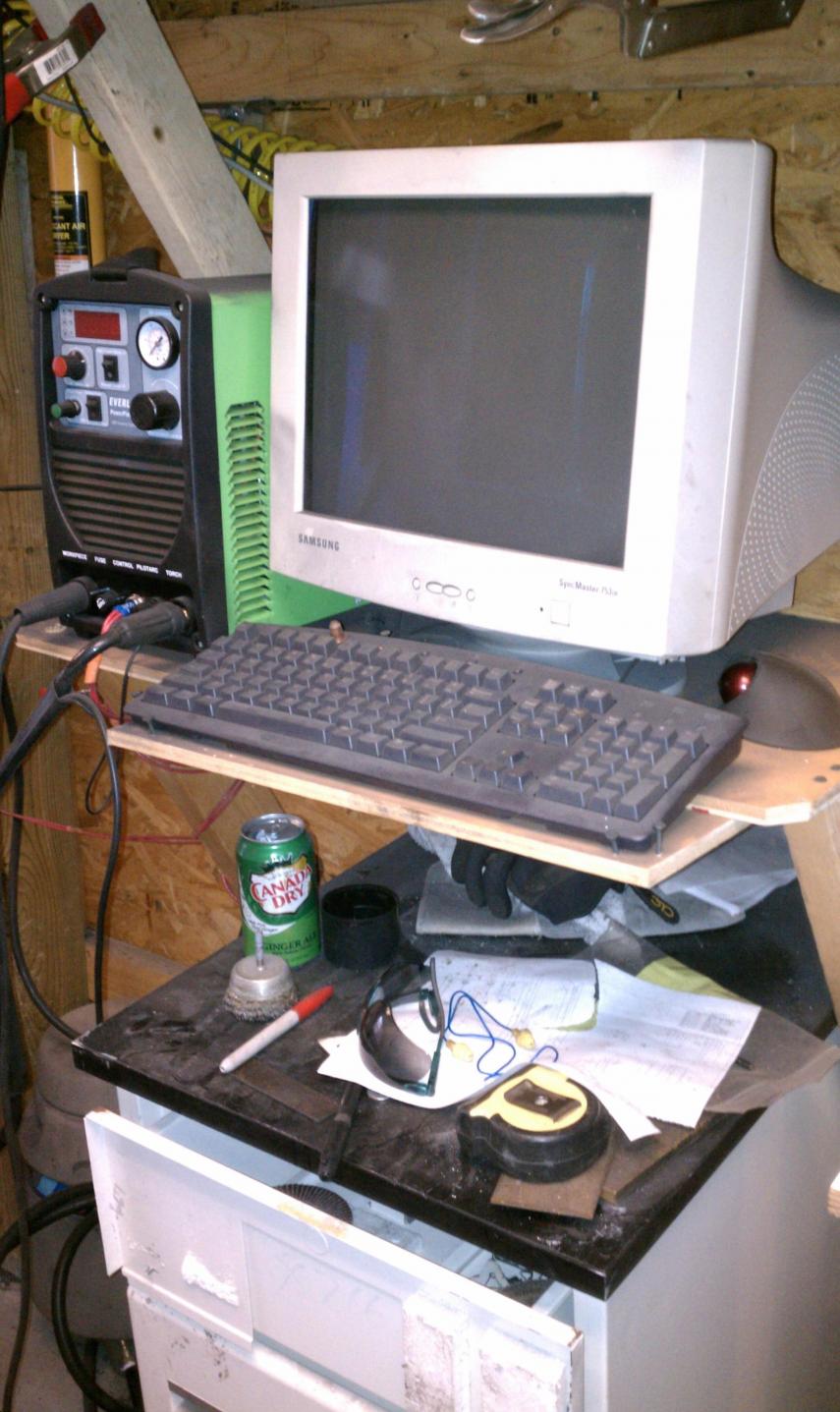

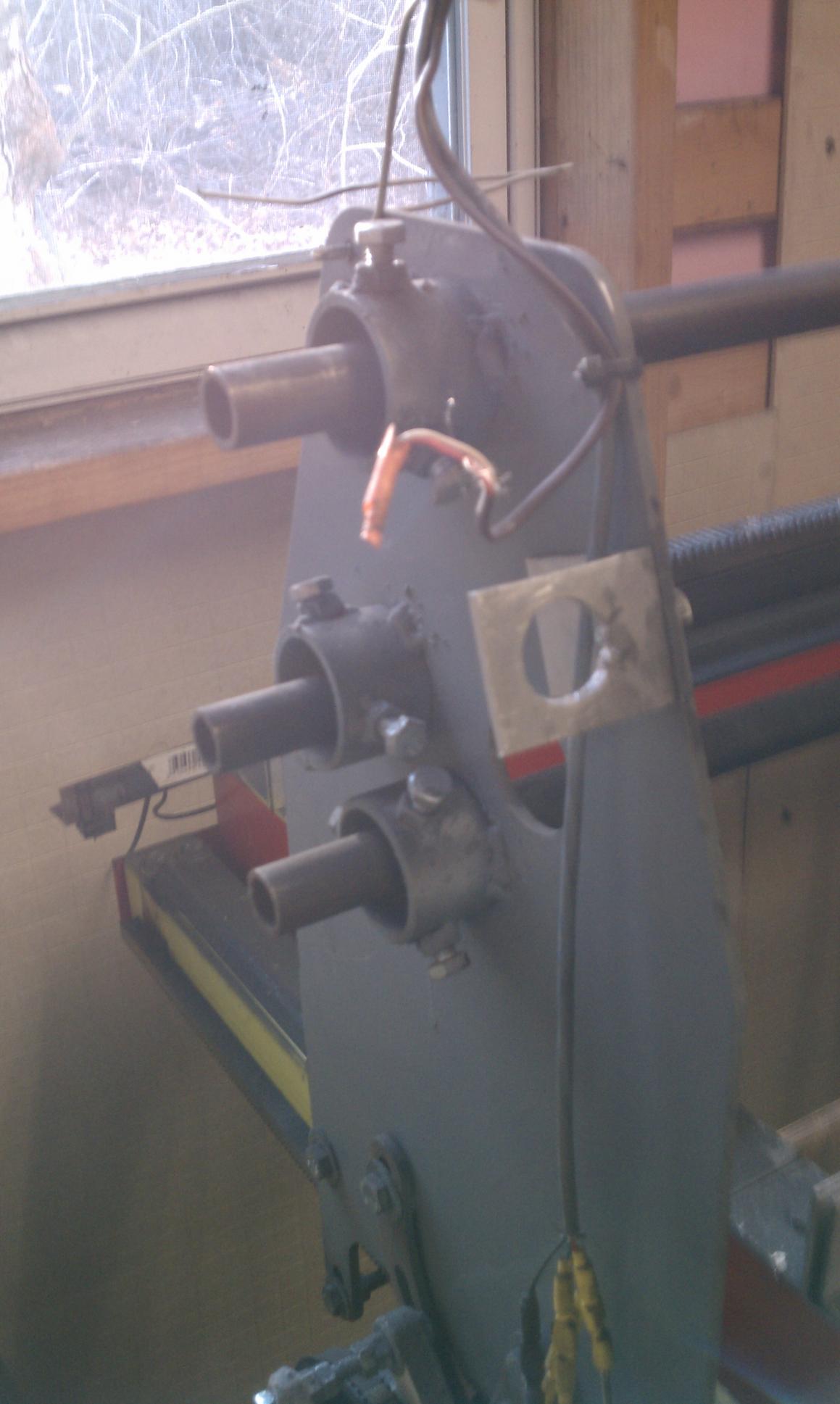

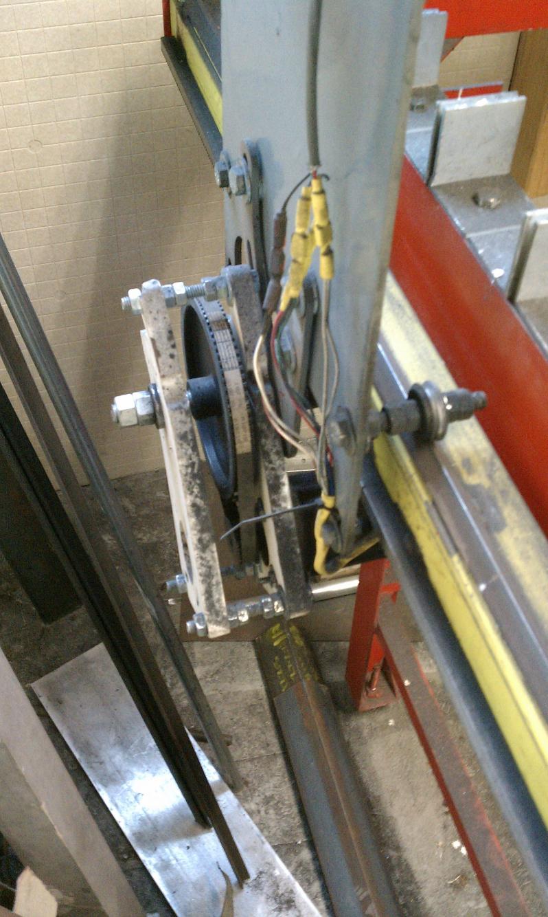

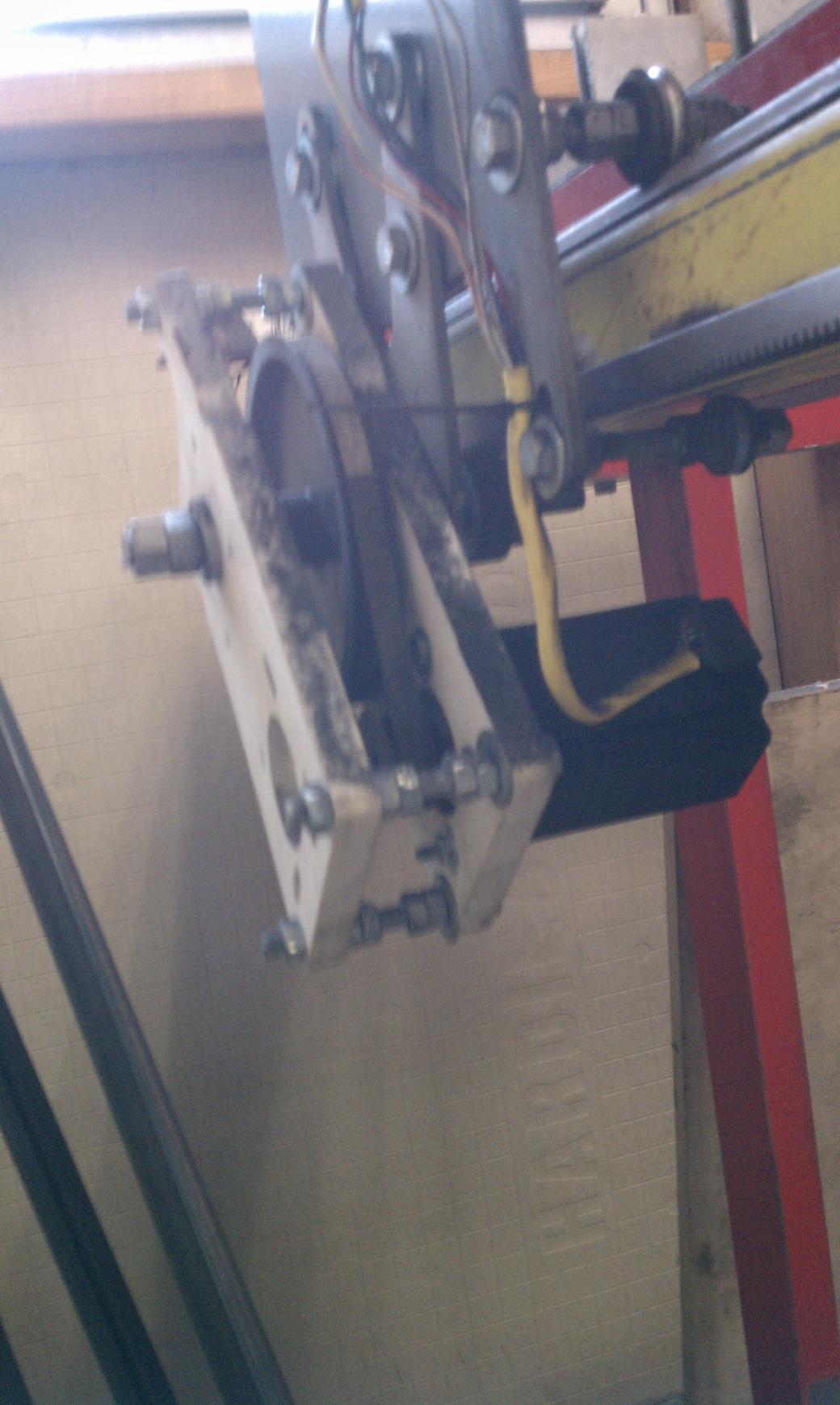

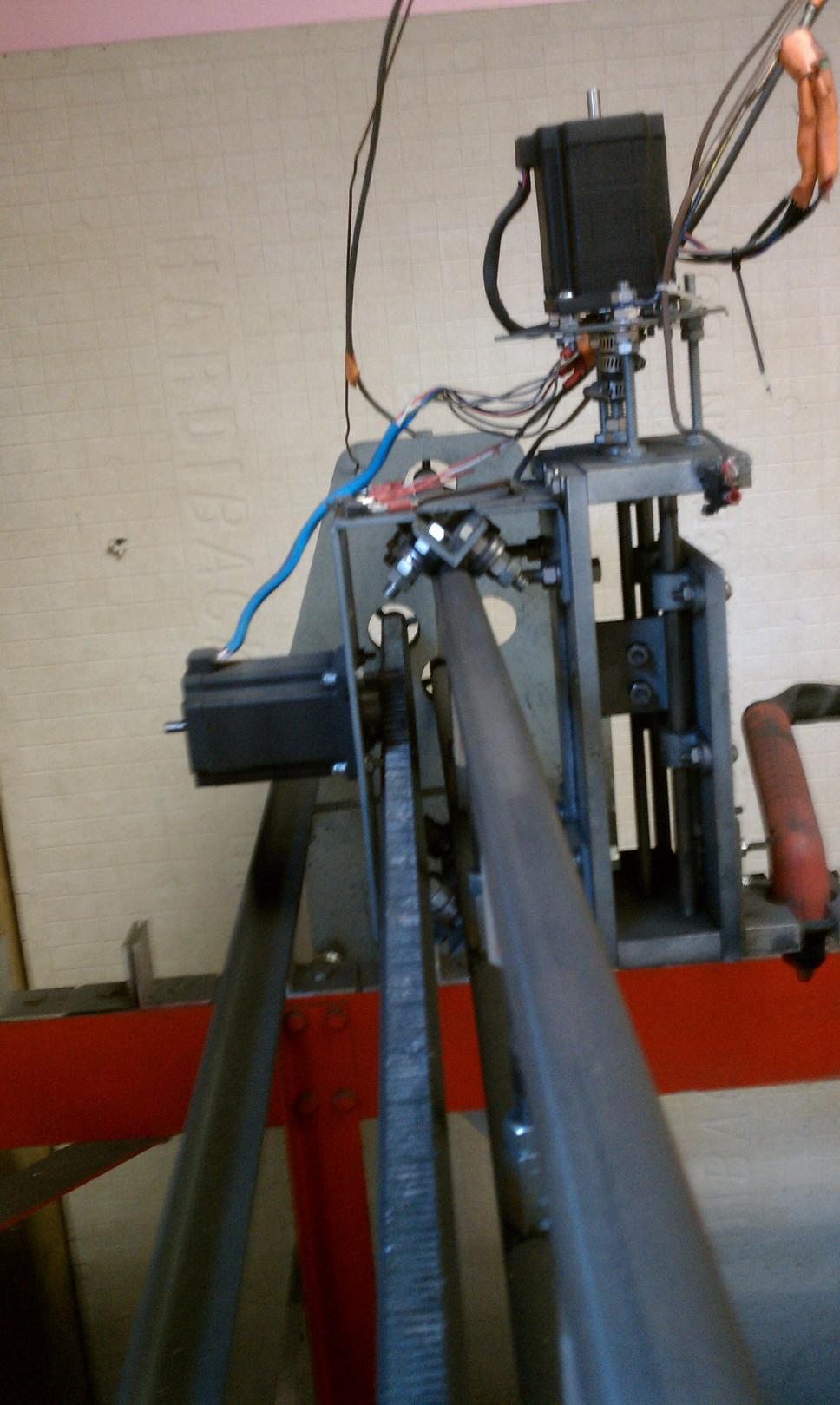

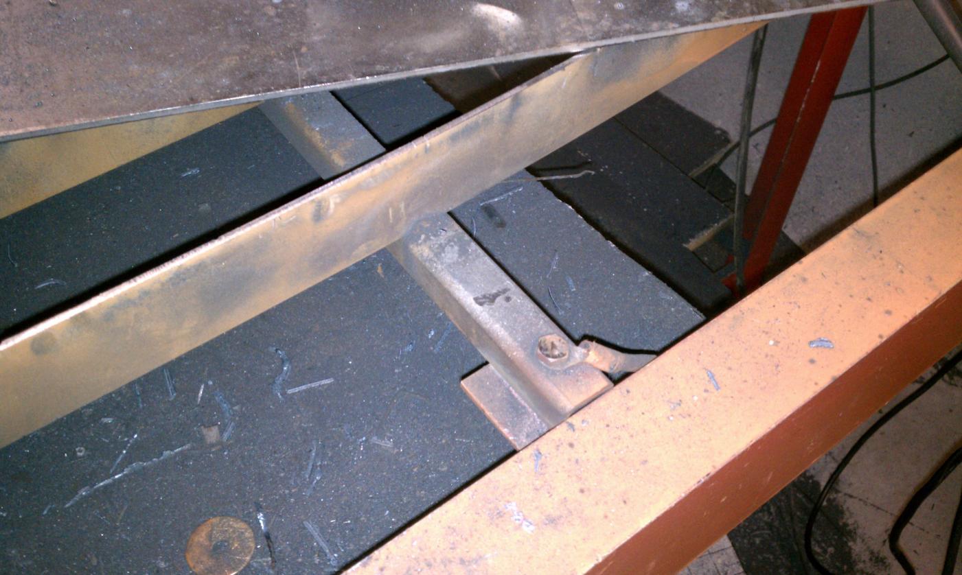

    Here are a couple pictures I have. I need to figure out how to get the others off my phone. Most of the material was free and laying around, so I made it with what i could get. Now that I can cut out precision parts, I'm starting to redesign and upgrade the table.
