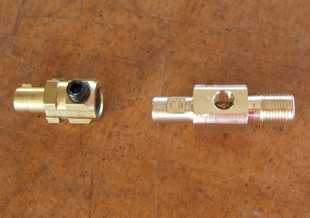

    Here is an adapter I made for my new tig torch. I bought a WP-26 torch from Ebay with gas through the lead but no dinse connecter. I had a round brass bar so I machined an adapter. I machined a 1/8” threaded port in the side of the adapter for the gas supply. . I removed the dinse connecter from my Everlast stick stinger and used it with the adapter to connect to my PM-256.
