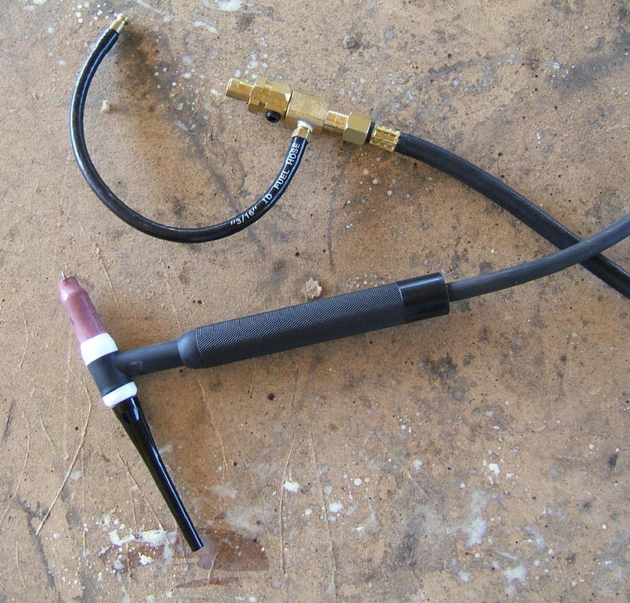

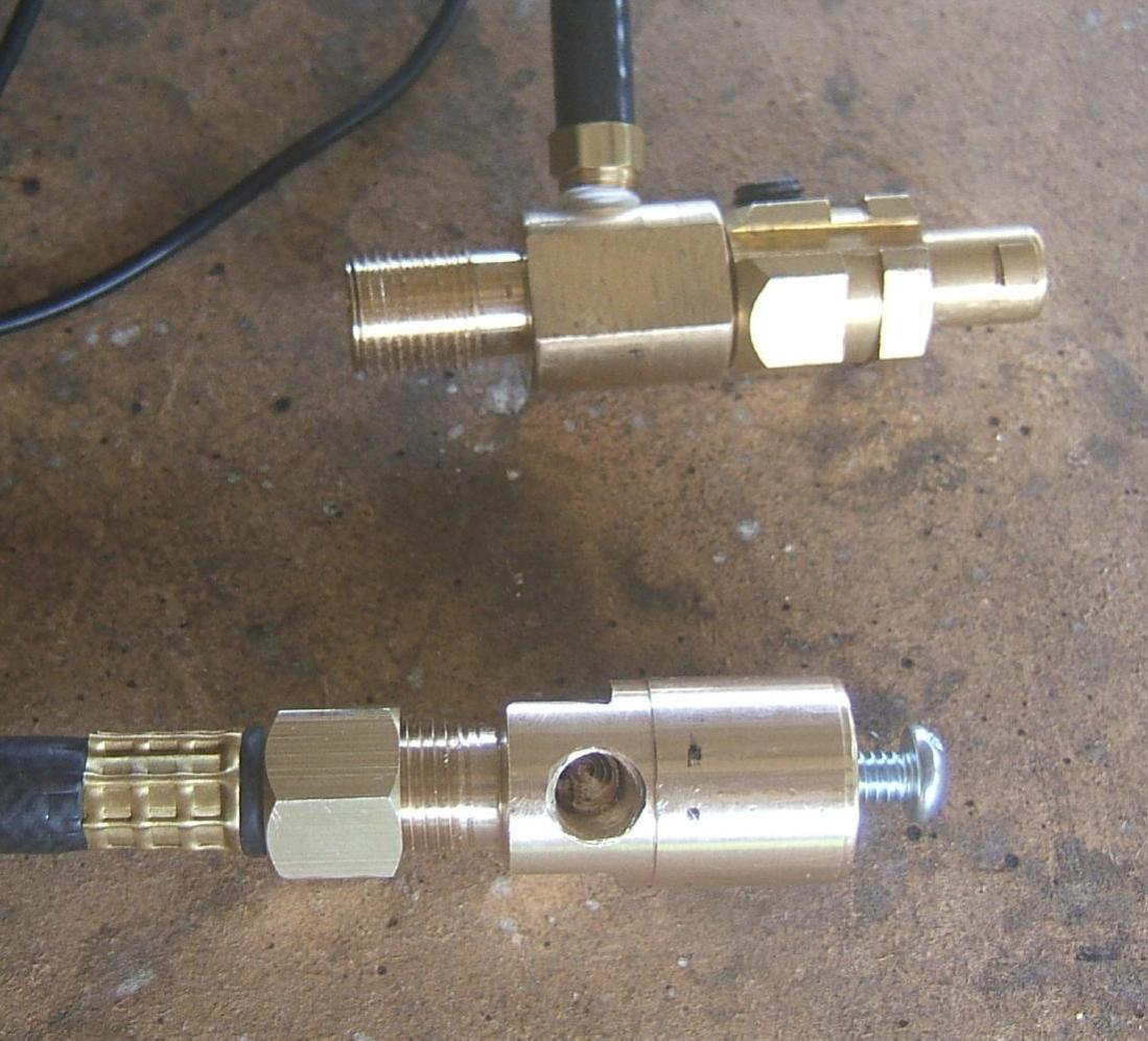

    Here is an adapter I made for my new tig torch. I bought a WP-26 torch from Ebay with gas through the lead but no dinse connecter. I had a round brass bar so I machined an adapter. I machined a 1/8” threaded port in the side of the adapter for the gas supply. . I removed the dinse connecter from my Everlast stick stinger and used it with the adapter to connect to my PM-256.
    Have fun
    tom

    Hey Tom, I am not using the dinse connector you sent me on the 26 series torch (it doesn't fit anything I have either). I will send it back to you if you can make me one of those adapters (don't mind paying you for the machine work of course). I don't need the protrusion for the dinse connector to attach to the adapter. I will just drill and tap a hole where the protrusion would have been to hook up a lead from my solar panel.

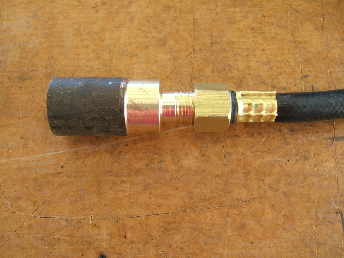

    Here be another one for tritium

    Sweet, Tom. Perfect. I PM'd you as well.
