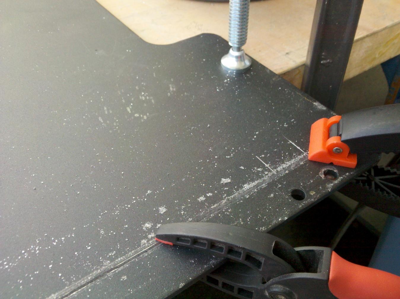

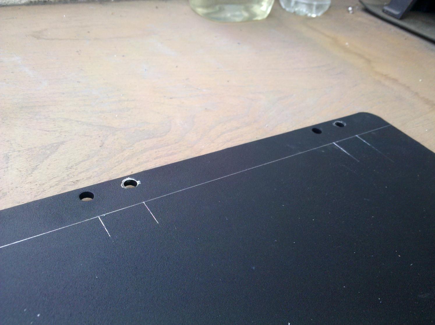

    Ok first off I did this project to save myself $145.00 for an 18 x 18 " piece of aluminum, (That's what the local shop wanted for a new item). I needed an 18 x 18" seat pan for an old power wheelchair I'm trying to get usable again and found a 20 x 18" pan on Craigslist for $20
    This is what I started with. Showing some of the Scribing of the new hole locations before any cutting is to be done, just lines transferred over and main cut line.

    Since I'm at my apt I am stuck using low tech for now, the next two shots show the cut in progress using a $12 HF jig saw with a decent bi-metal blade.

    next two shots show the cut off piece laid over the main panel to verify my marks for drilling.

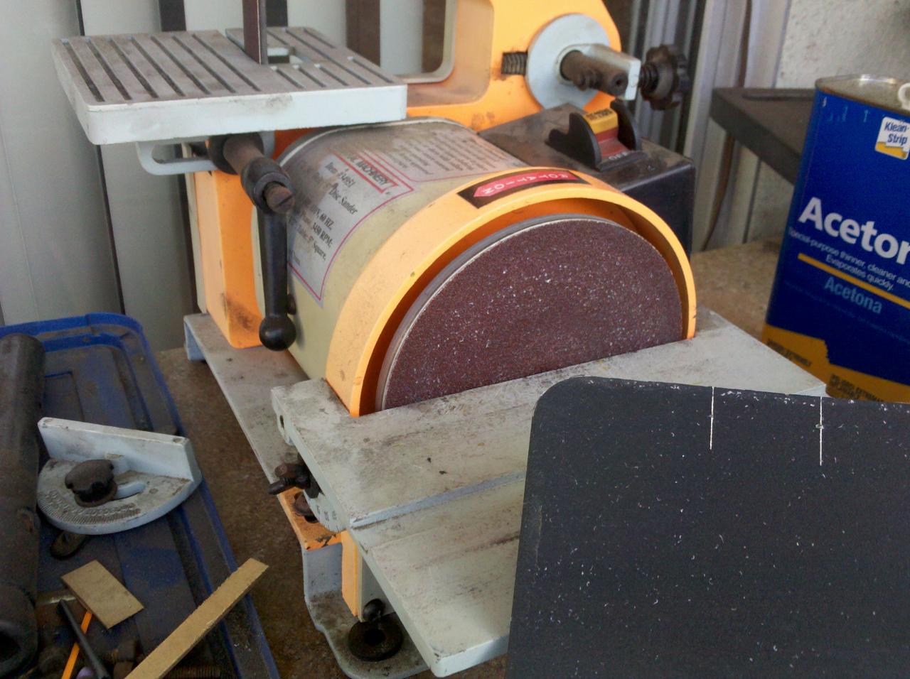

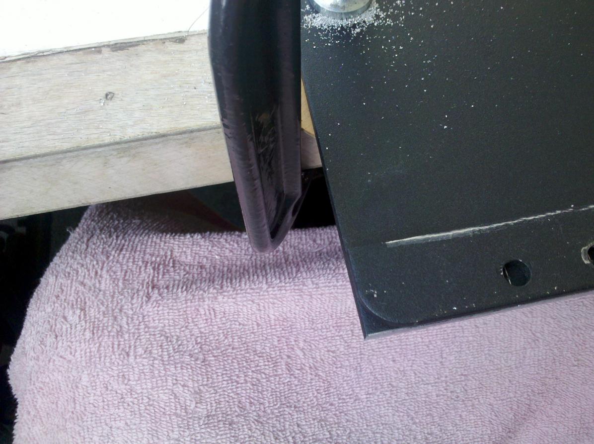

    Using the Harbor Freight 2 in 1 Disc/belt sander to redius the corners.

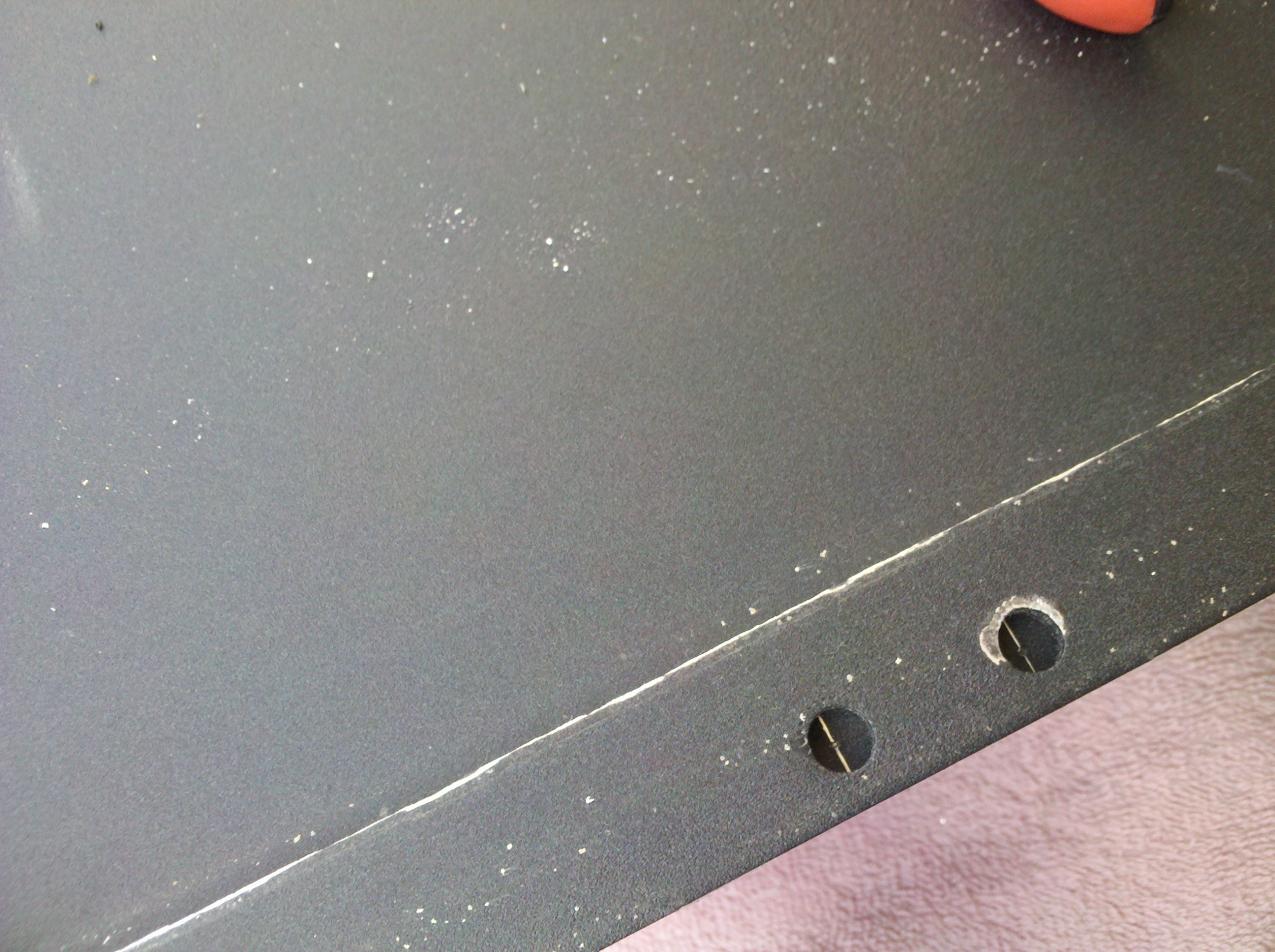

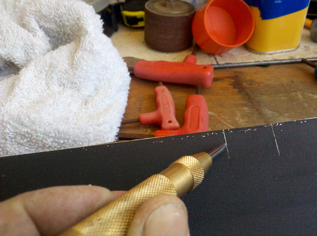

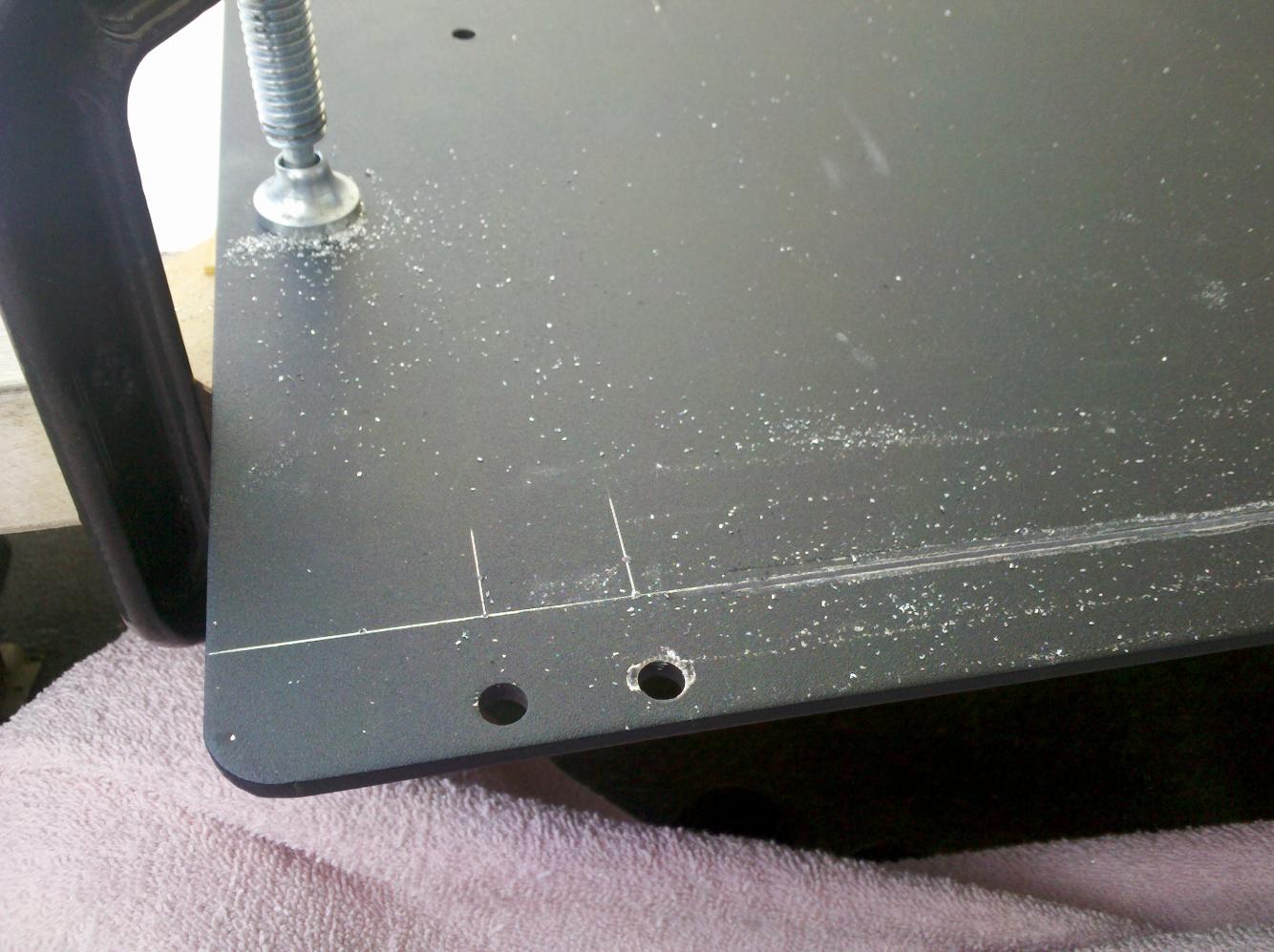

    Using my spring loaded center punch to mark the drilling points for the index holes on the seat pan, and readying my drill.
ID:	2603Click image for larger version.

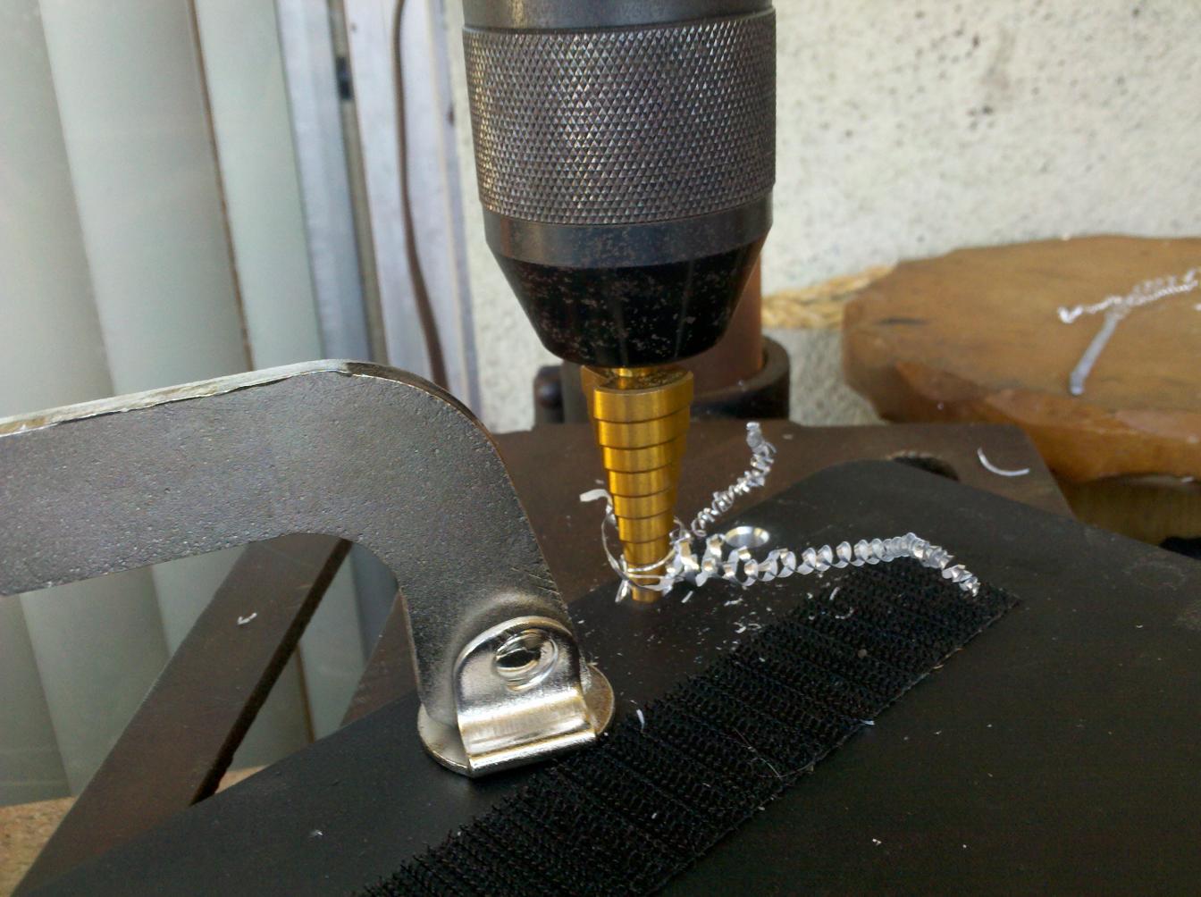

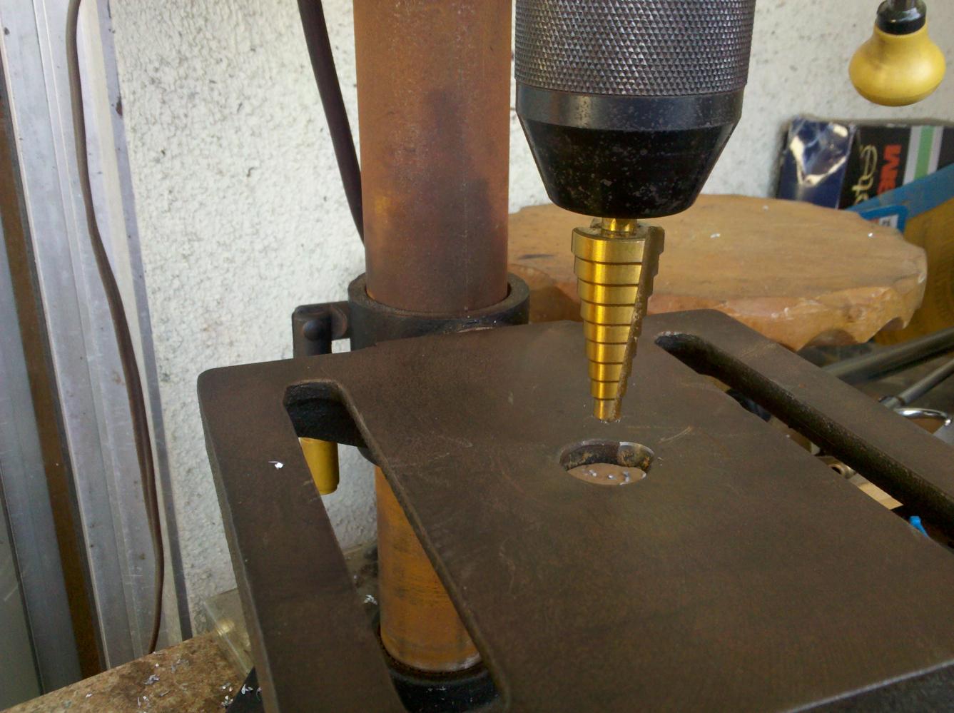

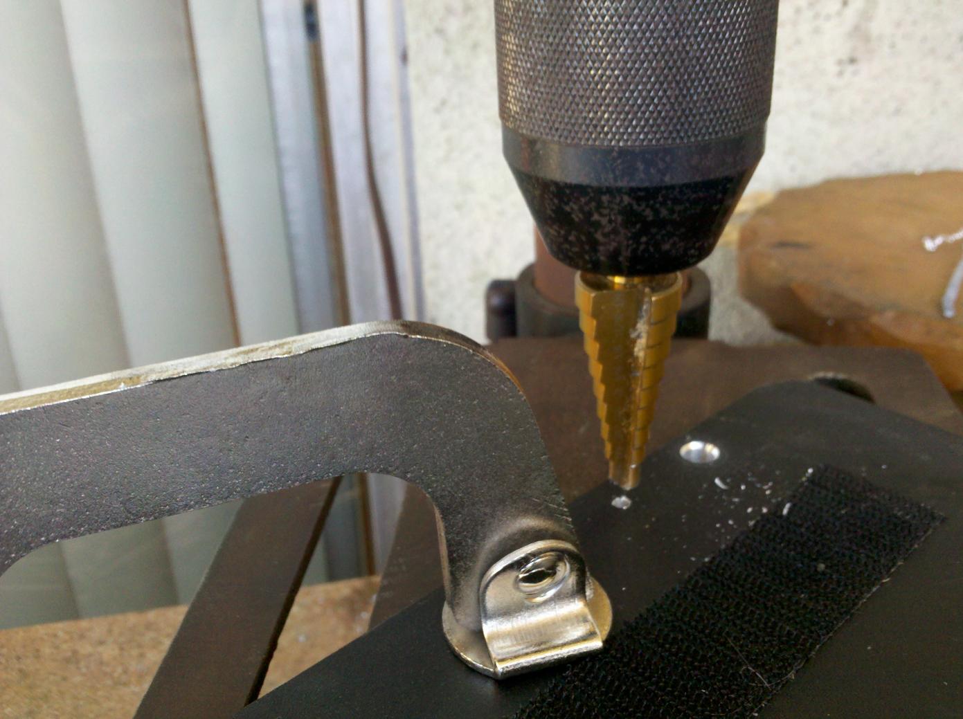

    I needed 1/4" holes so I opted for the large HF step drill bit as it would bore the hole and de-burr at the same time.
    to be Continued

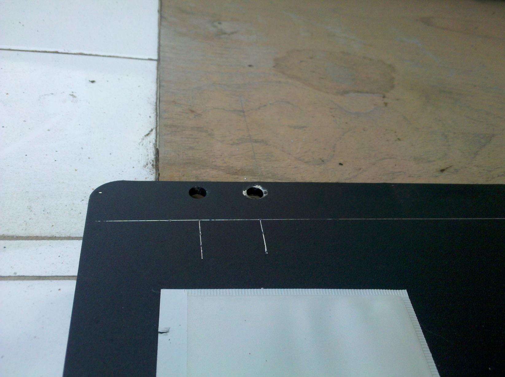

    ok back to the drilling. as i Said I am using the HF step drill bit because it makes a nice clean hole and de-burrs the hole at the same time
ID:	2606Click image for larger version.

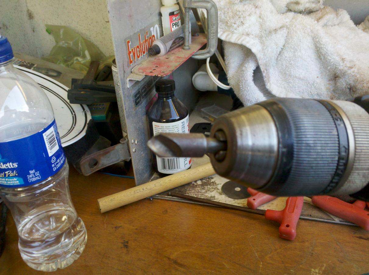

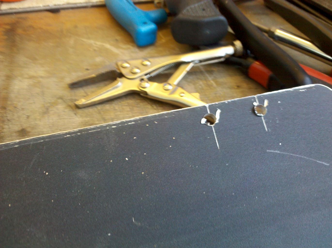

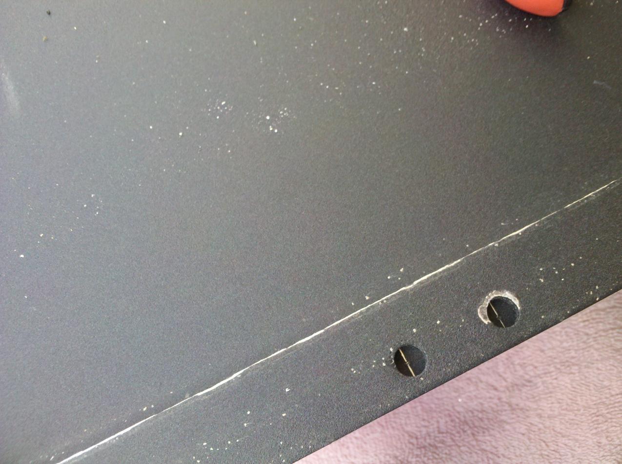

    After drilling the holes I still had to clean up the back side of the hole and for that I used a single edge countersink bit
ID:	2607Click image for larger version.

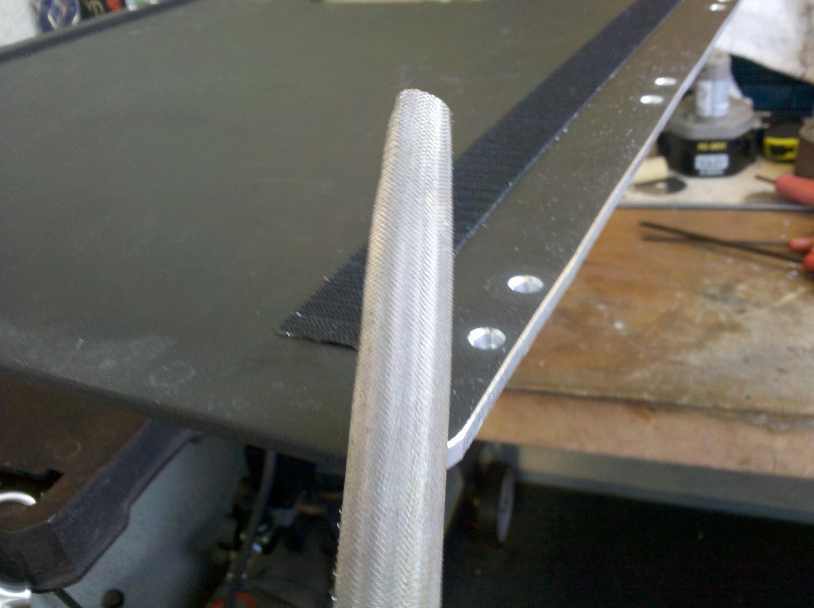

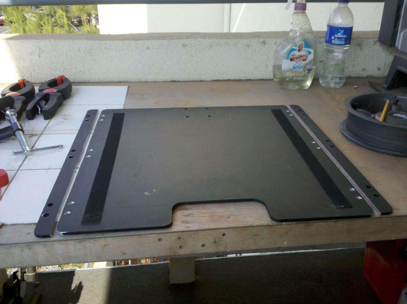

    And last of all I cleaned up the edges with a file so there will be no sharp bits next to my legs, and the finished product
ID:	2610Click image for larger version.
    May not seem like a big deal, but I saved $125 over the Mfg cost of $145 by buying something I could modify and reuse for my needs. Hope this small project shows that It doesn't always have to be new to be right
