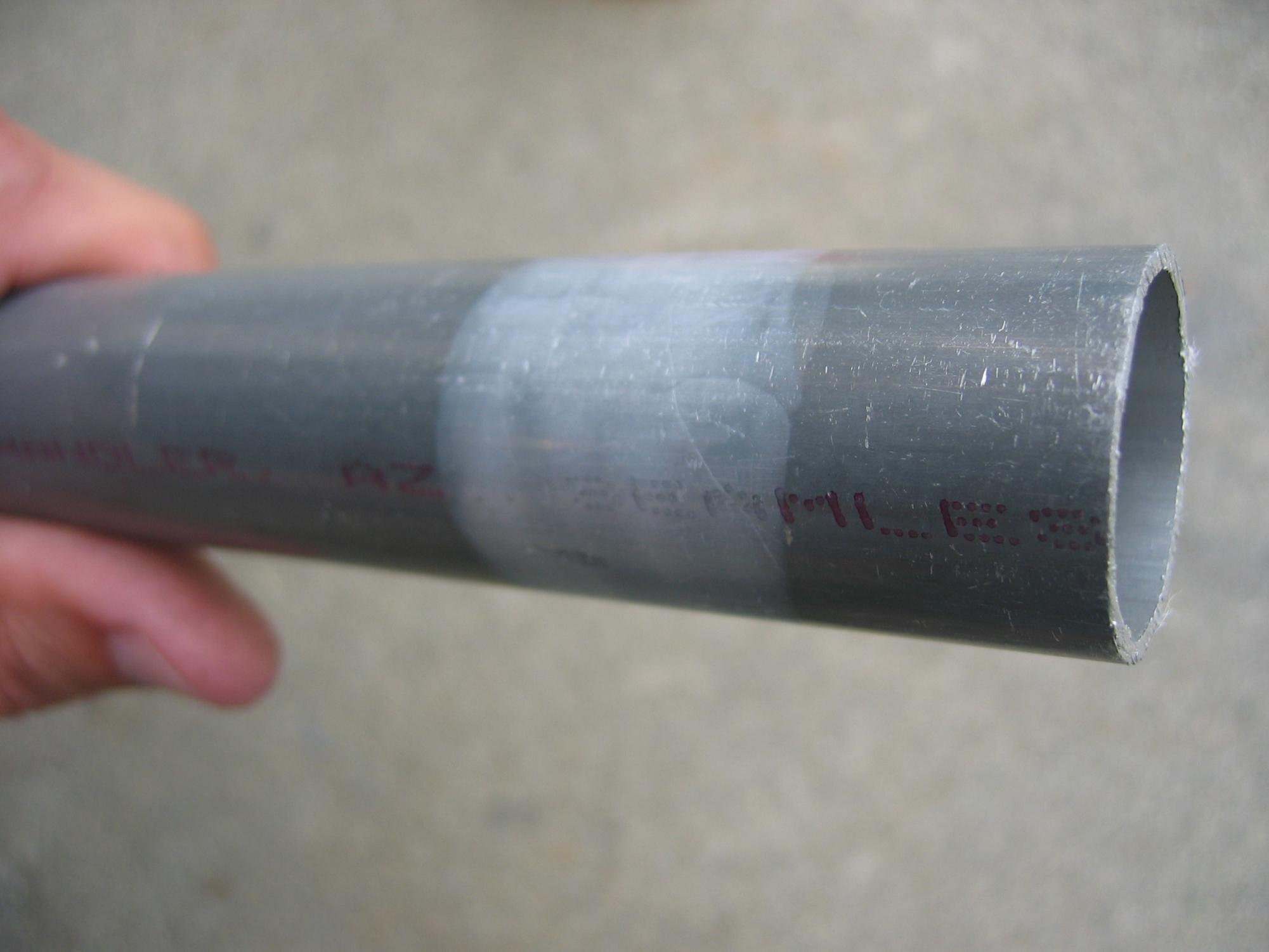

    I performed the test on a piece of relatively clean (but old / aged / lightly oxidized) aluminum 6061-T6 tubing scrap I had laying around. (.065" wall thickness, 1-1/8" OD.)
    I applied the solution with a cotton swab (two applications), and as per the directions on the bottle, left it to sit for 1-2 minutes, then rinsed off with water and dried off. A few seconds after application, the cleaner was obviously doing something, at least to change the color of the oxidized surface. I noticed the cotton swab got some dark / dirty aluminum color on it when I wiped the swab over the surface a second time.

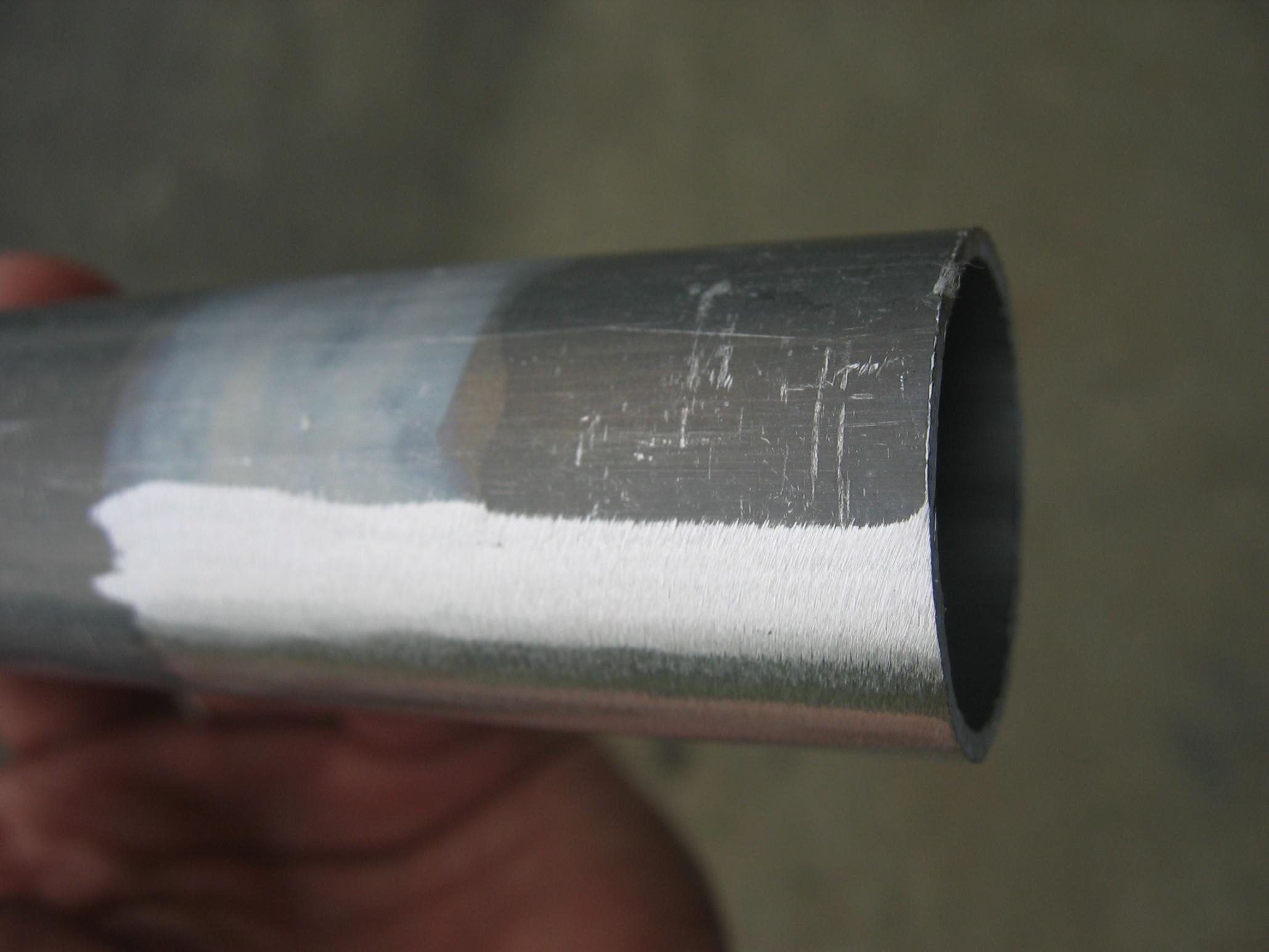

    I prepared two "baseline" tests as well as the experimental test. I left a portion of the tubing uncleaned for a "known bad" baseline (shown at upper-right in picture below.) Additionally, for a "known good" baseline, I removed oxides using one of my a "tried and true" methods: of using a flap disc with light-medium surface pressure (shown at bottom.) And the acid cleaned section is shown at upper-left:

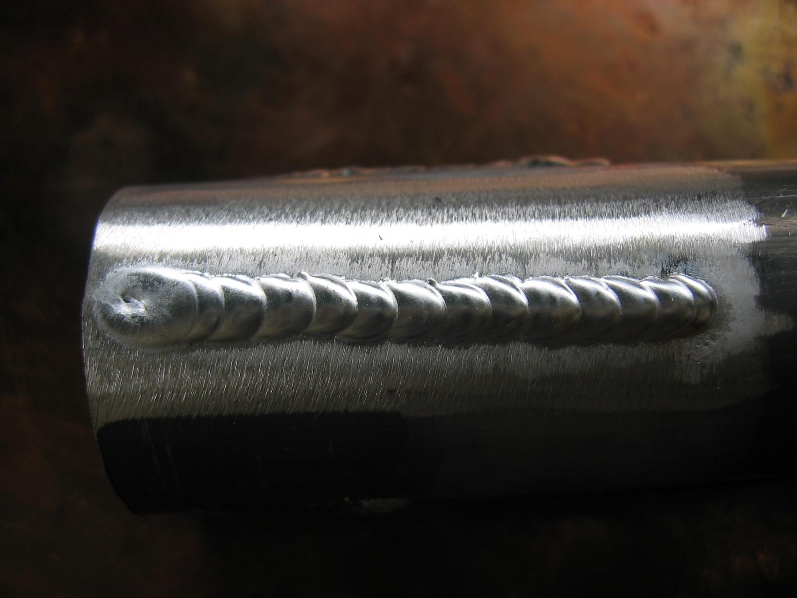

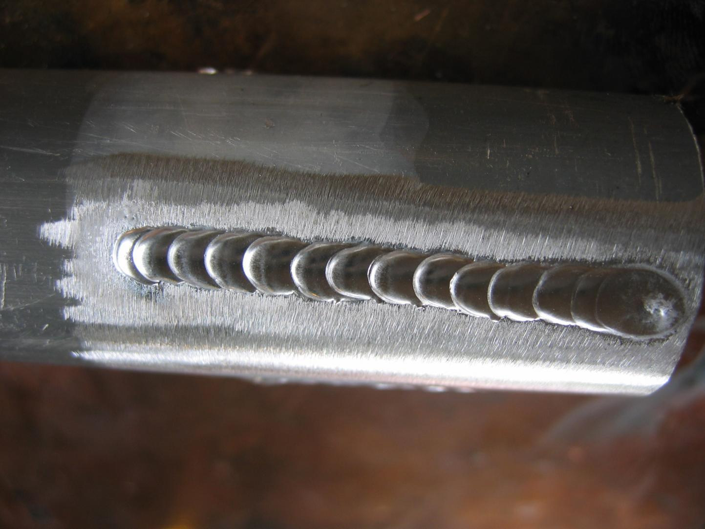

    First we'll look at the results with the "known good", mechanical/physical method of oxide removal method. Without any oxides on the surface, the weld bead wetted/flowed out in a nice, easily controlled manner. The weld bead had a nice looking, "bright and shiny" appearance.

    Here is one more view of the same weld bead with different angle/lighting:

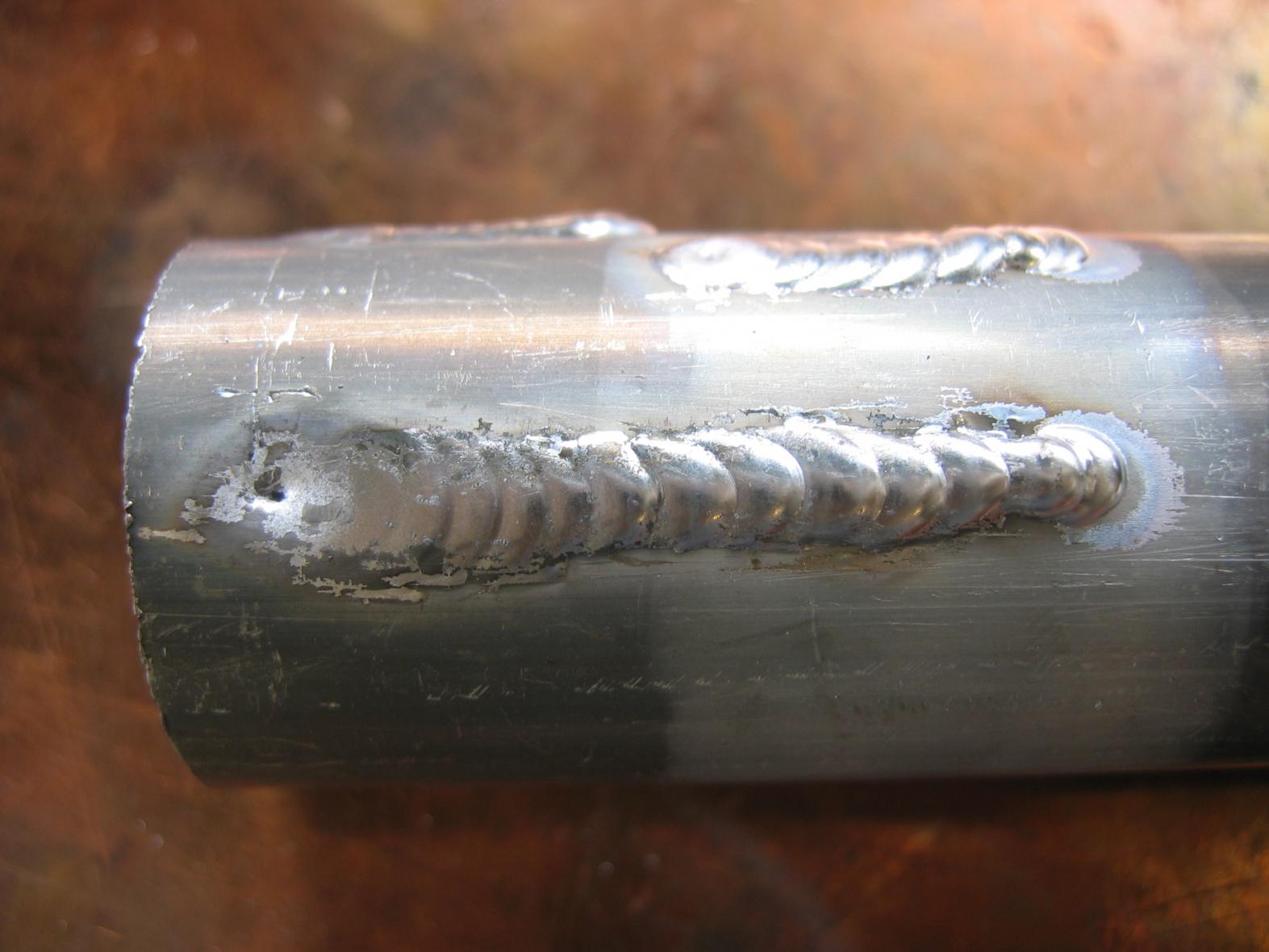

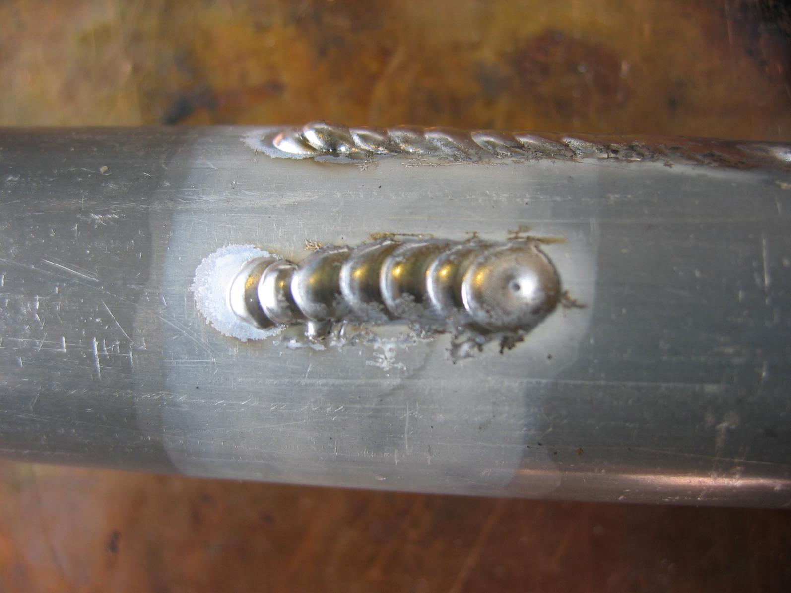

    Next we'll look at a "known bad" (unprepped/oxidized) weld bead:
    You can pretty clearly see in the above weld bead, that the molten puddle was flowing underneath an oxide "skin" layer on the top. Where the skin did break up, there were islands of oxide floating on the surface of the puddle, causing a rough / dirty appearance on the solidified puddle surface. The oxides also impeded the control/flow of the puddle (and I was not able to produce as uniform of a weld bead shape as a result.)

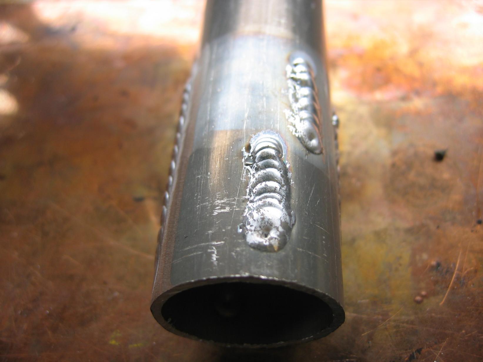

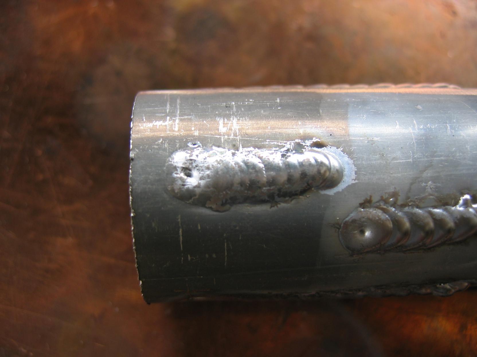

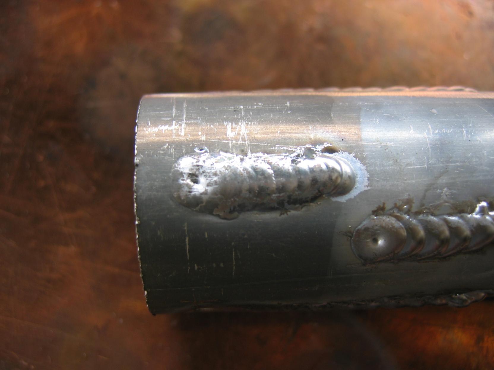

    Now for two pictures of a weld bead in the "acid prepped" zone (these is the experimental area) - I would recommend zooming in on these to see the details:

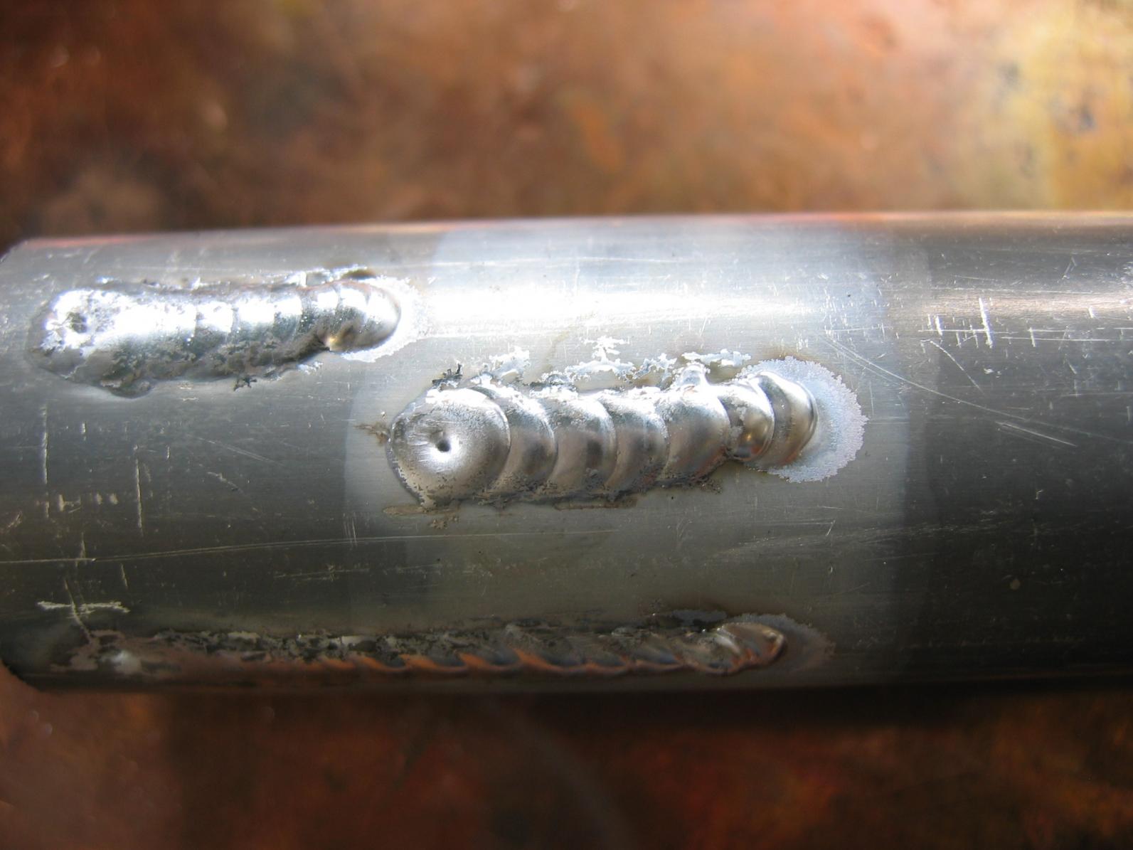

    And here is one weld bead that I started in the "acid prepped/experimental" area and ended in the "known bad/unprepped" area:
    Obivously, the acid prep cleaning method worked nowhere near as good as the physical/mechanical oxide removal method. However, looking at these pictures a little more closely, would you say that it helped some compared to the unprepared baseline? (If you ask me, I think that it might have, at least a little bit, but probably not enough for me to go to the effort of applying it.)
    I do wonder if there is a different, better way that I could apply the acid cleaner that would make it work more effectively. Perhaps I should rinse or wipe it off more quickly before it has a chance to dry out as much. It seems like when I wiped the swab over it, something came up on the swab when it was still wet. Maybe I should try a heavier application, or wiping / rinsing it off while it is still wet. I guess although the initial results aren't too great, I'm certainly open to the idea that there could be better way that this product could be applied, that I just haven't figured out yet.
